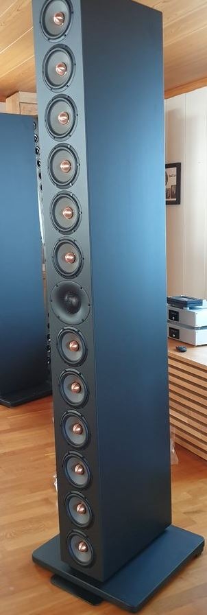

We modified the elliptical 8" waveguide for the T34B w/ groove for implementation of the cat /child-shield.
This is a part of a new active line-array consisting of 12 Seas W16NX003 in a MTM/ power and frequency tapered array (Hypex Fusion FA 503).
Thanx to Augerpro for sharing his work.

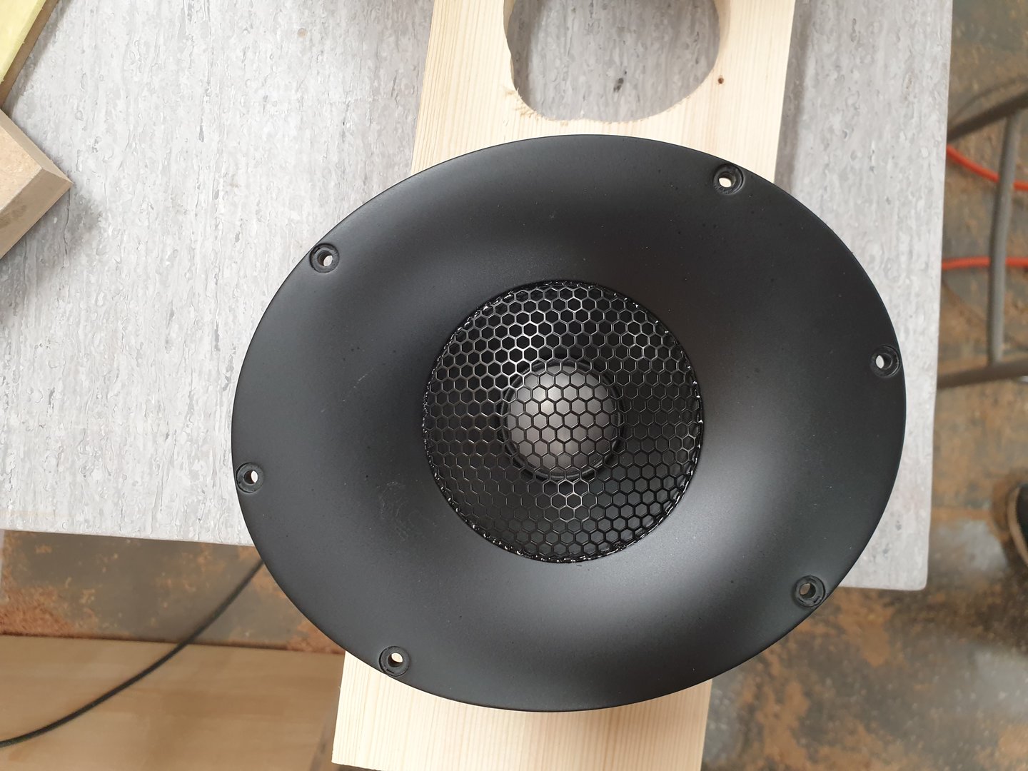

Here's the WG in charge:
