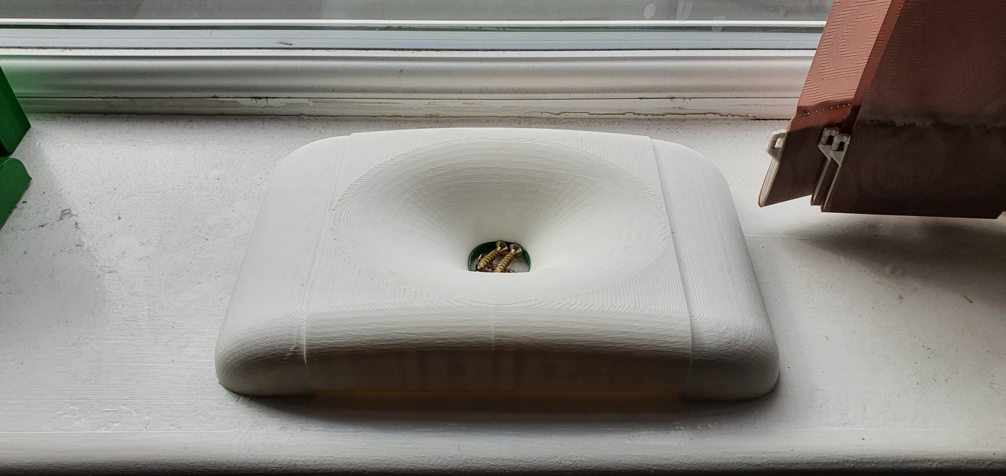

Are the .stl files for these waveguides available somewhere? On the soma sonus website, I could only find 6.5" waveguide with a circular mouth. I would really appreciate getting my hands on them!

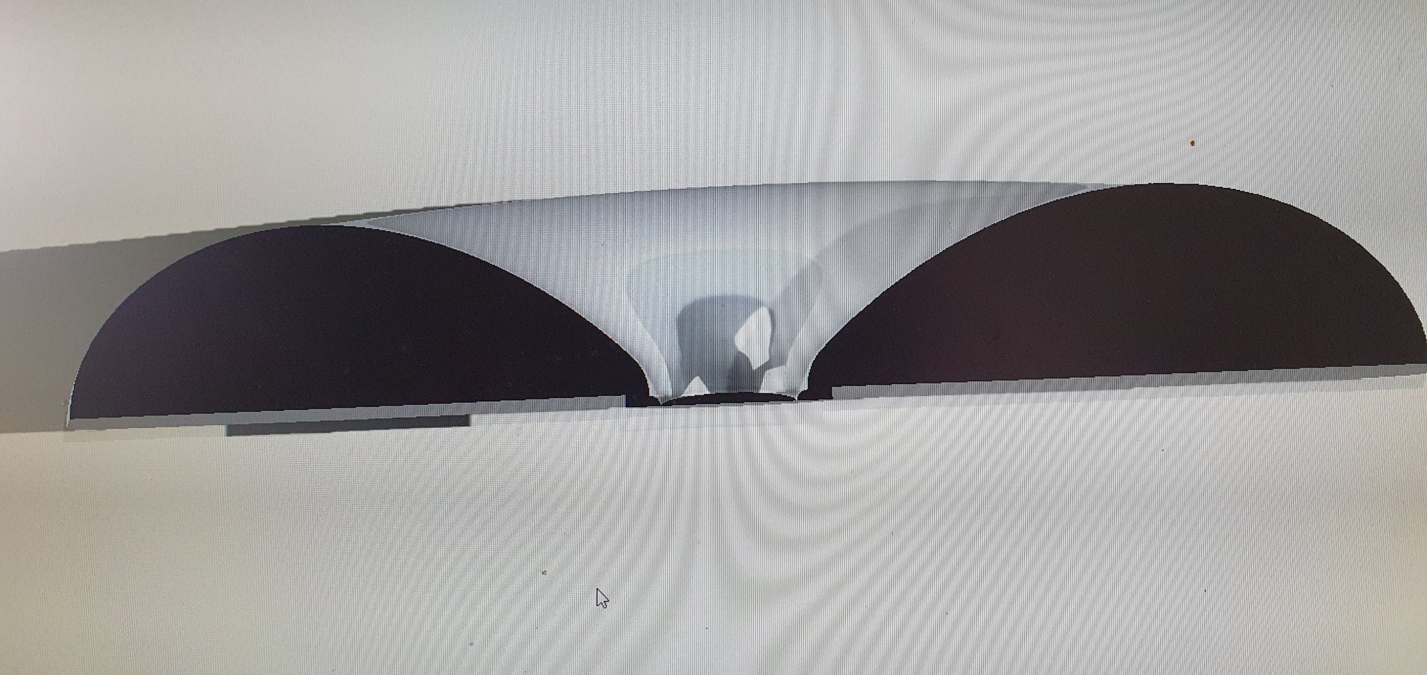

I've revisited circular waveguides for the SB26CDC, to see if I improve upon early attempts with what I've learned since then. Since the SB26CDC models well in ABEC, I did investigate circular waveguides with both my constant radius contour, and an OS-SE contour. None of them improved on the elliptical designs I already had, and I think the following measurements validate that.
Asking for the .stl files for the smaller circular sbc26 waveguides for one last time, before I go ahead and print out the 6.5" inch one.
My situation is that I can only book the library's printer for 8 hours at a time, and that means that with the 6.5" waveguide I will have to use very low fill density. I would much rather do a smaller guide and print it with higher fill / quality. The elliptical ones are, aesthetically, very unpleasing to me. It just can't be helped. And routing will be tough, while I already have a set up to do circular routing easily.
By the way, The 6.5" inch guide measures 190.5mm in the printing software once I scale it to mm (2540% uniform scaling). This seems rather big for 6.5, and by diameter, the mounting hole is more similar with 7.5-8 inch bass-mid drivers. Did I mess up something, or are the guides just classified a little differently?

Time for an update! I've landed on some good designs for the Satori and Scanspeak tweeters, and hope to have the .stl/.stp files uploaded to my website by the end of the week. Now I can scale the design up to 8" and down to 4" for those tweeters.
I won't post all the variants, but I tried different diameter phase shields, and tried using a hole in the middle of the phase shield. I also played with shape of the profile near the throat, since that has a huge effect.

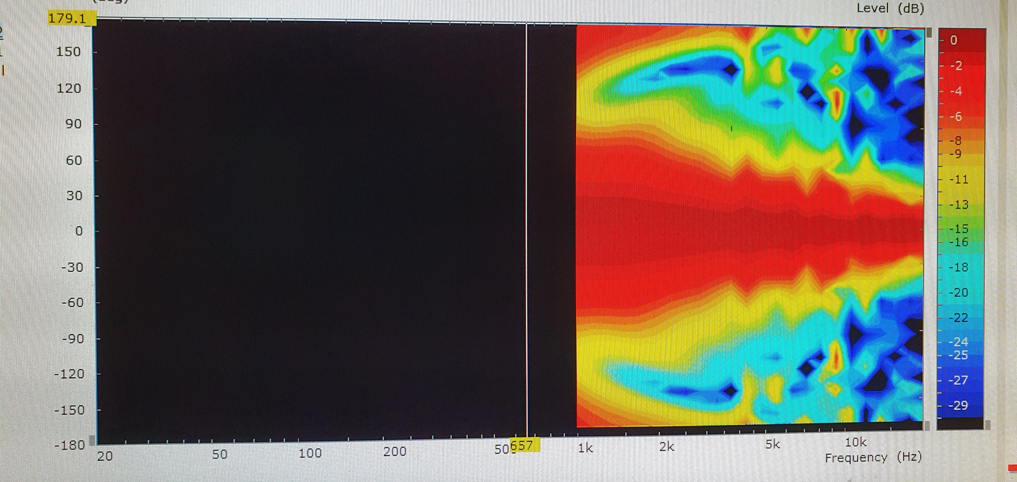

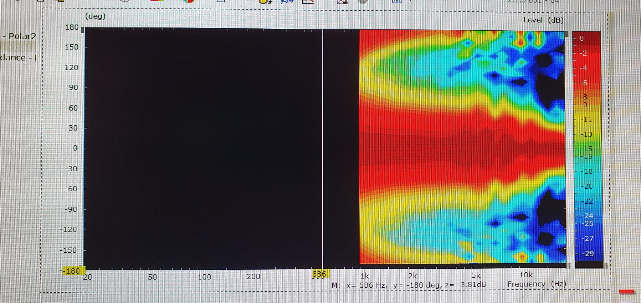

Here are the Scanspeak 6640 results:

Promising results on the SB26ADC. I may have to give that one another look. The phase shield appears to not make that much difference, which indicates not alot of the upper HF is reaching the tip of the done due to higher internal damping. That may be a good thing.
