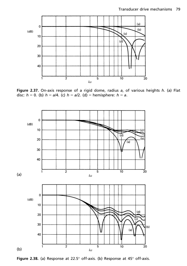

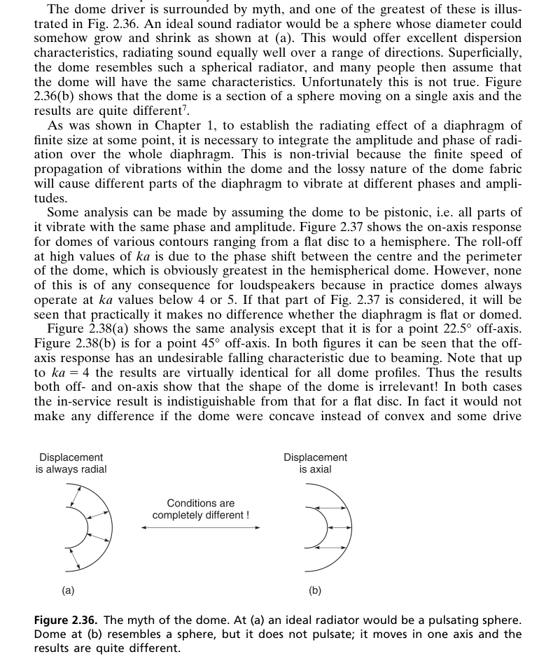

The theoretical ideal is a flat disk, since it moves along a single dimension rather than expanding like a balloon. A flat disk is also ideal for a 0° OS expansion.Building on this, what is the optimal shape of the dome for direct coupling to the throat?
@DSP_Geek
That's true, this is well described in Borwick's Loudspeaker Handbook (there are others, but this is one I have quick acces too atm). Page 78, 3rd edition.
However, I wonder if that really matters for a waveguide?
The dome material basically only effects resonances as well as frequency response.
Although there are other tricks to get that right. (with all of them having advantages and disadvantages)
Everything before the first material resonance is just pistonic region.
For softdomes, this can be a little less well determined sometimes.
(which can also be seen as an advantage at the same time)
Borwick glances over that part a bit, but Eargle describes those things very well in his Loudspeaker Handbook.
