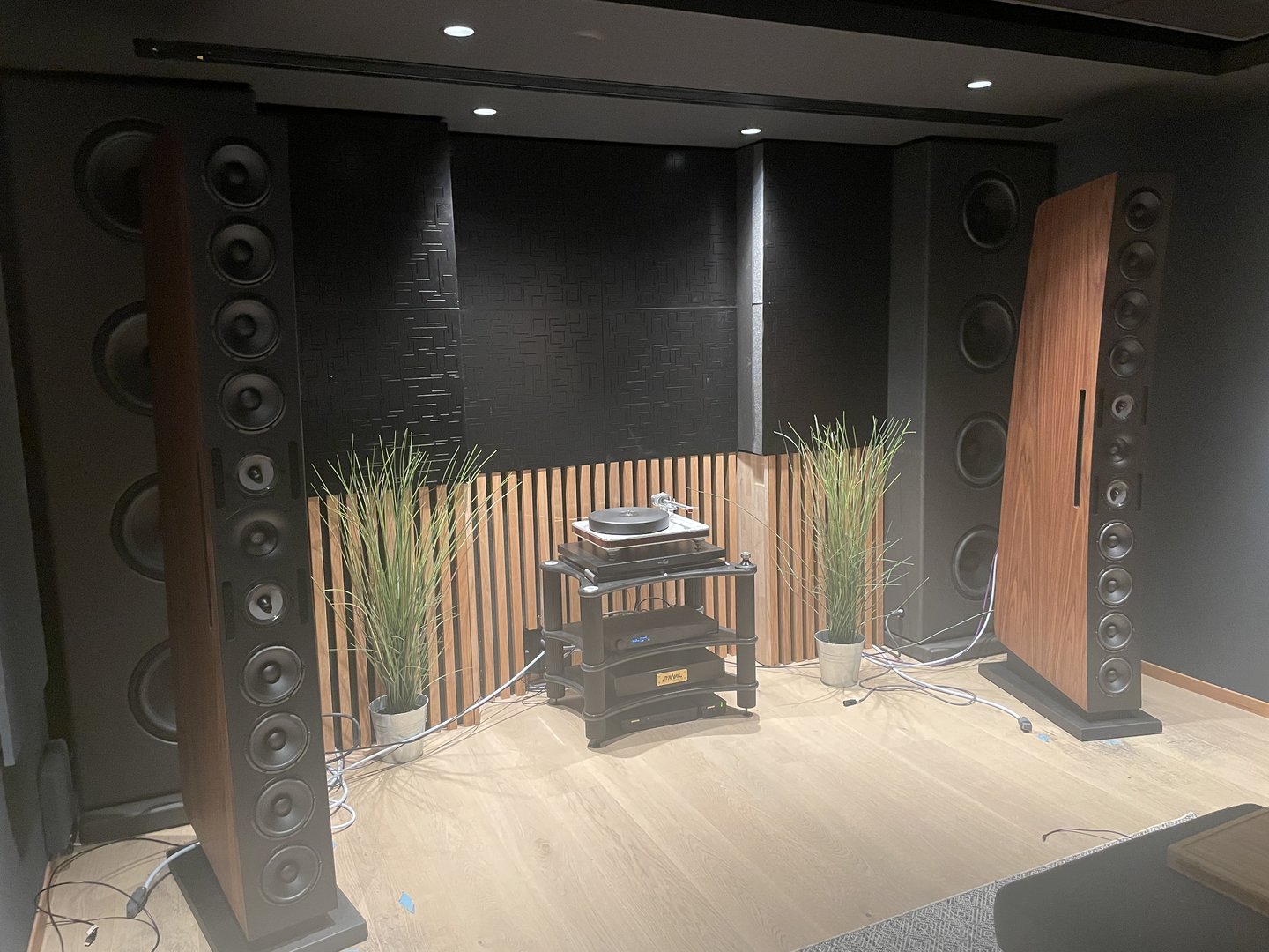

The modified Bliesma t34b waveguide in wwww-m-t-m-wwww cardioide & CB config. (Seas L16RNX3 and W12CY006)
Hypex FA 503 i rear baffle. Woofer towers are 12" Sc.Speak. (4.e.a.)
Built by Overn Design, Norway and developed by member Snickers-is here.

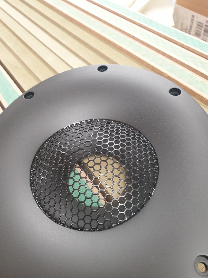

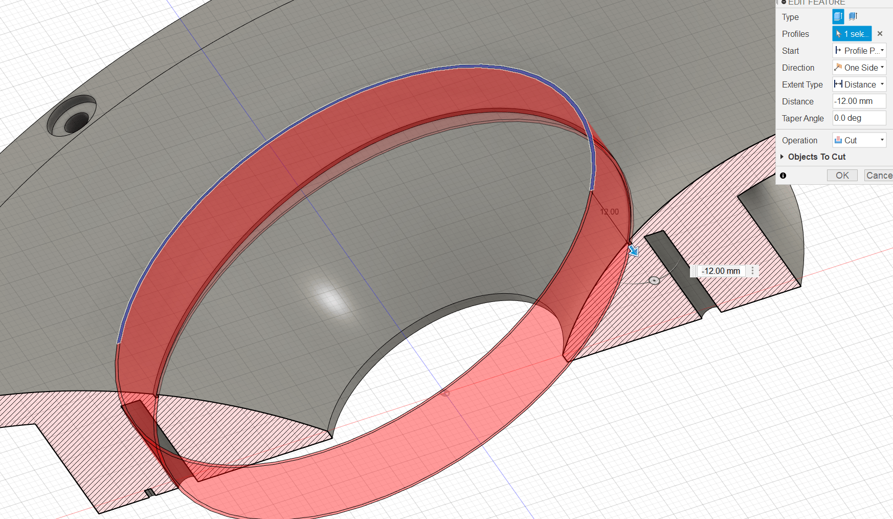

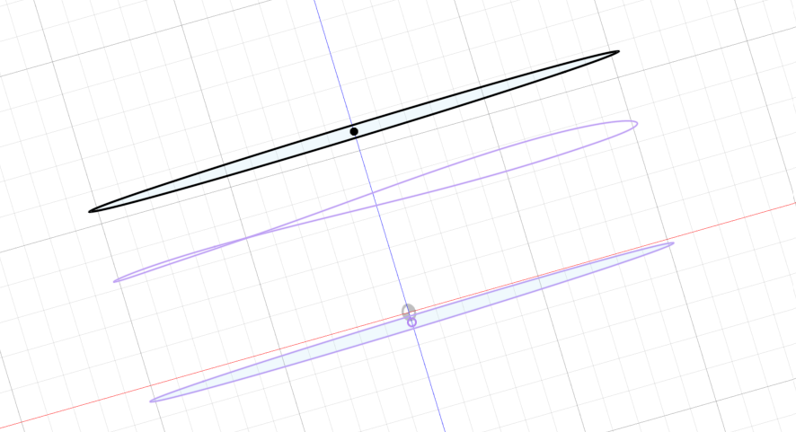

Ahhh very cool. Is the process of adding the groove easy to describe here? I'd be interested in trying in Fusion360 to add one to the elliptical 6.5"

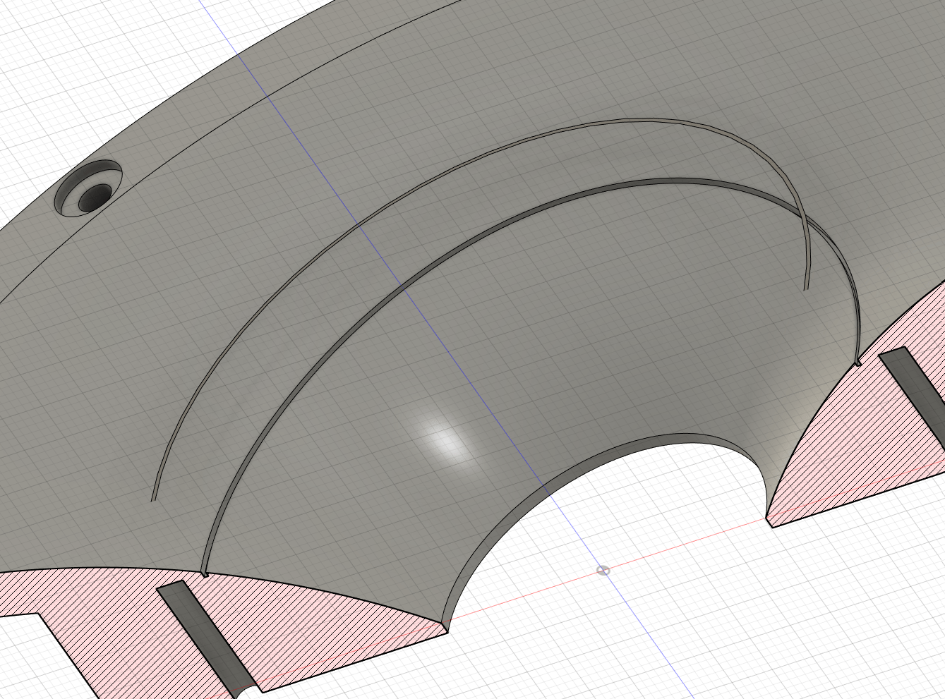

Here is one way. Sketch two circles to represent the inside and outside of the groove on an offset plane above or at the top of the waveguide. Create a patch of the area between the two. Use that patch to extrude cut into the waveguide. You can see in these images what @wilbur-x is describing where the cut goes deeper into the vertical due to the steeper wall angle.
You can make it the same depth all the way round but that is more complicated.

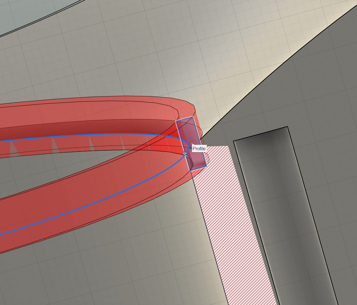

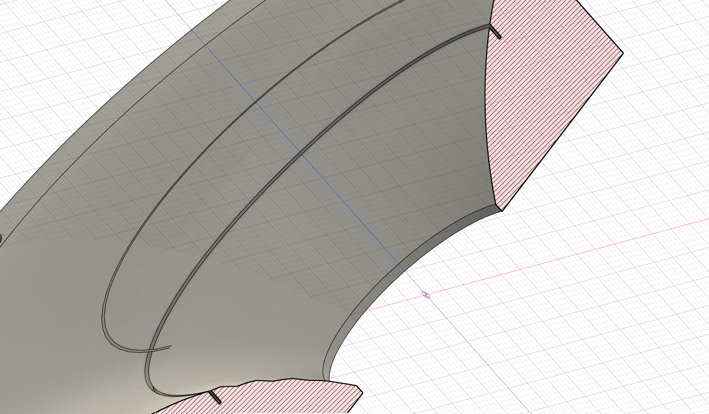

To do that you can split the waveguide body with the inner ring. Project the edge of that to use as a path. Create the groove shape you want as a sketch profile and sweep cut it around the path (make sure it intersects the projected path). That way it is the same all the way round.
