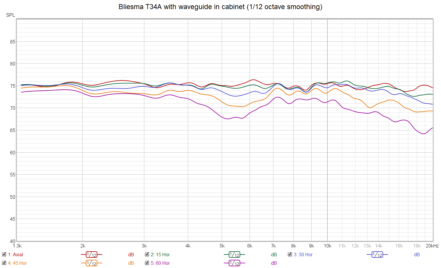

Measurements are made with the driver and waveguide in the cabinet. Measured at a distance of 60cm. A few DSP filters were applied to get a reasonably flat response.
I'm not really sure what to conclude from the measurements. The waveguide seems to do something up to 5k hz. But after that it narrows again. At 20k hz there is only 9 db difference between on-axis and 60 degrees. That seems similar to HifiCompass' measurements of the T34A driver without waveguide.
And how much of it could be caused by diffraction?

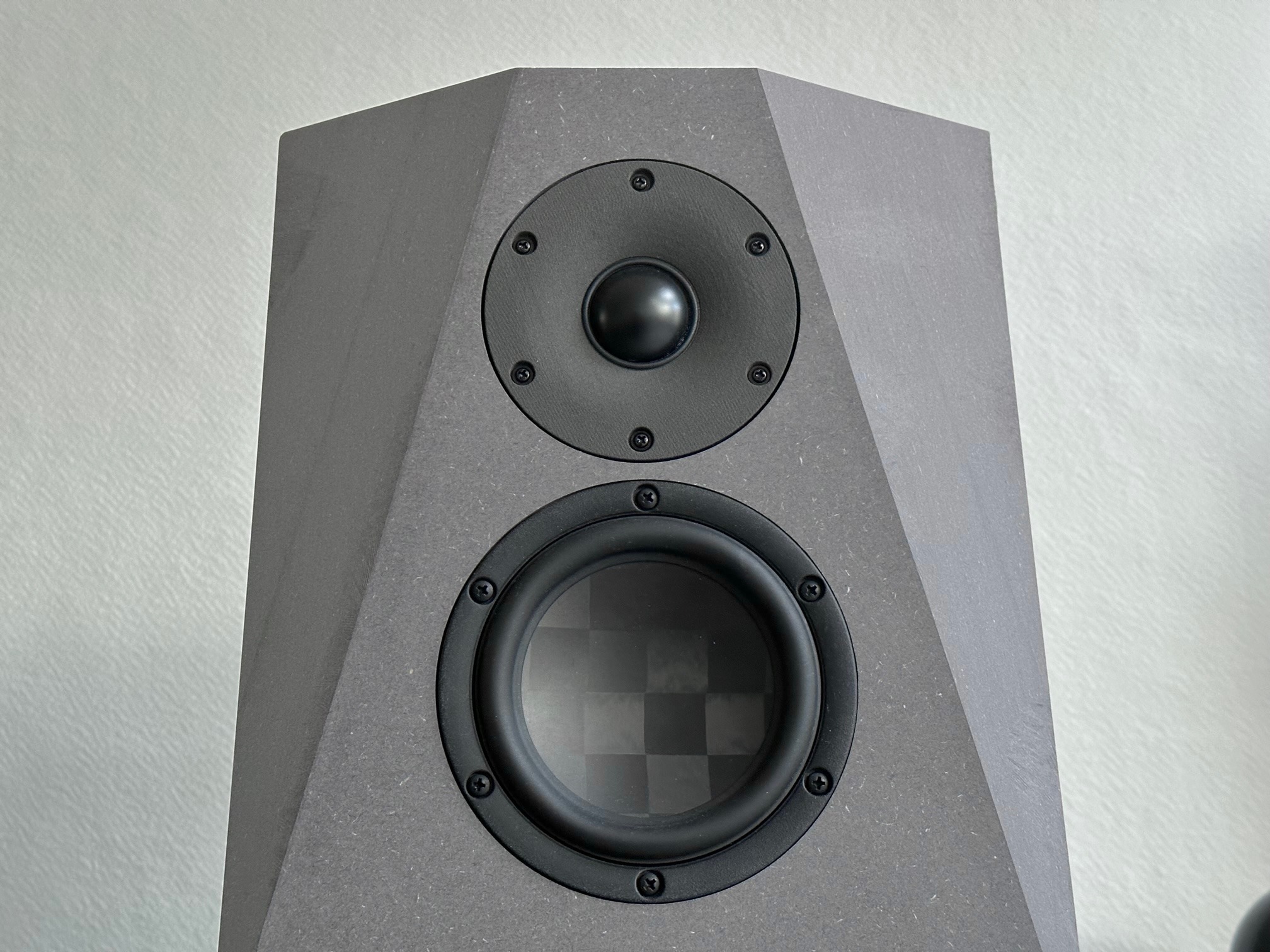

That looks very nice 🙂This is how the baffle of the (unfinished) cabinet looks like:

The irregularity around 5-6kHz might be caused by the chamfering edge of my cabinet. That edge is at a distance of approx 6cm / 5,7kHz wavelength from the dome. I did apply a filter in DSP to reduce the on-axis hump there. So in the measurements it seems that the waveguide does something strange. But that probably is not the case at all.There is nothing in the driver or waveguide to cause a localised cancellation increasing as you go off axis.
The crossover cannot be the cause of the irregularity because it has been disabled for the measurements.
I have no measurements of the tweeter in the cabinet without the waveguide yet. But I certainly expect the waveguide to be a significant improvement!

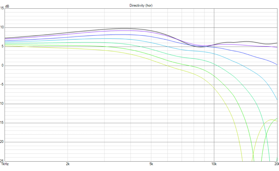

That narrowing of the directivity would bring a pleasant drop in the sound power right in the sibilance reigon. Still very wide dispersion speaker. Careful crossing to the mid will make one heck of a BMR competitor.These are my initial measurements of the Bliesma T34A tweeter with @fluid 's shallow waveguide in my new 3-way.
No measurements, but simulations of a bare dome and with the waveguide (both in an infinite baffle to remove any baffle effects)Thanks! Do you have measurement results of the Bliesma dome without and with the waveguide under the same conditions?

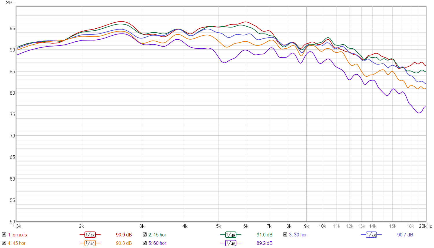

This is a measurement without filters, from 1m distance:Do you have a measurement without the filter?
It is a complete cabinet, with all drivers mounted, bracing and damping applied already. The baffle is 26.4cm wide, chamfers are 30 degrees and have a minimal distance of 8mm from the waveguide. Distance from top of the waveguide to top of the baffle is 3.2cm.Is it just a baffle or a complete cabinet?
That makes things much clearer, the filter you applied was the cause of the off axis response issue.
The real culprit is some diffraction around 7 to 10K causing the on axis and 15 degree traces to be at virtually the same level as the 30 degree trace. This is not something that can be equalized for very easily, boosting the on axis will cause a peak off axis in the same way as cutting on axis before pronounced an off axis dip.
The general trend follows the green line and this is the slope I would equalize to flatten the design axis.
The small blue arrow shows there is a slight off axis depression that moves in frequency, this is also nothing that can be equalized successfully.
Any filter used to flatten the design axis response that makes the off axis responses worse should be avoided, particularly if the design axis is 0 degrees as this will suffer the greatest level of diffraction effects than any other.
As an example the kind of things that will take to EQ are the hump at 2.7K and the peak at 10.5K.

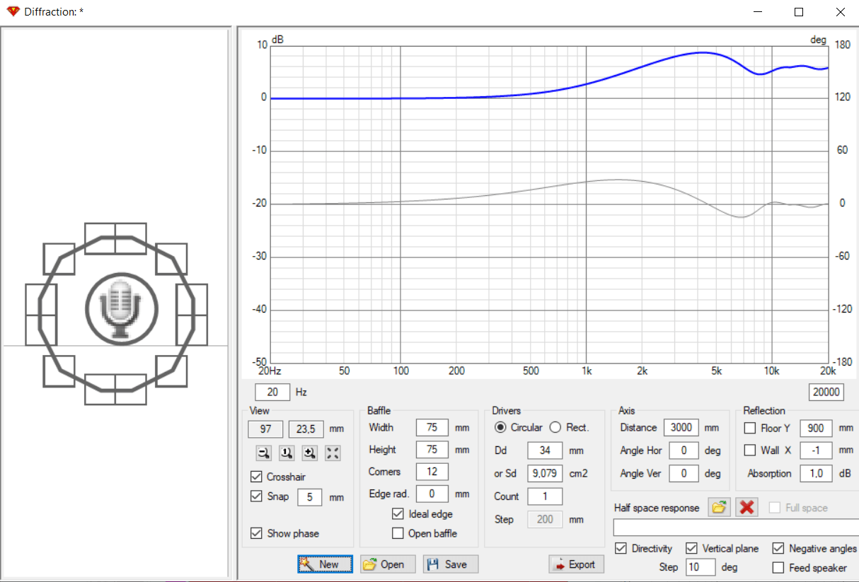

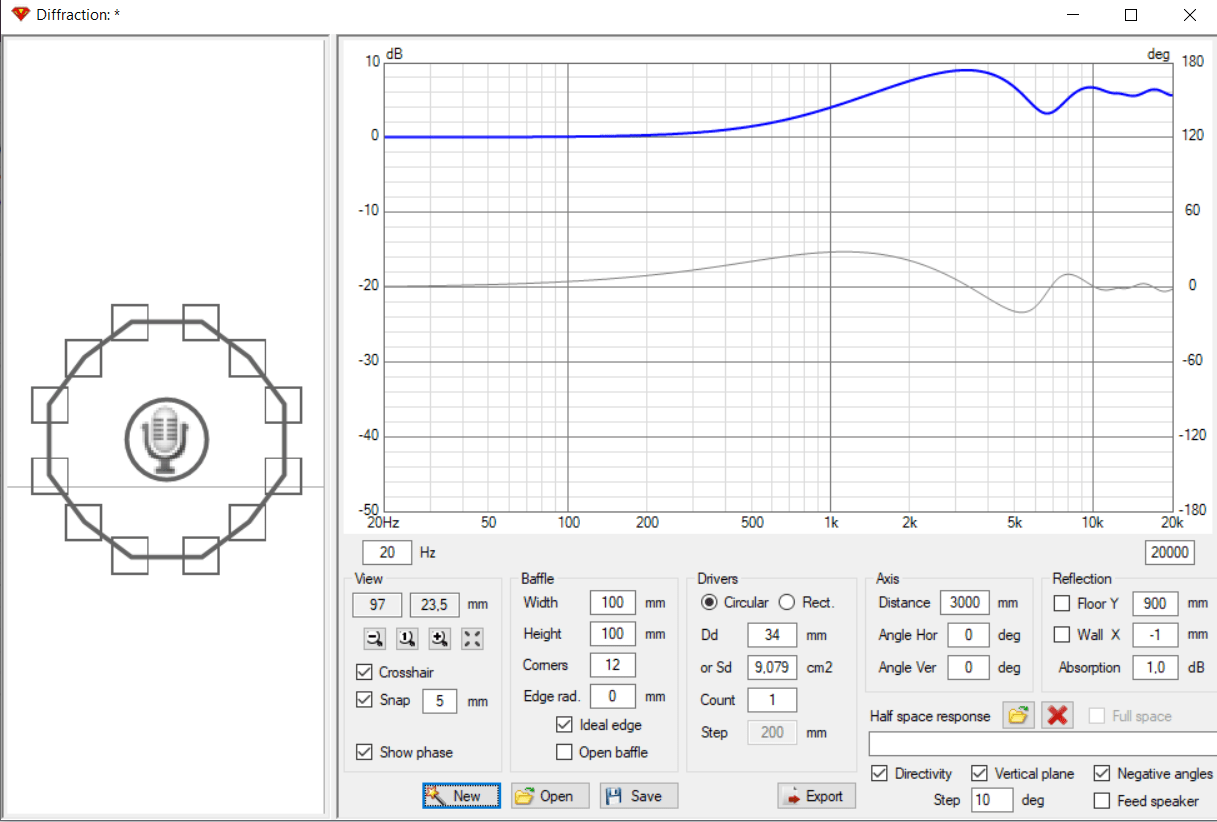

If its diffraction related we can try estimate it with diffraction tool. Trying to replicate the "bundling" around 7-10kHz, worst case scenario round baffle with ideal flat 34mm source in the middle, it looks like about 75mm diameter "edge" or feature that makes diffraction would make similar bundling.
If features in the measurement are due to diffraction it seems some feature in the build about ~75mm in diameter (or ~40mm from the center of the tweeter) that makes features in the measured response, perhaps the small gap between waveguide and baffle? If the waveguide bigger like 100mm in diameter then the gap would make the response charasteristics somewhat lower in frequency instead and its probably something else.
100mm round edge makes feature bit lower in frequency, on-axis dip around 6-7kHz.
Speculating that edge making diffraction needs to be closer than this, trying 75mm seems to lineup with measured response, on-axis dip ~8-9kHz:
