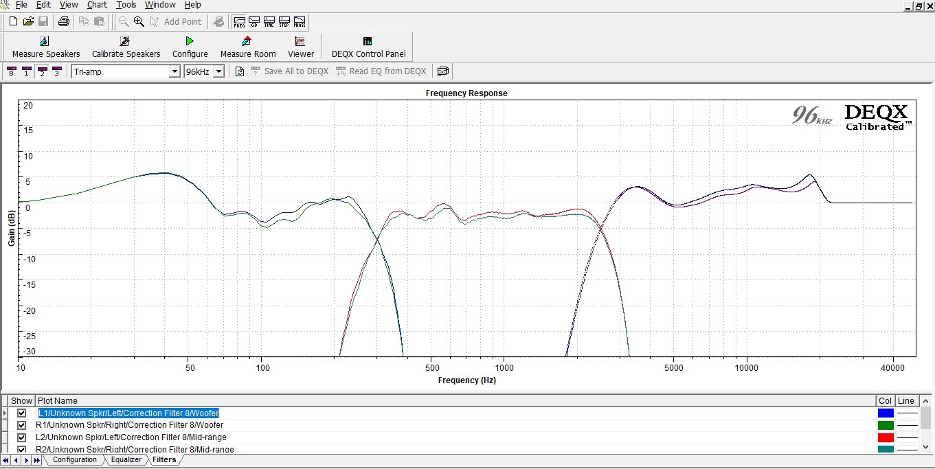

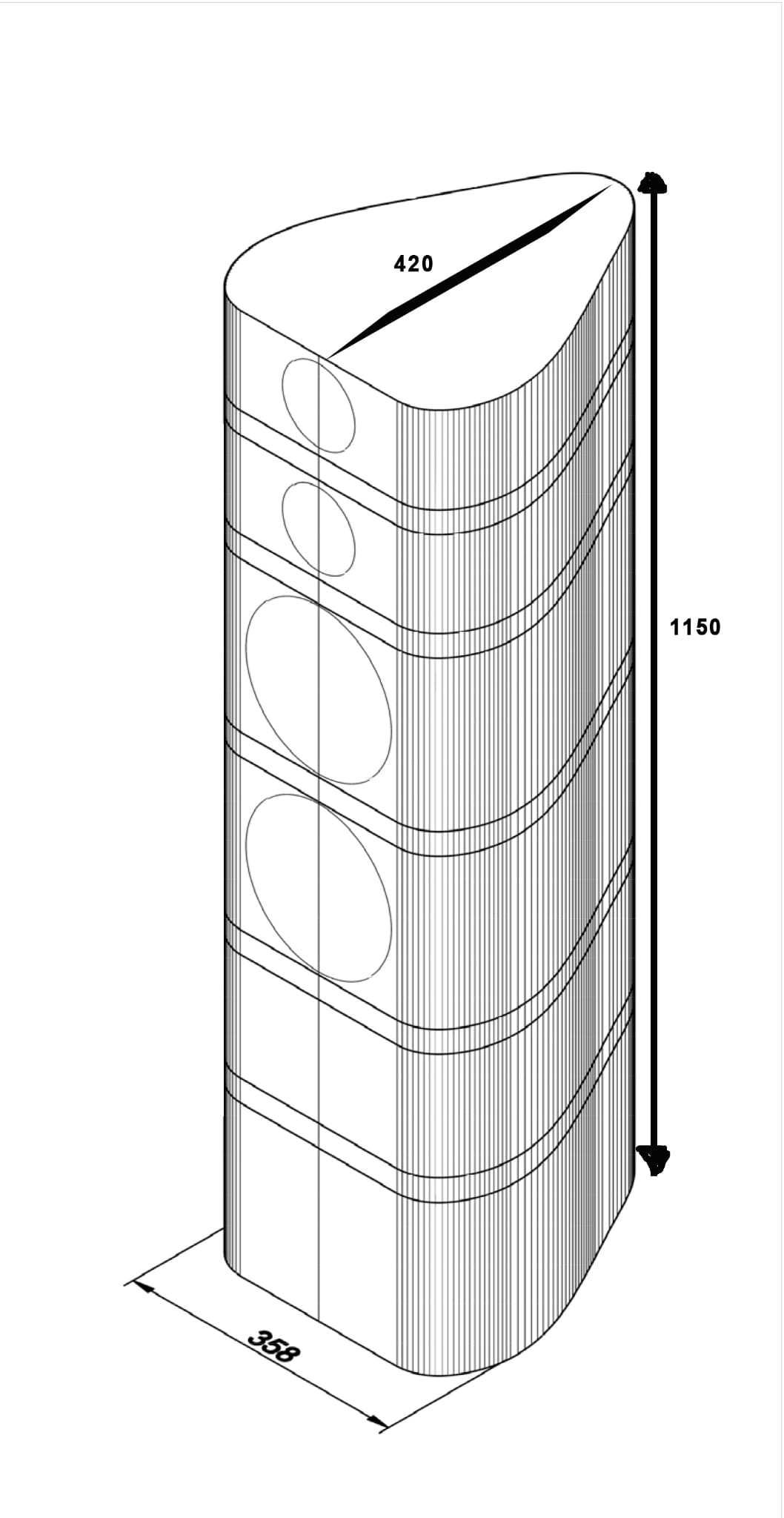

I'm planning a 3-way project with two SS 18WU/8741T00 woofers in parallel, the SS 12MU/4731T00 midrange and the Bliesma T25B-6 tweeter (I´ve attached a picture of the project). It will be an active system and I´ll use the DEQX HDP4 as a pre/crossover, so the phase problems should be resolved because this device achieves the time alignment between drivers. So my question for those of you with experience with the Bliesma T25B-6 is if you would recommend using a waveguide, or do you think it is not necessary. If you recommend a waveguide, I would appreciate it if you could tell me which of the multiple models made for 3D (I´ve seen some nice WG by Augerpro, Soma Sonus, Hificompass,...) is the one that has reported the best results for the T25B-6, or better asked, which WG do you think would match in the best way to this system?. Thank you very much for your opinions.

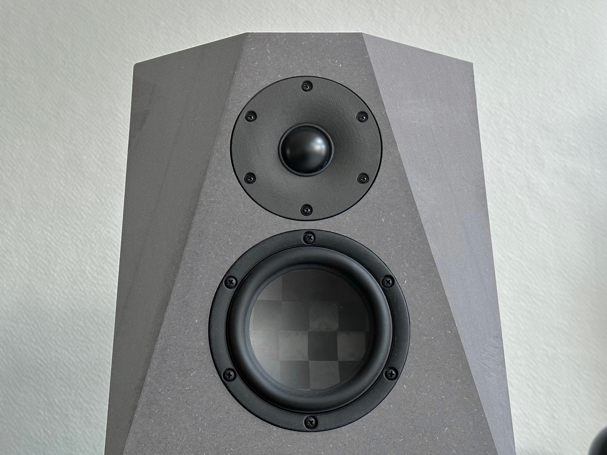

If I used a non-waveguided tweeter, it would be in a cabinet similar to yours with the big round corners. That said, a waveguide will make your life easier when developing a crossover for sure. I think my 5" might be a bit too deep for perfect time alignment (I still need to verify these AC depths). But I recently designed a 4" that is intended to to match to the MW13TX for a center channel. You can try it out but I warn you I haven't measured it yet, it might not perform as well as all the others I've done for the T25B. You should measure it first before you route holes in a beautiful cabinet.
One question I have is do you have the skills to design the crossover? Would be a shame to spend all that money on great drivers and have subpar performance if you don't know how to do the most important part. I only ask, because when I see someone mention using an active XO, it's usually because they know nothing about design and mistakenly believe that going active will solve their lack of skills.
Some details on intended crossover points might help.
Thank you very much for your answer, augerpro.
Actually I am not an expert in the design of passive crossovers, that facet is done by my partner in the project. However, I do consider that I have mastered the functionalities of the DEQX, which seems to me to be one of the most advanced digital filters nowadays. We've even experimented with 2-way loudspeakers alternating passive designs with premium components with the DEQX's active filtering, and the DEQX's performance has often come out on top. What I stand out the most about its use is the possibility of solving the problem of time alignment of the drivers at the stroke of a pen, which is usually a headache in the design of passive crossovers. The plan is to cut at 300Hz/2500Hz with a slope of 96dB/octave (I´ve attached a simulation image)

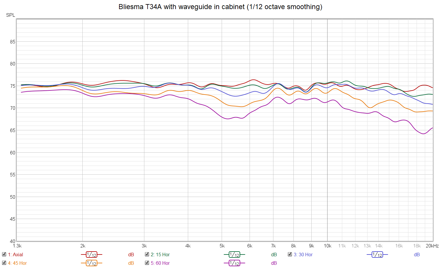

These are my initial measurements of the Bliesma T34A tweeter with @fluid 's shallow waveguide in my new 3-way.
Measurements are made with the driver and waveguide in the cabinet. Measured at a distance of 60cm. A few DSP filters were applied to get a reasonably flat response.
I'm not really sure what to conclude from the measurements. The waveguide seems to do something up to 5k hz. But after that it narrows again. At 20k hz there is only 9 db difference between on-axis and 60 degrees. That seems similar to HifiCompass' measurements of the T34A driver without waveguide.

That waveguide seems very shallow, almost like a flat tweeter faceplate and the diameter is small too, so it's not surprisung it doesn't do much. Imo the response we see is highly affected by the speaker baffle.
What's the crossover point and slope?
Crossover point I have in mind is 1,3k hz with a 24db slope. The MW13TX mid has a wide dispersion until at least 1,3k to 1,5k hz.
