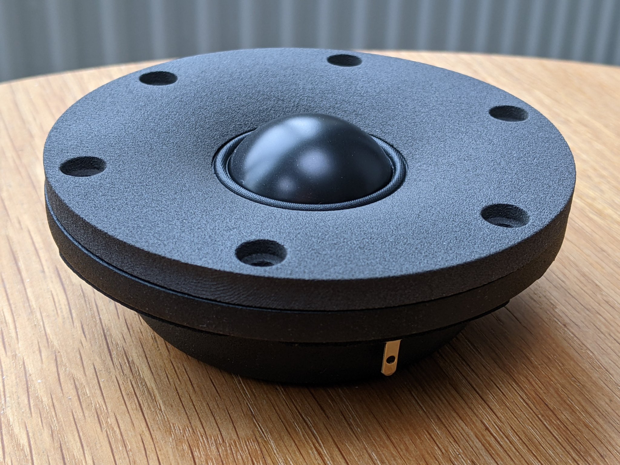

The waveguides as designed by @fluid arrived from the printer today. They look great and the fit is perfect with the T34A's!

They look really nice and it seems like I didn't screw anything up 🙂The waveguides as designed by @fluid arrived from the printer today. They look great and the fit is perfect with the T34A's!
That would be great, it is always nice to see a real comparison to the simulated one.As soon as the cabinet is ready, I will post my listening impressions and measurements.

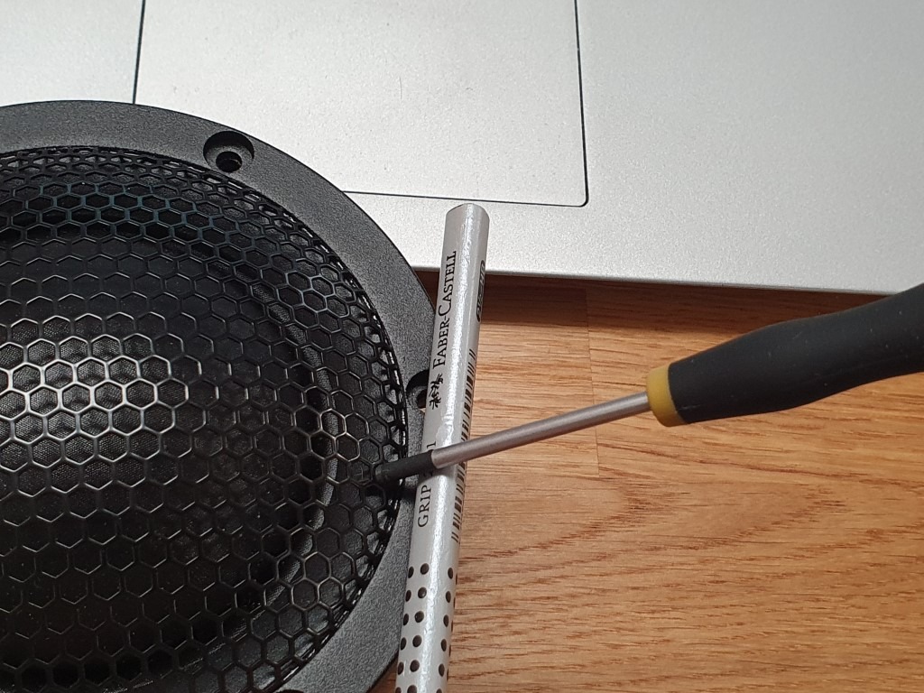

Following with interest. How hard was it to get the grille off without damaging the dome? Looks like a really nice fit. One of the benefits of sintering-style printing, I guess. My printer can get accurate results too... on the 8th try. 😀The waveguides as designed by @fluid arrived from the printer today. They look great and the fit is perfect with the T34A's!

Not so hard. I've followed the instructions from others. Mount the tweeter on a large piece of wood. With a heatgun on 80 degrees celsius the glue becomes soft quickly. Then you can gradually remove the grille. Use wooden sticks only. Be very careful with metal tools because of the driver's powerful magnet.How hard was it to get the grille off without damaging the dome?
80° is already a lot - there is also the glue for the surround in this area which we don't want to get weak.
I always remove the grid of the T25s just with force - works fine. Schould also work for the bigger ones, had a look at the M74 but will not remove the grid completely for now, just lifted one "edge" easy.
According to Stanislav 100 degrees for 5 minutes is no issue but 120 degrees for more than 30 mins can cause demagnetization.80° is already a lot - there is also the glue for the surround in this area which we don't want to get weak.
Hificompass used a copper foil heat shield to concentrate the heat only at the grid glue line which seems like a reasonable option particularly if you don't have a low temperature heat gun.
That's good to know - cause I plan to route the front plate of the M74 and it will get hot.According to Stanislav 100 degrees for 5 minutes is no issue but 120 degrees for more than 30 mins can cause demagnetization.
My methode is easy, save and quick but hey, useing a heat gun is always fun. 🤓
