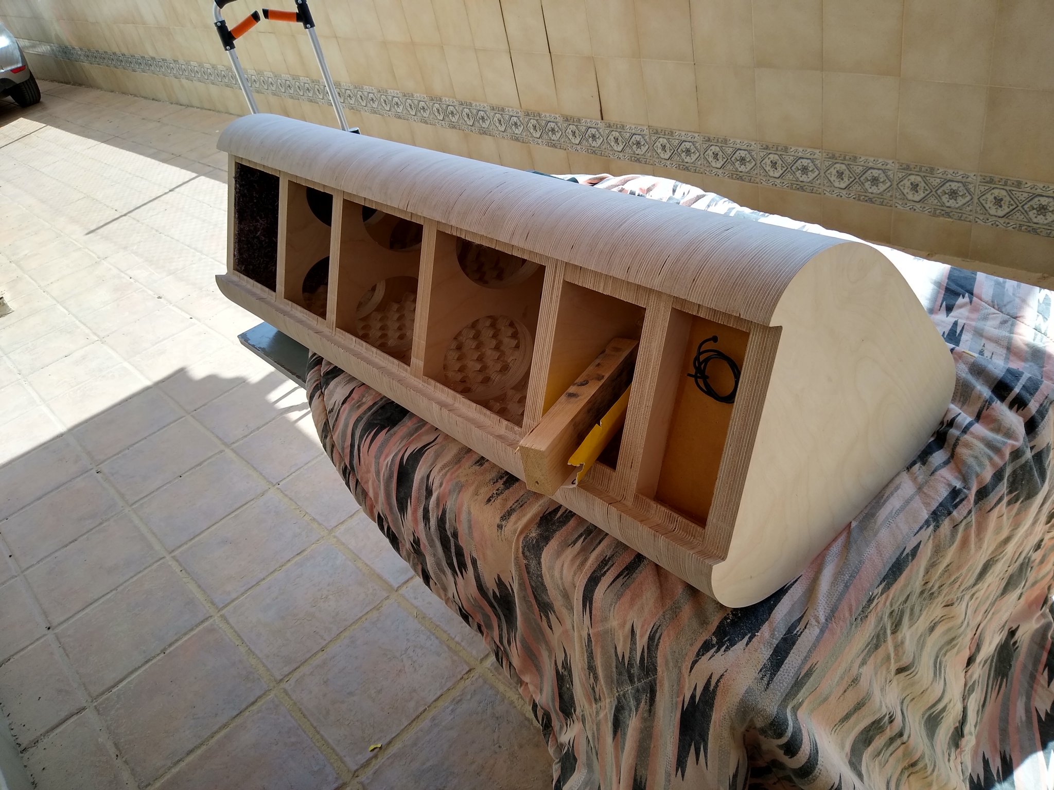

Meanwhile I keep working in progress with the cabinet:

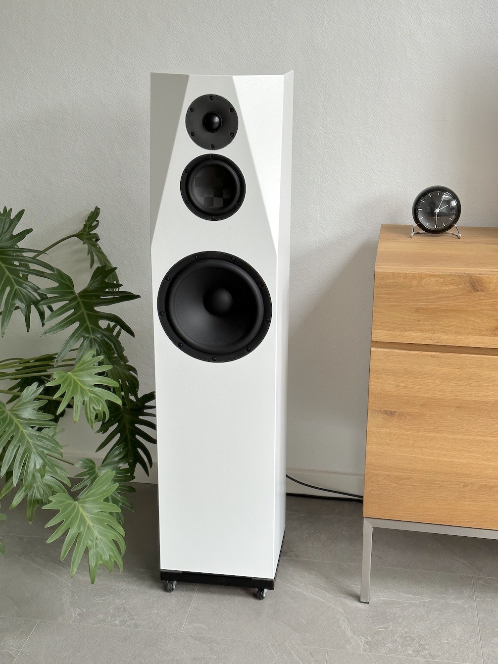

My idea about crossing at 1,3kHz was/is that there is a better match with the center-to-center distance of the woofer and tweeter. Crossing higher, where wavelength is shorter, might be detrimental on that aspect. And at 1,3kHz the directivities already match perfectly (as they indeed still do at 2,2kHz).
Manufacturer Bliesma lists in their documentation that the T34A can be crossed over at 1,3kHz.
My cabinets are ready now. I will try out both the 1,3kHz and 2,0kHz crossover points. Very curious about the difference in sound!
Oh yes.... please try it out. My words are not law, and learning what you personally like, is best discovered by trying it out yourself 👍I agree that the response of the 5" Textreme is very good.
Your WG is also way smaller than the 5" I use. Which might result in your cabinet/baffle having way more influence on the final acoustical result. Therefore, my approach might not help with your design. But again.... I will happily look forward to your measurements 🤓
This morning I have tried out different crossover frequencies.Oh yes.... please try it out. My words are not law, and learning what you personally like, is best discovered by trying it out yourself 👍
2kHz sounds quite awful. Probably because of cancelations and phase issues. I didn't try crossover types other than 24db however.
2,2kHz sounds a lot better. No cancelations at my listening distance of ~4 meters.
1,3kHz sounds even better. Highs are more detailed and sparkling. I like it a lot with classical and chamber music.
Comparing 1,3kHz and 2,2kHz, I think I mainly hear the differences in character between the drivers. The M13TX is detailed but slightly mellow. The T34A is extremely detailed and sparkling.
The finished cabinet, on wheels for now 🙂:

Nice looking speakers 👍 But the shallow WG surely makes everything a different beast, than Augerpro's options. Maybe the wider dispersion is just what you like - and that is totally fair 😊This morning I have tried out different crossover frequencies.
