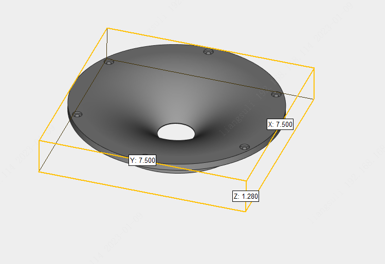

As I am too mke print a 10" wave guide foe a 1" CD, I also sent your stl file of the round 6.5" sb26 WG (as I am pretty too much a beginner to try the other shape) to mate with a 6" to 7" midrange for a try with the SB26ADC. The guy at JLPCB (I told them to convert x2.54 to have the centimeters) showed me a 7.5" diameter WG . Is it correct or should it be netto 6.5" width, please ? I will order in ABS !
Is the 7.5" diameter of the mouth correct, please ?

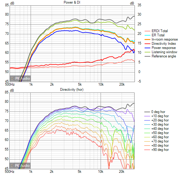

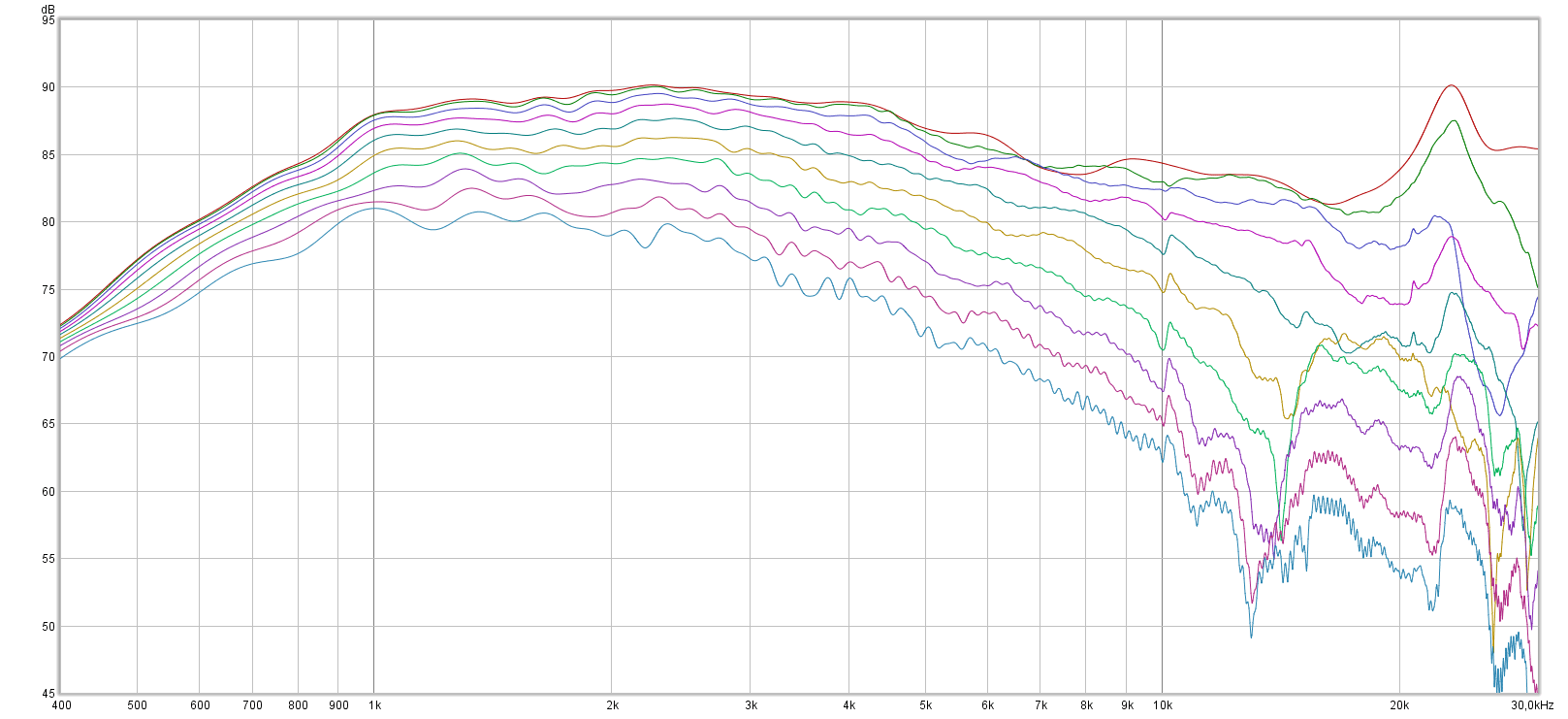

TXN in Jantzen WG does not look bad at all 😉
Measured in 2way cabinet, with 20mm facets.
total diameter with mounting flange is 7.28". There is also a 6" that is 6.78" wide that works well with 6-7" drivers.
ABS is alright if you don't have access to SLS nylon or MJF processes. I would print in those if you can.
Thanks, I am talking of the round one in 6.5"... seems the stl. shows 7.5" according JLPCB. They have not converted in cm yet. See the picture they sent.
Is that the good stl file, took it from your site in the 6.5 round WG SB26 section. Has anyone printed it at Diya, please and can help ?
