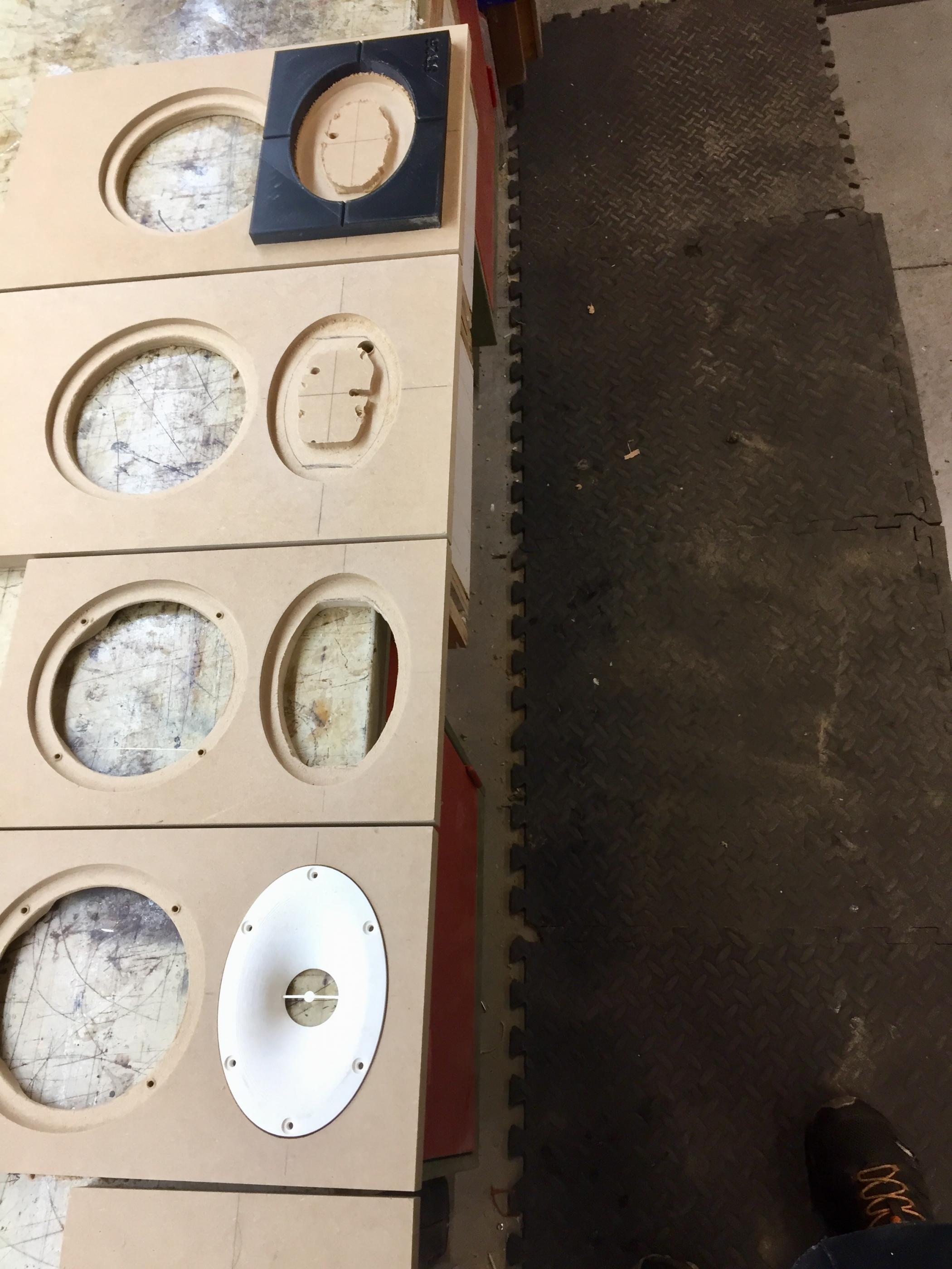

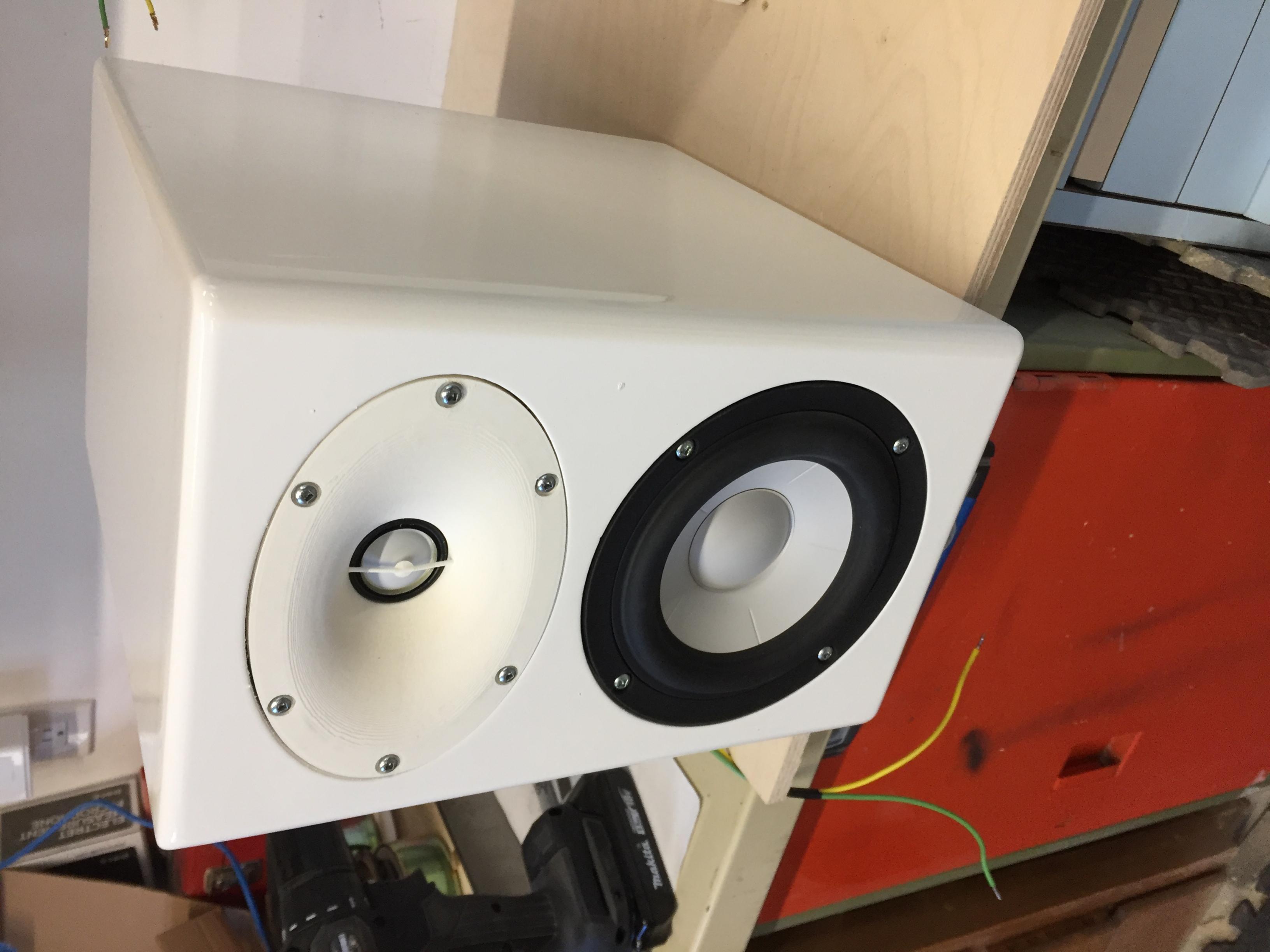

I recently completed a SB15CAC30-04 and SB26CDC two-way for my son using the 5” waveguide design that was printed by my other son in matte white. He wanted a small speaker with the “all-white” designer look and the SB15CAC30-04 modelled the “smallest” cabinet of the candidate midwoofers. See picture below.
I’m very happy with the sound of these. Crossover is about 2500 Hz. This was my first design with a waveguide and I plan to do more. Happy to share crossover details if anyone is interested.

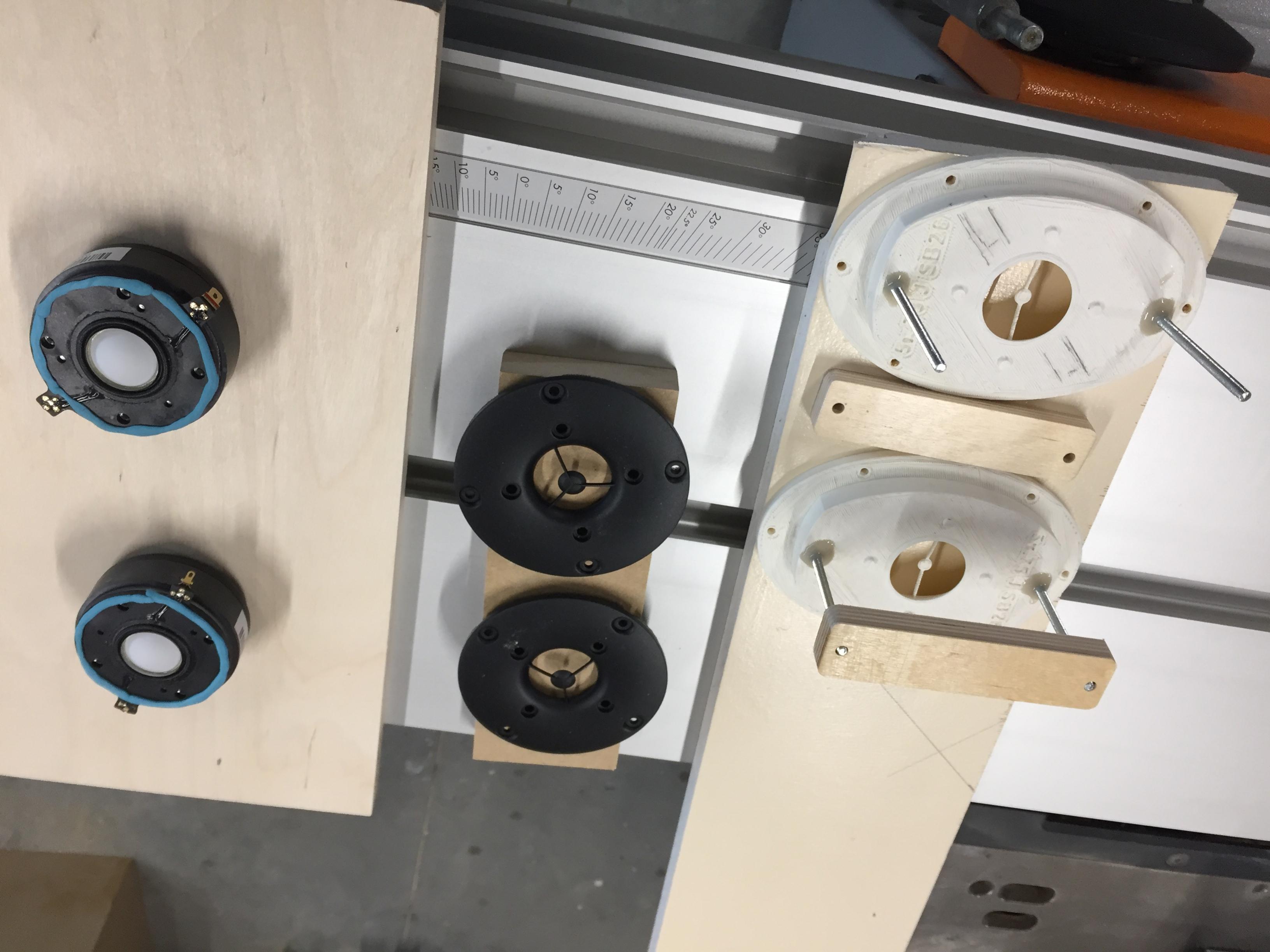

I was able to use the router template generously posted by BearX. I mounted the tweeter to the waveguide using “threaded rod” cut from a machine screw and set with epoxy into the waveguide. Pictures are posted below for anyone who has concerns or questions about how this is done.
Sorry if the picture orientation seems odd - I couldn't sort out how to upload the correct orientation.
Todd

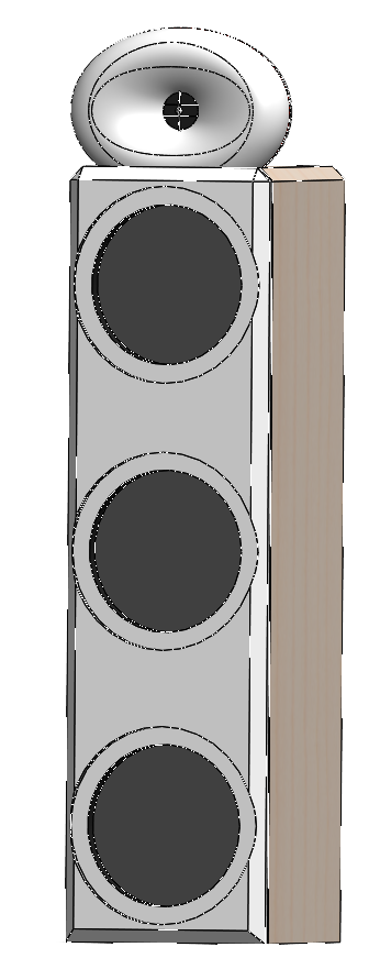

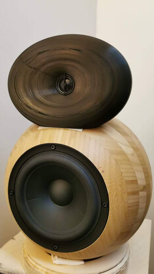

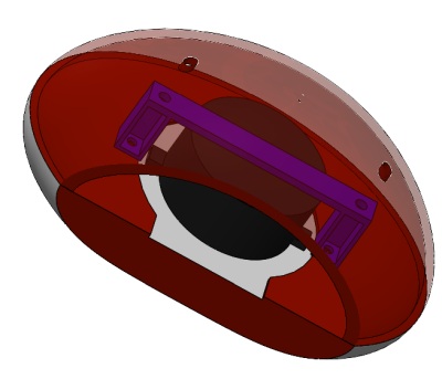

Yes 😀 , attached the next one lol, finally we do a plain front, tweeter fixation rotate 45° for be able to plug/unplug when tweeter is mounted, printed tweeter fixation larger than existing one, rear hole for pass Allen key...
glue in one piece then surface treatment + painting for both of us.
For me SB26ADC + Sica 6.5 H 2 CP + doble passive SB16PFCR-00

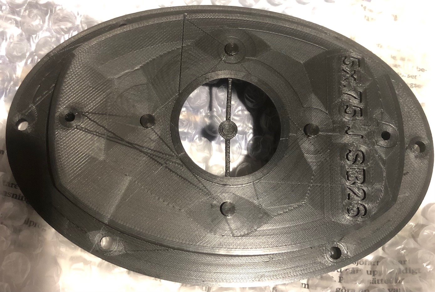

5" SB26 w/SP.st
Hi I´m new about waveguides and 3d printings and think it´s a fantastic way to get a waveguide and I did send the file 5" SB26 w/SP.stl to a company in Sweden where I live and they said
"The file you sent seems to be on the wrong scale as it is about 5.8mm x
3.88mm x 0.83mm large"
Can anyone tell me about the waveguide exact dimension so they can change the scaling or do you have any other suggestions?
I would like to have suggestions about preferable materials for the waveguide
and if I shall use with or without the PS.
I have the aluminum tweeter SB26ADC-C000-4.

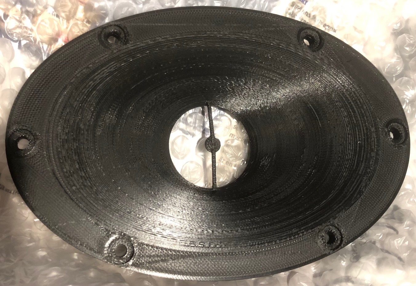

Now I got my waveguides
I decided to choose a PLA print.
Now I have to decide if and how I
should do with the surface and in that case how I should smooth it.
Don’t know how much the unsmooth surface are affekting the sound.

I compared a SLS nylon print vs my own PLA print and they measured identically. Neither has a smooth finish, but are different, the PLA has the layers like you have, the SLS nylon has no layers but has sort of a sandpaper feel. I'm currently investigating ABS smoothed with acetone vapor for my box ports since smoothness did impact the performance in my measurements. Might be something to look at for waveguides.
BTW: make sure you use 4 layers for all sides. I can see some infill poking through in some areas.

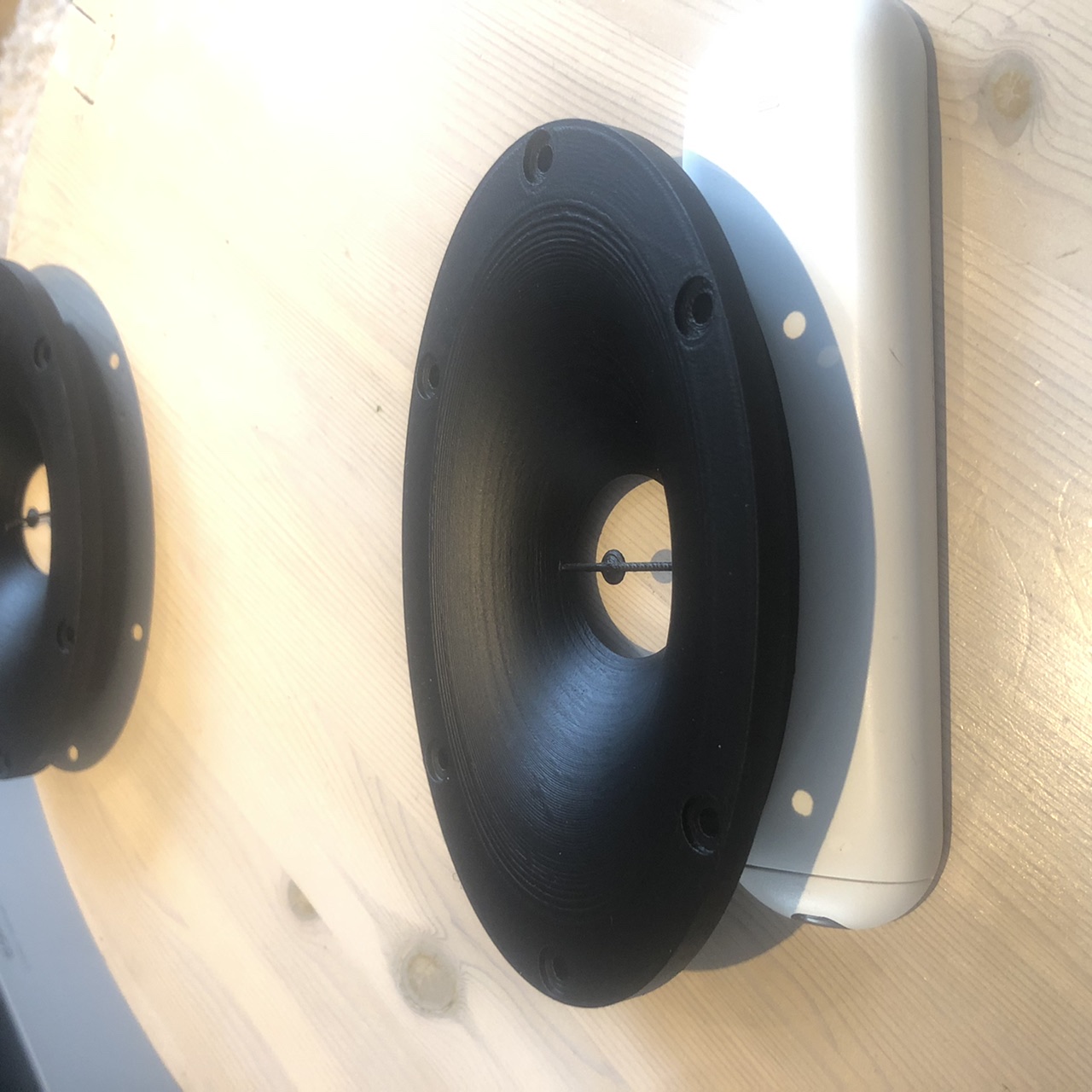

Now i have done some smoothing and painting
and I like it but good to know it’s dont affekt the
sound so much.
