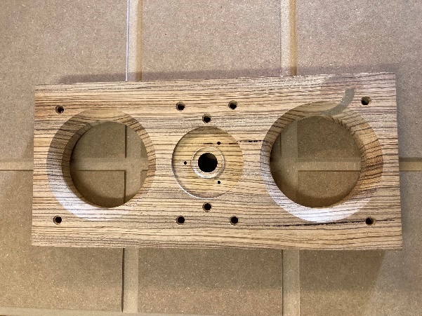

Scan Speak 6600 with dual Scan Speak 15M in a MTM. Waveguide is based on a Dave Pellegrene waveguide.
Solid Zebrano, 210x450x40mm
