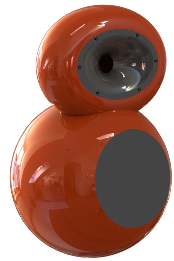

I mean all WG have the Step file without phase plug but no one have the Step version with phase plug.
Assuming you need to use the .step for a CNC, what CNC do you have access to that could mill the phase shield? I don't think it's possible, at least as I have designed it. Would be happy if I were wrong though.
No, I don't thinks it's possible, it's for integrate it in a kind of bulle front plate ,like this one in attachment, at the top.
But I need to merge it (no screws) and 3D printed it in 2 pieces front/rear
At the bottom it's a 6.5" in "Ikea bowl" speakers.
I see. I'll work on that, might be a bit of a wait. What waveguide were you looking at using?

Thanks augerpro, the 6,5" as it for 6.5 drive, for rmatch directivity.
I try some time ago to do a 90° constant wg for tweeters, it need a revel like phase plug (round bubulle and donut) and it at to oppen so fast (for avoir throat reflection) that it became pseudo constant. So I dropped it.
Precision have ro be +/-0.1mm also for the donnut, he is especially hard to find the good size and poisition and will interact with the bubble plug. So I stop for 90° and tweter and prefer to use yours.
I thinks you find the good formula, may be add the donnut, but the position is hard... (Even whit help of simulation)

Yes I don't touch profile, I remove flat part for screws and continue the profile in the reverse direction (and accelerate it a bit) for close the bubulle.
aznovic is a specialist of Ikea bol speakers ^^, he need the bubulle on the top with your WG :)
