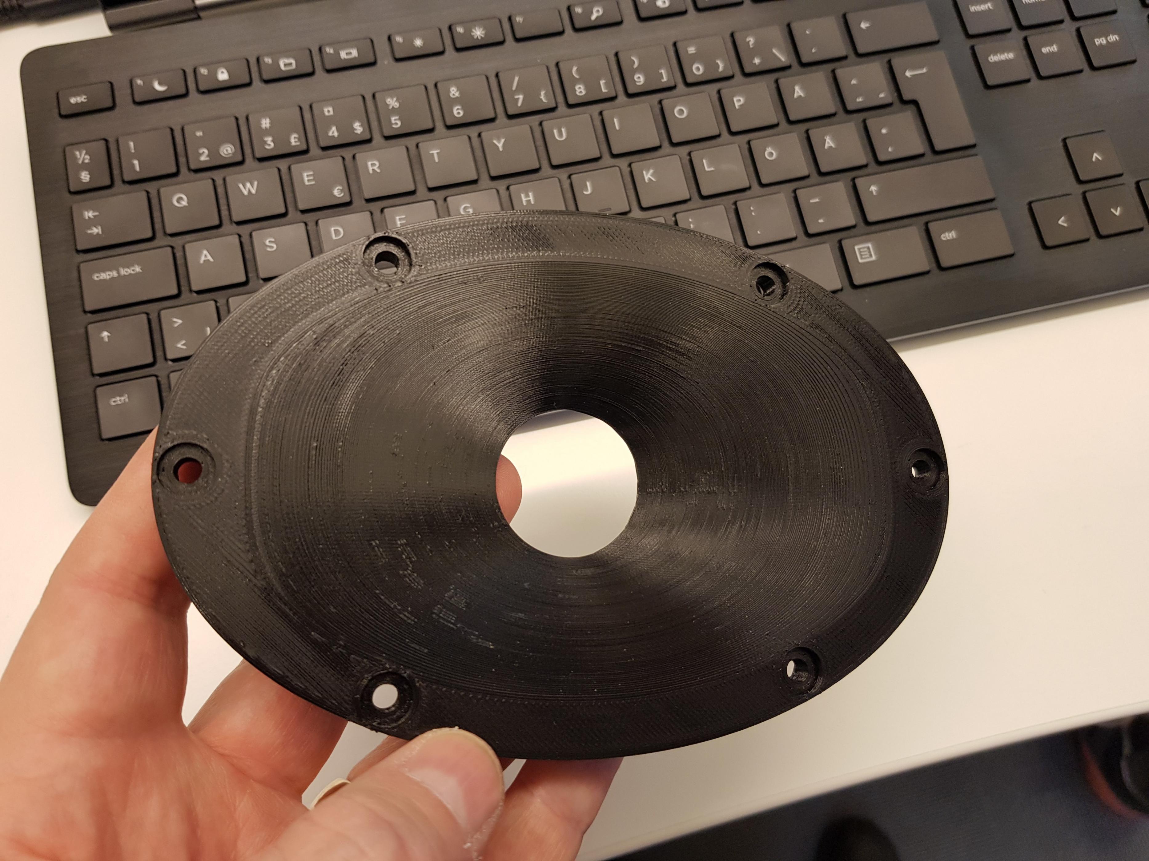

I should have explained myself better. What I meant was to remove the mesh grill from the tweeter, mount the tweeter to the waveguide and then place (glue?) the grill on the waveguide over the dome. Is this possible?
I suppose you could try but the grill is round and the waveguide is elliptical so it wouldn't sit evenly on the walls. I would be tempted to find some steel wire and drill a couple little holes in the waveguide and insert the wire into them.

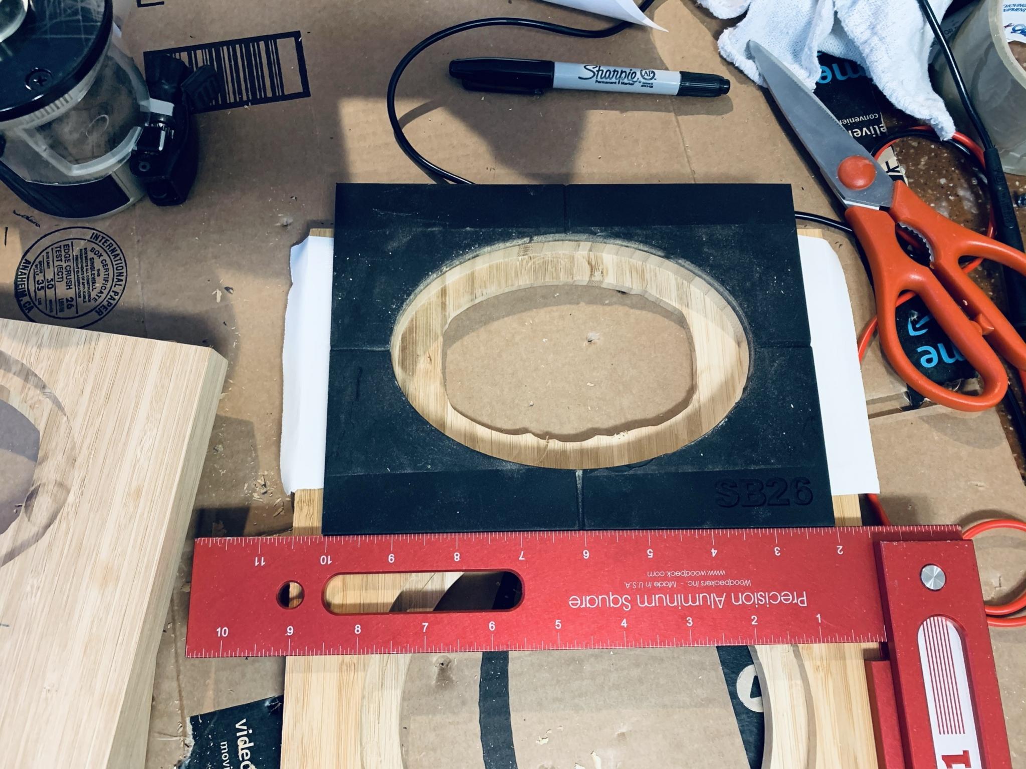

Here are two jigs for routing the elliptical recesses and cutouts for the 4" and 5" versions. I have tried a couple of times to do the top-bearing flush trim bit, and the bit is too erratic when trying to take out that much material. I've got two burned carbide bits as a result.
My currently preferred method is to use a 1.25" templet/guide bushing and my 0.25" spiral upcut machining bit that I use with my Jasper Jigs. Attach the jig to the baffle with double-sided tape (can be messy to clean up later), and then take 0.25" passes around until you have a through-hole. Then come back with a 0.5" rabbeting bit set to between 0.25" - 0.375" (6 - 9mm). The 3/8" depth allows for gasketing tape underneath the waveguide.
Making your own jig is fairly easy, just be sure that the jig is taller/deeper than your guide bushing.

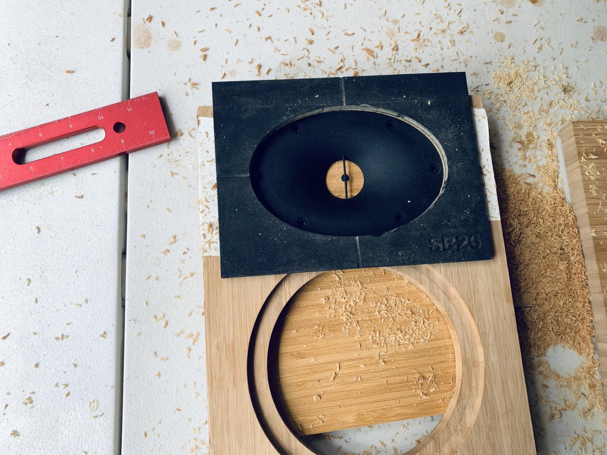

Using the guide bushing to clean-up prior attempts with a top-bearing trim and dado bits. My only real complaint on the guide bushing approach is that the bushing only fits my fixed router base, so changing depth is a bit of a hassle, and there is not an elegant way to ease the bit into the wood.
Before the clean-up with the guide bushing, and the fit afterwards. Gasket tape brings the edge of the waveguide to be flush with the baffle face.

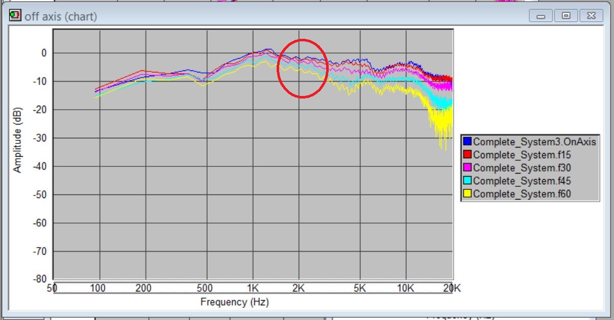

Hey guys,
I haven't read the whole thread yet but are doing it slowly.
I do have a question regarding the output in the top octave for the waveguided SB26ADC.
In the measurements of the WG+SB26 it seems like the spl level in the top octave is reduced against the SB26 without waveguide. Is this correct?
I am asking because I am looking for a WG + metal dome solution that fits my need of about 91dB to meet up with my midrange.
The DXT is too low in sensitivity and when checking for a suitable other metal dome i found the SB26ADC. But following the measurements in this thread, it seems it isn't possible for me to use it.
In the spec sheet it says 90dB, but following augerpros measurements it looks like the output is only around 85dB in the top octave with waveguide. The use of a waveguide for this driver makes it loose output in the top octave.
All other solutions of a dome + WG (DX/XT + WG etc) seems to not loose any significant output, only gaining in the lower octaves.
What is it that differs? And am I reading the measurements right, am i missing something?

Actually it is quite normal for the top octave to be less on axis vs the bare tweeter. Your SEAS example does this too if you compare it to the 27TBC/G it is based on. The upside is that there is more energy off axis in the top octave in waveguide, so power response is better than a bare tweeter. Now my results are within 1dB or so absolute, and I suspect a bit at the low end of the range, so it wouldn't bother me any to use this in a 91dB speaker. Ignoring whether a dB or two in the top octave is even relevant for most music and people, remember there is more energy in the top octave off axis. Again comparing the SEAS, at 30 degrees offaxis, the raw driver (27TBC/G) is down between 4-15 dB compared to on axis, while the DXT is only down 1-2.5dB! My waveguides behave similarly. So unless you have the speakers directly point at you, chances are you will have MORE energy at the seating position when using a waveguide.
