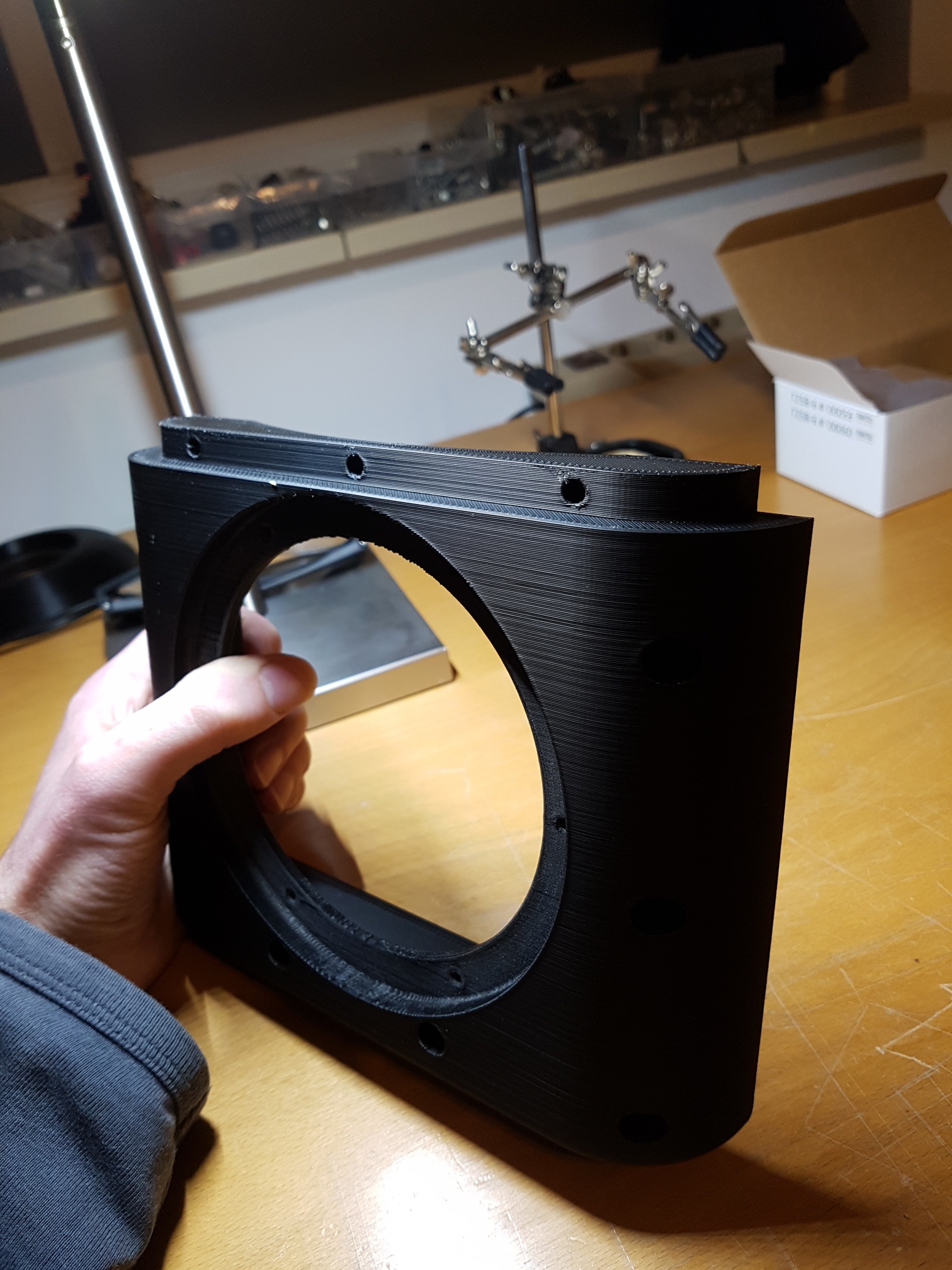

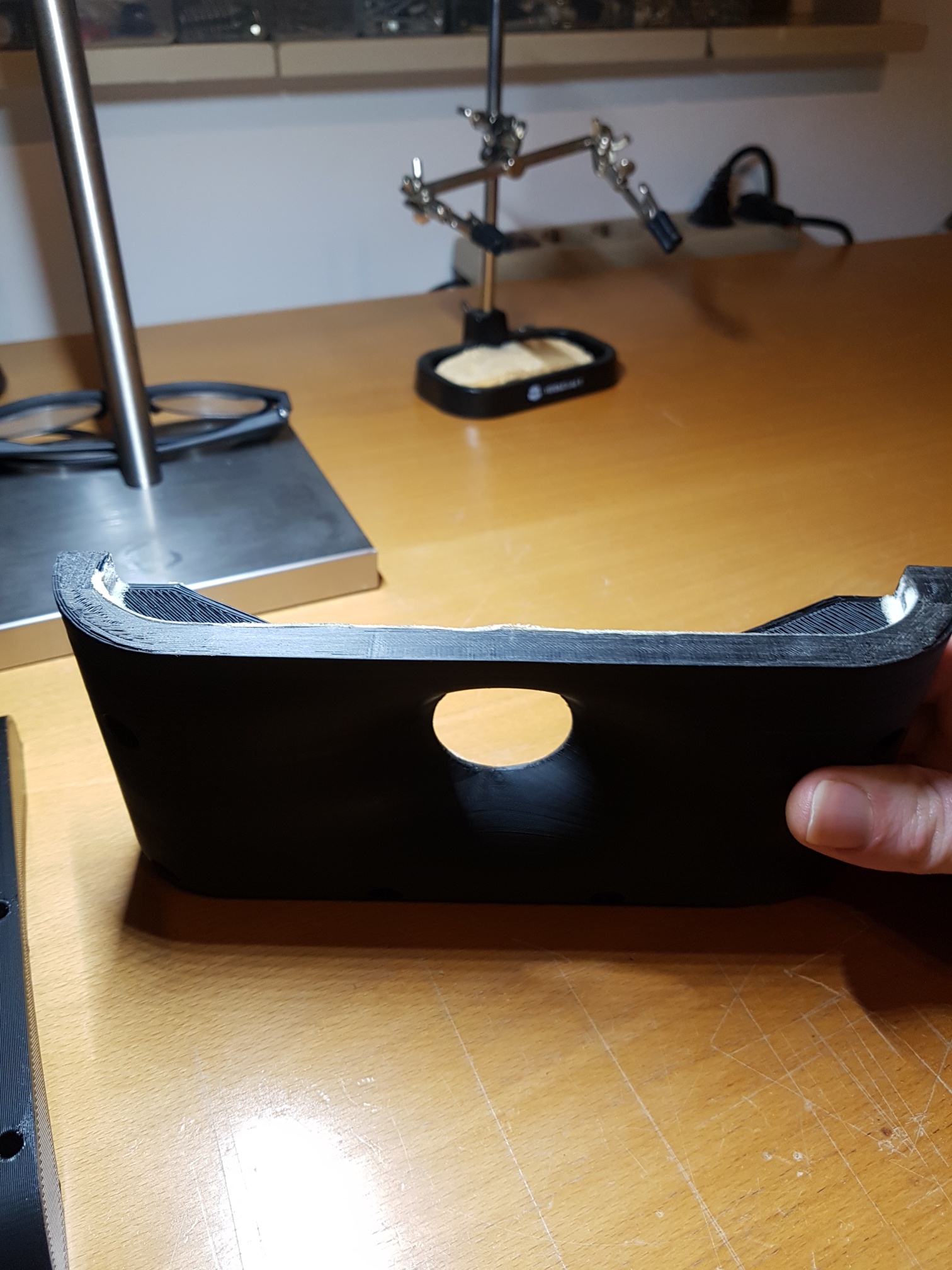

Is it possible to remove the drivers after attaching the baffle to the box?
😀 Yes, the drivers can be mounted/removed by removing the bottom panel.
There is a thin foam-tape gasket between the bottom panel and the baffle+box.
All other joints are made with adhesive (polymer between baffle and box, and wood glue between the layers).

Hello Brandon,
First i would like to thank you for your creating this topic, without it i would not even be doing CAD design and 3D printing. Before this, i had no experience with CAD software at all, and i bought my 3D printer just to print your waveguides. 😀
First i just printed your waveguides, but then i realized that if could somehow integrate your WG profile into a baffle, i could get a lot smaller center distance between the drivers, because i don't need the mounting flange that way and i could also partially overlap the flange of the midrange (when rear-mounted)
So i learned how to use Fusion 360.🙂

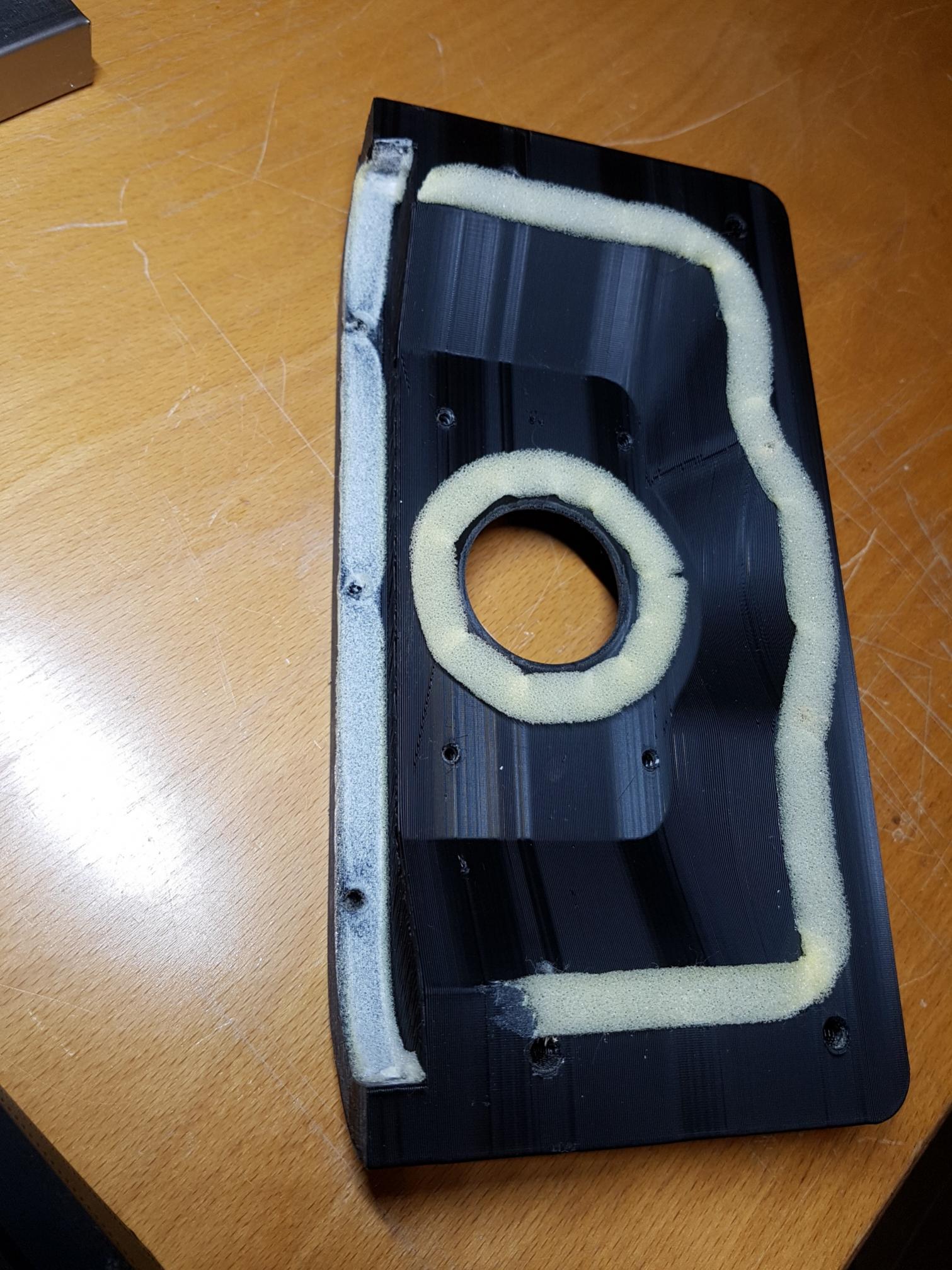

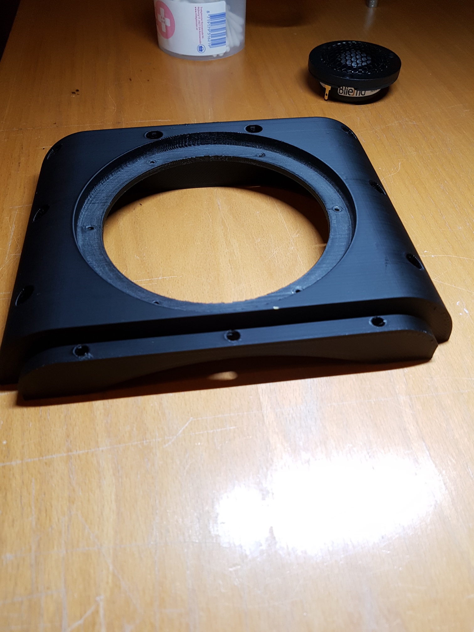

The Baffles are printed in one piece with my Ender 3 Pro, so i was limited to a maximum of 250mm in height, but this was enough for these speakers(their dimensions are 250 x 200mm

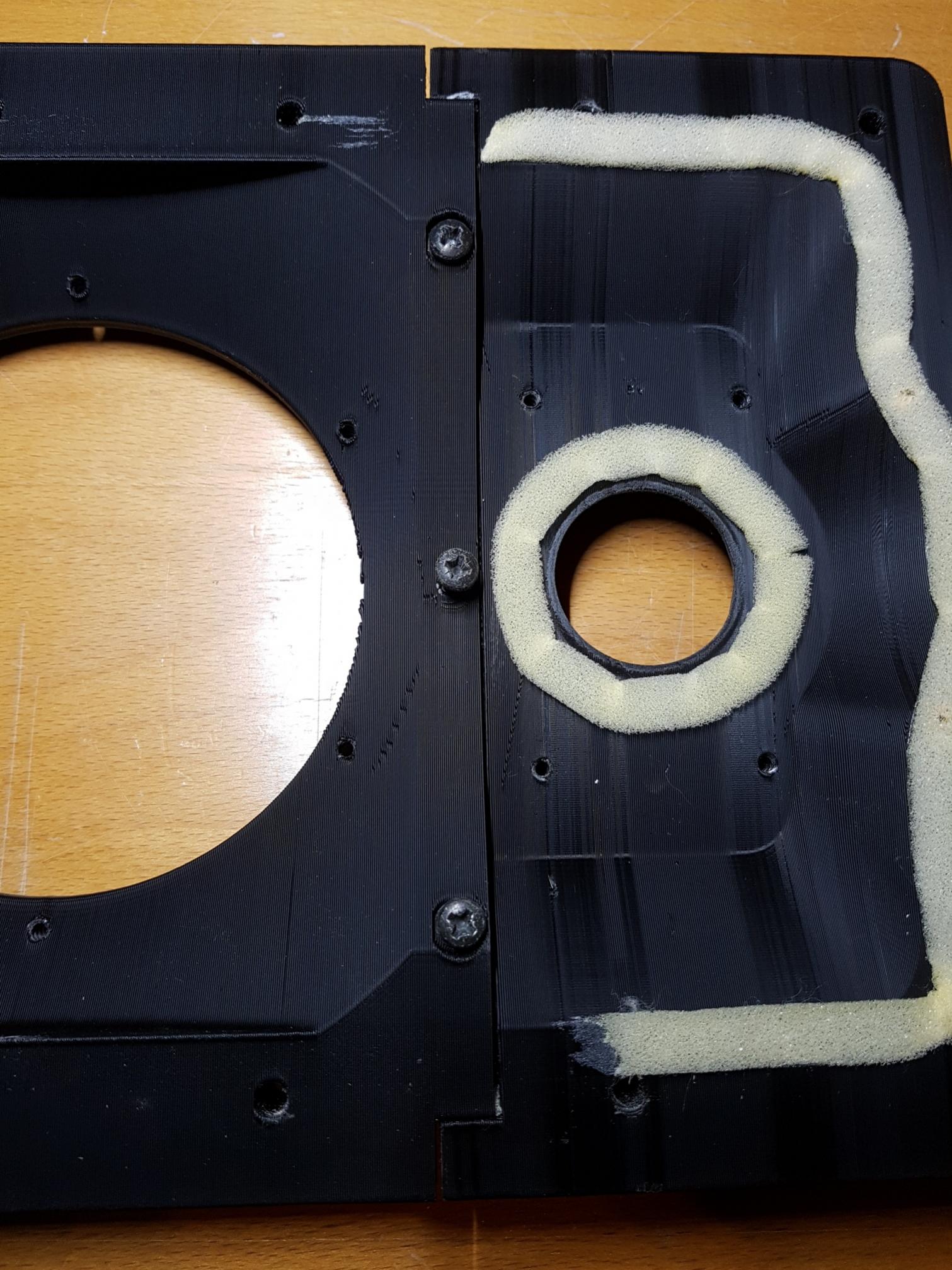

I also want to make a larger baffle, so i printed a prototype of a two-piece model (pictures below).
The two pieces are held together by 3 screws in this case, sealed with foam tape but i think that a 2K epoxy glue will also do a very good job.
However i'm leaning towards just buying a larger printer for this purpose, as they are getting cheaper and cheaper these days.
I experimented a lot with the slicer settings, print orientation and nozzle sizes.
The best results where obtained when printing the baffles standing right up instead of laying flat on the bed surface, the only downside with this orientation is that the beginning of the WG throat will not be perfectly round, but a little bit "stepped" because of the layers.
I found a solution by reducing the throat diameter in the CAD drawing (by 0.5mm or so), and sanding it back to the required diameter afterwards, so that it fits perfectly around the tweeter roll surround.

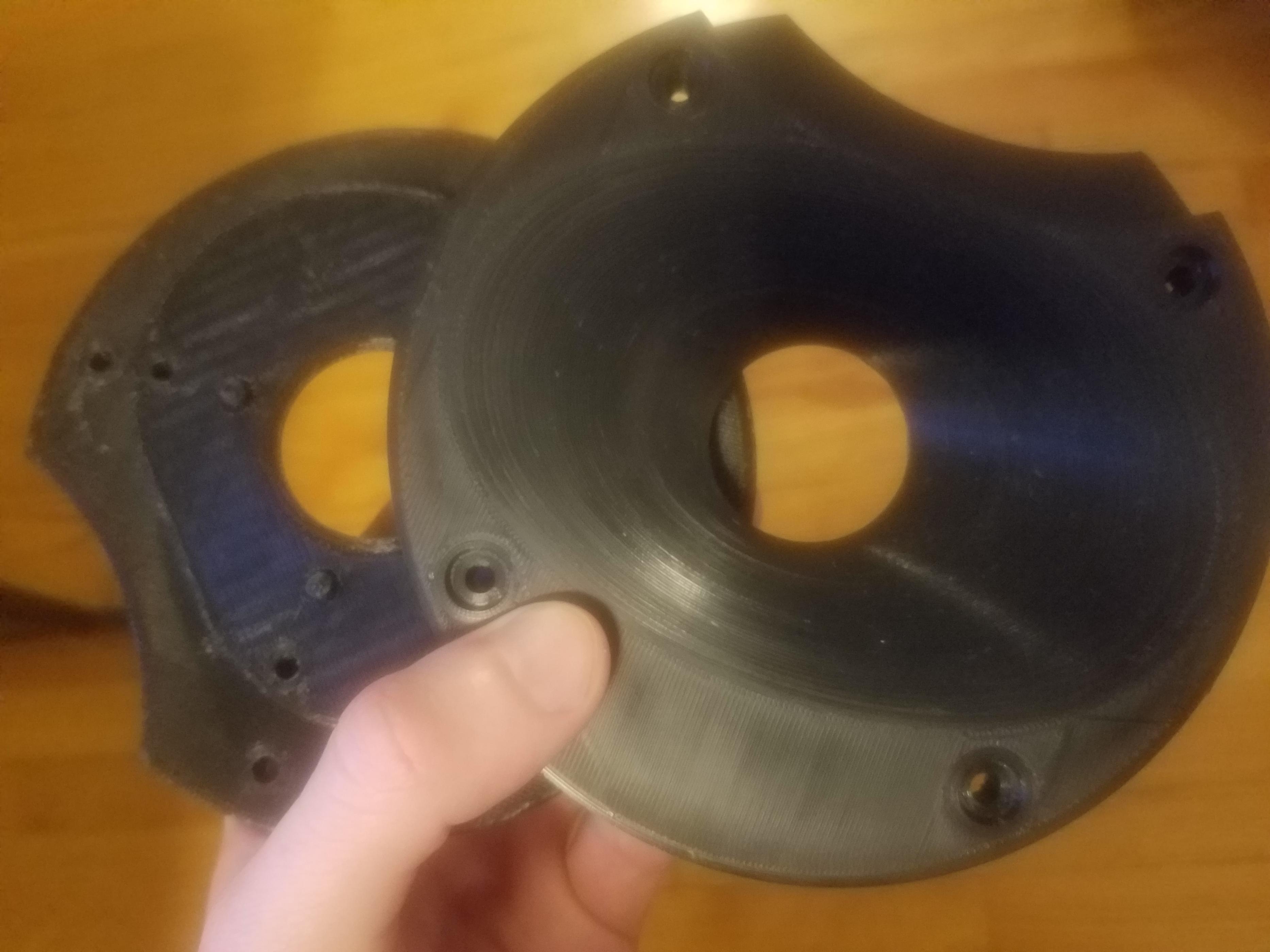

Hi folks,
Today I've tried for the first time to dismount the SB26ADC faceplate.
So I've unscrewed the 4 screws and raised the faceplate.
I've been very astonished to see the that the aluminium cone and its 'under' plate came out.
So I've started by sweating a bit, and just re assemble it as is.
Is it normal ? Do I have lost a tweeter ?

shining31 - same thing here. I just put them back together, being careful to not damage the voice coil when sliding it back together. No issues.

shining31> the faceplate and the diaphragm plate separate, just use a razor or butter knife to go around the edge and pry them apart. Sometimes they are tight, sometimes the faceplate just comes right off and the diaphragm stays put.
