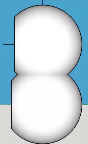

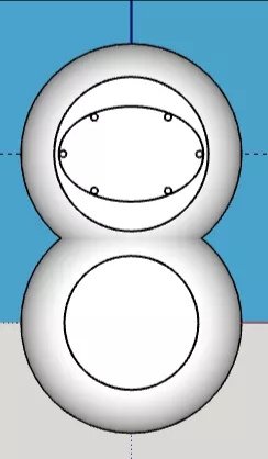

Working on spherical integration... Radius of 28cm.
Ikea Blanda Matt bowls, with sb17 nbac as a mid way.
This draft here is with wg 6.5" version, just to evaluate visual look. A round shaped wg would be ideal and avoid any adapter [emoji6]
I already printed the 4" version (too fast)...
Wondering if 5" or 6.5" would give better performance for this application...

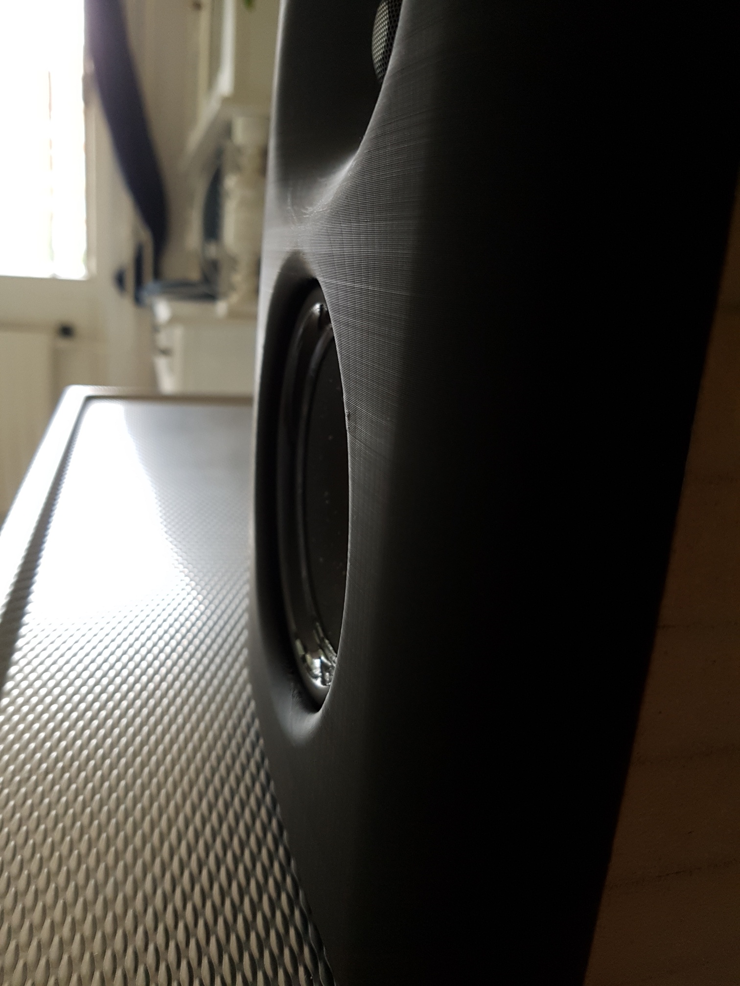

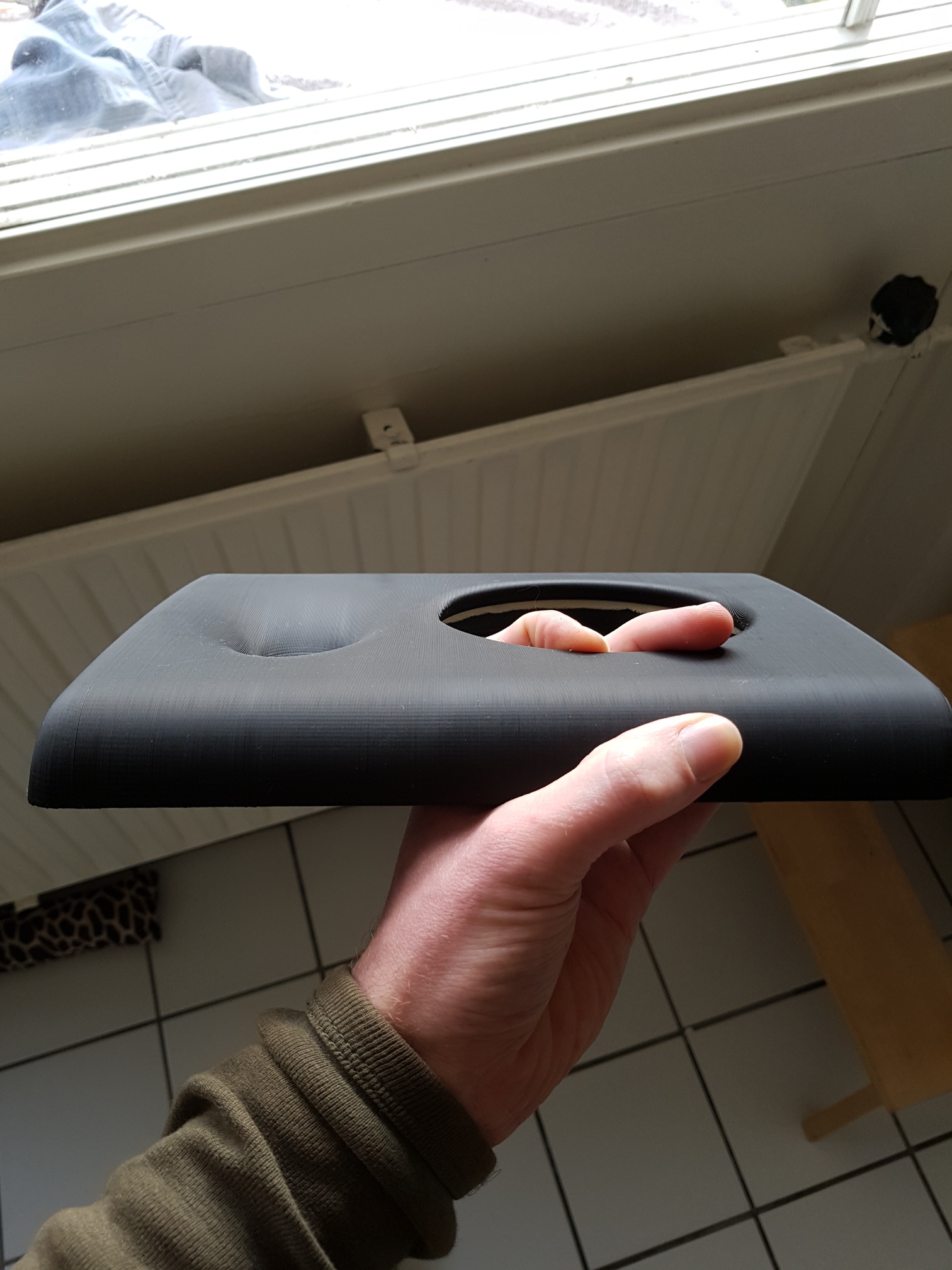

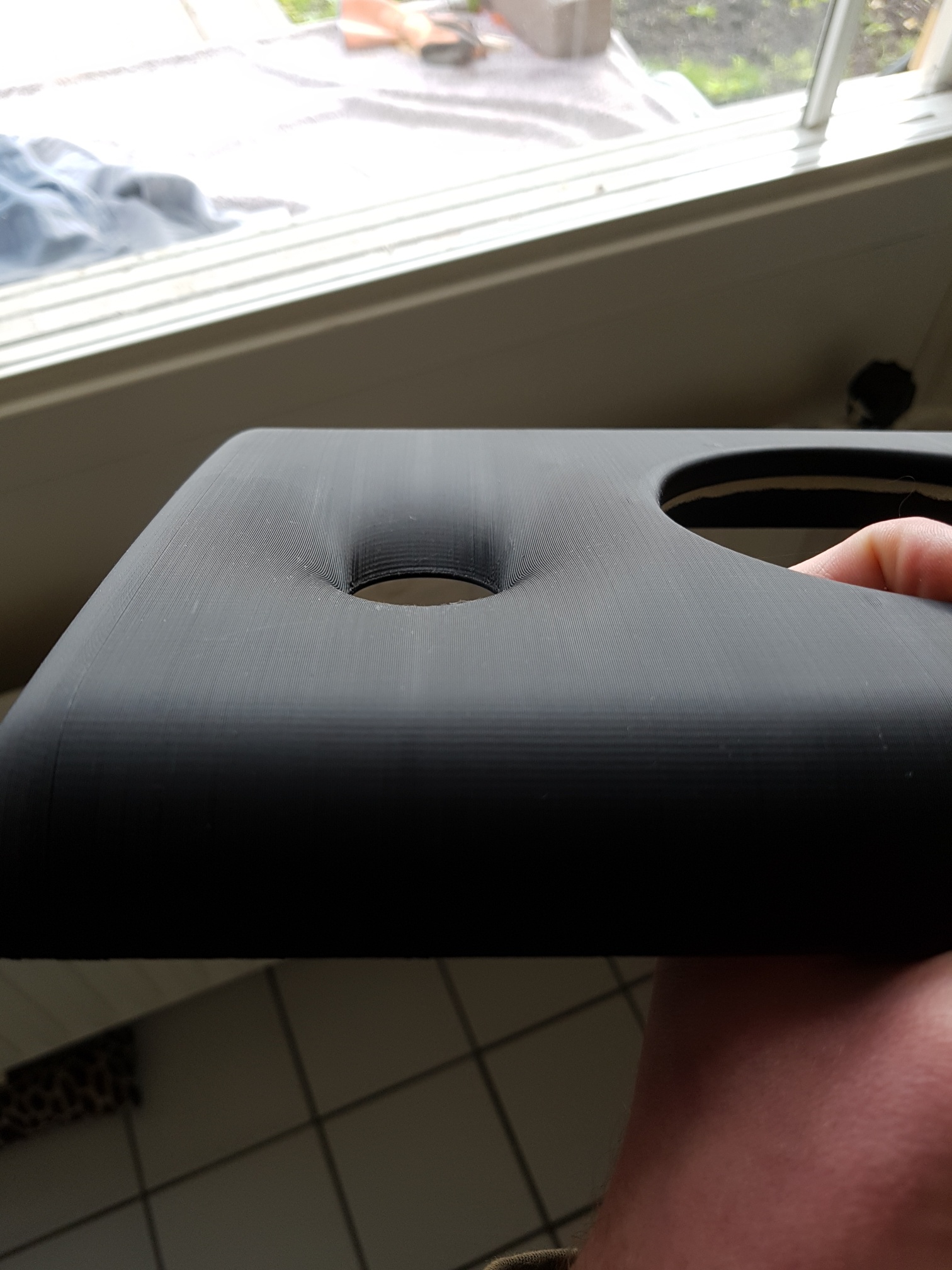

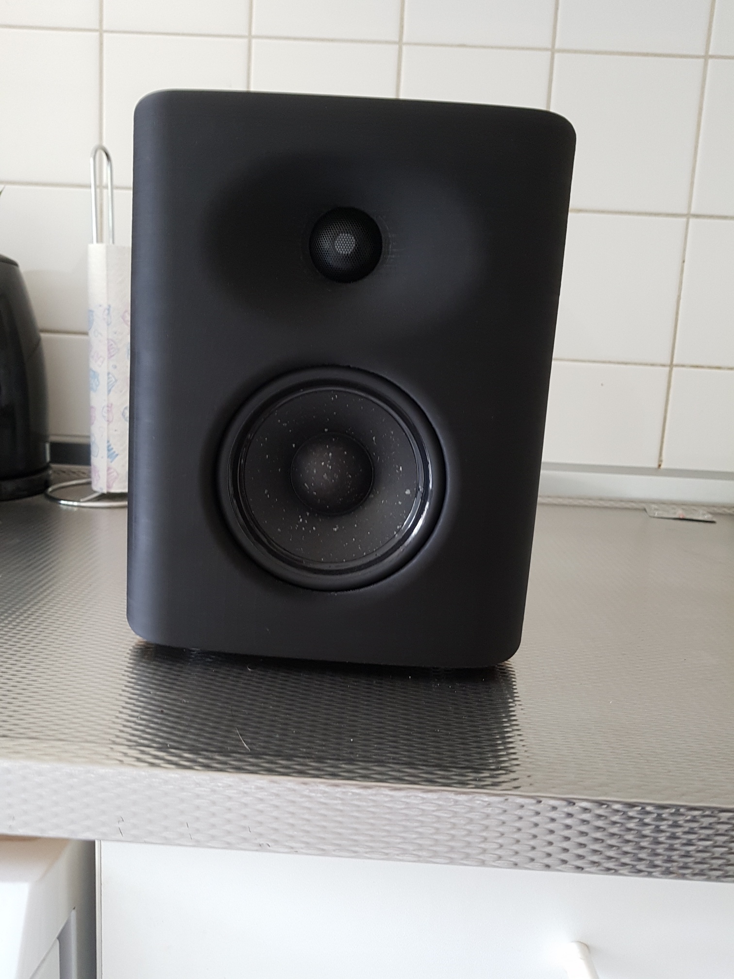

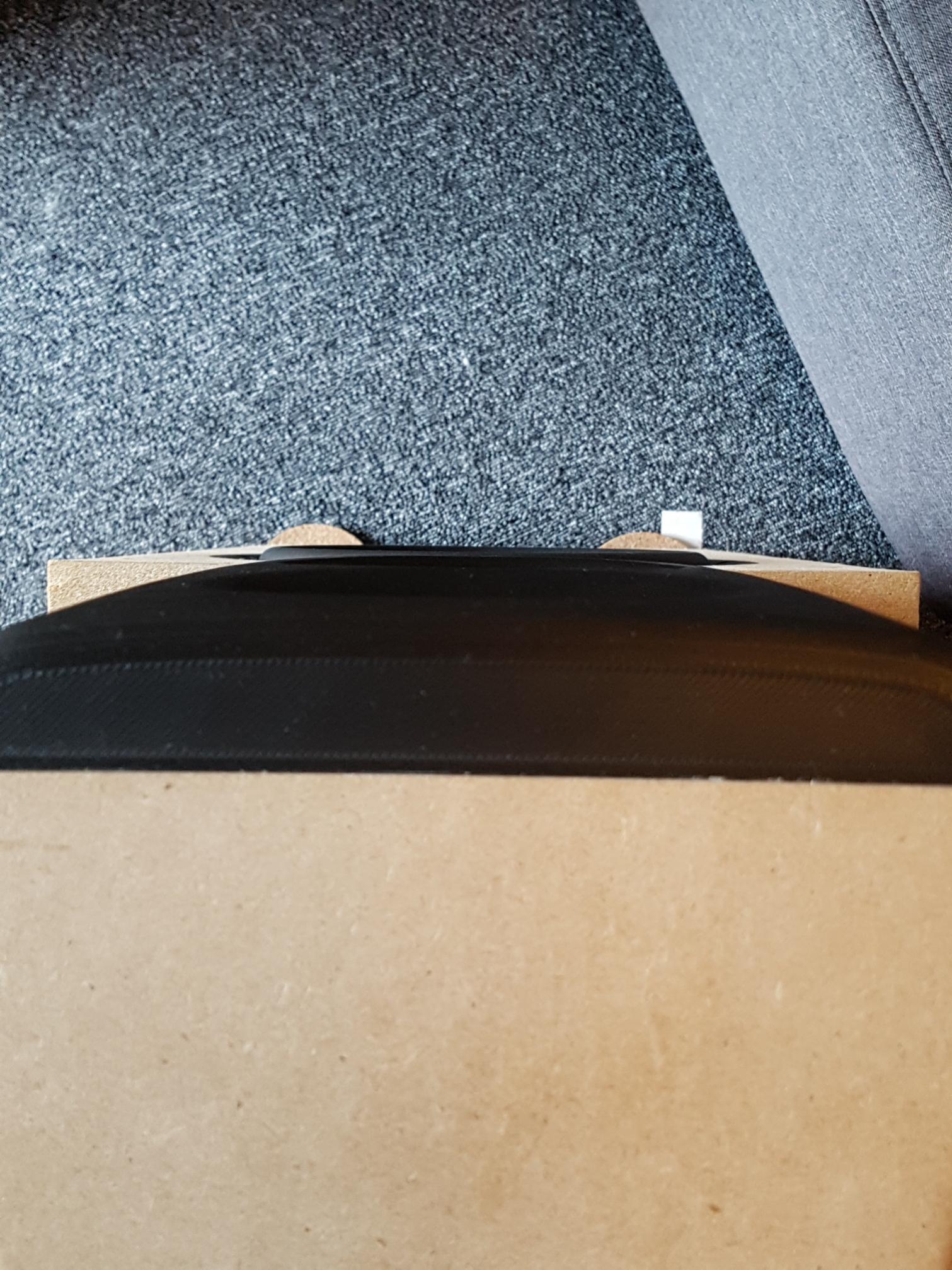

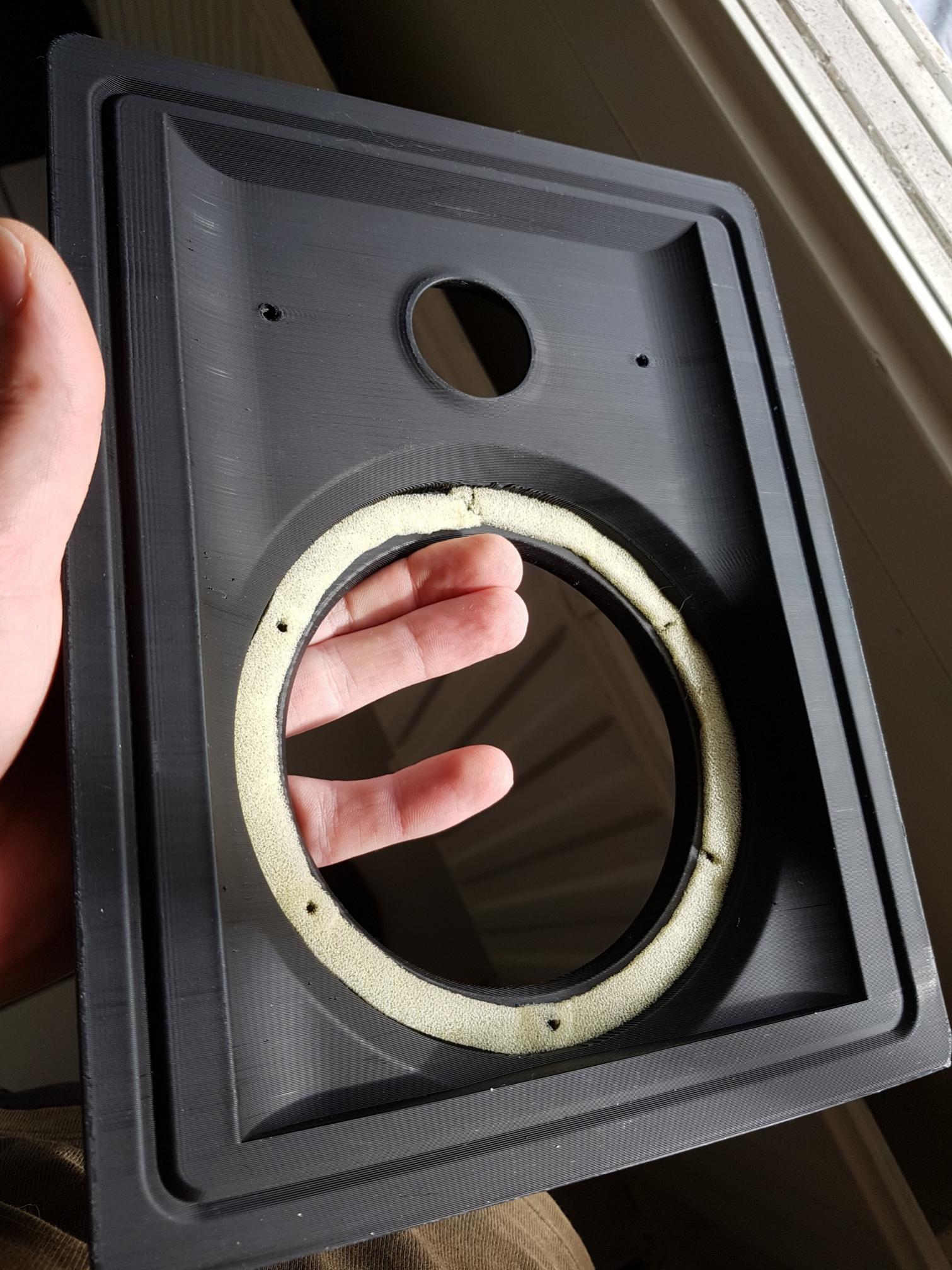

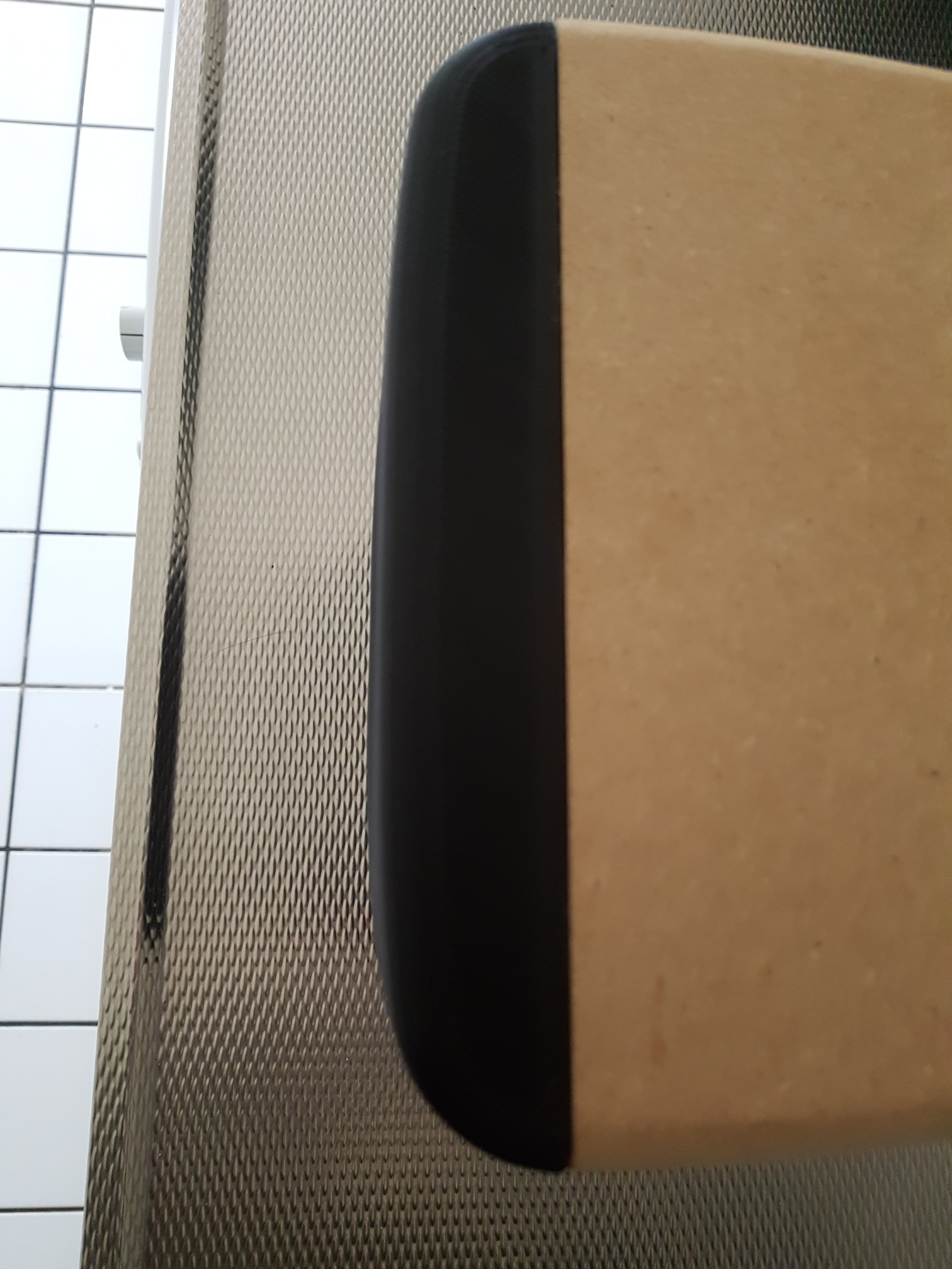

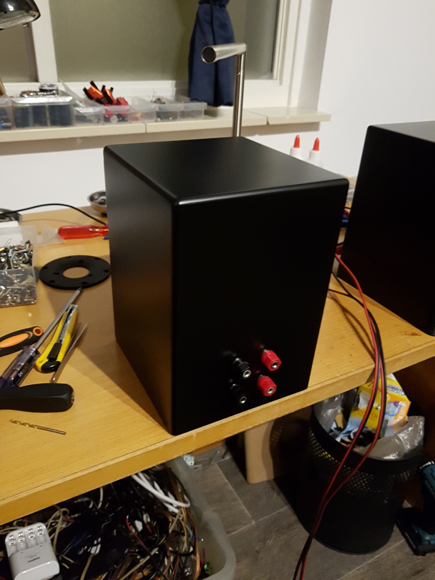

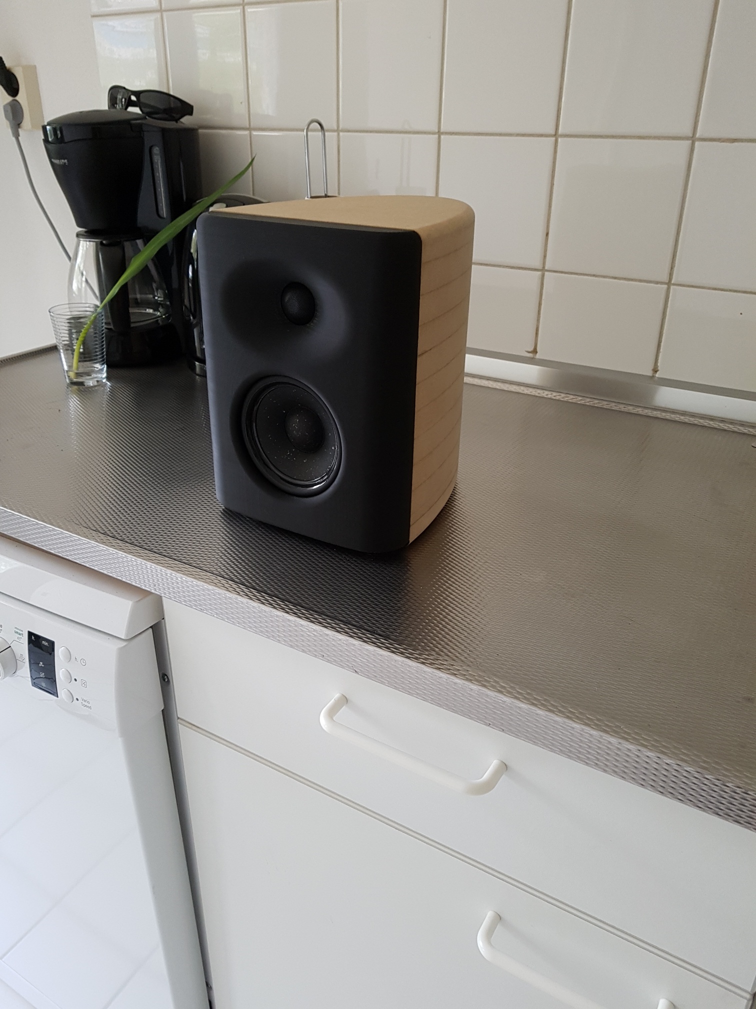

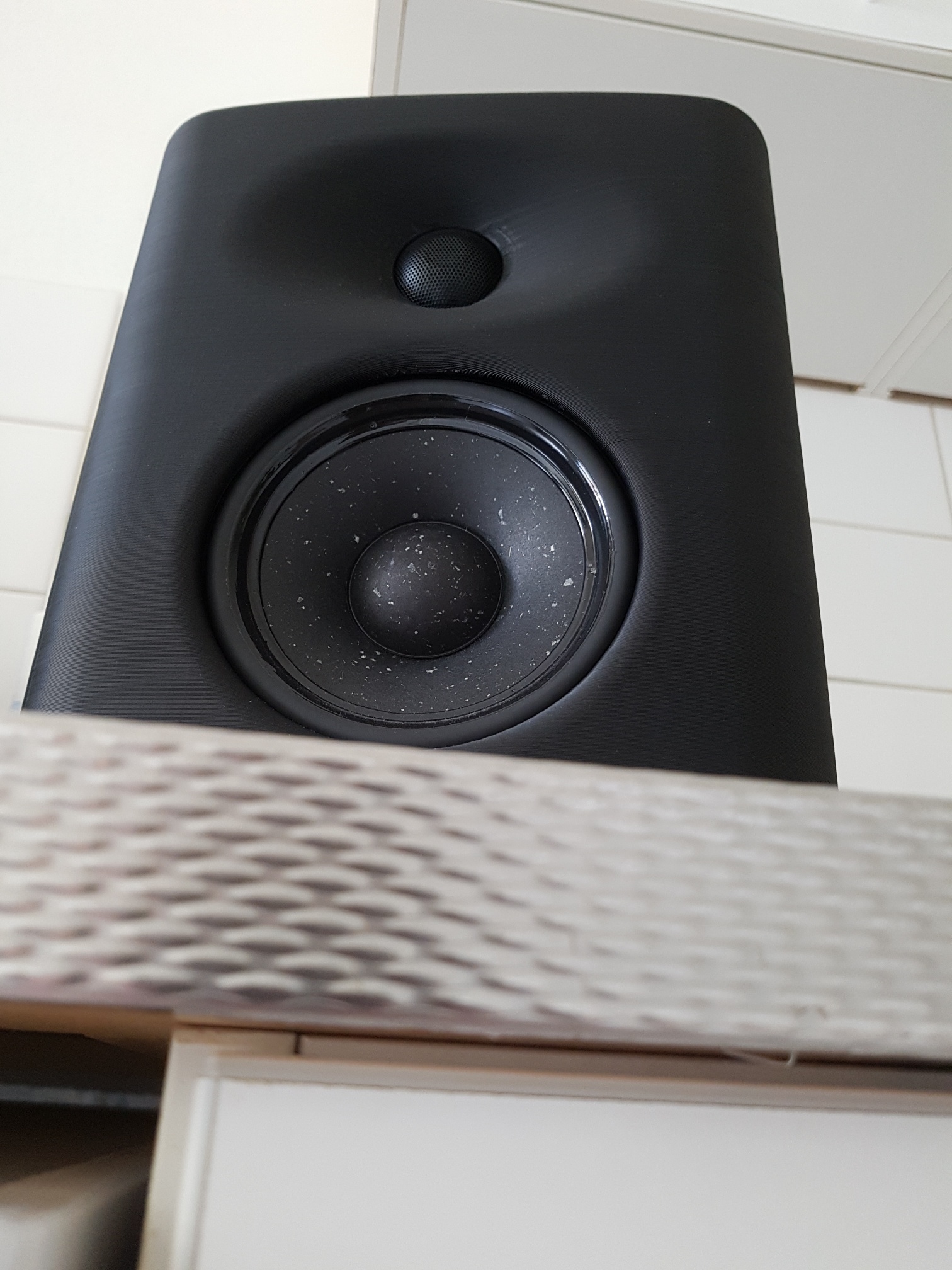

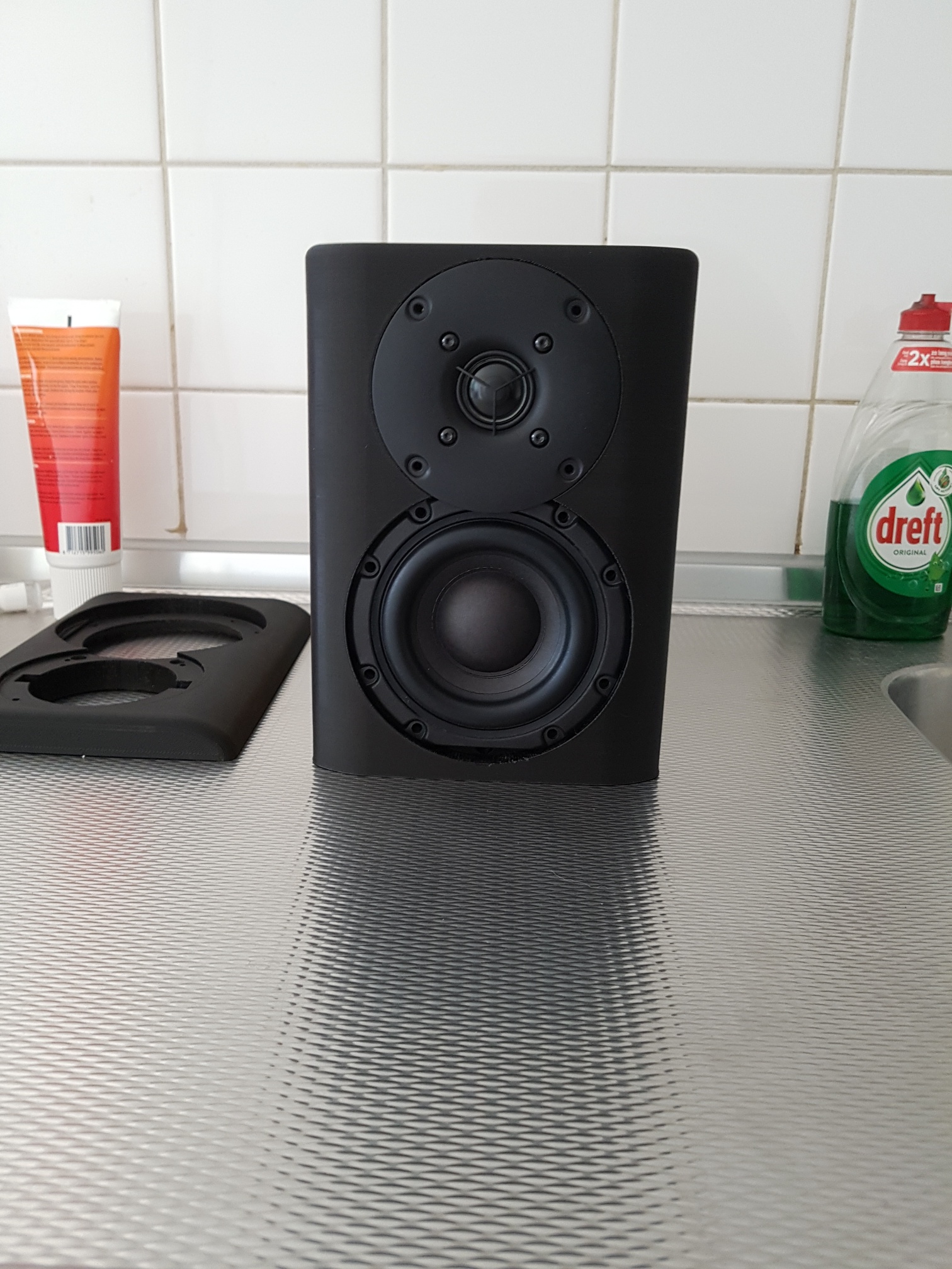

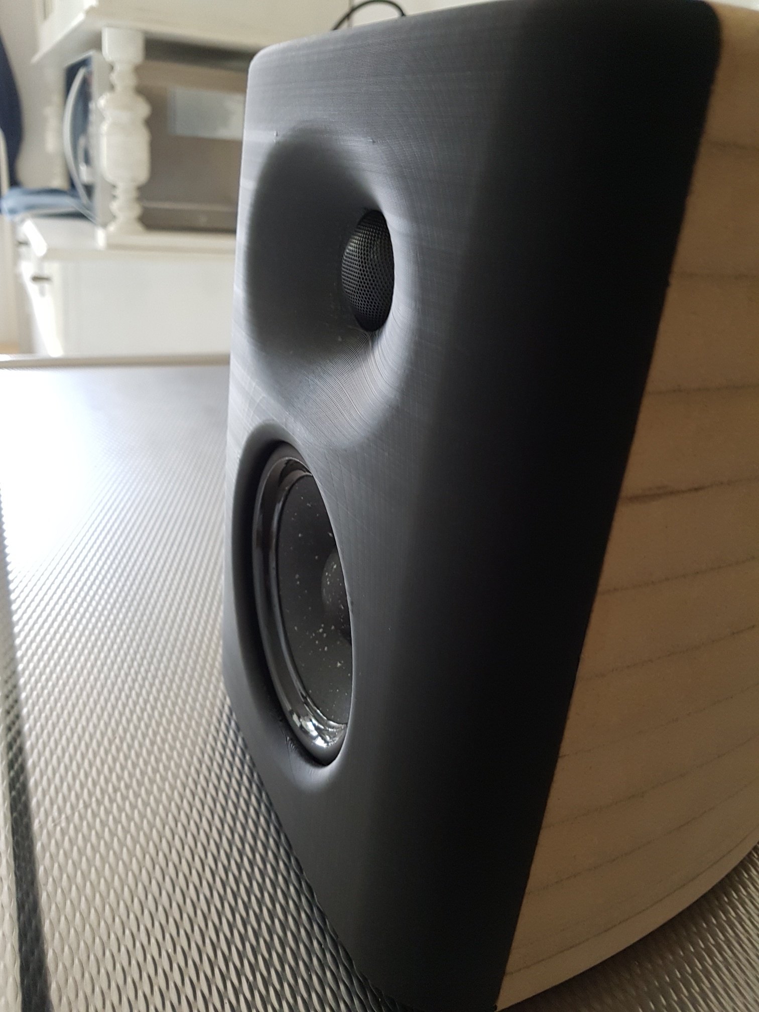

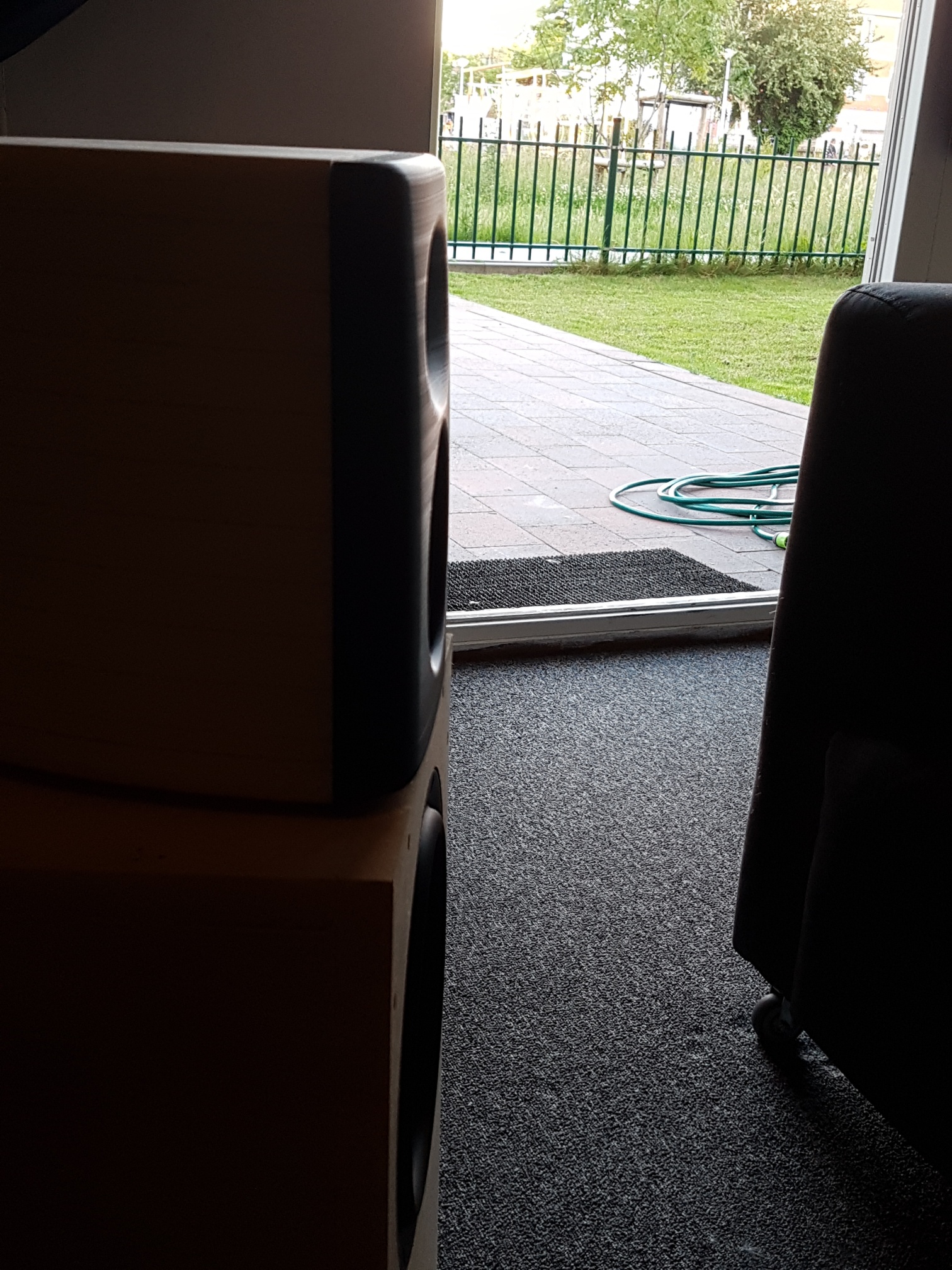

Here are some pictures of my 3D printed baffles and speakers.
Units in this case are Satori MR13 (with edge coating) and 25mm titanium dome tweeters (from Neumann KH120 studio monitors)

Those are purdy!! How do you plan on finishing them cosmetically? A few coats of automotive high-build primer would likely take care of the printing layer lines
Some of these baffles have Augerpro's SB26 5" waveguide integrated, the others waveguides are my own design (for the KH120 tweeter)
I found the KH120 tweeter better than the SB26 so i used these in the final speakers.

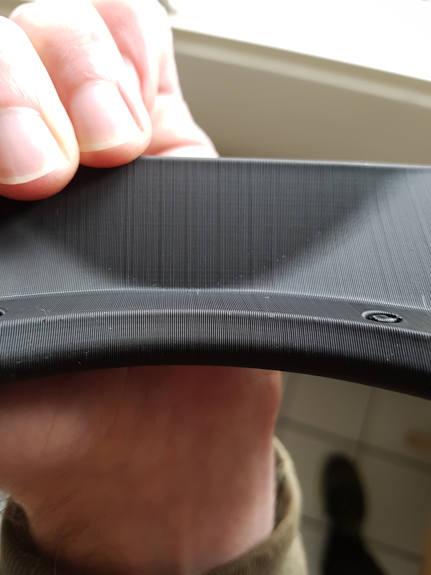

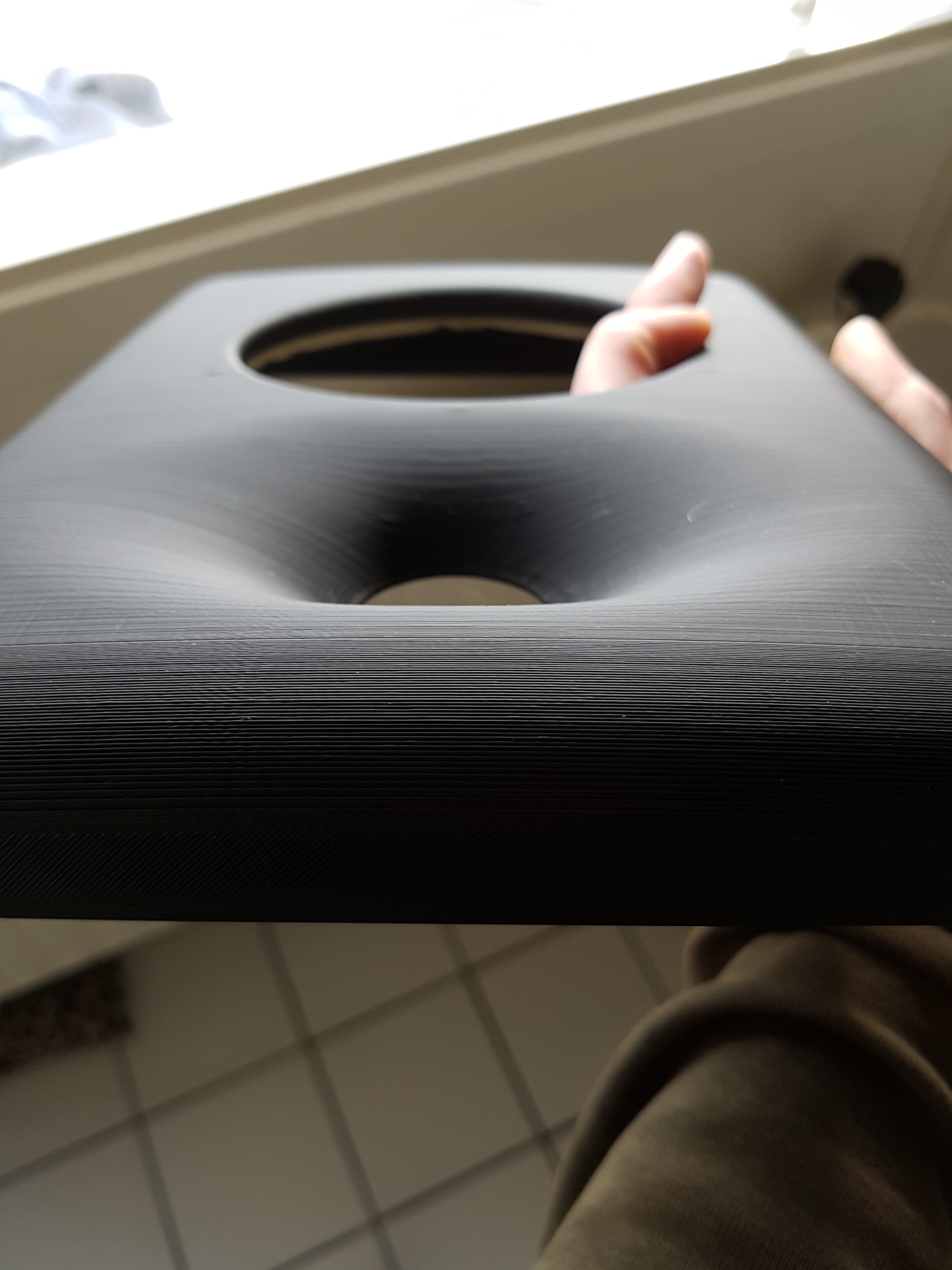

No CNC because i just wanted to try my new 3D printer (Ender 3 Pro)
But believe me, these baffles are very strong/stiff (a lot stronger than MDF), weight is about 0.8 to 1 KG.
Printed with 0.6mm nozzle, 90% infill and 5 inner+outer wall layers
It took about 52 hours to print 1 baffle.
Maybe i will paint them in the future, but for now i like the printed look 😀
I mounted the MR13 from the back, so that the waveguide could overlap the MR13 flange, this way the center to center distance is about 1.5cm less.
Holy, 90% infill.
Did you consider to create a honeycomb grid open from the back, that you could fill in with epoxy composite (granite dust & grit is a common mix) and/or or construction adhesive?
Epoxy granite stiffness - follow-up - YouTube

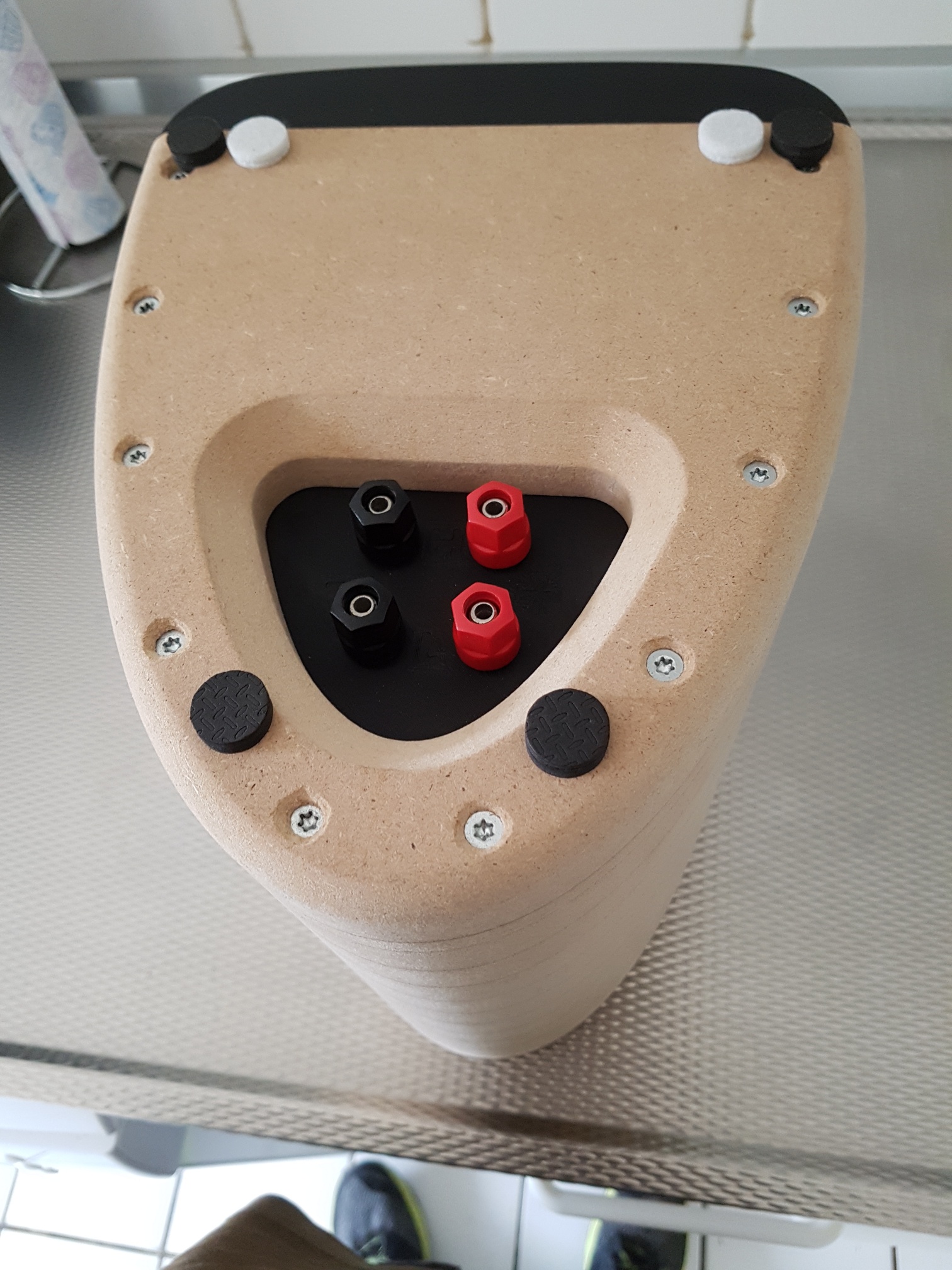

That looks awesome 🙂 How do you attach the baffle to the box?
