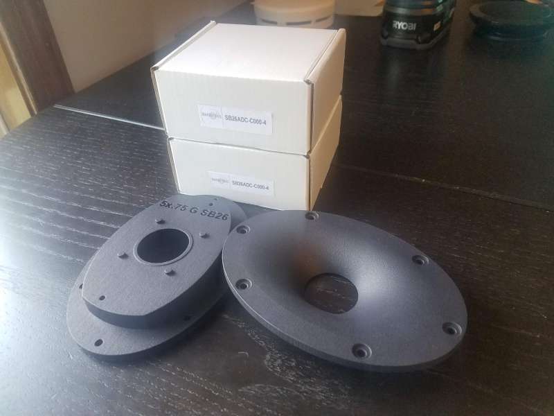

A couple weeks ago I ordered a pair of the 5" SB26 waveguides for my 3-way tower build. They came in today and I'm very happy with the quality, so I figured I'd share details!
Vendor: Xometry
Material: SLS Nylon 12
Finish: Media Tumble w/ black dye
Cost: $125 shipped w/ tax for the pair

black300zx> looks great and that's not a bad price either. What's the intended application in your design?
They'll be paired with Peerless 5" HDS mids and 8" peerless HDS midbass/woofers. I have very wierd room geometry so I'm hoping the controlled dispersion will help control room reflections. My first time using waveguides, so it's also an opportunity to learn & experiment. They look pretty neat too😉
