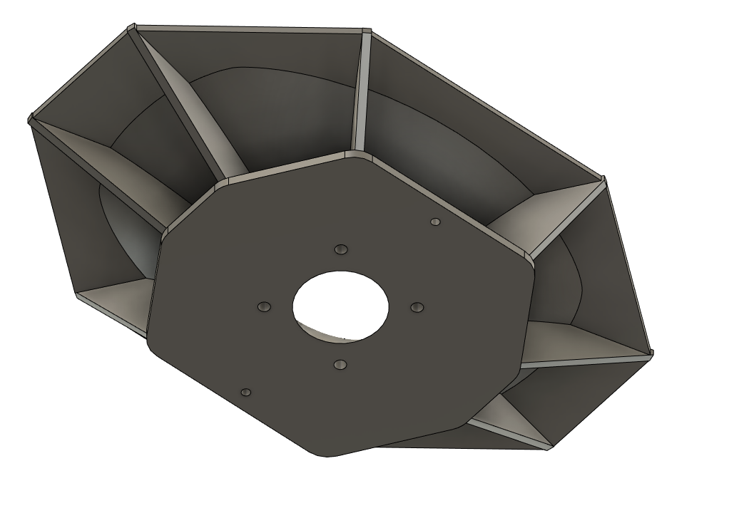

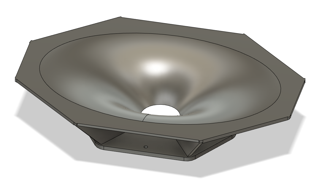

Was going to print the 8” waveguide you created, but my guy was worried it might not print without additional support...here are pix of what he will be printing...I will advise once we have made first print attempt.
