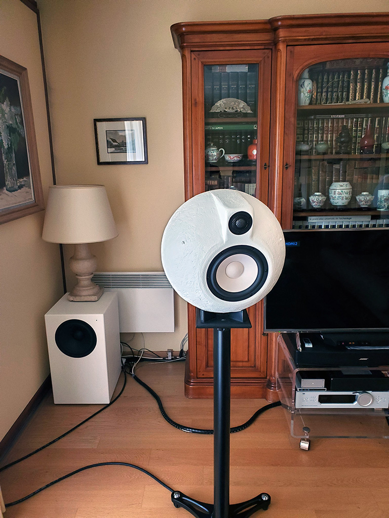

I received my samples last Friday and they are beautifully manufactured.
I have mounted one pair on a renovated (and modified) old "Boule Elipson" from the sixties to replace the ScanSpeak D3004/604010 I selected previously and clearly they are better both on measurements and listening (at least for my ears).
My second pair is waiting for a near future Augerpro waveguide and will probably be coupled to a Purify mid woofer.
