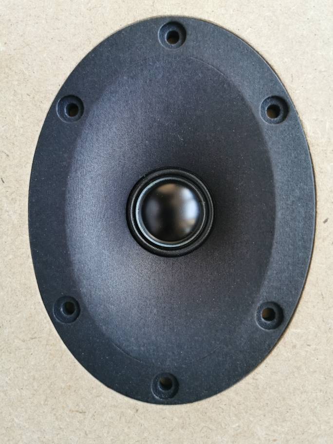

Please find attached the print i ordered online and received last week. High print quality with sanding & black paint applied in the process(cost 70€ for a pair....)
Quite impressive! Above my expectations.
Thank you! View attachment 830247

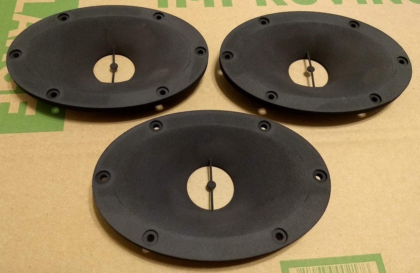

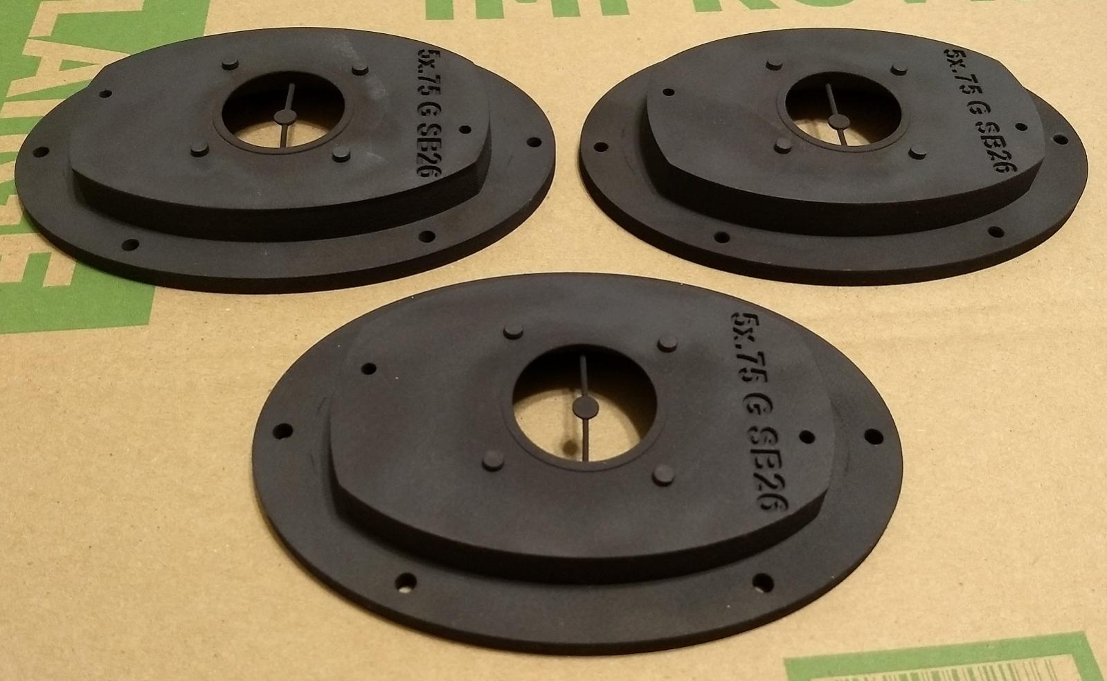

I'm not sure when I will actually be able to find time to build speakers, but ordered three of the SB26G prints in MJF nylon some time back. Ordered three to get past the minimum order upcharge.
The tweeter interface and waveguide profile are serviceable, but the phase shield support is deformed on all three.
Something to consider for anyone thinking of having these printed, since the print service indicated it was entirely my fault, and won't return further emails.

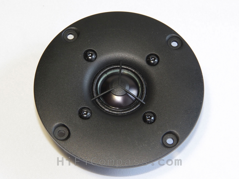

Could the phase shield be made more reliable by making it more like the one on the original faceplate? My Fusion 360 skills are woefully inadequate.

Update: I've updated the SB21 and SB26 files to correct any hint of a problem that may cause a printing issue.
All I can think to do is make the arms thicker. From my small experience with printers it seems like very thin - especially unsupported - features can warp. Although proper slicer setup should prevent that, but I doubt commercial outfits are taking the time to do it.

I am also interested in getting some sb26adc waveguides, but like Mandroid mentions above, I am also in agreement the phase shield should be supported at three points, not two. Like the original manufactures phase shield. This would greatly reduce the risk of warping or twisting post printing. Could adjustments be made to do this?

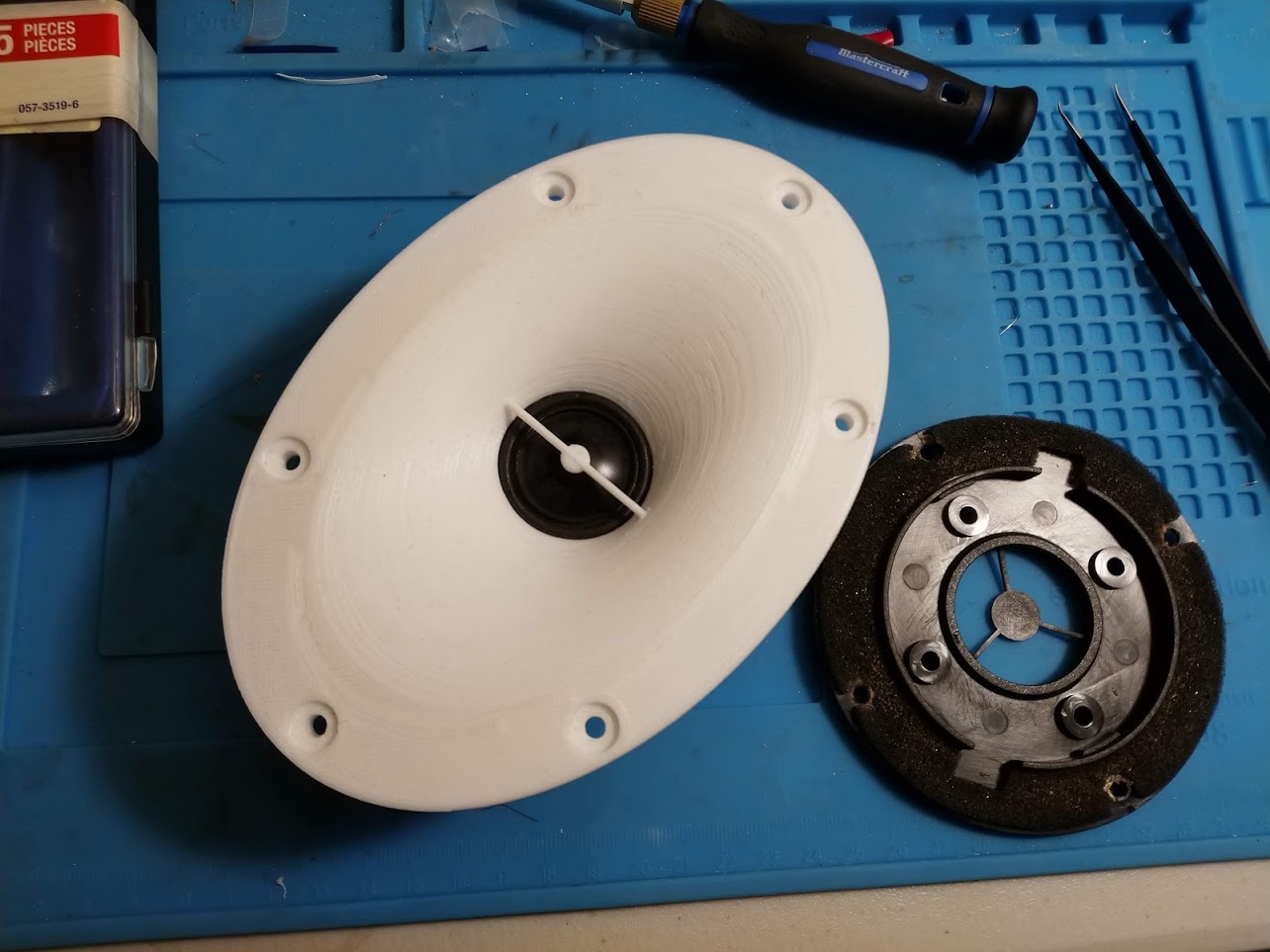

Have you used a 3D printer before? I don't believe the number of arms will make a difference, it is much more likely to do with slender objects hanging out in space. That is very tough to print correctly, and requires the operator be experienced with their slicer and printer.

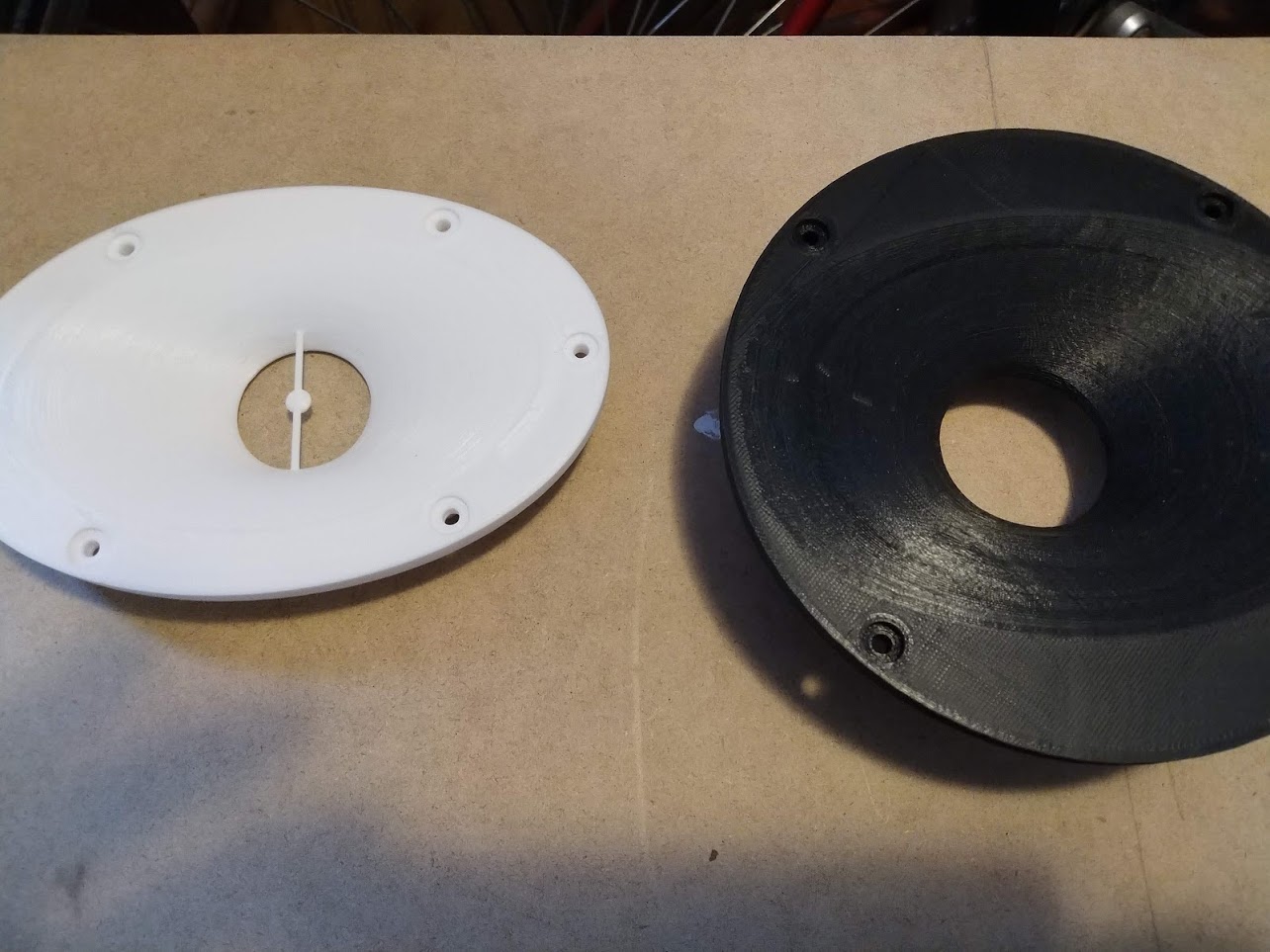

Exactly. I have printed this very waveguide several times with no problems - because I know how to use supports and print slowly, with a suitably sized nozzle, at a suitably low layer height. This does require my printer being in good mechanical condition and properly calibrated (esteps, extursion multiplier, etc). It does require careful support removal and a bit of filing/sanding to get the edges as clean as I'd like, but is doable.

morbo> is there anything I can do that would help in most circumstances? Certain sizes, geometries, etc?
@Augerpro sorry I just saw this post now.
The only thing I think you could do is possibly create a model with supports included... This might save people printing the guides with suboptimal orientation (supports should be on the back, where the can't wreck surface quality of guide). I suppose you could make pre-sliced files available, but those are really only valid for one printer with one extruder/nozzle/filament combination.
