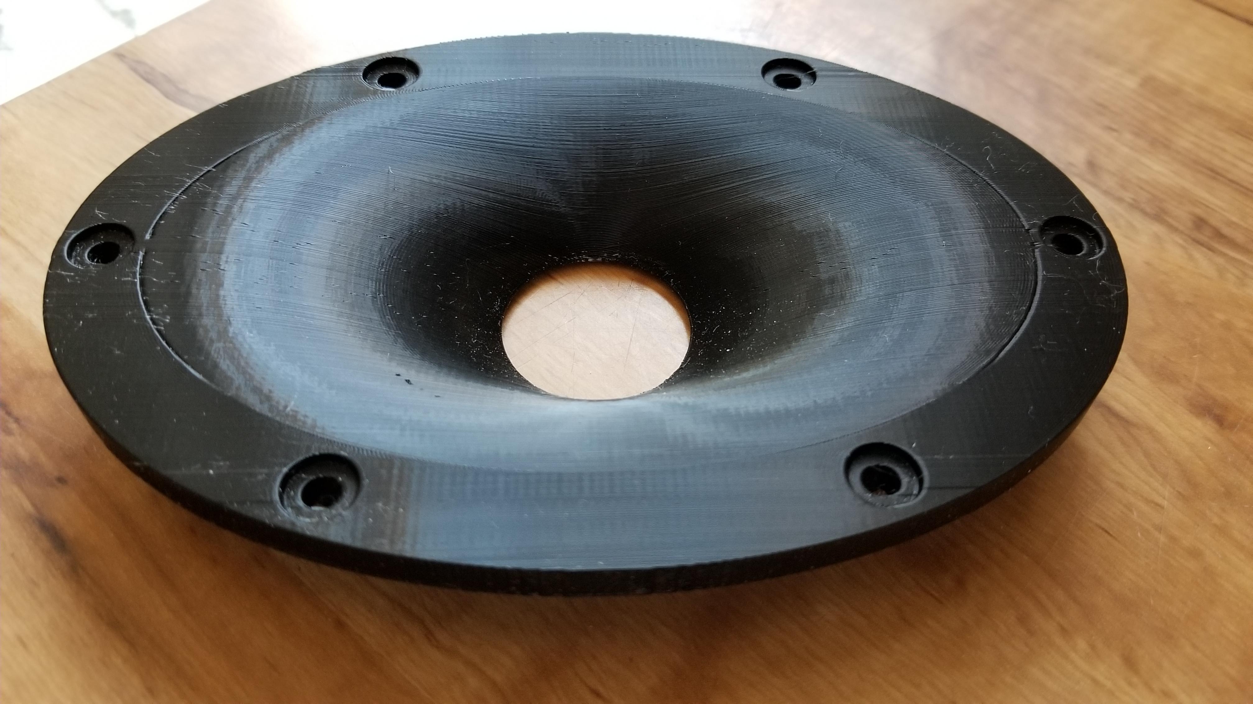

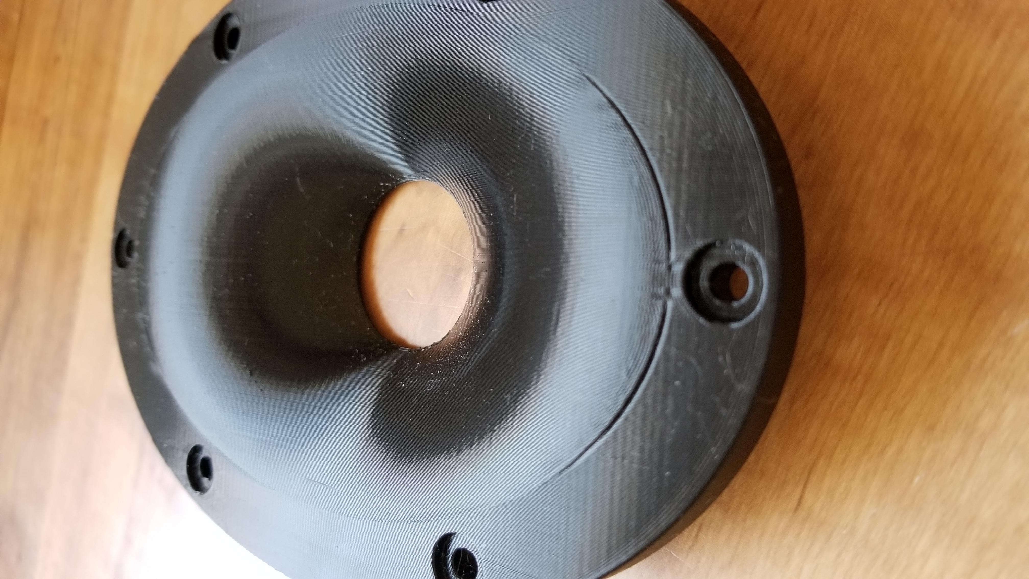

All the prints have two screw holes 4" apart. I printed a little bar to clamp them, but you could use wood just easily. Also used some foam rubber between the clamp and tweeter.

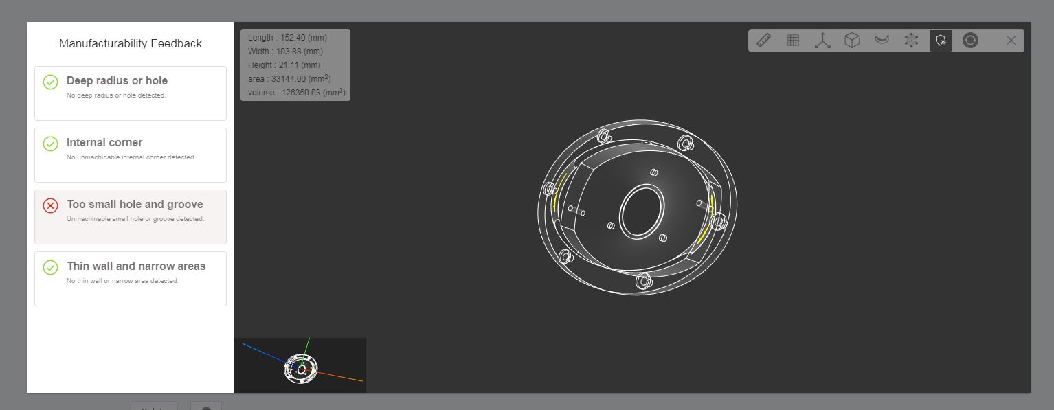

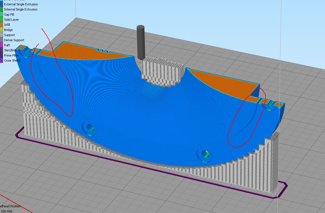

I found why it does that, looking at my other guides I can see it in them too. I think that software visually exaggerates the issue since they've all printed fine. I'll work through them and re-upload when I get the chance, working out of town makes it difficult right now. Are you paying to have it printed? If not I would just try printing it as is, worked fine for me.
Yes, I am paying to have them printed.
Please post an update when you are back in town and have made any changes.
Thank you,
David.
I have a batch of .75" Infinity CMMD dome tweeters, which is very close to what Revel was using before switching to beryllium. I don't have time right now but in the near future I'm very interested in using these waveguides, or some modification with them.
With the other problem you found on your software (related to this I think), I'm starting to think your slicer might be the issue? No else has had these issues (that I know about) and they *should* have given the issue was in all my designs. Which I am correcting just in case, but it would be nice to know if this is widespread, or just a result of your software/settings.
