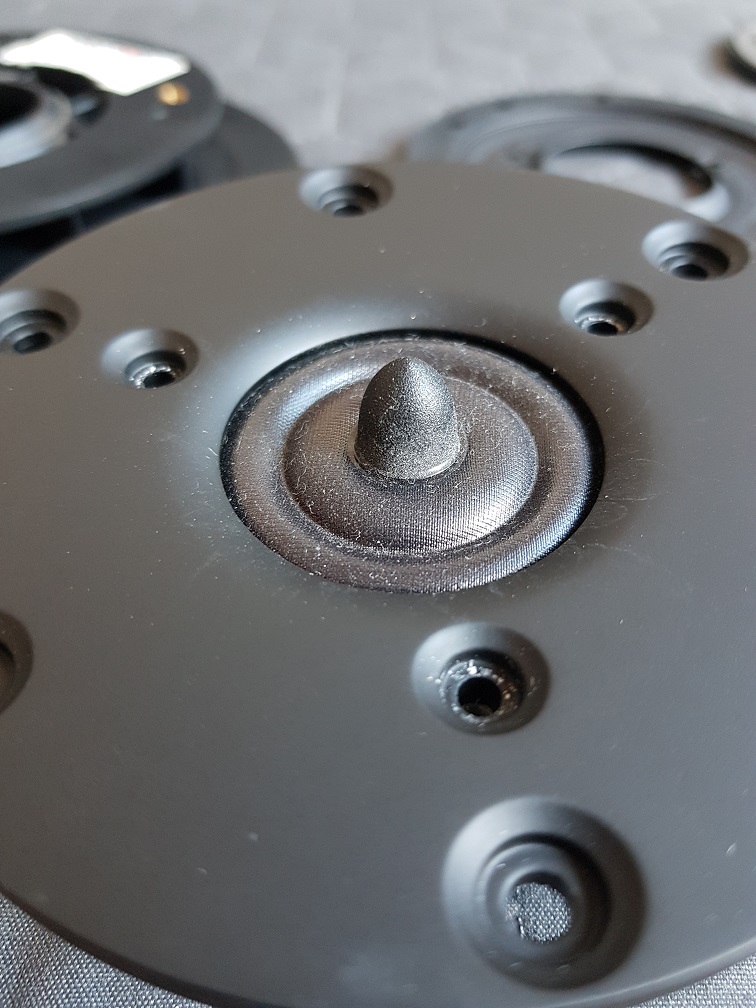

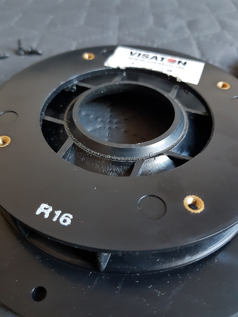

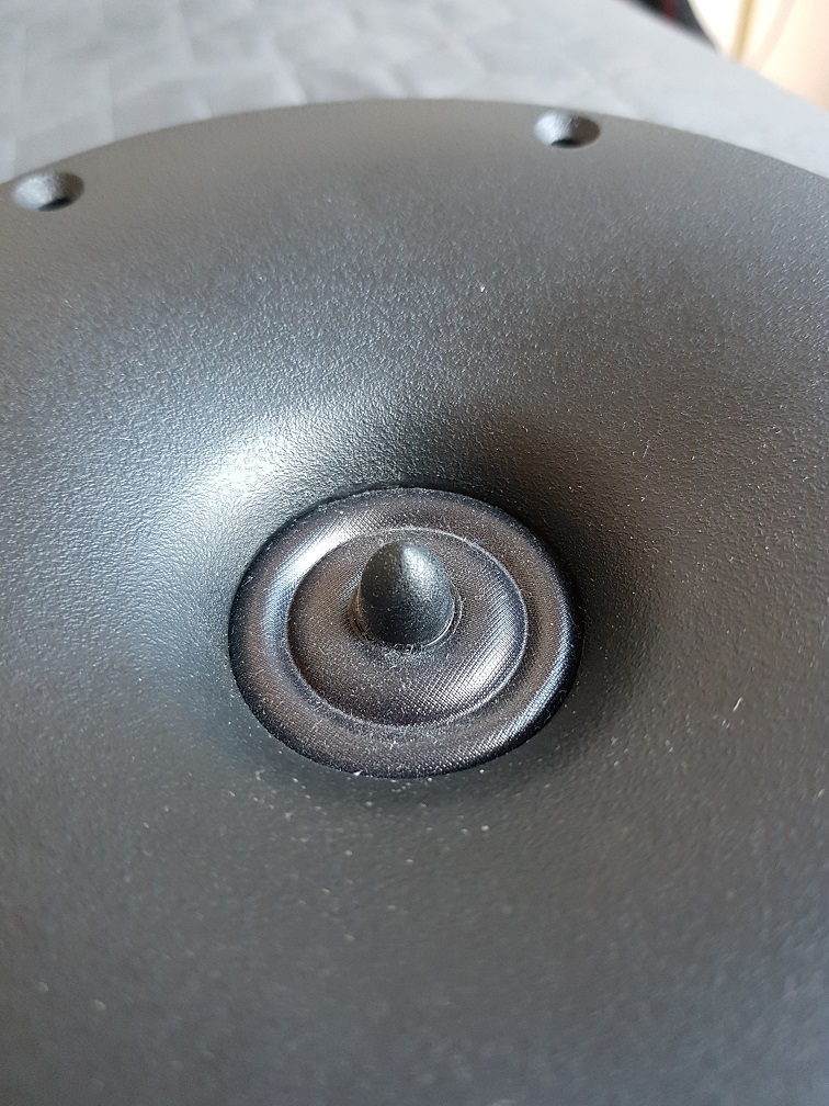

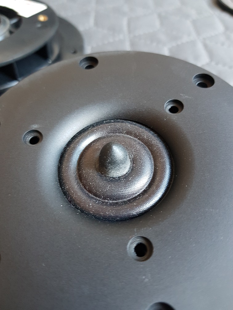

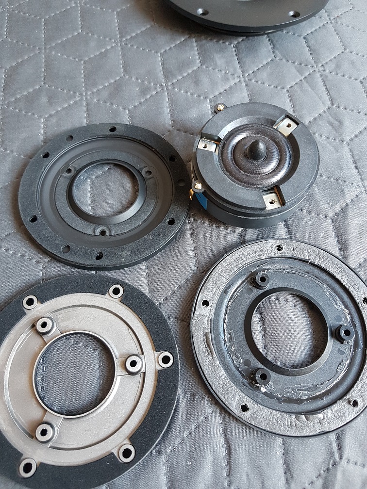

Measurements:
7100 and 7000 faceplates, diameter of opening for dome 39mm
WG148R diameter of throat 38.2mm. This is very tight fit, and it is better to chamfer the throat edge 45deg, ~0.5x0.5mm. It is very easy.
There are images in the attachment, XT25 in WG148R, XT25 + faceplate 6600, XT25 + faceplate 7100, photo of tweeter + faceplates, and WG with modified rear side.
I did not measure 6600, 7100 or 7000 outer diameter of suspension directly because I do not have them available.
Is the outer diameter of the XT25 suspension the same as with the R7000 or D6600?
