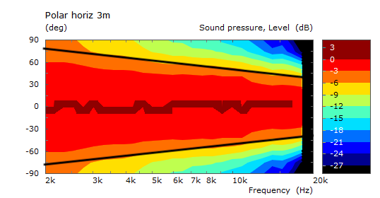

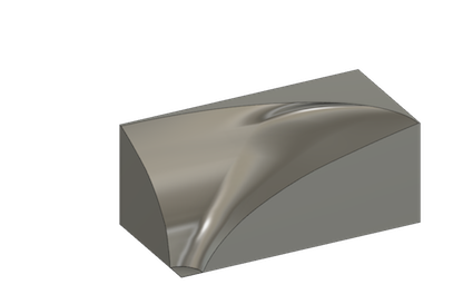

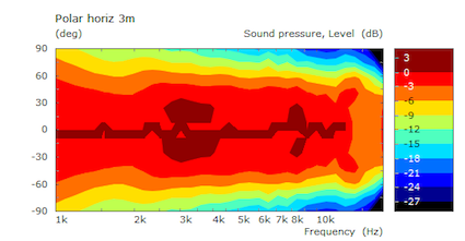

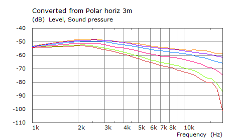

To me it was rather helpful to learn what the different steps are 'doing' in terms of directivity control.
However, some of the eliptical waveguides I worked on were quite ok anyway. For example th eone described here (sorry, again in German).
Very briefly:
The eliptical WG
The quarter model to get an idea of the contour
SPL in an infinite baffle
Horizontal directivity in infinite baffle
Directivity from 2-20kHz with -6dB highlighted by lines
...and in an enclosure
Please note, that these simulations have been done using an 'ideal' flat membrane at the WG throat in order to concentrate on the impact of the WG contour first.
The tricky thing is then to adapt a WG to a specific tweeter, i.e. to a dome, invers dome or ring radiator. and to adapt the directivity of the WG to the directivity of a specific bass-mid-driver.
The observation, that a small 'step' at the WG throat is extremely helpful to achieve a constant directivity at higher frequencies was a result of the subsequent work on simulating domes, inverse domes, ring radiators etc...

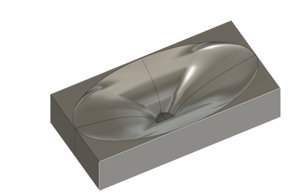

Take a look at what came out of the CNC machine here...
Those look fantastic! Any issues with fitment,etc?
I like that wall contour, sort of JBL M2-esque. How did you model that?
No problems at all! The fit is just perfect. Just a gentle push and the tweeters would hold on to the on the three "ridges" on the waveguides by themselves. I'd still use the screw holes for real use, but it shows how good the fit is.
