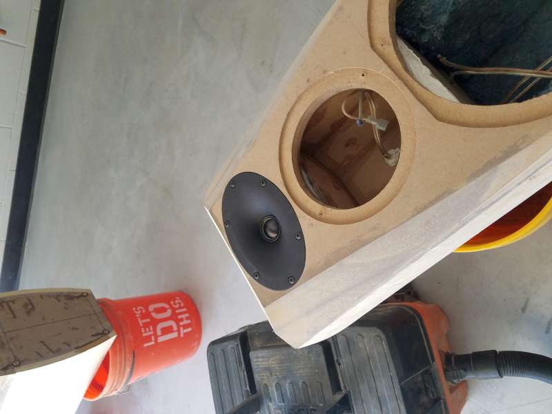

There are screw holes in the waveguides, usually on a 4" circle (the smallest waveguides are a bit smaller). Make a little bar and a foam rubber strip between the bar and tweeter.
Additonally I would seal at the following some blue tack or similar. With some of these tweeters I'm not confident there is a very good seal there and you don't want the woofer to be pumping the tweeter.

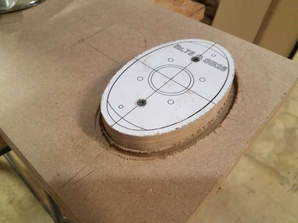

For me the tricky part was that I fabbed the baffles before I had the waveguides built, so I wasn't able to use the waveguide to make the template. I ended up importing the waveguide file into SolidEdge, making a 2D drawing with a 7/16" inward offset which I then used to make a template. I screwed the template to the baffle and routed the recess using a 1/4" bit and a router bushing.
Here's a PDF of the drawing. Print it out 1:1 on 8.5x11 paper and stick to to your templating material w/ some spray adhesive. Depending on your router bushing and bit size, you may need a different offset. Augerpro - if you'd like to toss this PDF up on your website, feel free to download it and re-host it.
SB26 5 vG template.pdf - Google Drive

How did you made the template ? By hand?
Attached is the walkthrough I found years ago to route irregular shapes. The website is long gone, but luckily I saved the page to my computer. Just click on the baffle.html file. Once you've done it once it will all make sense, so do a practice run first. Also make sure to make alignment marks, like a cross or something, at every step. This will ensure when you finally lay the template on your actual cabinet you have a way to align it instead of having to eyeball it.

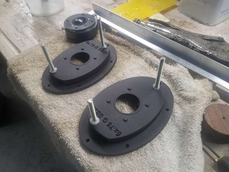

A number of you wanted to know my slicer settings, but now that I've redesigned the phase shield and started printing face-up, there really isn't anything special. Layer height: .12mm, top and bottom layers: 4, perimeter shells: 4, max fan speed for bridging, random start points on perimeter. The main thing is to generate supports under the throat so that interface to the tweeter is round and flat. Filament brand makes a difference. I had a tough time removing Hatchbox supports from the phase shield, while eSun PLA+ supports come off with less effort and more cleanly.
