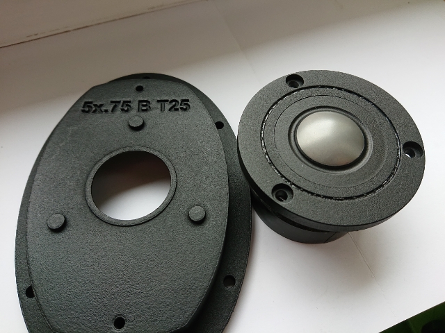

These waveguides would come with an obvious disclaimer saying your tweeter warranty is void the moment you open it right? If not - time to add one!
I've verified my model is larger than the surround, and that the hole in the faceplate must be almost identical to the outside of the surround. Therefore the lip of the waveguide is resting on the part of the surround glued to the faceplate, which is in turn resting on solid metal. So the waveguide is behaving as any faceplate on a typical tweeter does.
I'm confirming with the user that his throat is actually 1.21", and not slightly smaller which can happen in DIY printers. This should leave .02" of clearance around the surround.
Once that is confirmed I've sent a variant with no lip for the user to try. I'll also print it, but won't be able to do measurements for about 2 weeks.
Also, I use foam between the clamp and tweeter so you have some measure of control of the pressure. If you just tighten rigid parts I could see applying very high pressures easily.
So at this point I'm leaning towards the throat on his particular print is just too small, or clamping pressure was too high. That said I need to test myself. Perhaps that cavity created between waveguide and faceplate due to the lip is doing something weird. Maybe clamping down too hard actually bent the waveguide enough that it started touching the faceplate where there should have been a gap (again, due to the lip around the throat) that is creating buzzing which showed up as higher harmonic distortion? (that is how he first noticed the issue)

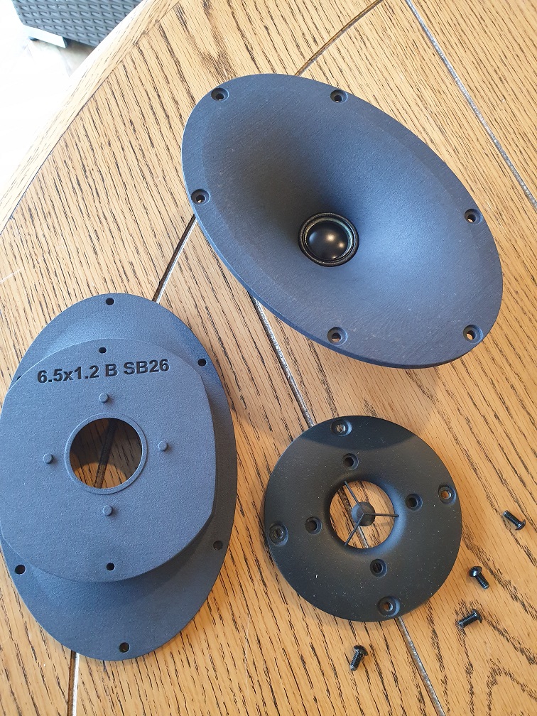

- use foam to seal the tweeter on the waveguide (I use 2 mm foam see picture)
- check and adjust the inner throat diameter to the proper value (>30.74 mm)
- Don't press the back of the tweeter too hard to avoid excessive pressure on the faceplate nearby the surround via the annular ring. On my side I added an 0.5 mm thick washer on the 3 centering dots to reduce the clearance slightly

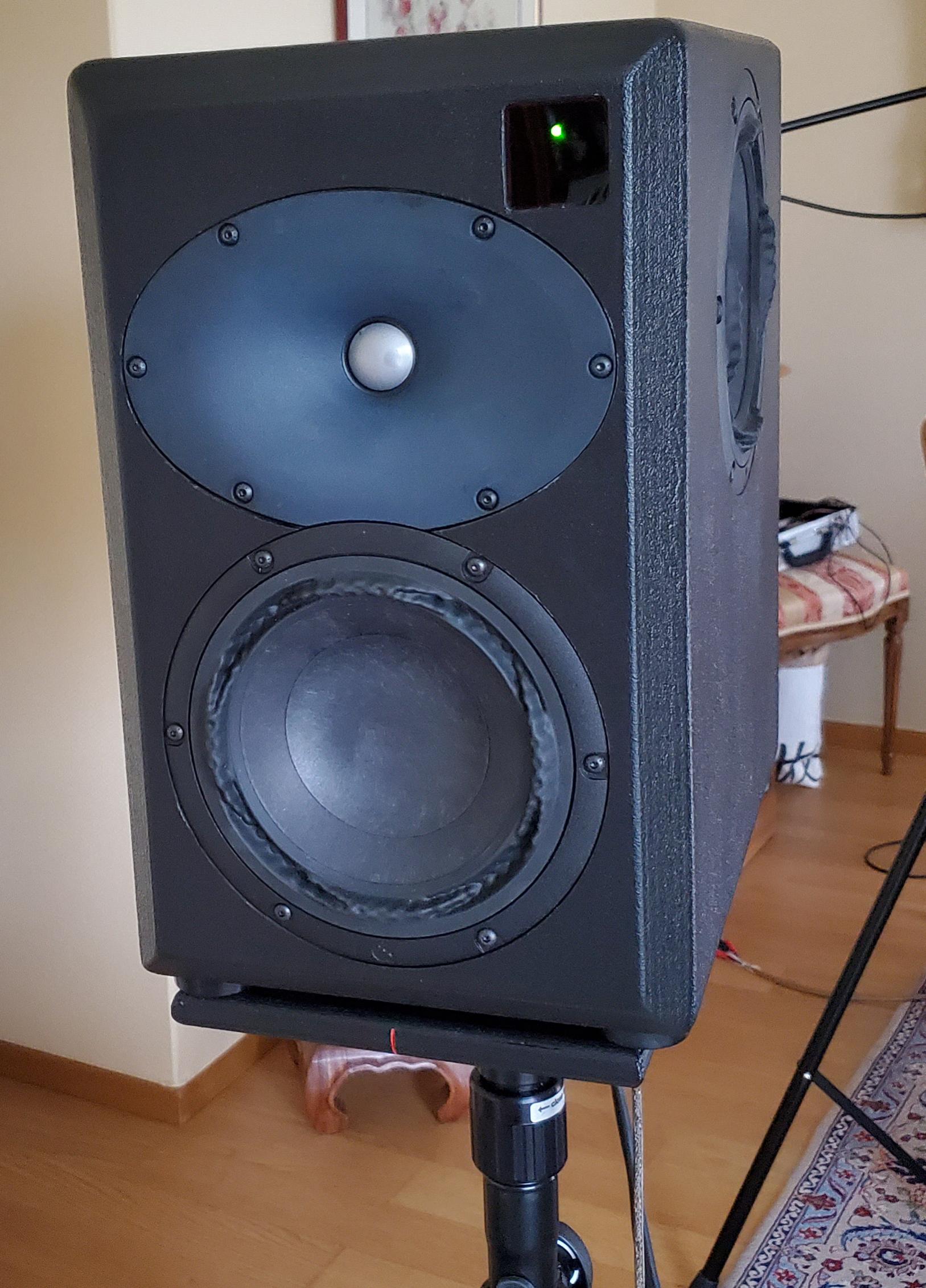

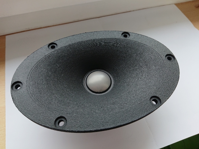

Mine just arrived from printing company, looks fabolous
thanks for this project!

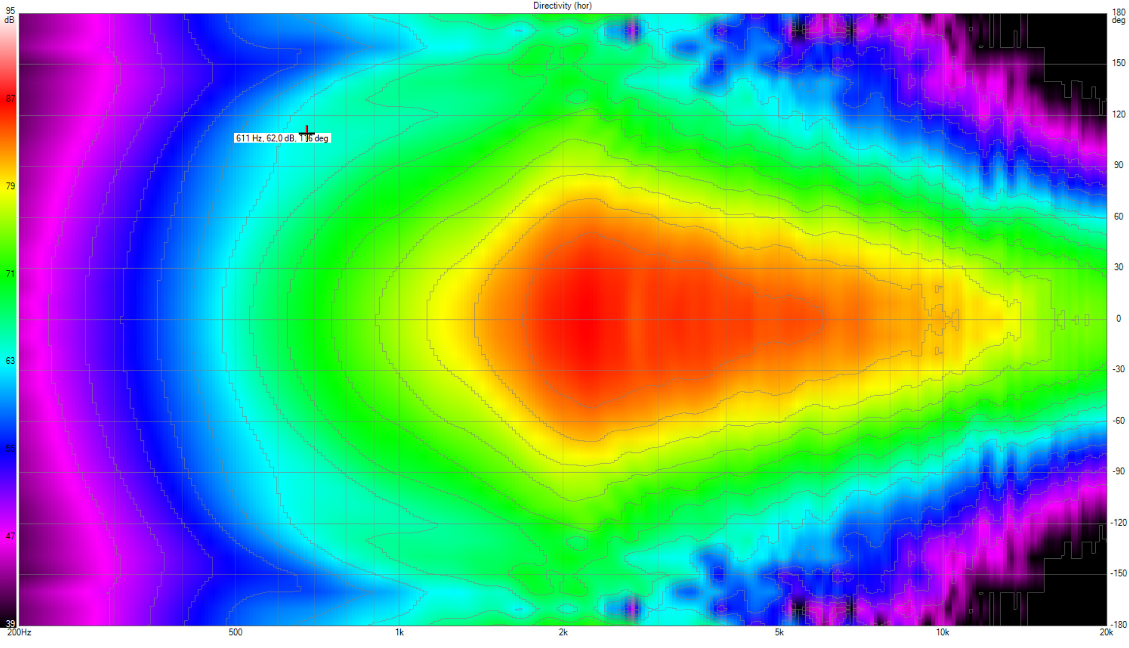

I spent the past couple of days on that and I found that adding foam between the waveguide and the faceplate will introduce a dip in frequency curve. I tested 2 different foam ring, one introduced a 4 kHz dip and the second à 12 kHz dip. So at the end I removed the foam.
The best results in my case were obtained with no fixing on the back, a small 0.5 mm thick washer on the centering dots and blue tack at the periphery of the face plate to hold the tweeter and seal the combo. I also have A have melamine foam in the enclosure just behind the waveguide pushing gently the back of the tweeter (just in case).
You can see an untouched horizontal +/-180° polar map.
Jean Claude
Jean Claude
