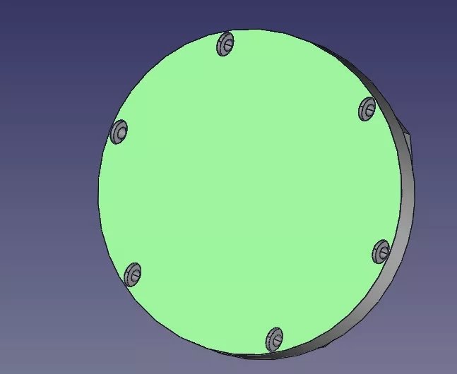

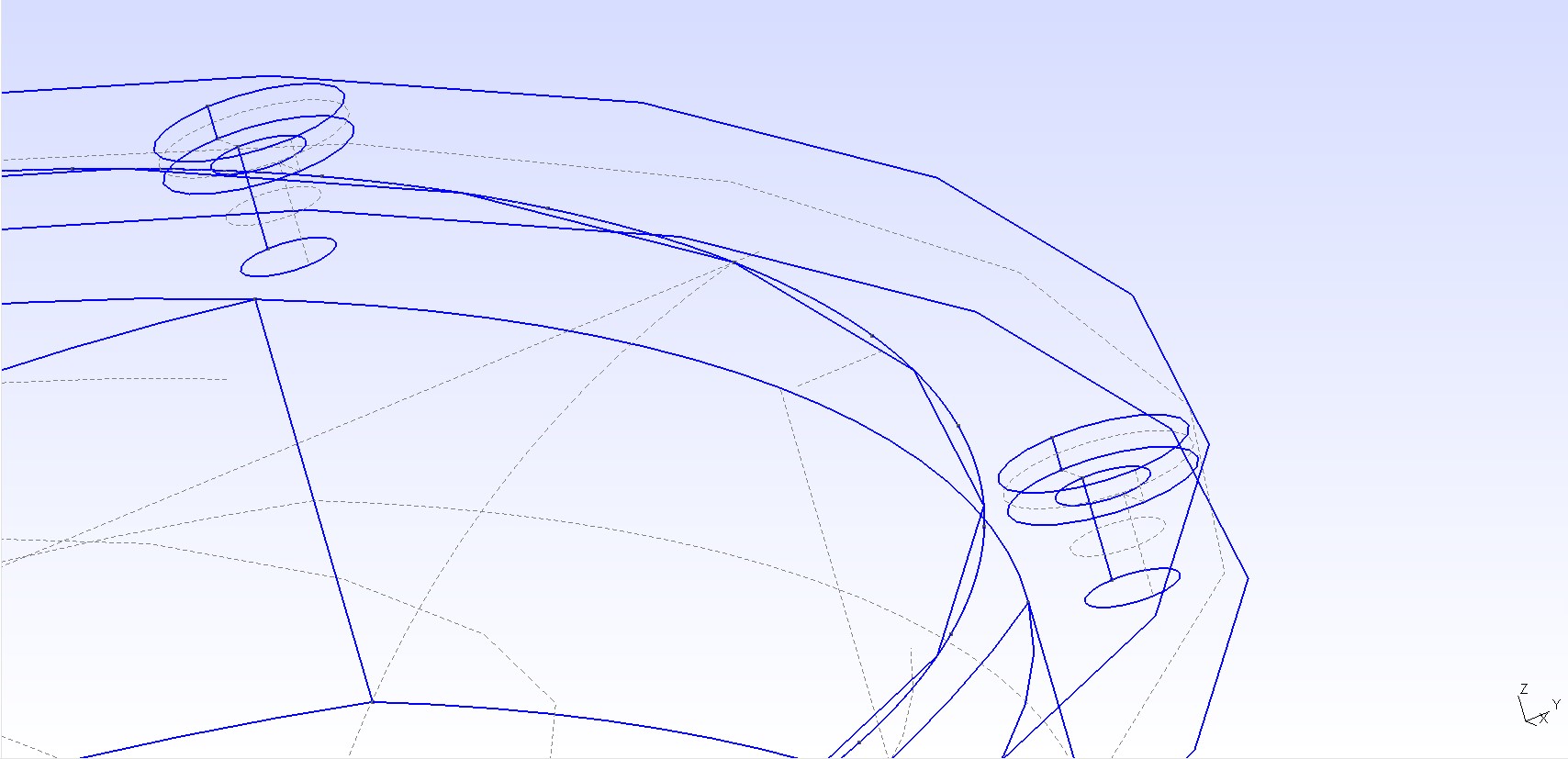

There it is. All pictures deal with the 6" version (sb26), step files.

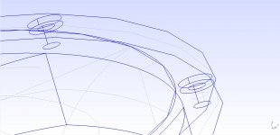

First picture is the file loaded with freecad 0.18. I tried to fix the flat face, after removing it you can see on picture 2 what i explained in my last post.

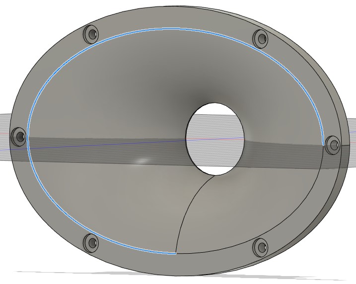

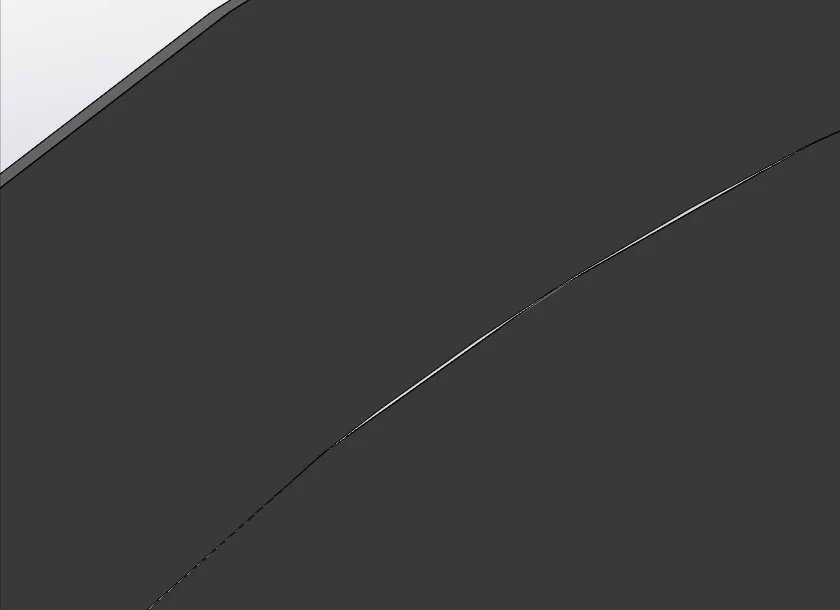

I tried to open it in Fusion360, and export it back to freecad always in step format. This time the file opens correctly in freecad, but still some issues as you can see on picture 3.
Hope this helps [emoji4]
The resolution that circles and arcs are displayed at in most cad programs, FreeCAD Included can be changed, as you zoom in you notice that the circle is a polyline. It's display related not geometry related. Keeping it low helps to refresh the screen quicker with changes.
That's what I see in your second and third images.
You'r talking about CAD visual resolution representation, and it' not happen on the 6.5" Step :
This kind of things happen when geometrically the surface (or the volume/bodies after this) haven't the same edge, like it's two different volume stick together but not "sharing" the edge, sometime there is a gap, sometime the two edge overlaps without merging.
Whatever the visual resolution representation in CAD software, a shared edge between two volumes or surfaces has never a gap or a overlaps, even in STL format (3D printer will do strange things other wise).
So present problems could come from how the 6" model is design, export, or if the Step come from a STL (Step must come from original format), but I don't thinks augerpro does this.
It can be a different way to design the 6" (unchecked merge when creating volume or something like this), it can also be the export also, by default in Step export all surfaces/volumes is exported in geometric but you can change it to wireframe and/or to not export some faces/bodies.
First picture tend to show that this hypothesis could be valid, so with a miss-click it will miss a surface or a edge that other CAD (but not the STEP viewer that will fail) will try to recover, as CAD software launch a optional functions recognition after opening a Step.
The last picture can be Fusion360 trying to recover edge to not merged volumes, or a mix of everything 😀, like if the elliptic shape is no longer a geometric shape but a mesh shape (truly not "only" in representation).
A Step that produce a fatal error in a Step viewer is not a good sign ^^ ,as the 6" step does but not the 6.5".
Step doesn't have a resolution itself, it's a ISO geometric format mainly design for lossless exchanges or transformations (like 2D vector format).
There is two Step format : STEP AP203 and STEP AP214, AP214 is a extension of AP203 that add color and layer, so may be it's just because it's a AP203 Step and not a AP214, but I have try to re-export 6.5" Step to Step AP203 and I can use it again in his original geometric shape.
But a re-export, just in case of, of the 6" in STEP AP214 (geometrics, not wireframe, it will fail) from the original could solve the problems, a check of the front plate and elliptic volume/bodies too, about merging volumes.
STL is a format that is a 3D mesh faceting representation of a geometric representation thanks to a parametric resolution, that is usually generated from the proprietary format (Fusion360/SolidWroks,AutoCad...) or... from a Step file 🙂
Sorry for the long post, I have try to write it for have to a common understanding ^^

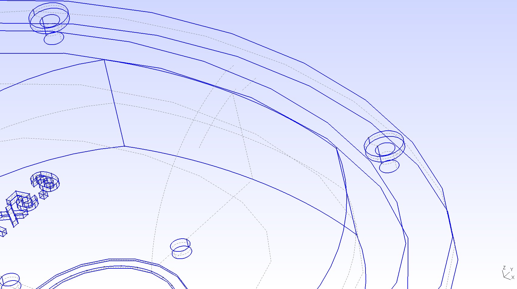

Yes I was because FreeCAD defaults to a low level and if you draw a circle and zoom in it looks just like those images.
I can see the point you are making about the differences between the 6 and 6.5 versions when I open them in gmsh.
In the 6.5 (right image) version the top elipse that joins the waveguide profile is a single profile.
In the 6 (left image) version there are two separate edges creating that odd gap.
You can see it where the dotted grey line that represents the profile meets the ellipse(s) in the middle of the images.
It's the opposite way round where the back thicker sections meets, in the 6 it is one profile and in the 6.5 it is two. Not that it really matters in that location though.

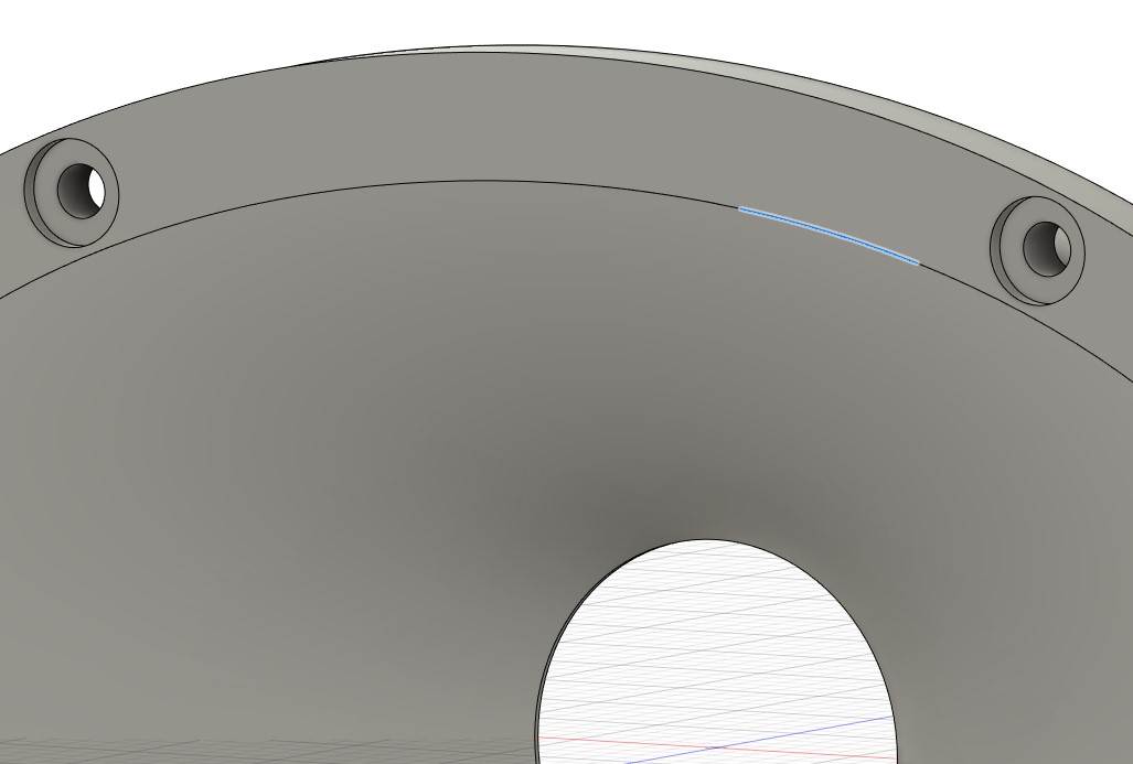

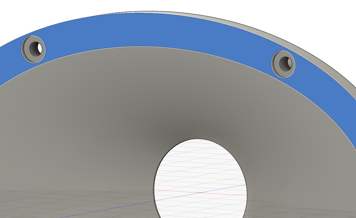

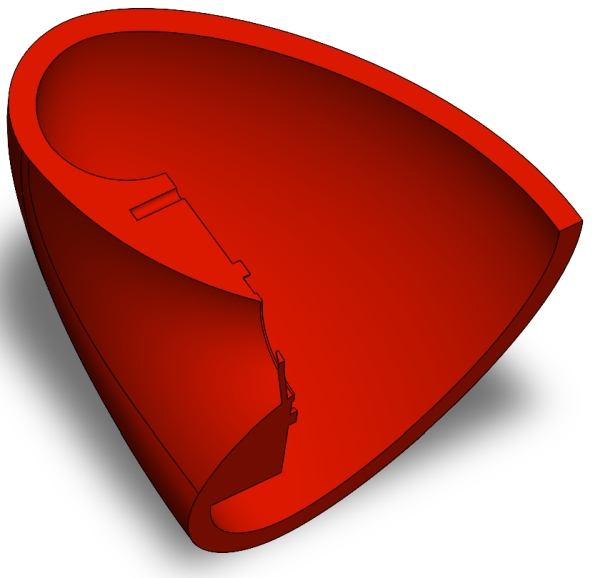

I opened the .step in F360 and nothing seems wrong to my eyes. Zebra analysis is ok. If i zoom in on that seam you can see the curve go to straight lines, but that is just the visual rendering as mentioned above. Opening the .stl to look inside the model I see not issue at that seam. Attached is a pic. You would see an internal surface drop down vertically from that seam if there was an issue.
I wish I had a better answer, clearly the different softwares behave differently and some suggest a problem where there is none, but what can I do about that? All I can say is that they print fine for me and my slicer never has an issue.
You could see it in fusion when the outline of the elipse was selected. On the 6 inch version the polyline is on top. In the 6.5 the elipse is split but represents what you intended.

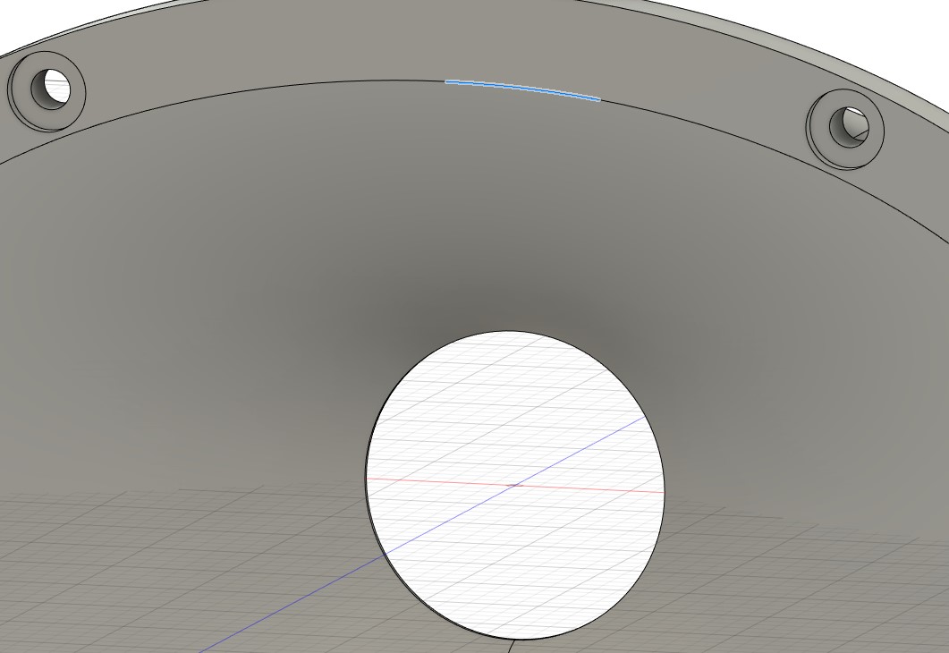

Brandon it looks the same to me.
It seems like the top surface where the mounting holes are is using an elipse as it selects as a face. The edge of the waveguide still selects as a polyline which is what was shown in gmsh.
Removing the two separate lines and only having one should fix any boundary related issues that might throw an error.
My point with what you changed is that you ended up with the polyline and not the section of ellipse that comes out in the 6.5 version. Meant as an observation not a criticism 😉
fluid> ok, the software angle for processing these files isn't something I know terribly well so I wasn't sure if I was following your comments. Thanks
NicoB> no problem. If anyone see something similar let me know. I'm going to go through all of the files on my website as soon as I get some T25B testing done, to make sure I didn't accidently skip the step that caused this issue.
