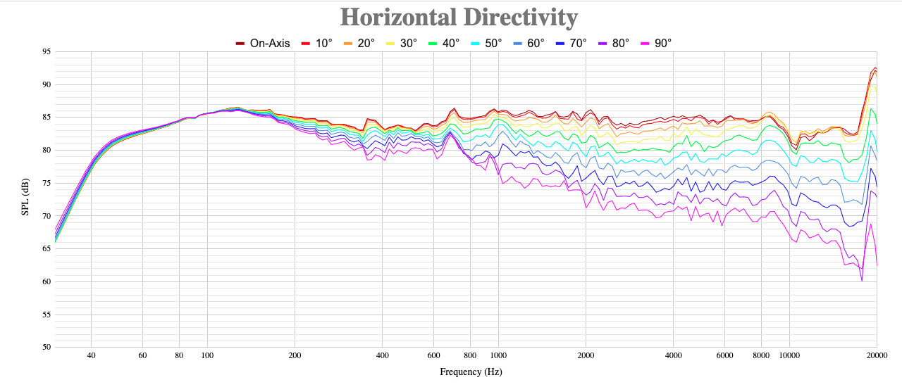

I am using the 8" with the SB26ADC with an 8" woofer (scanspeak 22W 4534G)
I haven't done explicit directionality measurements, but the directivities "should" match in the 1700 Hz range based on comparing augerpros charts and the measurements I've seen of the 22W.
Subjective listening on and off axis has me slightly preferring a lower cross. I settled on 1350 LR4.
I assume 1350 XO center freq. doesn't look as pretty as a 1600 or 1700 cross in the full series of off-axis plots, but the design axis is ~23 deg off-axis and sounds quite good. I think running the cross below the ideal directivity match is much less of an issue than crossing above that ideal, and the SB26ADC has zero issues playing low. THD in the 8" waveguide looked quite good down to 1000 Hz, even at high volume, and listening to low cross, my ears agree, it doesn't sound overly strained.
This is in ~22L boxes using Hypex Fusion amps so I can adjust the FR and XO at will. These are really just temporary boxes, they will eventually be built into a media center that will add subs as well (also powered by the Hypex fusion amps,) so essentially will be used as on-wall speakers like you're planning.
FYI, the 22W I'm using is not staying pistonic. It starts deviating from pistonic just under 1000Hz, but it has a graceful poly breakup that just exhibits some rising 3rd order distortion. I think an RS225 should work fine as long as you can bury the breakup peak of the aluminum cone, but like in my case, you will probably want to cross lower than at the ideal directivity match. I really don't think it's THAT big a deal to cross below the ideal directivity match.

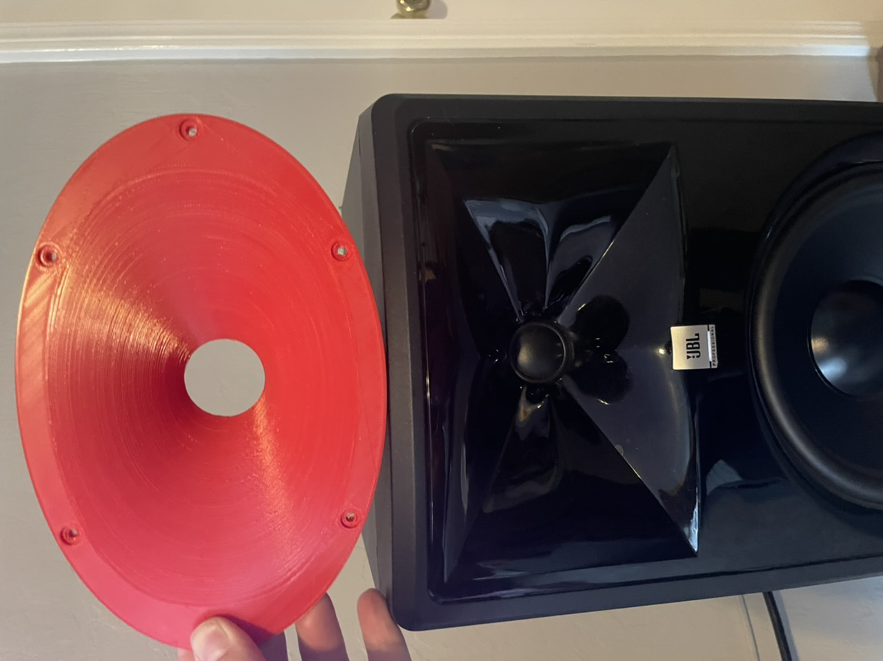

Hey, thanks a bunch for the replies! You’ve given me hope that this could be a fairly viable project. I use the RS180 in the Modula MT right now and I’m a fan of the drivers in general. If I can make it work here then it’s potentially a fairly high value project. Heck, maybe I can take some inspiration from one of Jon Marsh’s crossovers to keep the break down! In the meanwhile I have a minidsp for prototyping.
Warming up the printer now!
One is done at 15% infill! This is just my random PLA. The surface is a bit rougher than I would like, but with some elbow grease I suppose it can be better. It feels sturdy, I bet that at 100% infill it will be great.

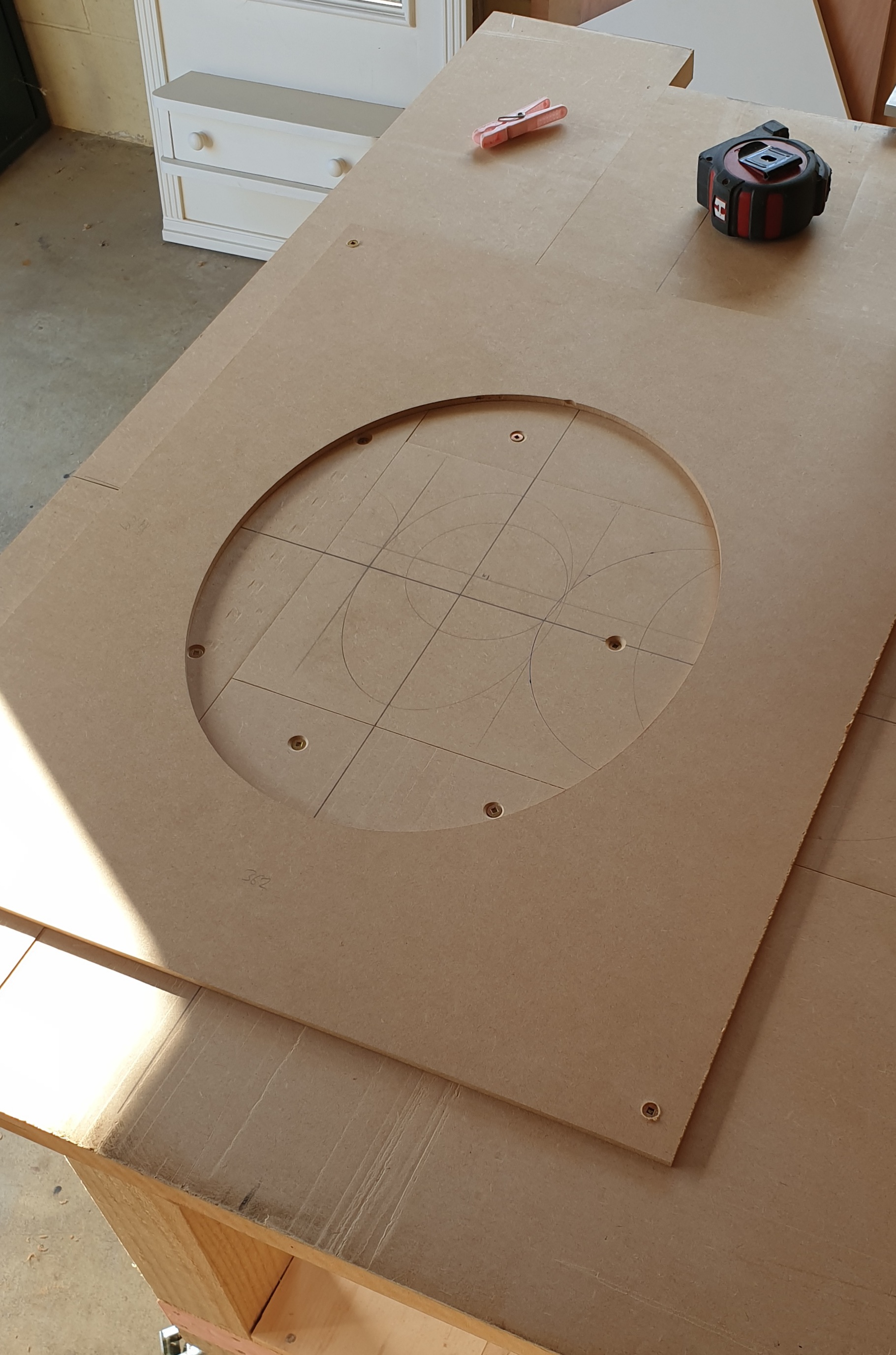

How do you folks cut an oval hole of the right dimensions? Every time I try using a jigsaw for that kind of work it goes off into the weeds.
Router Required with round base.
Tip: How To Flush Mount Irregular Shape Driver -
Techtalk Speaker Building, Audio, Video Discussion Forum
Basically;
1. Fix the object being installed to a large scrap piece of 5mm MDF or similar.
2. Using 1/4” bit, run the router around the work piece to create a main “template”.
3. Make another round router base 1/2” larger than original used for trace.
4. Fix template to baffle or frame the object is being installed to
5. Route hole or recess using larger base on router around inside of “template”.
6. Make larger router bases for smaller holes or cutouts within “template”.

If you have a bushing plate, you can cut the big template as noted, then use that to cut a smaller template with the same base, then use a bushing to adjust for the bit diameter spacing to cut the recess into the baffle. The final template ends up smaller and is a bit easier to clamp and work with on the baffle, plus you don't have to make a base... sure it's not too hard to make a bigger base, but it's not totally simple, especially to get it concentric.
It's what I did... it was outlined earlier in the thread by someone.

If you cut the bigger base with a Jasper jig then getting it concentric is a doddle since the centering hole is already where it should be. The only thing to remember is cutting a circle two bit widths larger than the desired base size since the J.J. is calibrated for hole sizes, not offcut widths.
