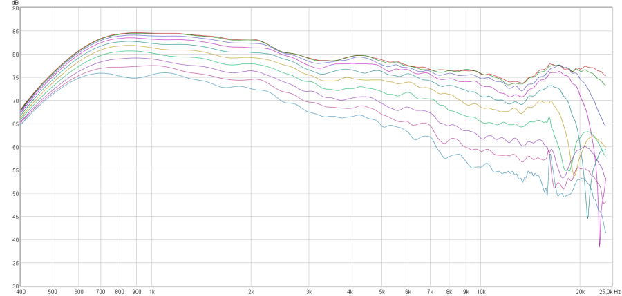

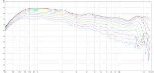

Ergo, thanks for Bliesma and WG measurement, it shows that it really has a potential. I definitely recommend to try roundovers at least R20, I have experiences with WGs of similar sizes in baffles of normal sizes, and WG responses were similar. Larger roundover always helped. I use R30. WG outter diameter is 170mm, depth 30mm.
Check the result here: SatoriWG7 :: Pkaudio
It is still not perfect, as WG profile was not machined pricely a the small diffraction at ~6kHz is probably from the midwoofer frame running into WG, next itteration will be better.
Earlier prototype with correct WG prototype was better in that regard. The baffle was just chamfered 15mm 45deg, which was not perfect in other regards (broad dip at 3-4kHz) - this made me to try R30 roundovers.

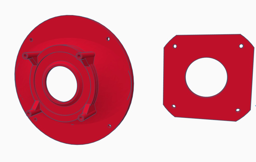

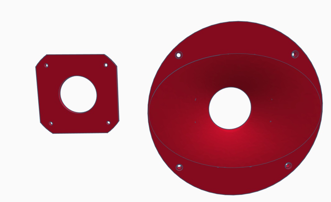

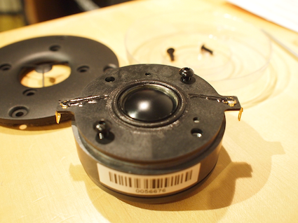

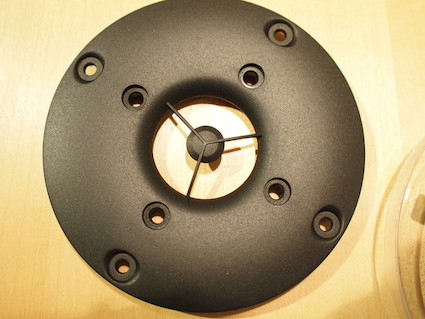

I have modified the 6" waveguide made originally by augerpro to fit ScanSpeak R2604 (also fits all other models with same faceplate, for example D2604). There is a round mounting plate that is easy to route for, diameter is 142mm, mounting depth is 6,4mm. The mounting holes are standard M4, diameter of holes is 130mm. You can use normal machine bolts to attach tweeter to waveguide with the backplate.
Dropbox - SSR2604wg.zip
Measurements coming soon when I can figure what's wrong with my measurement microphone. It shows a rapid drop-off starting from 8k, even from speakers I know can easily go past 20k...

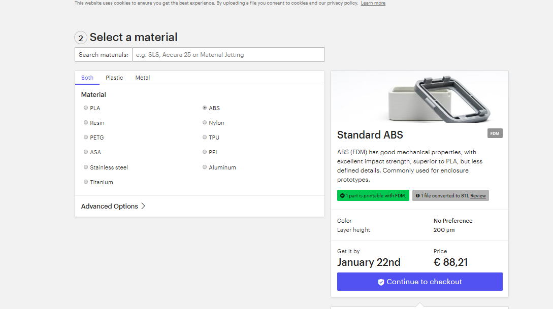

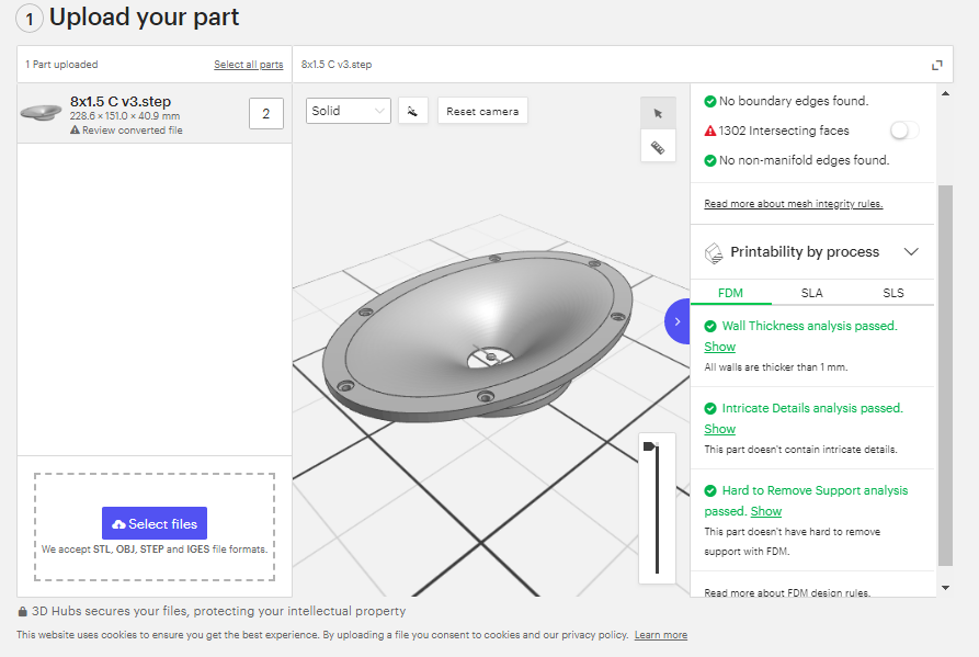

Im all new in regards to 3D printing. I found the following web-based-shop that can print in all kinds of materials.
ABS is cheapest, but nut sure if the quality is high enough.
And do you think this version is in its final stage?
