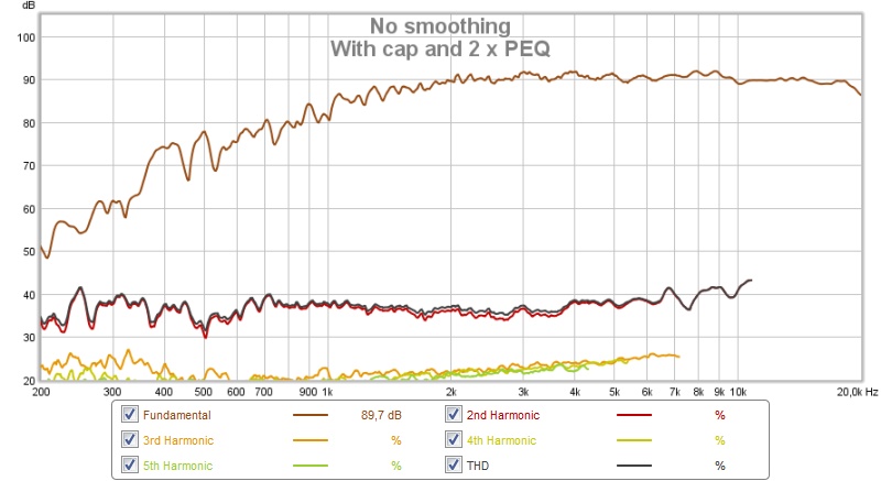

If the conditions were comparable (and assuming the curves show D2 and D3) I would say that the D2604 has better distortion result from these measurements.
1. The D2604 is measured at about 5 dB higher level.
2. The D3 is more important than D2 and is for the D2604 about 10 dB lower than for the SB26ADC.

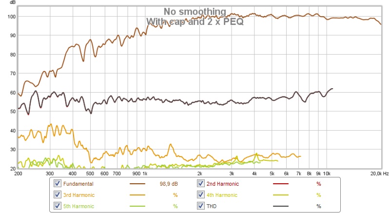

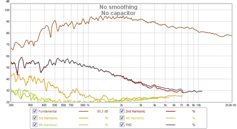

I've played around with a waveguide for the R2604/8330 and here is distortion for a large waveguide at 1 m:
And with an added 10 uF cap, at 90 dB:
And at 100 dB:
The 3rd harmonic is impressively low. Not saying the SB26ADC is bad though, just that the interpretation of the data felt off.

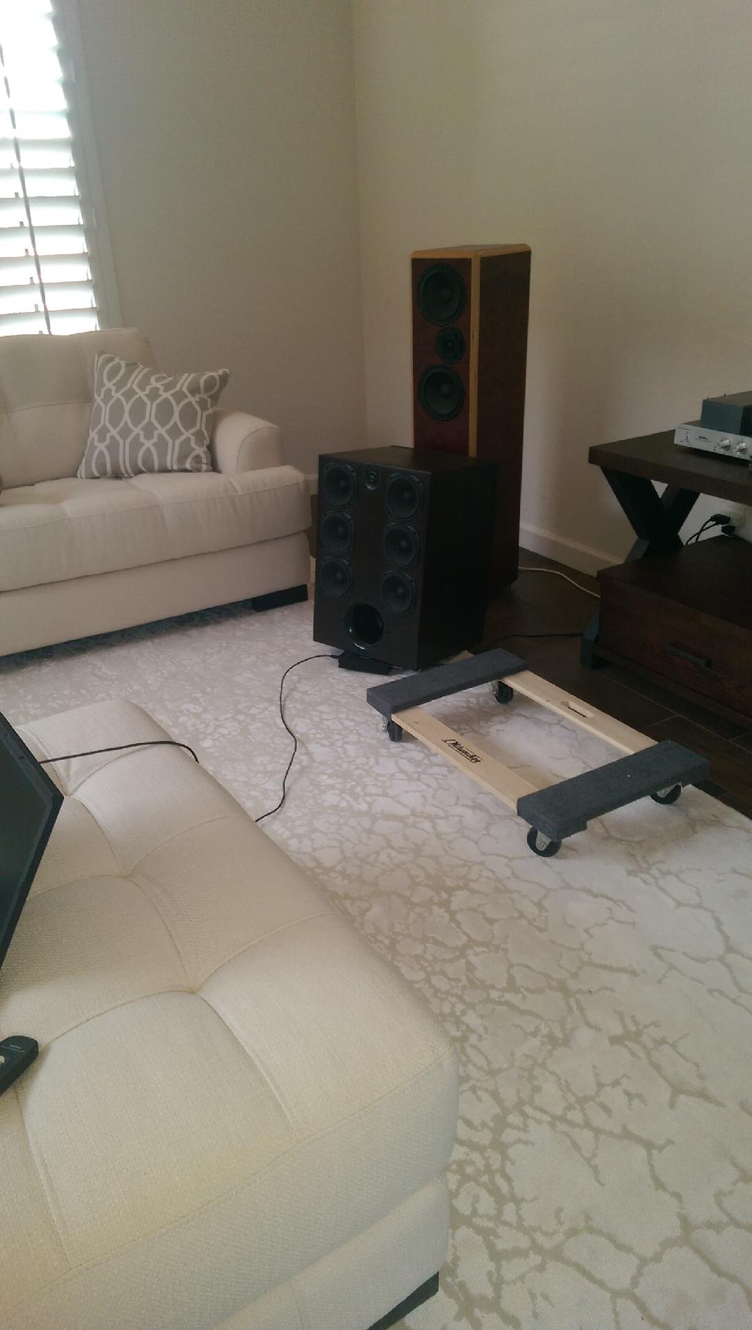

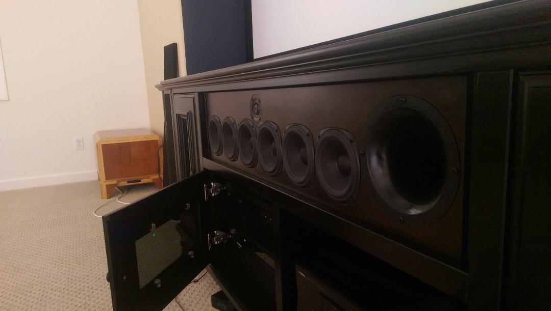

I'm well aware of the merits of the SB product: my last three speaker builds have used them: this is the LCR setup in my movie room:
Testing the left.....
As it stands, I plan on using an SB driver for both tweeter and woofer in this build 😉

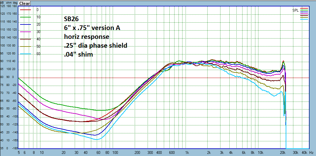

Here is the measured response of the 4" waveguide.
699856d1535349088-source-waveguides-cnc-3d-printing-9qn4iq9-png
Here is the measured response of the 6" waveguide.
attachment.php

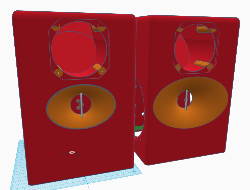

Here they are side by side on my project model. With the 4" waveguide, the CTC distance between mid and tweeter is 86mm, which is the 1/4 wavelenght for 1kHz crossover point. Below this point, tweeter and mid function as a point source. Another upside is increased enclosure volume, which will ease some load off the woofer. The design is extremely compact, only 250mm high, 170mm wide, 153mm deep.

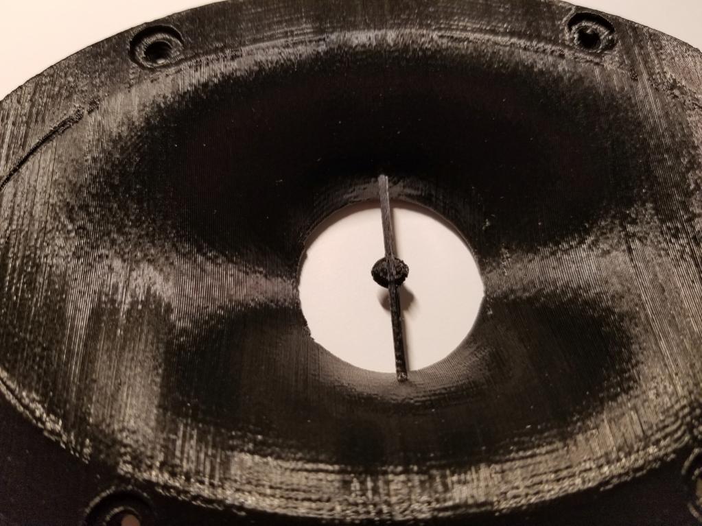

I tried getting the 6" G version printed on a 100um PETG process through 3DHubs, but the service provider wanted to make unspecified changes to reinforce the part -- at an upcharge, of course. So, I went with a 200um process, and I'm skeptical that it's usable -- too much striation. But the build quality is fine, so my skepticism of the 100um guy's proposed changes seems well founded.
I went back into the site yesterday to see if I could find a higher-resolution print option at an affordable price. With yesterday's pricing, a resin print at 25um was less than the original quote for 100um PETG (~$140 vs. ~$160 for two pieces). Also noteworthy: the upcharge for shifting from a 100um process to a 25um process was $6, but the upcharge to go from 100um to 50um was more than $10. So the 25um print was cheaper than a 50um print.
Net-net: 3DHubs is gig work for guys with printers, so you may need to play around with the various options on different days to get the right combination of process, price and provider (how's that for alliteration? :-o).
Even though I've got a low quality print in-hand, I'd make a suggestion for improvement:
It would be nice to have flat surfaces (rear flange?) to use so that one can square the ellipse to the baffle for those of us going the "print" route.
Also, any tips/tricks for mounting are appreciated. I haven't found a commercially-available ellipse jig that a) works at this small of a scale, and b) that fits one of my routers. I may have to trace my dummy part and free-hand the cut, but I'd prefer that as a last resort if there are better options.
