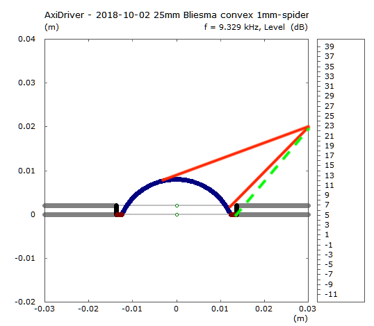

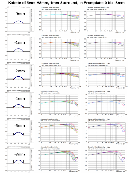

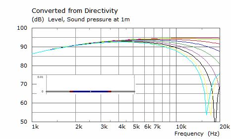

Hi Brandon,
With respect to the shims (or the 'step' at the WG throat as discussed earlier in this thread): Nice to see an improvement here with the 4''-WG.
From my experience, the possible improvement by a shim/step largely depends on the geometry of the respective dome applied to the WG. I'm working on the impact of the dome shape (both, concave or convex) on the directivity of tweeters and the possible implication for use with a WG over in the German DIY Hifi Forum here.
However, as you have to register to see the images there, I briefly summarize here:

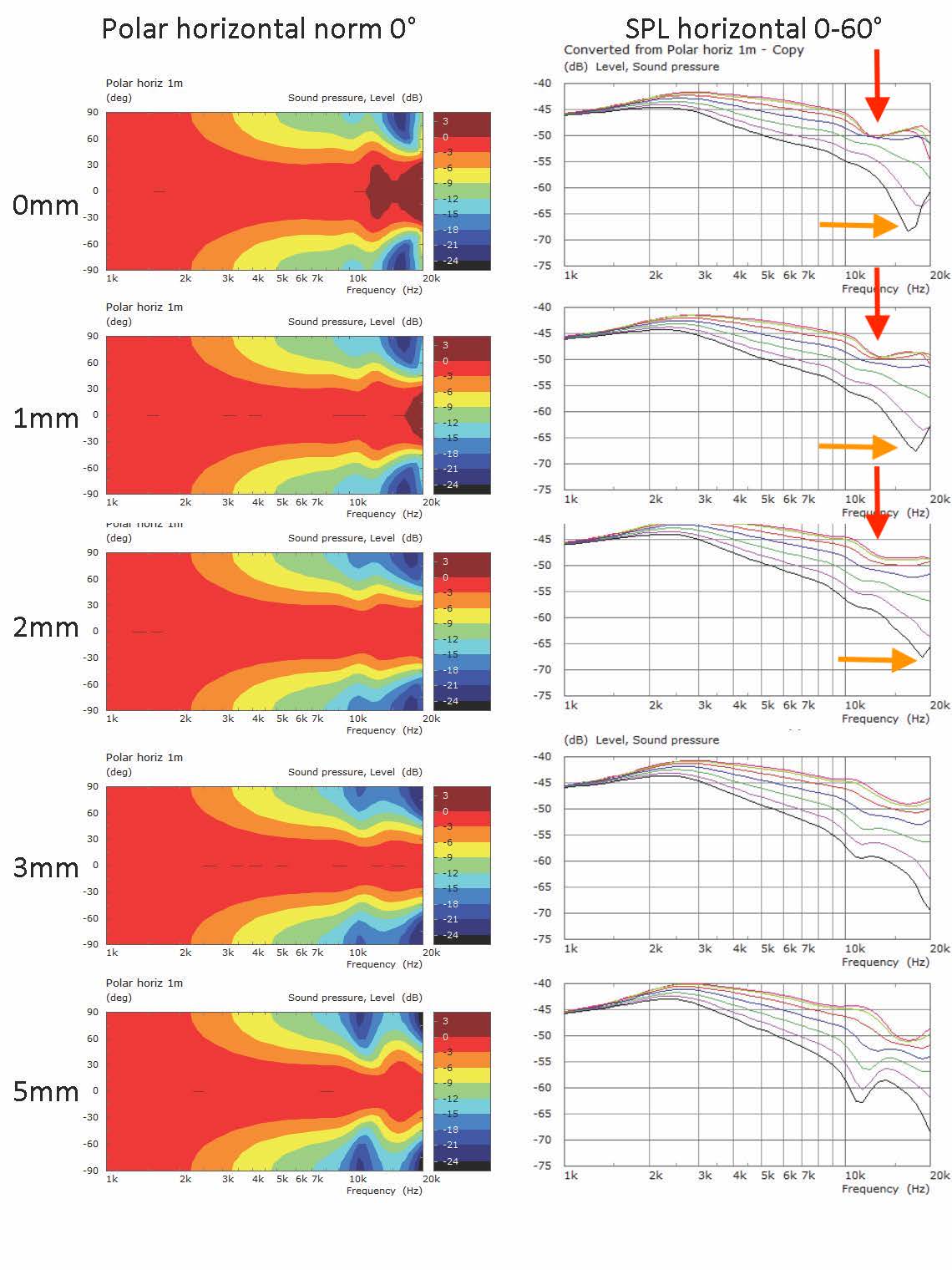

This one shows the directivity (here SPL from 0° to 90° and for sake of better clarity at 0°, 30° and 60°) of a dome tweeter with a 1''-diameter, a 1mm suspension and a dome height of 8mm in a infinite baffle - and the impact of 'Shims' or 'Steps' increasing from 0mm to -8mm on directivity.
You can clearly see the improvement with respect to a more consistent directivity at high frequencies around the -2mm step.

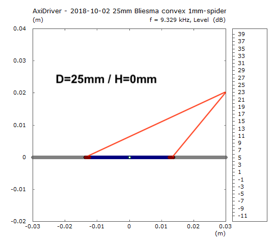

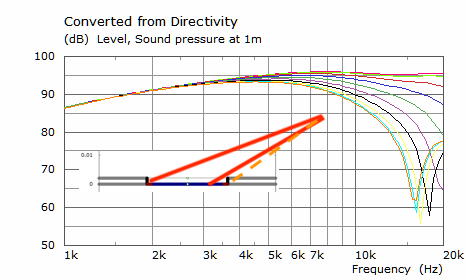

Directivity at high frequencies of a tweeter-WG-combination is largely determiend by the WG-throat...
What happens here? If we look at the directivity of a flat 1''-membrane we see increasing dips with increasing angles due to different travel times of sound from the outer edges of the membrane.
and

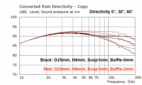

With a 2mm 'Shim' or 'Step'...
...dips under increasing angles are less deep or severe, because the step causes a 'virtual' decrease of the membrane diameter. Of course, increasing step-height introduces new issues by constituting 'secondary sound sources' (see first image with steps >2mm).

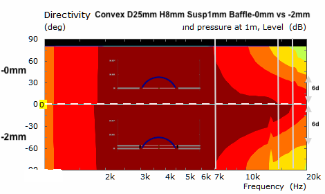

Basically same happens with dome membranes:
Comparison of SPL at 0°, 30° and 60° of a 1''-dome, dome height 8mm, 1mm suspension mounted in a flat front of with -2mm 'step' / 'shim':
Comparison of directivity:
Finally the impact of the 'Step' or 'Shim' on the SB26ADC mounted to an elliptical WG (contour derived from one of the 'Brandon WGs shown before):
Though the impact of the steps is quite obvious, arrows show some changes of interest. I think these dips were measured and discussed by Brandon before.

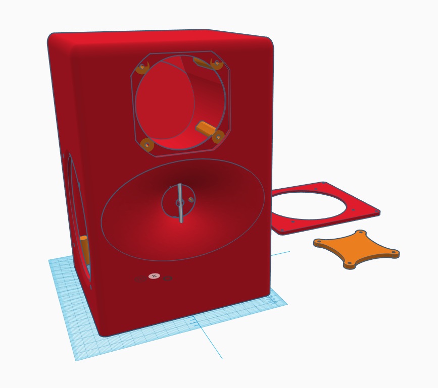

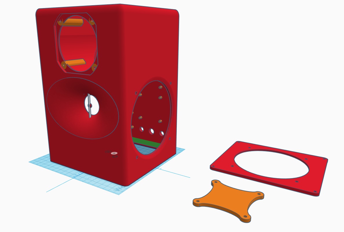

Here's sneak pics on my project with your 6" waveguide for SB26ADC, active 3-way monitor with DSP functionality. Genelec said they have the smallest 3-way speaker with 8331, I made it smaller. 🙂
Aim is to get same freq. response, but lower max SPL.
