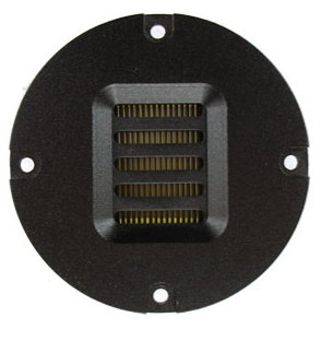

Have you done any modeling or fabrication for ribbons or AMT tweeters?
I've got some Airborne AMT tweeters that should work great in a WG, but no commercial product seems available.
If there is a model, I've got a friend with a 3d printer that has offered to print me some.

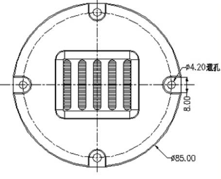

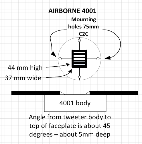

Brandon,
here is what the Airborne 4001 looks like, and I measured the dimensions as best as I could. No hurry on any sims, but I will try to respond quickly if you need more info.
THANKS!

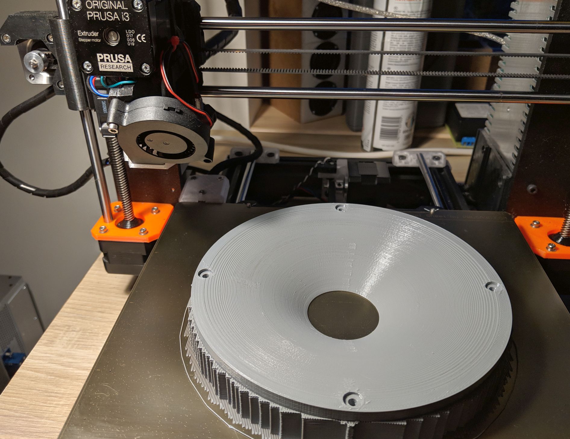

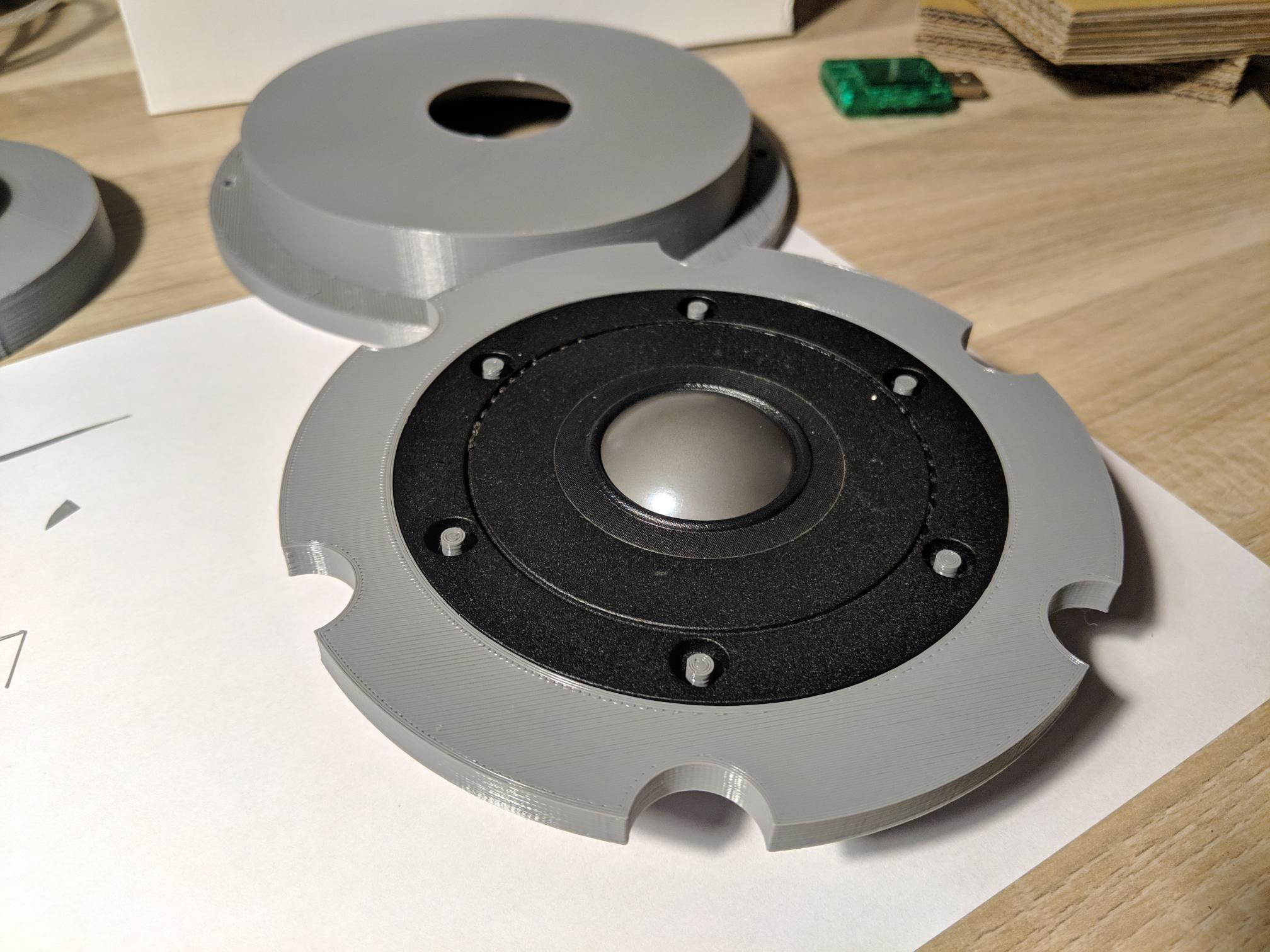

I did some waveguide printing this week and today some hands on testing as well. This is largely inspired by Brandon's efforts - so a huge thanks to him.
The driver: BlieSMa T34B-4
Waveguide: 165mm diameter - profile is a section of a radius of bigger circle. Printed on Prusa i3 MK2.5 - 0.2mm layer with linear advance, material PETG

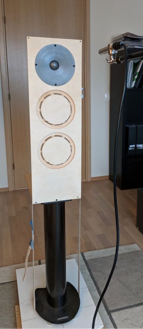

Test baffle - 220mm x 700mm baffle as intended for the final project (2.5way with 2x Satori MW16P)

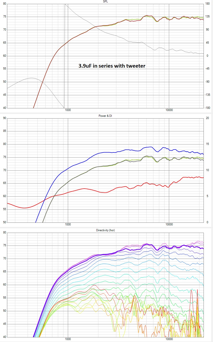

Test conditions:
Mic to baffle distance for off axis measurements: 600mm

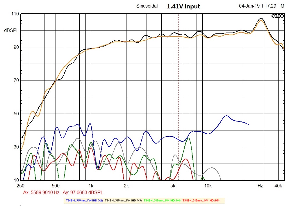

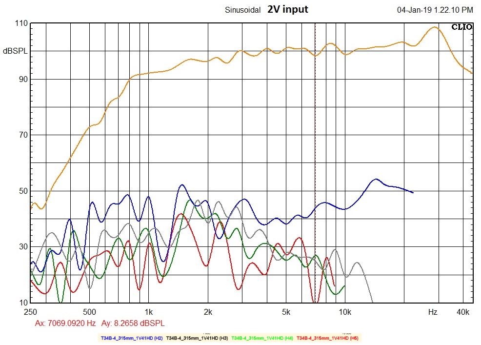

In addition two THD measurements
Mic to baffle distance for THD: 315mm
I tried to keep plots comparable to the hificompass.com test

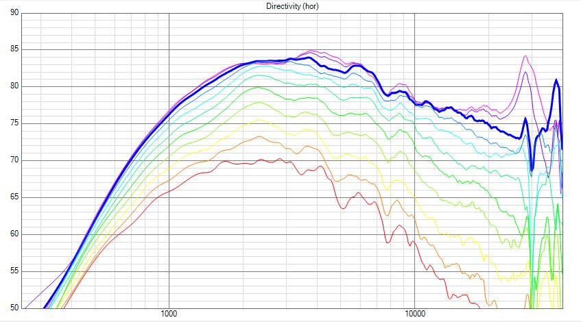

All in all, not a bad result for a first attempt to find a profile for this huge dome tweeter. I will try to print a phase shield out of interest too. There is a small dimple at 7.6k that could maybe be improved a bit, but not sure yet if it is that or might it be also the baffle edges as I'm using a realistic baffle not a huge IEC type baffle here.

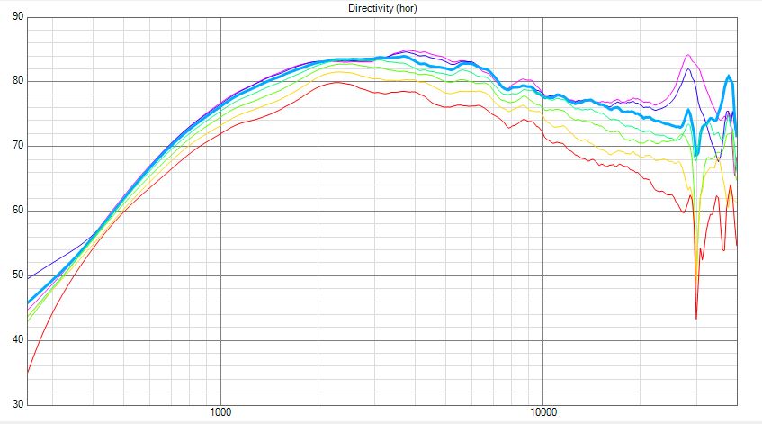

By the way Brandon - do you normalize the measured curve levels around 1.2k? One aspect where our plots differ is that mine show some beaming effect already at 1k while yours match at that frequency for all angles. I could process my data same way if thats the case.
I did rotate around the vertical center axis of the front panel.

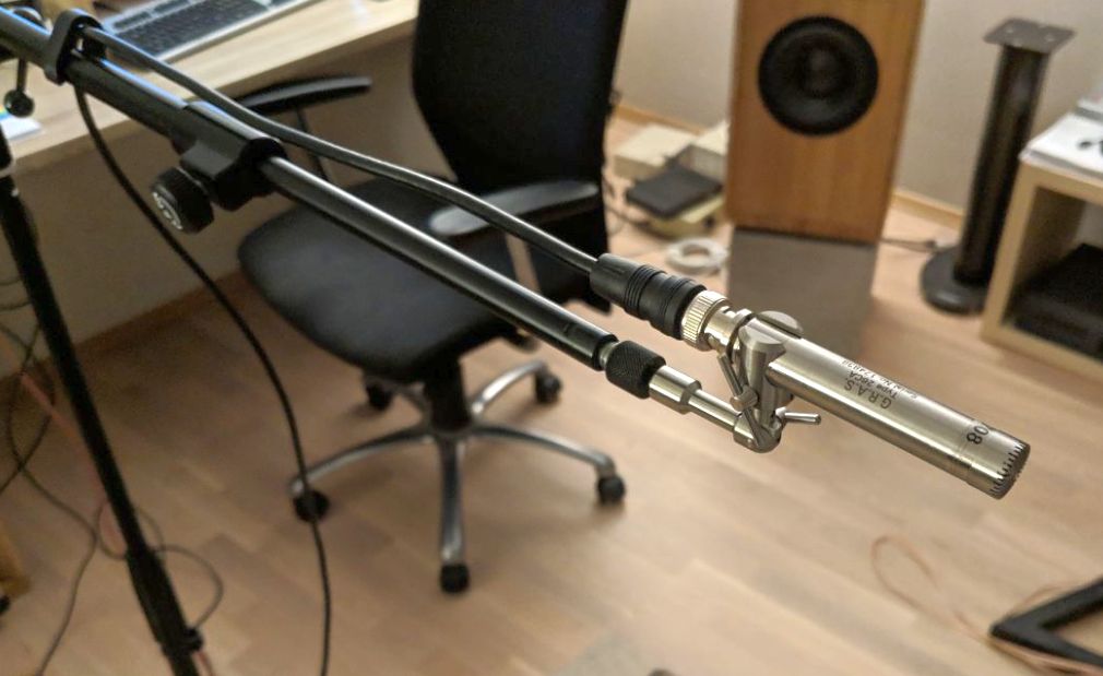

At 7khz you shouldn't see much baffle diffraction showing up with that design. I assume you are using a calibrated mic? My next guess would be the mic holder, if you have one of those typical saddle shaped ones it will reflect back to the mic tip, which shows as ripple in exactly this area.
Your waveguide is bigger than most of the ones I've done, so that will show up on the low end by how much baffle diffraction starts to creep in. Plus my baffle is approx. 1.2m x 1.7m, so that diffraction shape will differ between us too.
Thats a worthy to check idea. I'll experiment with some foam collar on it tomorrow.... it should be quite ok though and the mic itself is known to be flat there and I do use the cal curve yes. Though this one is pretty good to beyond 20k even without the cal file 😉
