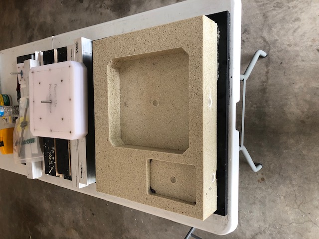

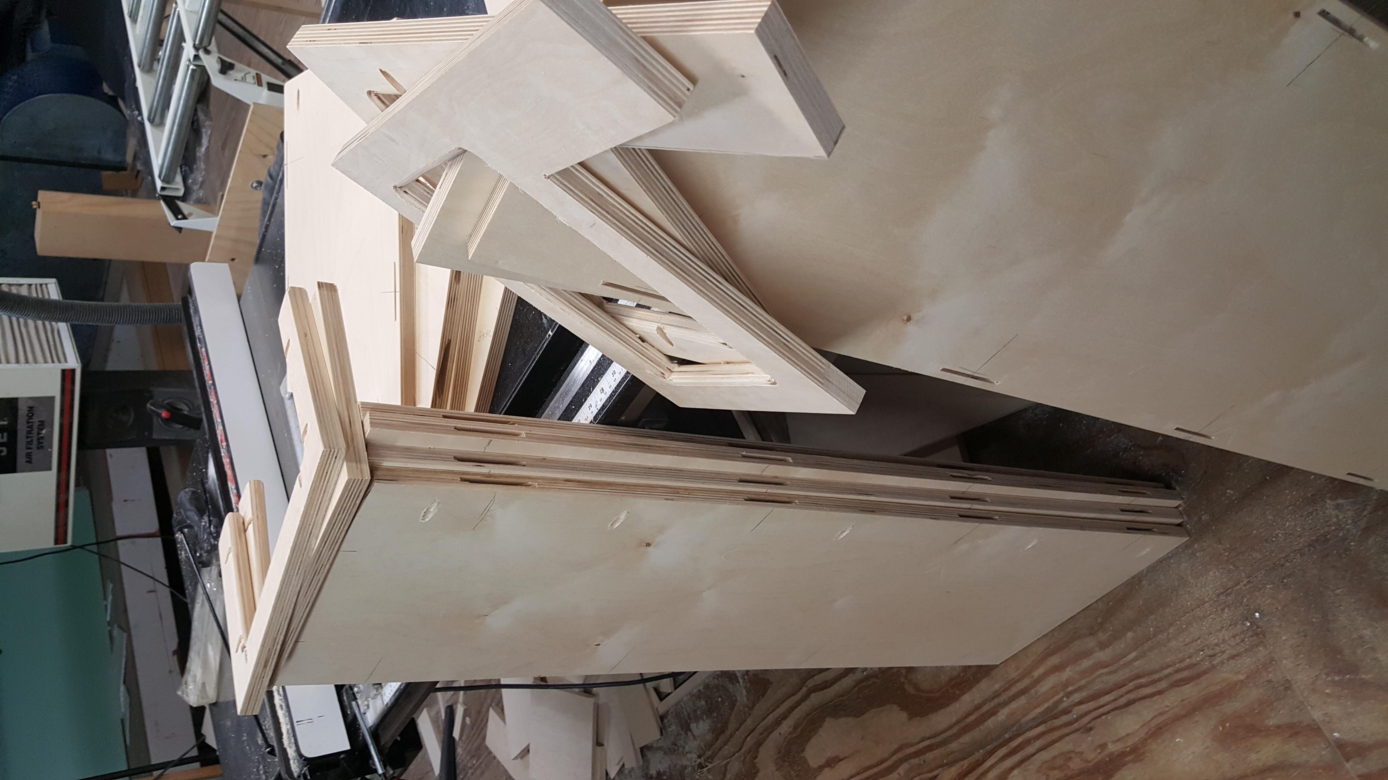

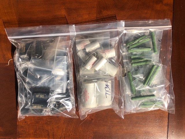

Attached are pics of the xover resistors and caps. And the CNC cuts for the speaker cabs.
The inductors are still in Estonia and the speakers are in Kansas waiting for the CNC spindle to be repaired so the bass driver flush cut can be made. It will be more accurate than I could get it. I will do the small ones. In the mean time, I am working away on the resin/bento SP-10 plinth (also pic attached). Not to go off topic but both are big upgrade projects.
I will start posting again when I get the cabinets.
