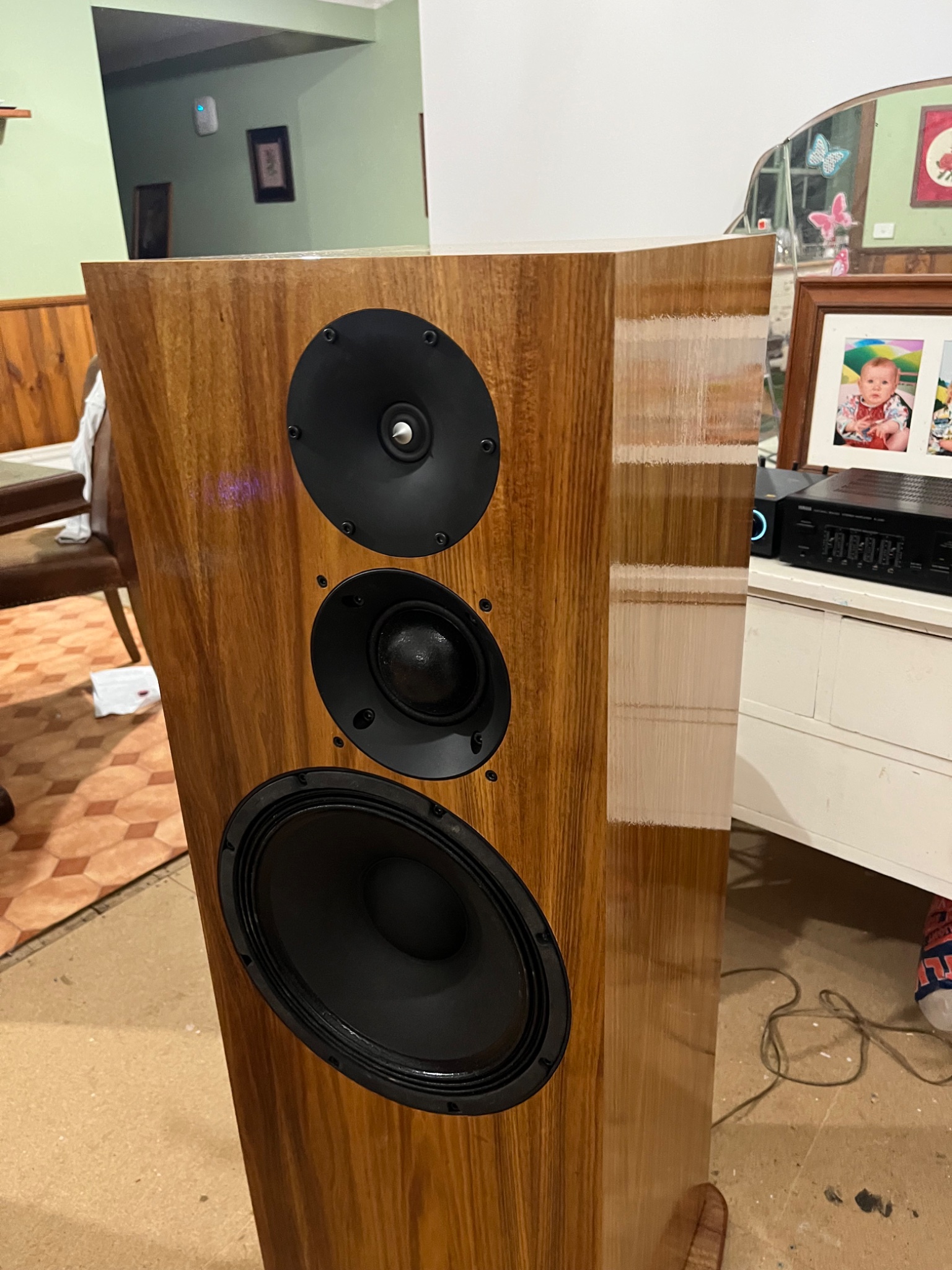

To make such a good box without leaks is not for basic wook workers
There are jigs for box joints. Now, if he did them all using hand tools only, then we are talking.
Either way, airtightness might still be an issue with this type of joint, he probably sealed the inside edges. If the enclosure gained stiffness over, say, a much simpler rabbet joint, then the additional effort might actually be worth it.

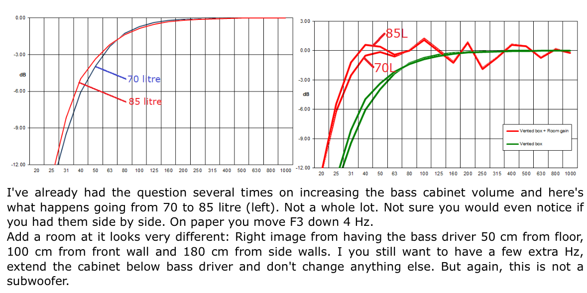

Troels’ 12” Faital speaker has a similar volume as the OSMC, it’s the same driver. He has this to say about volume:
So looks like even 70 litres work fine, with going larger yielding only a small benefit.
You are not looking at the full picture, group delay for the tuning is not part of his equation, which is the whole point for me, though that is more the symptom than the cause. And he has a large space to use them in, one of the original criteria for the OSMC was flexibility in terms of room placement IE bookshelf or stand (though this criteria went out the window for some reason).
Besides, this is NOT the OSMC thread, this is the thread for the larger tower adaption.
If you do not have any interest in a different design and/or tuning for the OSMC there is no reason to respond here.
