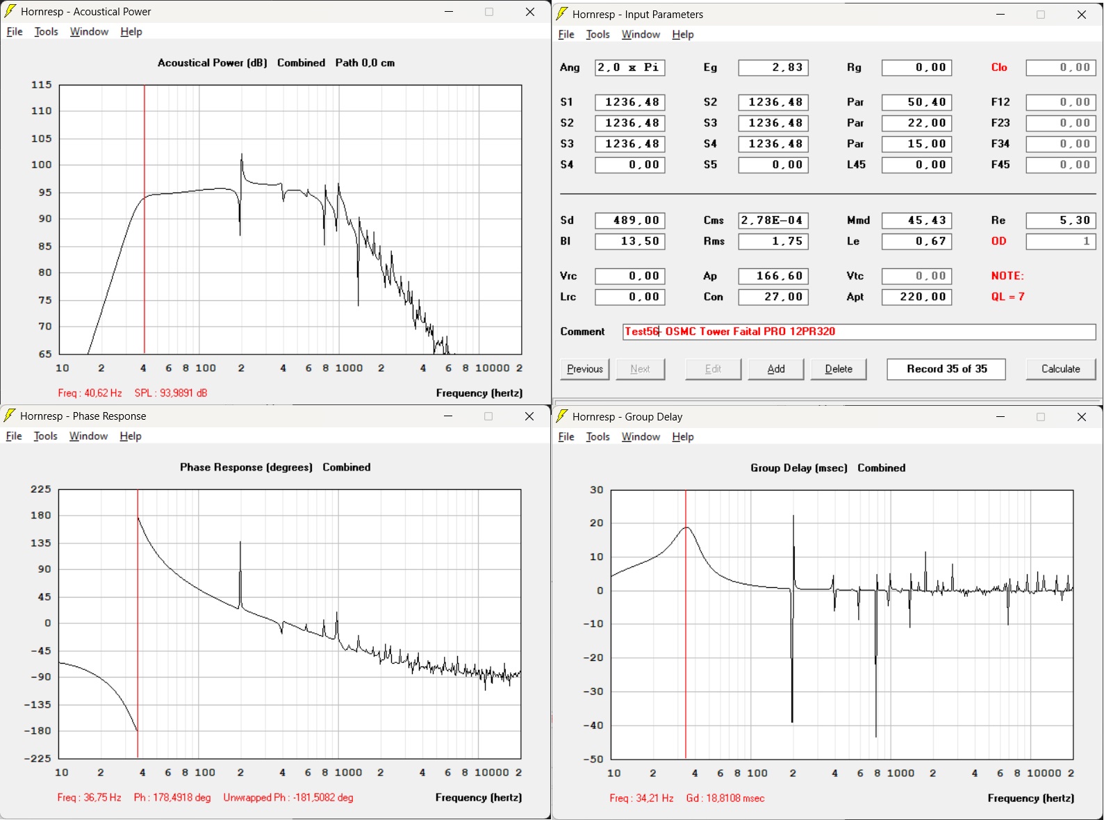

Hi guys,
On the process to build the OSMT load for the Faital 12PR320. Project going slowly because the mid and treble would differe but that is for another thread (thanks Matthias for the PM on my basic beginner question from above 🙂 ).
So 101 L + 6 litres circa for the two ports space and drivers/sealed mid load if needed. I keep the idea of external passive filter box from the OSMC.
I re read the datasheet from Faital yesterday nigth and saw it changed sligthy : VAS is now 113 liters, the others T&S are the same. Noob question, does it changes the OSMT cabinet liters if Faital sligthy changed their production parameters on that unit ? I purchased mine few weeks ago.
Or should I measure the impedance of my two units with my Arta box and try a T&S measurement after breaking in ? Which is bringing me to another question to @Paul Vancluysen , @mbrennwa and @KaffiMann : Does one design with T&S took from a sligthy hot unit for the box load because when playing back music, the driver will get hot fast anyway ? I assume most Qms change is comming from the speeder annd voice coil get hotter than room temperature. Not knowing if it is cutting hair in 4, but my average target room is 23°/24° Celsius.
But that's maybe off topic here, just want to know, please, if the new VAS of the datasheet changes the 107L cabinet target (so port design too) for cutting the wood first ?
Many thanks for your thougths on this.

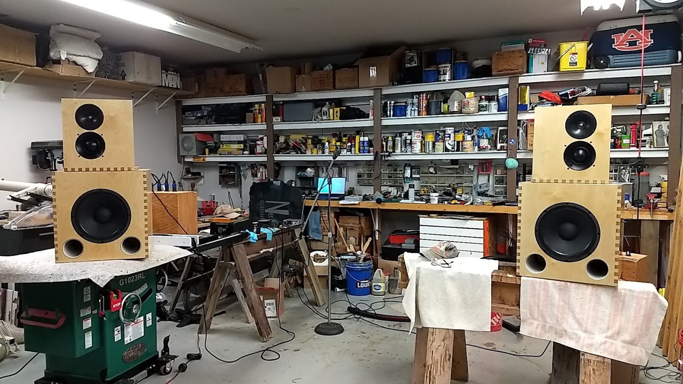

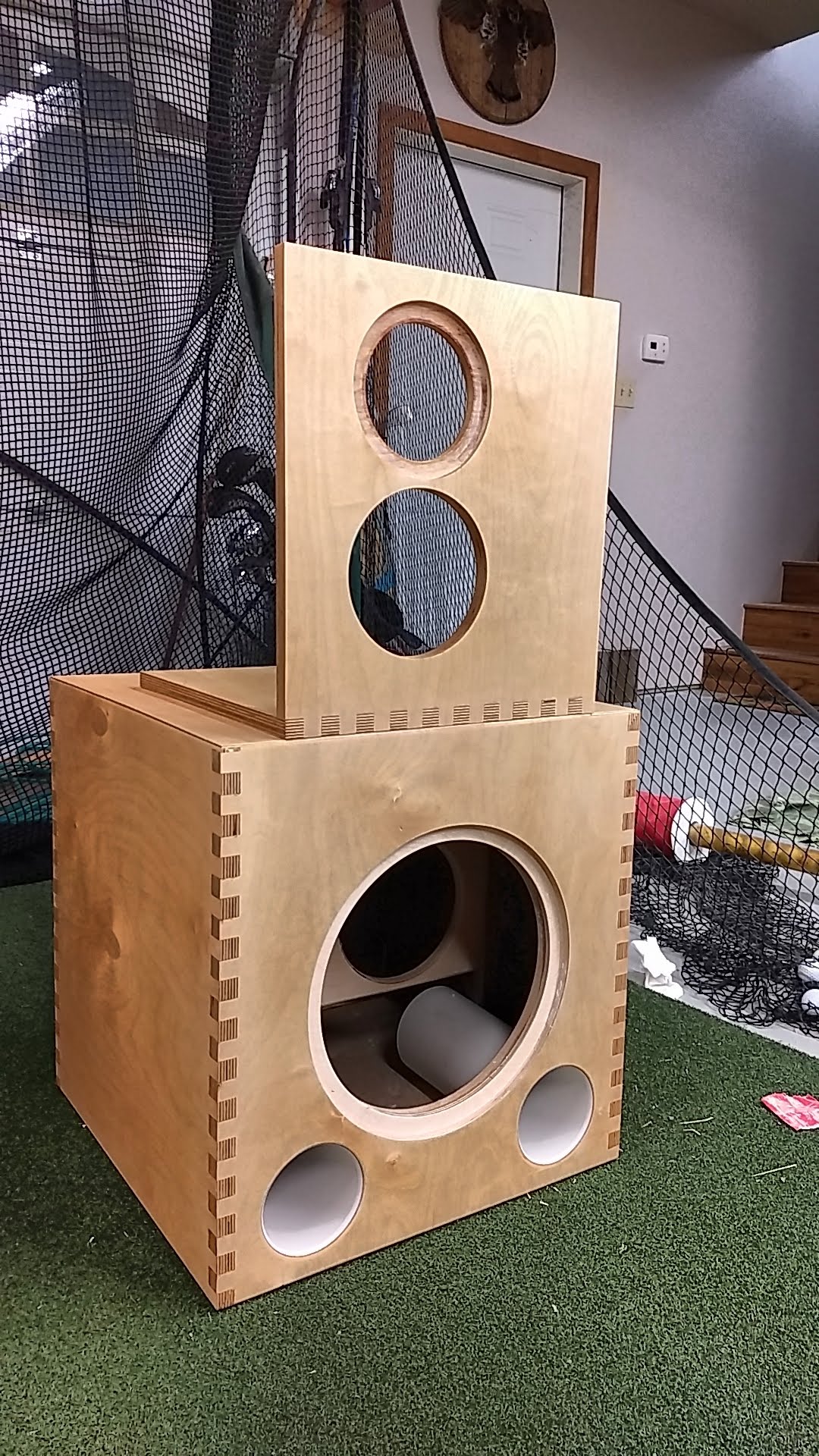

@gbowling I hope it is allright for me to post some of your pictures, you made up to this date THE BEST variation of the OSMC project.
After a bit of input and a few nudges here and there. he ended up making quite a different design while retaining some crucial key elements.
Gabo did it all himself, absolutely everything, and in my usual style I just gave him a gentle nudge here and there to help his thoughts wander off in the right direction.
He did this as part of a custom solution for a studio. If I remember correctly the tops are built-in the walls, fully integrated.

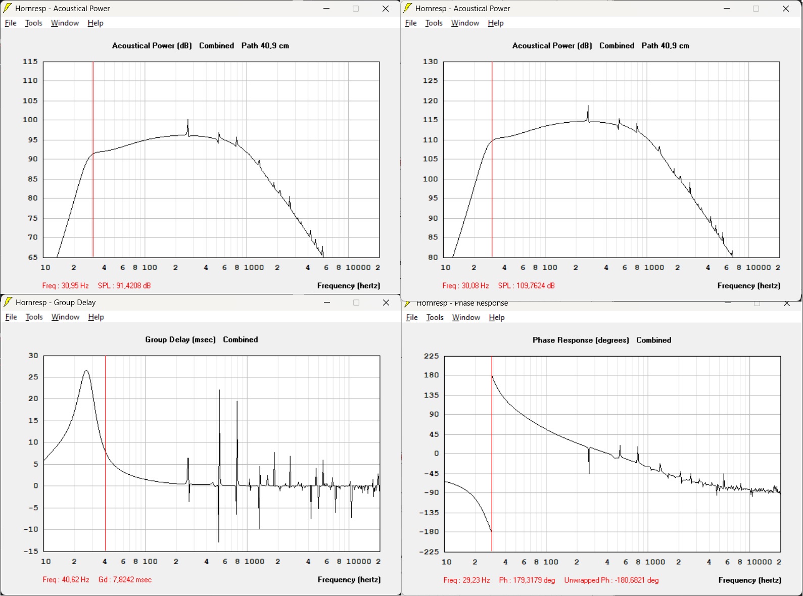

Here is what he sent me as the results of his process, great guy, great results.
However.....
Because I never gave him anything except a little bit of help, there is still a small amount of performance to squeeze out of this design.
I apologize Gabo, please forgive me, just a bit smoother and a bit deeper, the big difference is the group delay around 40Hz, it makes a big difference in perception of bass articulation.
If you do not care about power handling (that much), and you have about 150 completely squeaky clean watts on tap though you only need a bit over 100 of them, this is what is possible:
I think that is just about the most one can expect out of this membrane area, need more? Maybe you should consider a different project.
For the US population that is "A Hunnerd'nTen deebeez @ thurdy hurtz!" from a single 12" in halfspace, smooth to 1kHz.

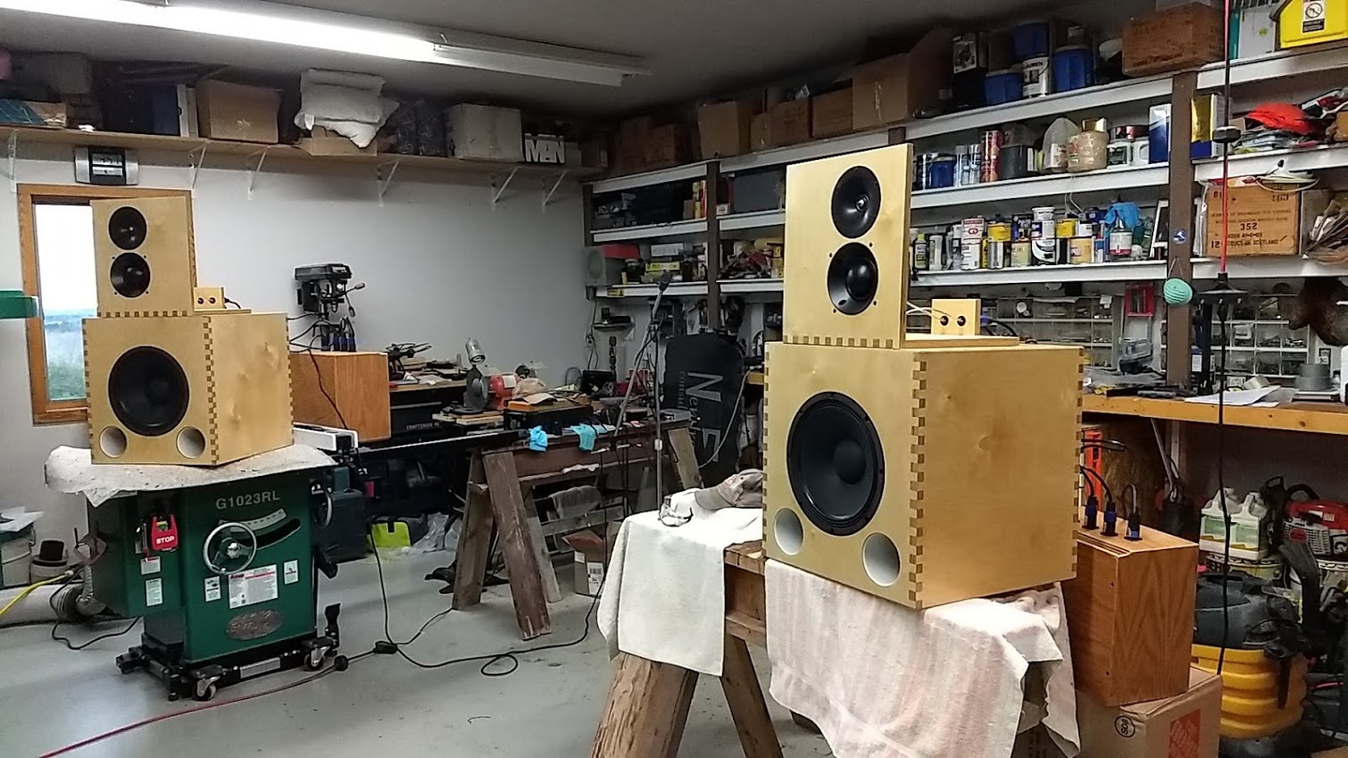

@KaffiMann no worries in posting anything I did. I'm flattered by your comments! I had a great time with this project and you taught me a lot about how to use hornresp, something I struggled with until you helped me understand some of the nuances. I'm still not as comfortable using it as you are, but I can get by doing what I need to do if I have a bit of time.
Those speakers are still in the studio, the owner of the studio absolutely loves them. They get driven very hard every day, this studio does all types of music and film but does do quite a lot of metal and they drive some pretty extreme SPL's for long periods of time.
The speakers were a part of a much bigger overall design that included room treatment, studio console designs, and many other things. Not only does the owner love it all, but I get to do "drum sessions" there a lot and get to enjoy the entire experience. Thanks for the memories.
gabo

To make such a good box without leaks is not for basic wook workers ! 🙂
