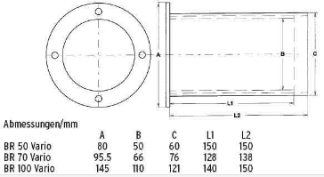

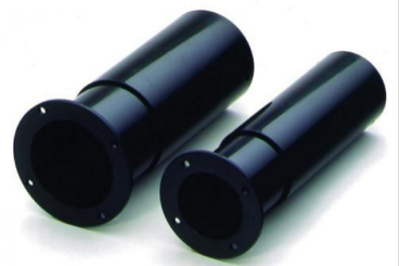

BR-tubes: 2 pieces 4" diameter and 20cm something long. Maybe Intertechnik BR100V/SW could be something. It's telescopic! See pictures!
I have this issue with my listening/living room being a bit narrow, so I have to place the speaker quite close to the front wall, given the OSMC-tower is quite deep. Can I place the BR-tubes on the front without sacrificing sound quality? Some claim that BR's leak stuff you do not want to hear or not to be blended with the direct sound from the drivers.. even though it is a very common solution.
We had some lengthy discussions about this in the OSMC thread. Long story short: I am not a fan of front-firing BR ports. But,as I wrote before, if you could move the ports on the rear, you can move them to the sides or the front.
I have not fully understood if changes to the bass xo was needed or not!? Matthias you did some simulations, but it wasn't conclusive or?
See post #88 for the modifications that would be needed for Dons larger box. The calculations for the compensation of the impedance peak are usually straight forward and spot-on, so you should be fine with these values.

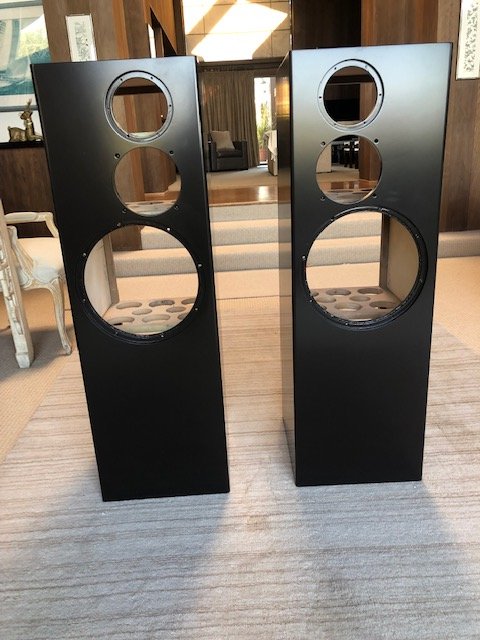

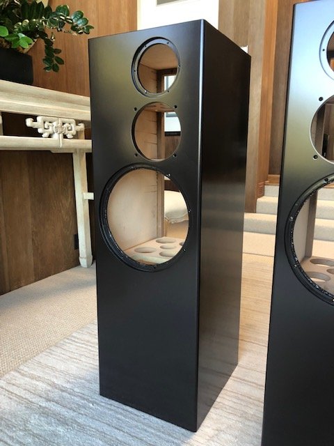

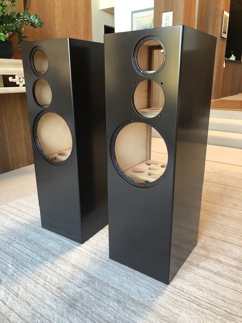

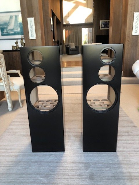

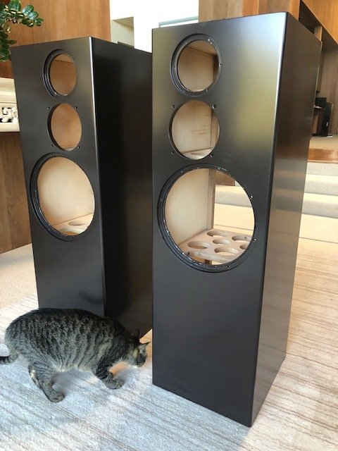

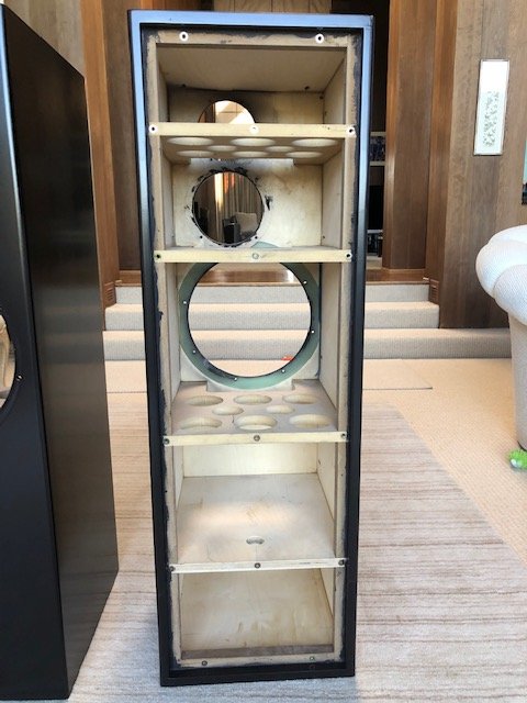

It's taken a while but here are pictures of my speaker cabinets. Now for the fun part.
A 1000 thanks to all who invested their time and knowledge to this endeavor. You made this possible.
The backside foto shows the bottom shelf that separates the speaker volume from the xover space and the hole for the speakOn connector between the two.
My next post will hopefully be when making sound.
Thank you again.
Don
Thank you again.
Don
Congrats! The cat also seems to like them.
What is the greenish ring on the inside around the woofer hole? Just wondering, nothing wrong with it.
M, it's 1/8th inch G10. Single piece. I used it for reinforcement since the bottom of my volume wasn't right there to help make it rigid.Congrats! The cat also seems to like them.
Then after I did it I ended up putting a brace there any way. This wasn't the most efficient build but so far everything works.🙂M, it's 1/8th inch G10. Single piece. I used it for reinforcement since the bottom of my volume wasn't right there to help make it rigid.
Don
