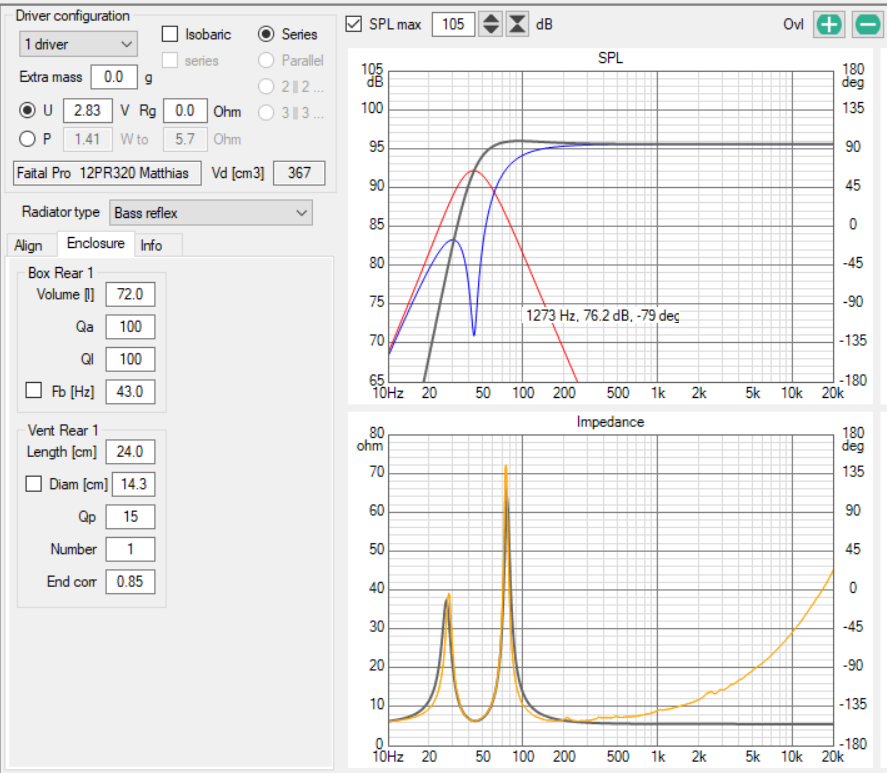

I did use an impedance curve, used at the end of the Monkey Coffin design, and yes it is the same as in figure 1 in the OSMC doc. Indeed that is misleading...
I used now the impedance of the attachement in your last post. I had to edit the txt first, the first frequency in the row did have no impedance values. Something with MATAA??
plot 1 left
Imported the measured impedance of the Monkey Coffin in VituiXCAD, yellow curve, and adapted basreflex parameters for best fit. FB seems to be 43 Hz.
Important, I used a driver model with TSP the same as the Faital driver of Matthias. That driver has fs = 47 Hz, Vas = 77 L, Qts = 0.45
plot 2 right

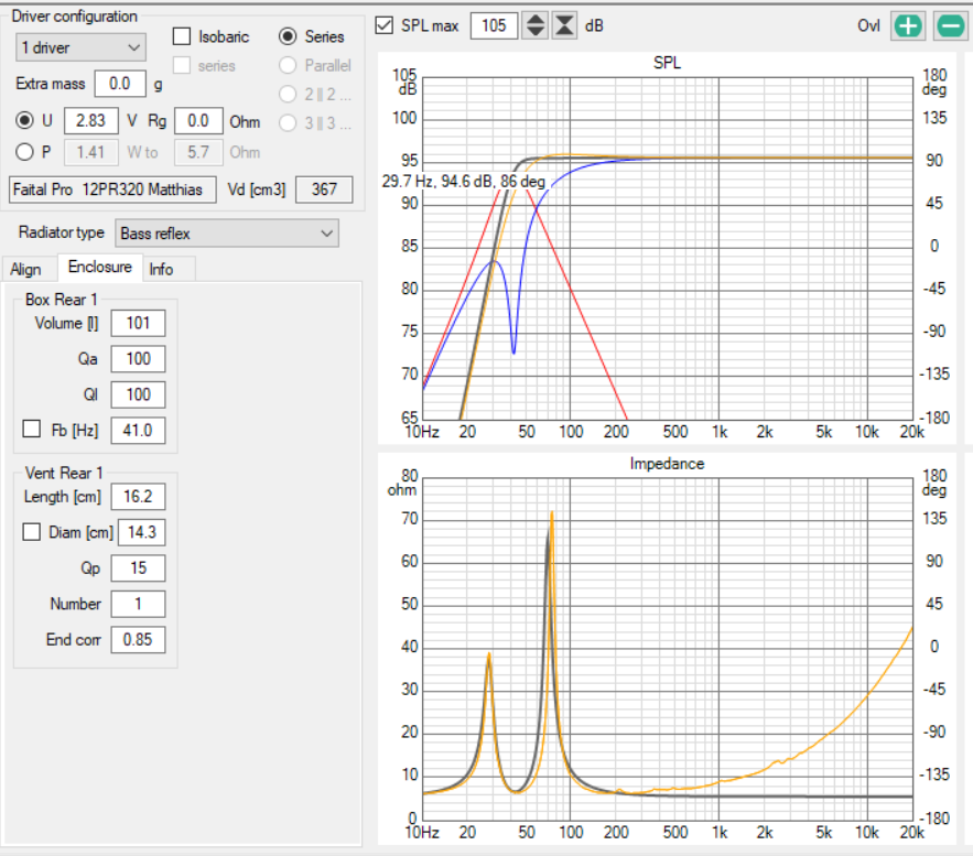

Imported the measured impedance and corresponding simulated SPL of the Monkey Coffin in VituiXCAD, yellow curves.
Changed VB to 101 L and FB to 41 Hz. This SPL is close to the Monkey Coffin. For a more extended response, FB has to be lower, but the SPL difference 50 to 100 Hz will be more different.
I used again TSP of the Faital driver of Matthias to see the impact of the larger volume.
Simulation with the TSP of the data sheet will be different. Best to do that once Don has its driver at home.
Concerning the port, is the diameter = 14.3 cm and the length = 8 cm? It looks different in VituiXCAD. Then I will look to that also.
The Monacor BR-100HP tube is slightly conical, and has a flared exit:
https://www.monacor.com/media/JPG/1024/G/G1/G128600Z.jpg
At 90 mm length, the internal diameter at the entry is about 96 mm.

Looking to the port dimension calculation in VituiXCAD
- for the Monkey Coffin, VB = 68 L, FB = 43 Hz and port diameter = 9.5 cm, the port length becomes 7.9 cm. That is the same length as in Matthias' speaker.
- for the Monkey Tower VB = 101 L and FB = 41 Hz and port diameter = 9.5 cm, the port length becomes 4.4 cm. That is short. It is better to choose a larger port diameter.
So, for the Monkey Tower VB = 101 L, FB = 41 Hz and port diameter = 12 cm, the port length becomes 9.8 cm. That is already more acceptable.
For the more extended modes, FB is lower and the length will be higher than 10 cm.
It has to be optimized later.

KaffiMann, are you referring to these numbers? I don't see why this wouldn't make sense. I could reproduce Pauls numbers quite nicely with the Vituix calculator. But maybe you were referring to something else?
Hi Kaffimann,Paul, did you mix up the numbers a bit?
Those port numbers do not make sense to me.
As you can see in previous posts, Matthias and I get the same results in VituiXCAD.
At first we have simulated the SPL of the basreflex system with the same impedance curve and cabinet volume as Matthias' speaker. The port dimensions we get in VituiXCAD are exactly the same as in Matthias' speaker.
Then we increased the cabinet volume to 101 L and adapt FB for the best SPL fit on the simulated SPL of Matthias' speaker, for minimum X-over changes. In this way we get the new port dimensions for the Monkey Tower.
Can you explain which problem you see with the port numbers?
