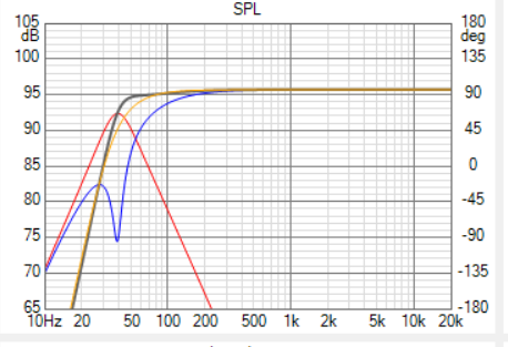

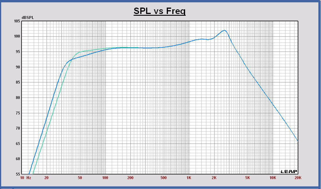

- blue curve: VB = 120 L, FB = 38 Hz; larger volume and same FB as Monkey Coffin (shorter port)
Thisone looks nice, as the SPL is pretty much the same as the original Monkey Coffin above cut-off.
Could you also do one with VB at approx. 90 L?
In all cases with larger volume, you have to adapt the RLC circuit parallel with the woofer, because the location of the higher impedance peak is different.
Yes! The corresponding changes in the xover be relatively straight forward (just adapt the L or C values in the compensation network).
Yes I can do VB = 90 L or let us take the VB value that Don has in mind.
Than we can optimize for the best FB value and port.
Adapting the X-over for the new BR is not much work. We can do a simulation for the best fit on the existing Monkey Coffin SPL for higher frequencies.
The curve shows a SPL decrease starting at about 150 Hz down to about 40 Hz. If this is due to the bass-reflex tuning (i.e., "just the woofer+box acoustics"), the bass output between 150 Hz and 40 Hz or so will be less than with the original Monkey Coffin box, which has a flat SPL curve in this range.

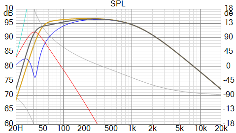

It depends what kind of basreflex system you like to realize. This Faital driver has fs = 42 Hz, Qts = 0.37 and Vas = 95 L.
If you like a Butterworth 4th order high pass response, conform the R.Small graphs, you have to choose VB = 95 L and fB = 42 Hz for Qts being around 0.40. Then the repsonse is optimal flat down to F3 = 42 Hz.
If you like a more extended low frequency response, you have to choose FB lower. SPL at very low frequencies will increase, but F3 will become higher.
In the plot, two SPL responses for VB = 95 L and FB = 42 Hz - B4 response (green) vs. FB = 35 Hz - extended response(blue)

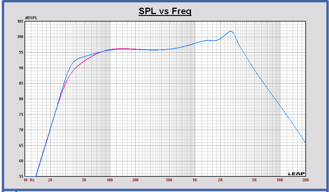

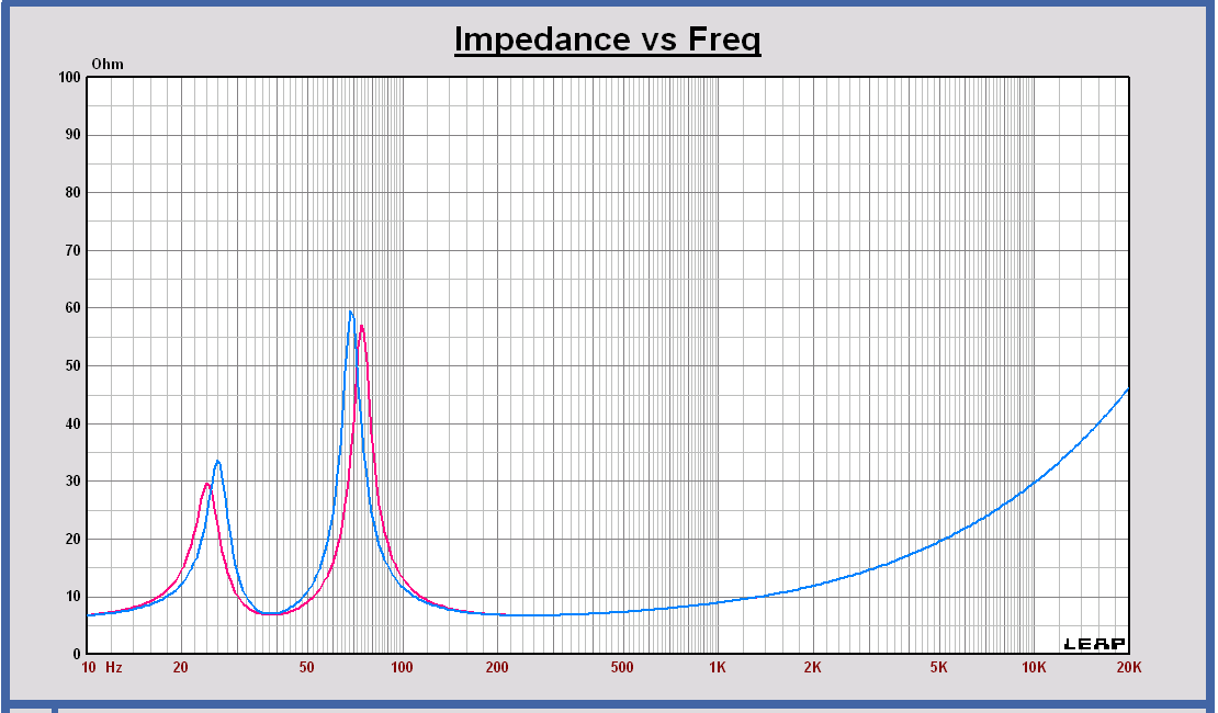

IMO, the X-over changes will be minimum, keeping the same FB = 38 Hz like the Monkey Coffin for a larger cabinet.
Look to the SPL and impedance differences of a BR in 95 L FB = 38 Hz (blue curve) versus BR in 68 L FB = 38 Hz (red curve)of the Monkey Coffin

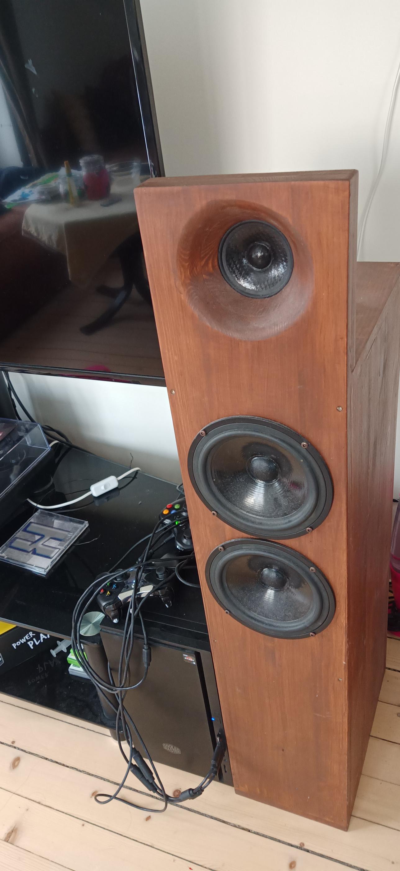

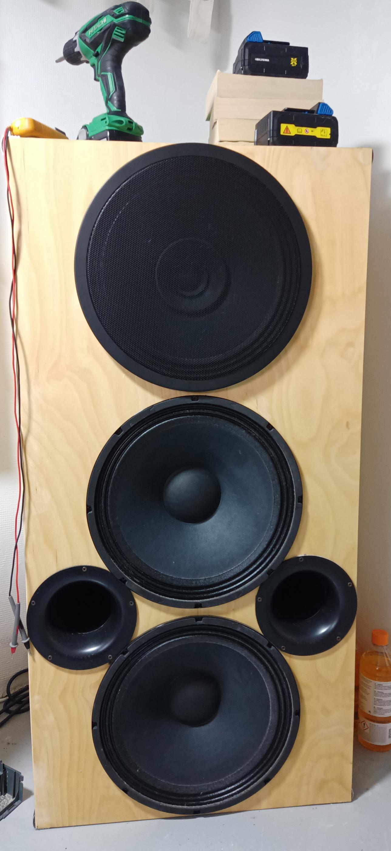

I'll be attaching pictures of my right side office computer speaker which is about 300 liters with 3x15" one of which is an FR, and the speakers currently in my livingroom with double 6,5" and a 5" FR. Also in the house are some 120 liter T-TQWT's, but my daughter is trying to win a round on Fortnite so I'm not going to disturb her.

Ok, so going back to the practical implementation for Dons Monkey Tower. I'd say the next steps are as follows:
- Don't change the Monnkey Coffin xover (except the impedance compensation network, which is easy to do). Don't change the baffle geometry (baffle width, position of the drivers relative to the sides and the top).
- Decide on the box volume. Don, after reading the discussion so far, what volume do you want?
- Modify the impedance compensation network for the upper impedance peak (the peak frequency depends mostly on the box volume, but not so much on the port tuning).
- Determine the port tuning for this volume. I'd suggest to build with a slightly longer port and see how your ears like it, then start cutting it until you get to your preferred optimum tuning. If you use removable plastic ports with compression fittings, changing the port length is a piece of cake.
my summation
Thank you guys, I am overwhelmed by the response. Quality and volume (no pun intended).
It looks to me from the curves that we can actually improve on the SPL's of the Monkey Coffin and get a bigger volume if we do it right. So may I suggest,
1. Do a box volume of 106 L which looks like a good spot for the Driver.
2. Shoot for an Fb of 38 Hz, same as MC.
3. Make the parallel RC adjustment which should be manageable.
Then it looks to me like we get some really good SPL vs Hz curves. Well behaved and manageable. Possibly superior to the MC.
Then, all that is left is the port design which I know has some controversy but we are down to one variable. I am favorable to the front port mainly because it provides for more flexible room positioning.
If I want a taller box for room presence I can just extend it and put the bottom in at 106 L. Might put an additional stiffener in to maintain box stiffness. TBD.
Comments? Thoughts?

Alright, I had a quick look at this with the bass-reflex calculator in Vituix CAD (see attached plot):
- Yellow curve: standard Monkey Coffin, with Vb = 72 L and fb = 45 Hz (it's actually a bit different than in Pauls post above).
- Black curve: Monkey Tower with Vb = 101 L and fb = 38 Hz. I subtracted 5 L from the 106 L for the woofer, braces, and the port. With a Monacor BR-100HP tube, the port length would work out to 87 mm.
Port position: my tests during the development work of the Monkey Coffin showed that I prefer the port at the back, because the leakage of the upper bass and lower midrange from the port is directed to the rear and is therefore not as audible as with the port was on the front. Of course, a rear port requires placing the speakers away from the rear wall. If that is not possible, it might indeed be better to place the port on the front or on the side.
For the yellow curve, is the impedance in VituixCAD the same as in the measurement of the Monkey Coffin? It is possible in VituiXCAD for fitting, using all parameters incl. QA, QL and QP.
I don't understand fB = 45 Hz value?? Looking to impedance measurement and port dimensions of the Monkey Coffin fB looks to be 38 Hz.
So, I get a different result, see in the plot.
yellow curve: VB = 72 L , FB = 38 Hz and QA = 100, QL = 60 and QP = 10
black curve: VB = 101 L, FB = 38 Hz and QA = 100, QL = 60 and QP = 10
For both Rg = 0.3 Ohm.
Strange that QL = 60 is so high, but the value is conform the impedance measurement of the Monkey Coffin.
QL around 10 should be a more practical value...
Results in Leap almost the same.
VituixCAD is very powerful for basreflex, also for passive radiator! Strongly recommended to use it!
