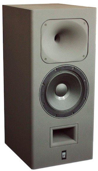

I bet if the slot port was 1/4 up from the bottom the second standing wave at 400-500Hz would clean up considerably. At least if I move the driver position in the hornresp model to 1/4 position the 400-500Hz ouput is attenuated some 20db 🙂 See Strauss monitors for example, seems to have woofer at 1/2 and port at 1/4.
Hold your horses, If I calculated correctly the slot port is currently equal to two 100mm drain pipes, 30cm long. 75mm pipes would be too short and chuffing 🙂
IF hornresp MLTL model reflects to reality you could add panel between mid and tweeter and make the box ~12cm longer to get the woofer in the middle of the "pipe" and then there shouldn't be any 250hz resonance at the slot port. And you'd get some room for 100mm drain pipes and turn them up from the bottom. Just speculating fhere 😀
Can't put a divider between the mid and tweeter, as it collides with the magnet idvthe mid (dashed pink circle).
Also, making the box bigger is not in line with design goals of the Monkey Coffin.
If one adjusts L12 so that the woofer is middle of the "pipe" the 250Hz resonance cancels out and is not showing at the port output anymore. 500Hz resonance is more pronounced here, but maybe easier to filter out by crossover and polyfill. See the other attachment.
Only thing changed between the attachments is the woofer location (L12, L23), huge difference.
Anyway, a lesson here is don't put port at the end of an long enclosure and put woofer in the middle of the baffle to cancel out the lowest standing waves in the enclosure.
I have mentioned this soooo many times.
But your conclusion is not 100% correct, you can indeed put the port on the end of the enclosure, that is not the problem. If the port could be on top of the enclosure the problematic frequencies would also shift.
In general, I find that the woofer should be located between 1/2 to 1/4 baffle length distance away from port. But this will inevitably vary pending on the other measurements of the enclosure, so no fixed rule.
Conclusion: Check and double check every single time, also move port and driver several cm in each direction to verify that there is some slack, should your cuts be a bit off when doing the build. Never hurts to be careful.

Extending the baffle's lower edge does nothing to diffraction, practically. And neither does a small increase in volume to tuning.
Port diameter and length go hand-in-hand. If we use 2 tubes, each must be twice as long as a single tube. Makes it easier to bend them up.
I vote for 2 bent tubes below the woofer and a bit taller cabinet. Still, there will be some resonances in the cab and in port tubes... ¤75mm drain pipe
I wrote this the wrong way, it should say 1/2 to 3/4 away from port. So half length and further away.
That would mean.that a port below the woofer is too close. I guess the only solution within the limits of the current Monkey Coffin design would be to put the port in the upper half of the box then. Front baffle is out, so: rear, top, or side of enclosure?
^Try this. Still, that is estimation. A tube will always have standing waves too.

We already know the port tuning. My question was "how can we fit a bent tube port (or two) into the Monkey Coffin?" The way I see it is that the geometricak constaints will be a problem. Either the bent ports are too shorting bend around the woofer and upwards, or their diameter gets too big. If someone finde a solution, please show us a drawing that is to scale.
Apart from that I dont think it will be possible to implement KaffiManns rule of a woofer/port distance larger than 1/2 of the longest enclosure dimension using bent tubes below the port.
Subwoofer Vent Length Calculators - Diameter of Vent, Number of Ports, Volume of Box, Tuning Frequency, End Correction Factor
This calculator gives around 25cm length for double ¤7cm vents. The angled tube in front wall and straight pipe 15cm up - means next to driver's midline. I wonder if that would be doable. It just has to be tested in a proto. How about 45deg angle?
