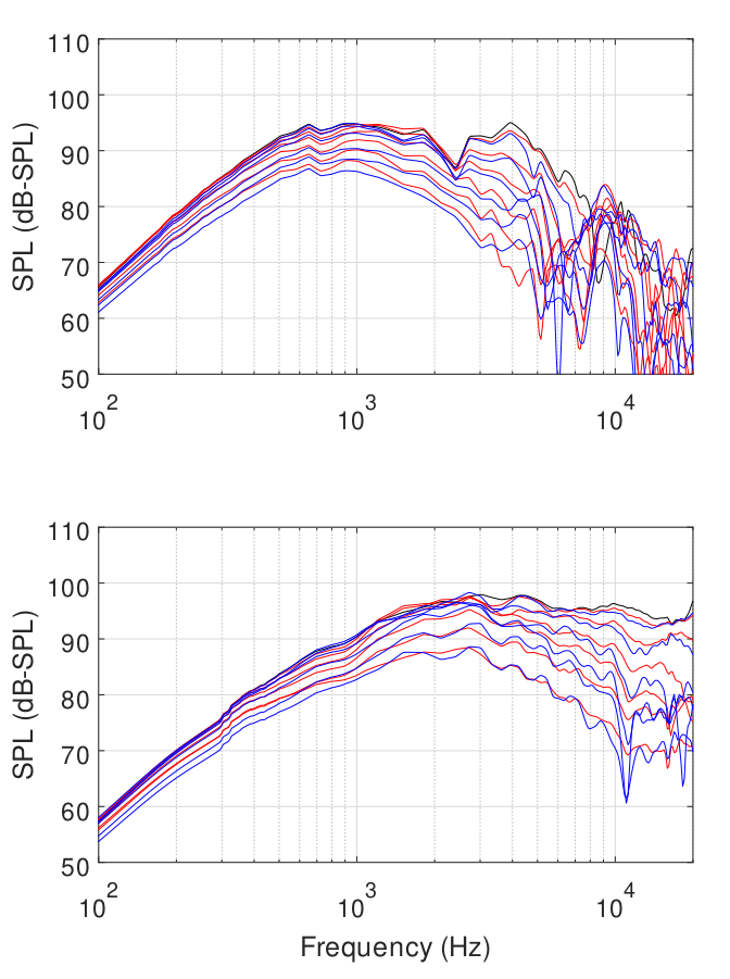

Here are my thoughts:
- The SPL response of the Scan R2904+WG148 response curves shown in augerpros post look pretty bad. Things look much better if the WG148 is machined to properly fit the R2904 (see here).
- Still, changing the Monkey Coffin from the WG148 waveguide to one of those custom designs might allow an even smoother SPL response at the top end. Some (minor?) changes of the x-over might be required.
- We want to keep the workshop difficulty on the "kitchen table" level. Fitting the custom waveguides to the Scan tweeter would be straight forward, while the WG148 requires some machining (see here and here). However, routing the tweeter cutout for the the elliptical shape of the custom waveguides might be slightly more difficult than with the circular WG148. I am not sure which is more in line with the "kitchen table" approach.
- The WG148 is easily available, while the augerpro waveguides need to be custom made on a 3D printer or a CNC machine. Then again, it's not difficult to upload augrerpros 3D files to an online service that does 3D printing or CNC and click the "order" button (just a bit more expensive, but not much compared to the costs of the other parts). I am currently drooling over a black anodized aluminium version of the augerpro custom waveguides at 3Dhubs.com.
What do you guys think? Stick to the WG148 or change to the augerpro waveguide for the Monkey Coffin?

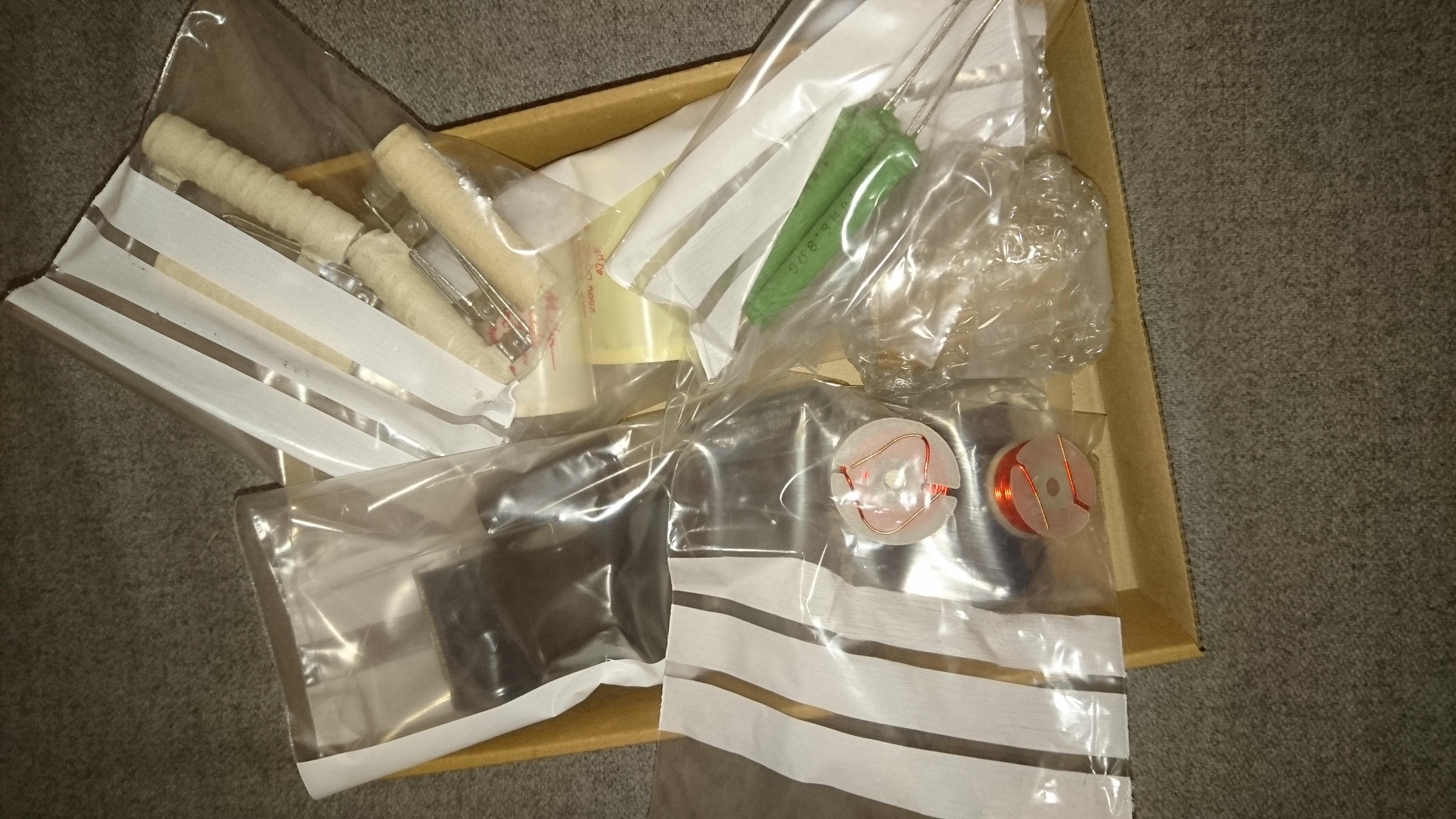

The postman brought some more x-over parts. Still missing some parts, but I got all for the tweeter filter and I quickly built it. The measured voltage gain is spot on with the Vituix model. Looks like the Vituix model output is pretty accurate!
The postman brought the missing parts to finish the x-over, so I took the day off and finished building the filter prototypes. I am sorry, but I couldn't do any measurements or photos yet. I was busy with listening and dancing to the music (I rarely do that in the workshop!). According to my ears, this is coming along really well... stay tuned!

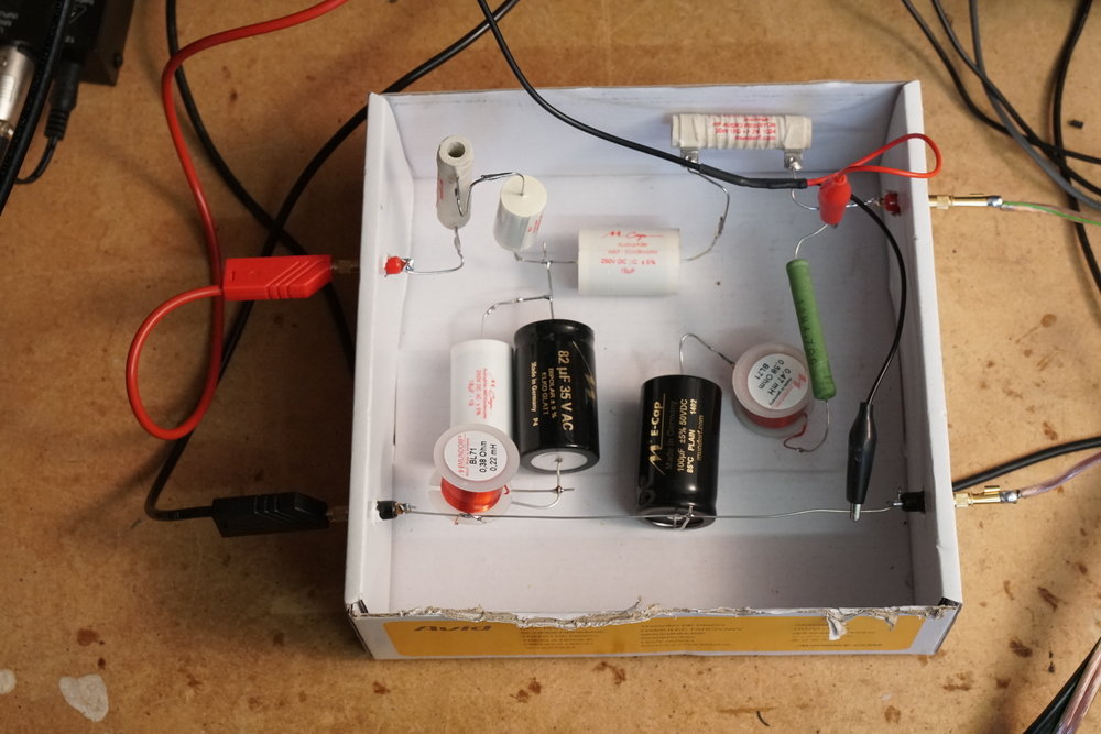

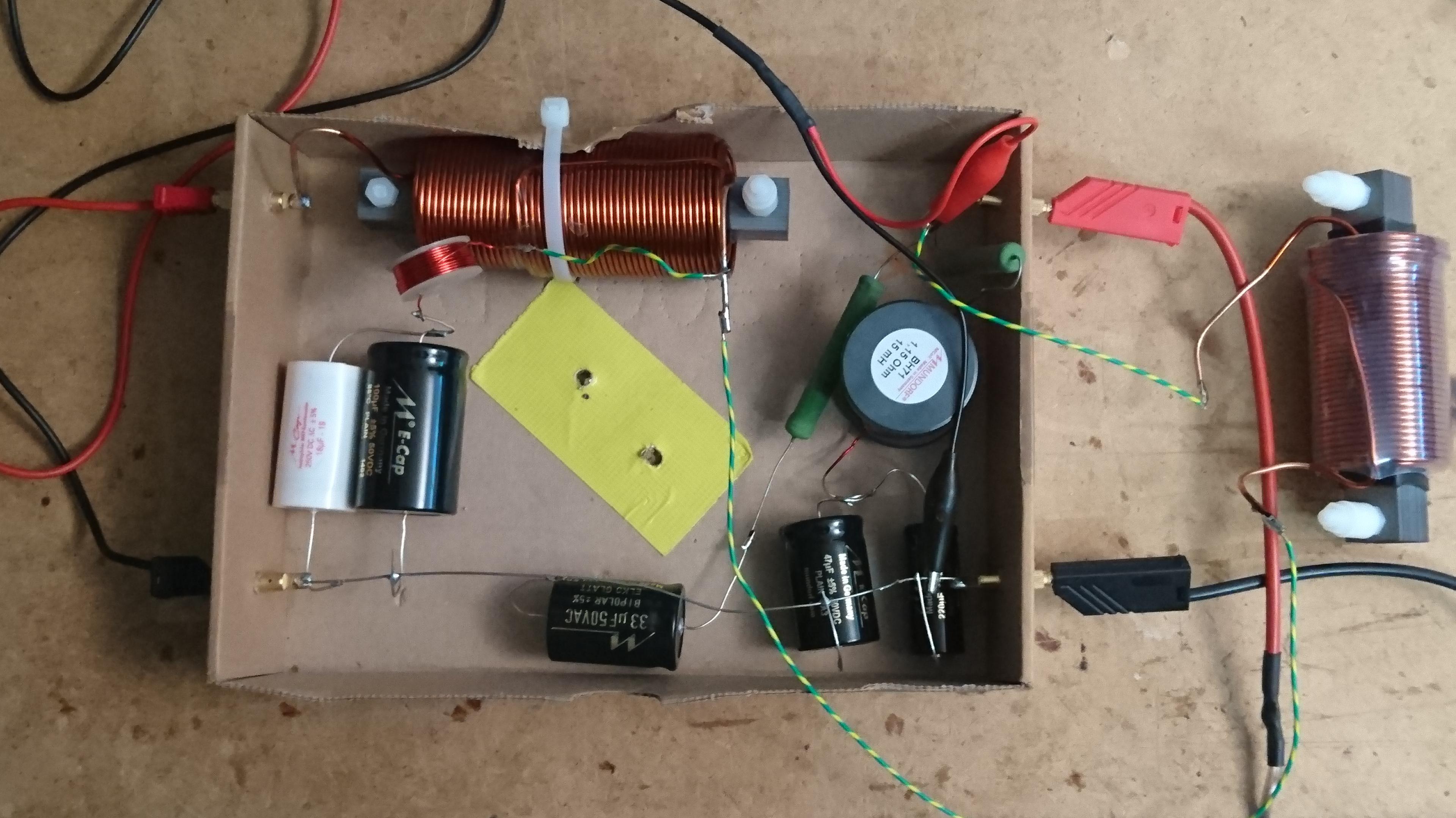

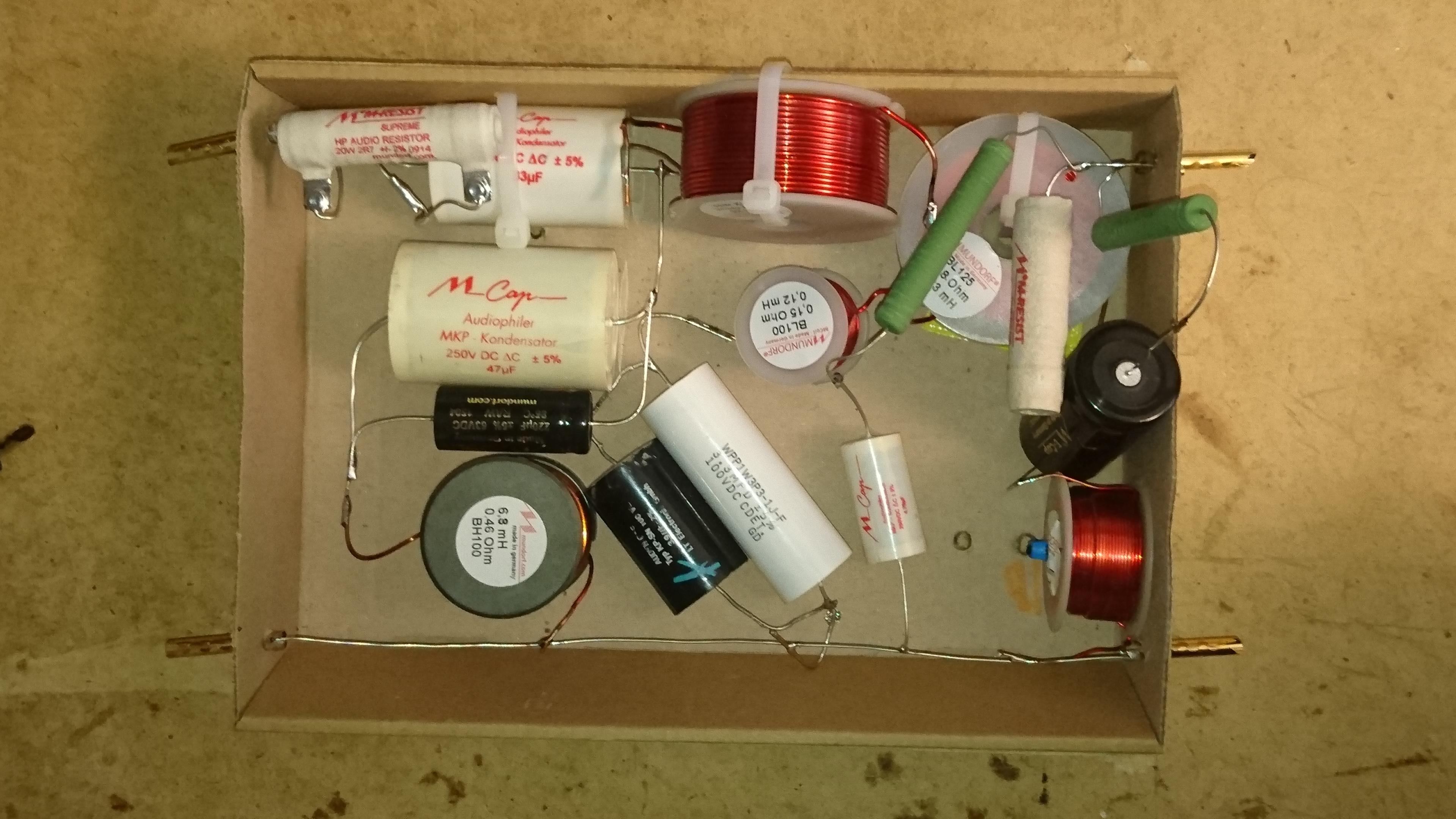

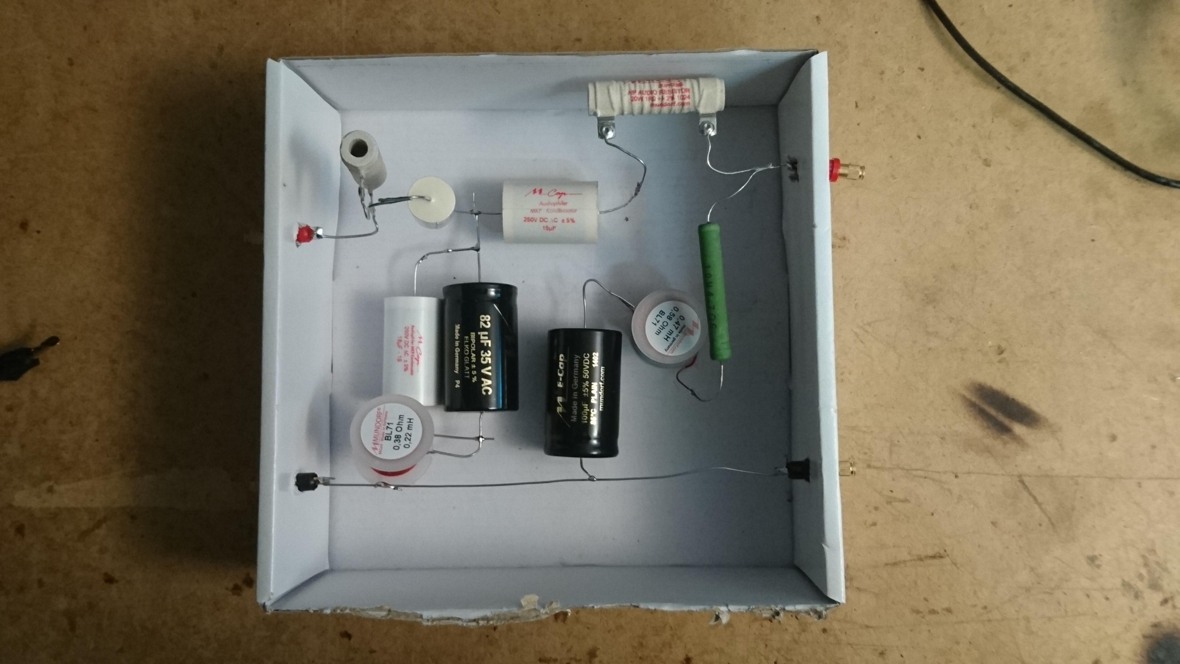

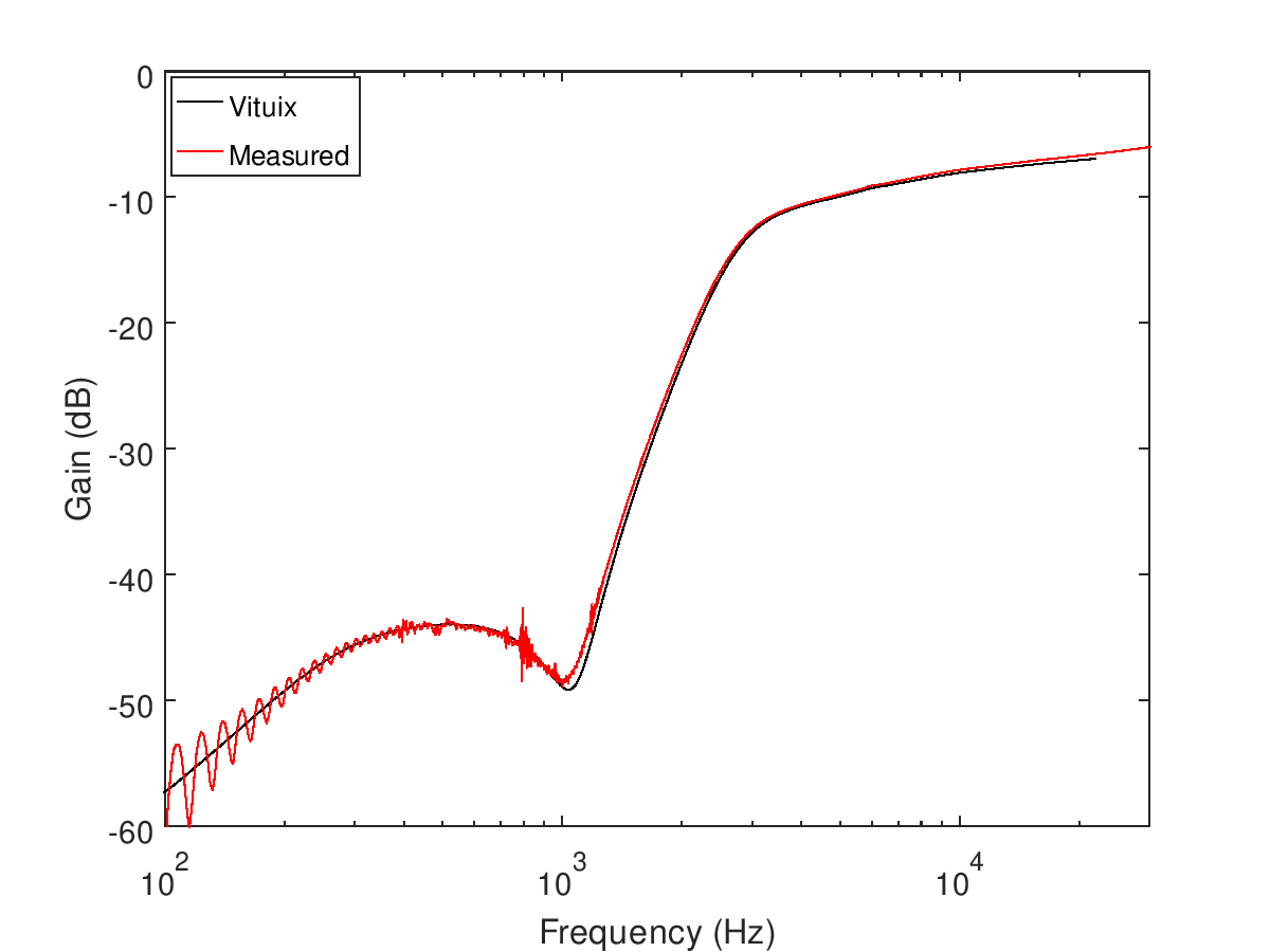

Here are some photos of the filter sections for the woofer, midrange and tweeter. I also attached the measured filter transfer curves and compared them with the curves of the Vituix model for the Monkey Coffin. The agreement between the observed and modelled curves is extremely good, almost spooky!

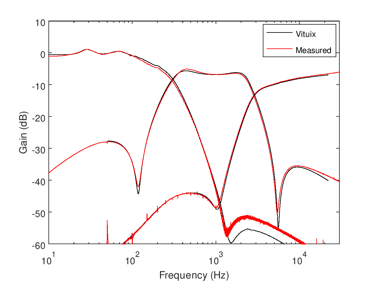

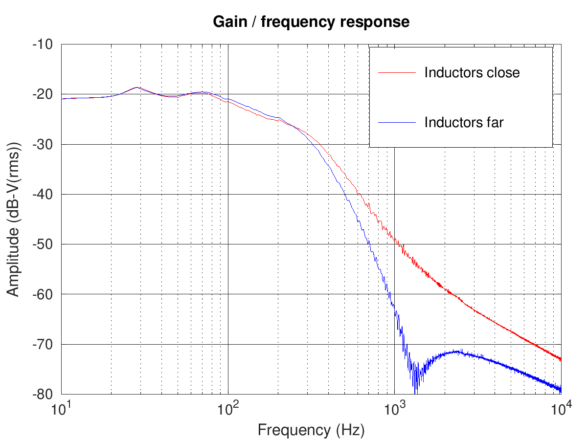

The only real issue I had was that the woofer transfer function did not look right at the beginning. Then I realised there was substantial crosstalk between the two large inductors, which were sitting just next to each other. Once I separated them from each other, things looked good. This is something to remember for the future, and it's especially important with steep filter slopes.

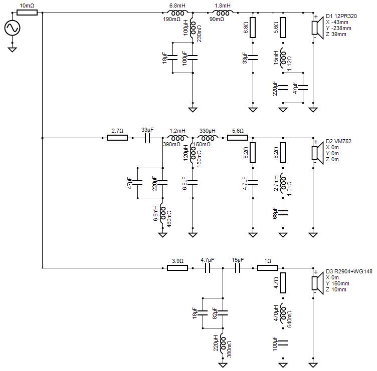

I also attached the filter circuit (this is version MB20190303_EL34).

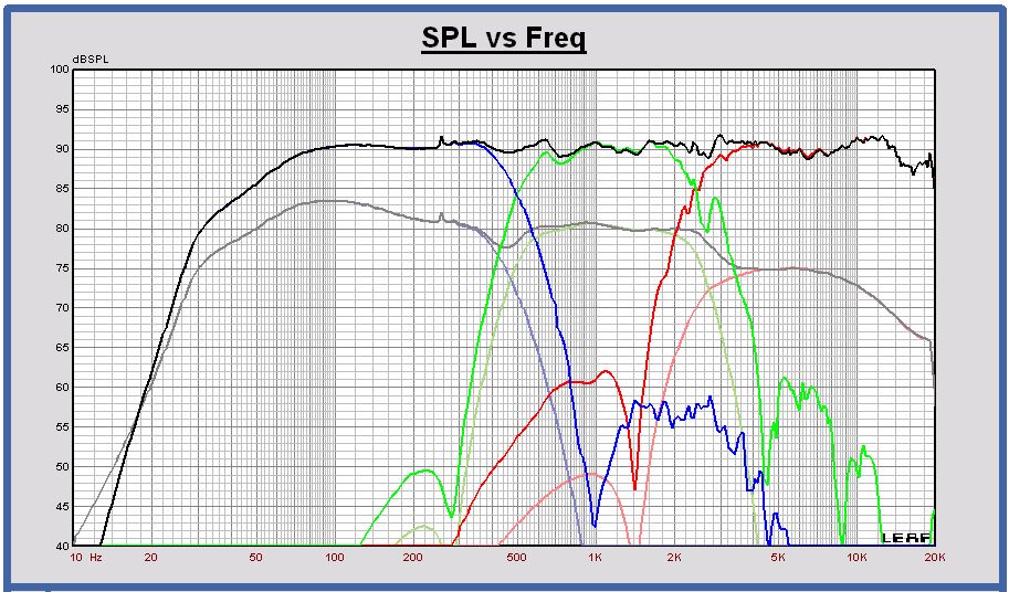

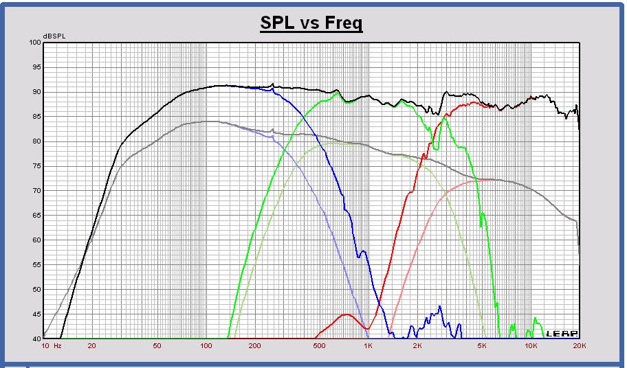

Some thought about the power response of the Monkey Box design.
I have simulated the full space power in Leap of Matthias’ last EL34mix design (post 813). Compared with the Vituix power simulations the high frequency full space power is lower. This is caused by the power in Vituix that is calculated out of the frontal measured off axis SPL curves. The power response is smooth, but at the expense of a slight SPL fall off to high frequencies.
In the plots, the lower curves are the power curves.
A more flat SPL design, for example my first EL3 design proposal, will become difficult with the tweeter waveguide. You can see in the plot that the power response is not smooth anymore above 1 kHz.
Also added the tweeter SPL with and without waveguide. The difference between the curves is also the power difference for a flat SPL design with or without waveguide.
I agree that conceptually the LEAP and Vituix model results cannot be the same, since LEAP sums up the off-axis response in full space, whereas Vituix uses half space only. I wonder how accurate the LEAP dispersion model is as opposed to the true/measured SPL curves (as used in Vituix). Both the midrange and the tweeter use a waveguide. In addition, the tweeter is a ring radiator rather than a dome, which results in stronger beaming at high frequencies. I would think that effects of the waveguides and the ring tweeter might upset the modelled off-axis SPL responses, which are are summed using angular weighting to determine the power response. I guess that both LEAP and Vituix have their issues here. Is there a way to get some more insight to this?
The fall-off is actually intentional. A sight fall off of the power response to high frequencies seems to be preferred by most listeners. See here and here, for instance.

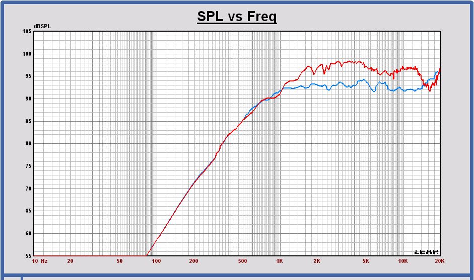

The SPL curve without the waveguide is probably the one from the Scan Speak datasheet, right? I'd guess this was measured on an IEC baffle, so it would be rather different to the curve we'd observe on the Monkey Coffin baffle.
I have the opinion that with this midrange-tweeter driver choice, it would be better maybe to not use the tweeter waveguide. The reason is the midrange that is only 3 inch with a lot of power up to 3 kHz. The transition of the full space power to the tweeter with waveguide is not so good.
I am not sure. Take a look at the attached SPL curves (same data is in earlier posts, just a new plot). These are the measured on-axis and off-axis SPL curves of the midrange (upper panel) and the tweeter (lower panel), measured from -90° to +90° at 15° intervals. The SPL variation of the midrange at 2 kHz is about 12 dB (ok, it's a bit tricky to say, because of the notch present in the near-axis curves). For the tweeter, the SPL variation is about 10-12 dB at the same frequency. I'd say the dispersion of the tweeter and the midrange is very similar. Without the tweeter waveguide, the dispersion of the tweeter at 2 kHz would be much less, and it would not fit the midrange at all.
With the waveguide it isn’t possible anymore to make a combined flat SPL – flat full space power design for higher frequencies.

While I was playing with the DSP filters, I tried a few iterations of x-over versions that gave flat on-axis SPL, while the power response (from the Vituix model) was not linear. This sounded overly bright, definitely not good. Once I decided to put the priority on the linearity of the power response with a slight fall off to high frequencies, the sound was much more balanced. This is why I decided to compromise the on-axis SPL curve in favour of a smooth power response.
So, yes, it is a design choice. Waveguides will for sure not always be a good choice. It certainly is possible to design a good monkey coffin type speaker without using waveguides, but that would be a different beast than the Monkey Coffin design we have developed here. I do think that in the current design the tweeter waveguide nicely allows for smooth dispersion at the the mid/tweeter x-over. In addition, the waveguide also helps to reduce tweeter distortion (because the drive voltage is lower), it helps reducing the baffle edge effects (because the beaming reduces sound at the baffle edges; the attached graphs show very little edge diffraction!), and it inherently adjusts the acoustic center of the tweeter with that of the midrange (ok, the nice match with the WG148 waveguide was just coincidence).
