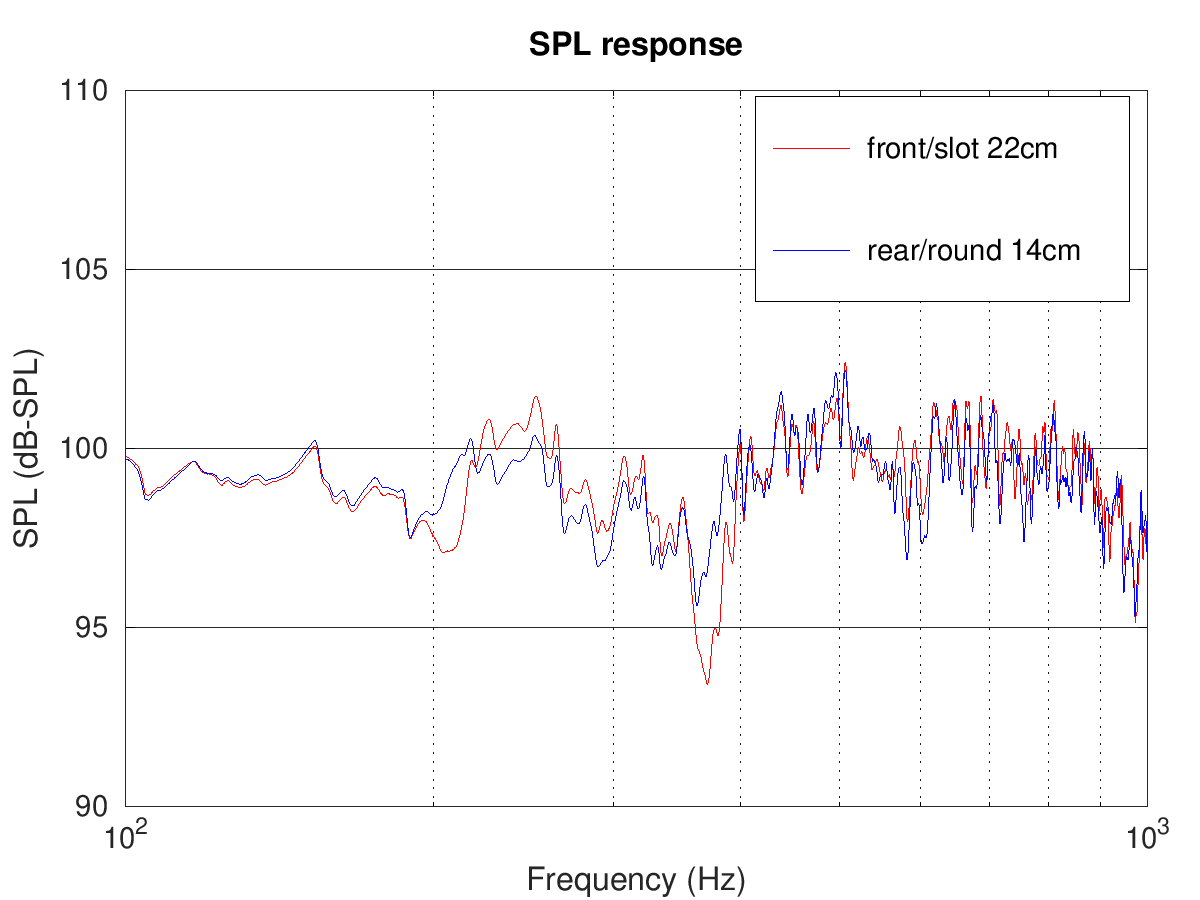

To add some concrete data to the discussion about the port placement and the "250 Hz issue" from post 740 I made a dirty experiment: I shortened the existing front/slot port to 22cm (cross section was not changed). While this results in a much higher bass-reflex tuning, the "250 Hz issue" is also (almost) gone; just compare the attachment with post post 740. It really does seem that the "250 Hz" issue was a resonance within the (long!) port.
The good news is that the 250 Hz issue can be avoided with a shorter front/slot port. The tuning frequency could be adjusted using a smaller cross section. However, the leakage of upper bass / lower midrange from the enclosure inside through the port is still a bit of a problem with the slot port below the woofer. The Monkey Coffin does sound cleaner with the rear port.

I did not try this because the experiments showed that the resonance is determined by the length of the port. Adding braces along the length would be like using several ports of the same length, but smaller diameters. Since these port would be the same length, the resonance would be the same.

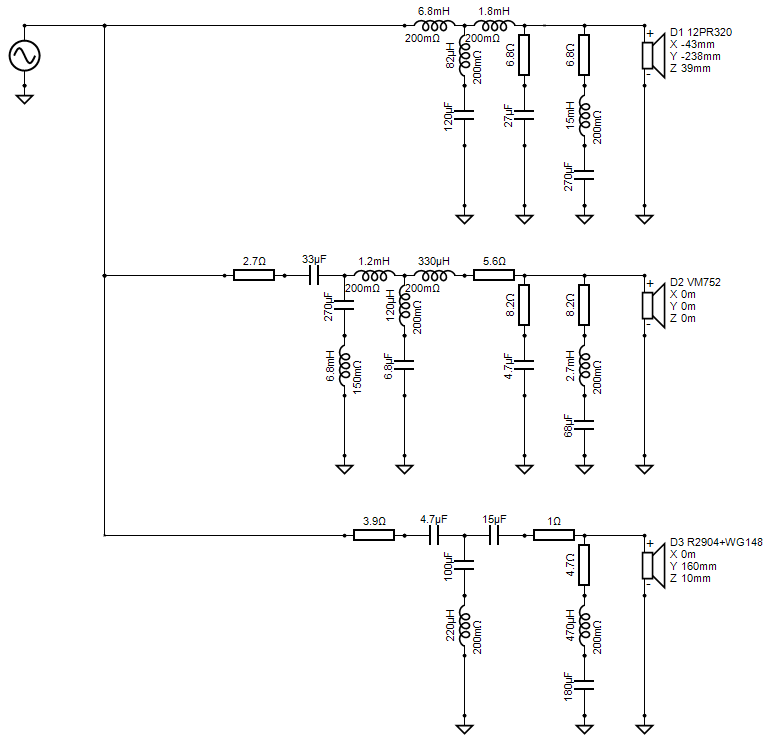

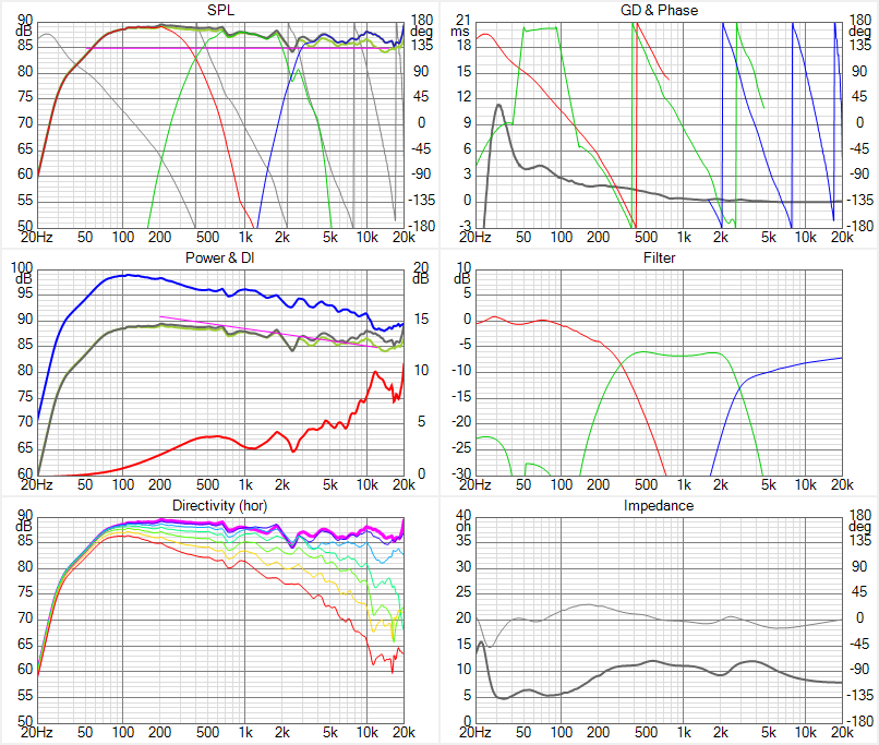

I attached my revised xover design (EL20190302) and the corresponding Vituix curves. Let me know what you think.
In particular, do you see any reason why I should not go ahead and buy the xover parts to build this (using the leftover money from the fundraising campaign)?
- I still prefer the rear port (Monacor BR-100HP, 140 mm long, centered on the rear of the enclosure). I'll leave it there. Tuning frequency is about 37 Hz (from the impedance curve, I still need to do the proper measurement by finding the excursion minimum of the woofer). Using a different port/tuning (different lengths, or front/slot port) is always a possibility. The good thing is that changing the bass reflex tuning hardly changes the upper impedance peak, so the the compensation of this peak in the x-over circuit is not affected. This meas builders can easily experiment with the port/tuning to suit their taste.
- The DSP filters I tried were the "Conventional 3B" and the "Elliptic 3.4mix" as described in post 685. Just to be sure, I measured the miniDSP filter curves from Pauls biquad coefficients, and they were extremely close to the filter transfer curves of the passive filters modelled in VituixCAD. As already mentioned earlier, the overall tonal balance is essentially the same for both filter designs. However, the Elliptic version is more "transparent" (it's a bit like using a better amplifier), so I stayed with the Elliptic version for the further testing.
- I made a few anechoic SPL measurements of the Monkey Coffin with the DSP filters in place, and I found very good consistency with the Vituix calculations (both individual drivers and summed response). This is not surprising since the Vituix output is just the "multiplication" of the unfiltered SPL curves and the filter transfer functions, but it's still good to confirm that the Vituix output is good.
- Listening tests showed that the overall balance was a tad too bright, a bit too much energy in the treble. This was fixed easily by reducing the tweeter level by 1.5 to 2 dB. A tiny bit of attenuation of the midrange might also be good (0.5 dB or so), but maybe that's just the acoustics of my workshop. Implementing these changes in the passive filters seems to be a piece of cake, as it can be done by simple changes of the series resistors.

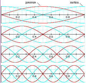

Sorry, still have to post on the topic since your conclusion seems to be wrong
I think its not the port length, which would have its own resonance, lowest resonant wavelength is at 2 * length of the port. 22cm long port =~ 780Hz. Resonances of open air columns
The box height is the only dimension which would result a standing wave at ~250Hz. Port being at the pressure node of such resonance at the enclosure end makes the resonance sound come through the port, it seems.
If it is so that a pressure node of a standing wave likes to come through the port, best place for a port would be in the middle of the enclosure (for the lowest standing wave in mind) where there is a velocity node (pressure antinode). See attachment for pressure nodes, red line
But, then the port is in the pressure node of the second harmonic at ~500Hz and that would leak through the port as much. If one wants to balance the attenuation between the "leaking" standing waves, best place for the port would be somewhere between 1/5 - 1/3 of the enclosure height which doesn't hit a pressure node of the worst offending (height related) standing waves. Maybe the two lowest resonances are the most troublesome, so hit 1/4 to attenuate first and second standing wave. Higher harmonics are attenuated more by the box lining at the top / bottom so maybe not a problem.
That's the "classical" bass reflex port resonance. However, it seem the original slot port we used in the Monkey Coffin had a 1/4 resonance, possibly because its one end was semi-terminated by the rear wall of the enclosure creating a pressure node. The resonance went away once I made the slot port shorter, moving the port throat further away from the enclosure rear wall. This shows that the issue was not due to a standing wave within the enclosure, which I did not change at all. Please take a look at the earlier posts with the measurements illustrating all this.
No, Matthias. It did not go away.
The affected area is in a shorter pass band, but the resonance is still there, centered around the exact same frequency, just slightly less visible on the SPL measurement.
I have mentioned this before, I even mentioned the resonance would be there before you started building the box, asking if there was somewhere else you could put the port.
It seems like you are very interested in crossovers and baffle diffraction, but completely ignore what is going on inside the box.

Yes, the standing wave in the box is always there, no matter how long the slot port is. But that was never the problem, and dampening materials took care of most of those internal standing waves.
The problem is/was a resonance that showed up in the measurements with the long slot port, but did not show up in the short slot port. Also, this resonance did not change when I added damping material in the enclosure. The frequency of the resonance was exactly consistent with a 1/4 length resonance of the port. It did not fit the internal dimensions of the enclosure. Just take a look at my earlier measurements that demonstrate these points.
I measured the port options, and I listened to them. I know what works best for me, and I am not going back to this ad-nauseam discussion. If anyone wants to build the Monkey Coffin with a different port, feel free to do so.

Does anyone have any comments regarding the latest xover design?
...Does anyone have any comments regarding the latest xover design?
Technically, schematics and plots do look ok. Elliptical filters tend to sound bright. In my speaker with elliptical filtering the overall SPL is flat, but I have different drivers. With the Volt 3 inch midrange you have more power than a 7 inch midrange as used in my speaker for example.I attached my revised xover design (EL20190302) and the corresponding Vituix curves. Let me know what you think.
Applying steep filtering, like the ellipticals are, also implies more high frequency power for the same SPL curve. That is because the tweeter can push more power in space, because of a more high Q filtering with less overlap between the drivers.
Remark that changing resistors in the xo to adapt levels, also affects the curve shape (and sound), because the resistive load on the filter does change. In that way it is more recommended to use L-pads (if possible).
