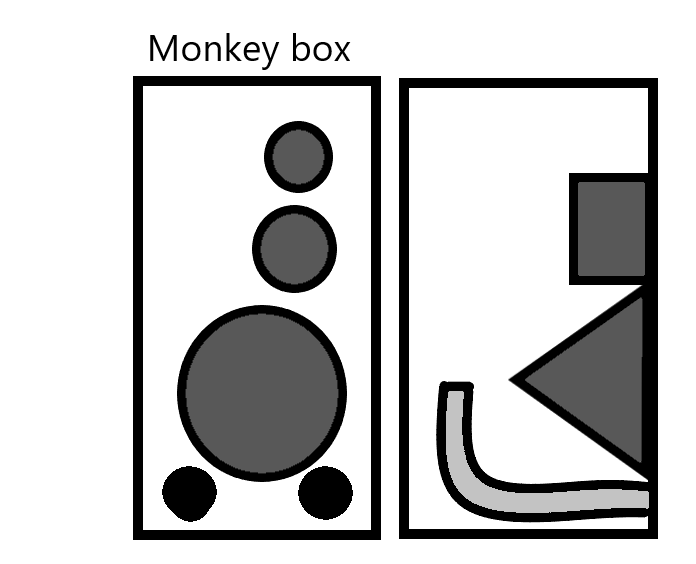

How about a tube port that has 90¤ angle inside the box? This usually attenuates high frequency leakage and might help for 250Hz issue. It is easy to twist the end of the tube to different direction.
Take a look at he "port" of Genelec speakers!
I was actually thinking if it would be possible to make a "mode suppressor" inside the box.
Might not work, but it would be interesting to know for sure.
A bit similar to the solution Yamaha came up with, just pipes with stuffing to "consume" the resonances at fixed locations.

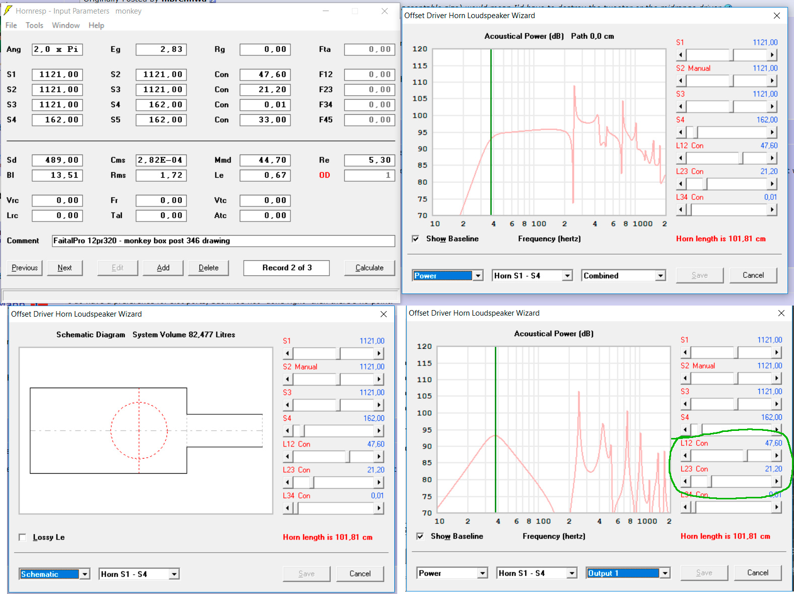

I tried to simulate the box in Hornresp as MLTL:
Clearly a resonance is seen with the current box and woofer position, but could be cancelled if woofer was roughly half way of the "pipe".
Obviously not gonna happen unless the box was made ~20cm taller :)
One could add length to "the pipe" with some internal structure but this adds length to the pipe (obviously) and brings all resonances down in frequency, which means the next resonance comes down and is not that much higher than the first was originally. Not much help here it seems :D Maybe this + some filling would damp the resonances enough if the slot port at bottom was mandatory.
Anyhow, best thing is to put the port somewhere the resonance is not so audible. As it's already done. And carry on :)

Juhazi has a good point though, one could replace the bottom slot port with a tube port that curls up into the middle of the enclosure. Down there it would not be in the way, and the tube could be angled anywhere, away from the modes.

But if a solution can be to put a tube port with a bend inside the box, in the location of the completely useless implementation of a slot port, why is that not a viable solution?
It is a real alternative to having the port on the rear, and it would allow the box to be placed in a large number of different locations in the room, if the port is on the front you can even hang the speaker on a wall and it would be fine.

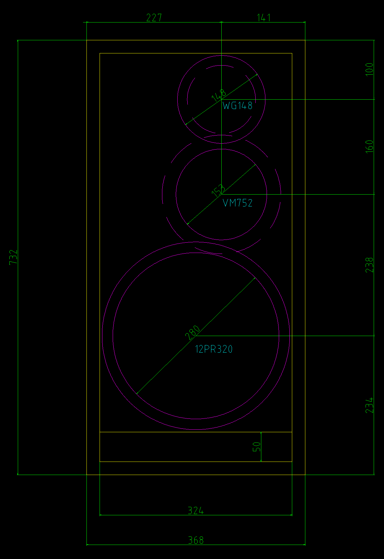

I am struggeling to understand how to implement a front port with a bend in place of the original slot port at the bottom. The port will have to bend upwards around the woofer, so it will have to be very long. But maybe I am in the wrong boat... Can someone make a drawing, using the Monkey Coffin drawing in post 346 as a template?
Is the drawing in post #271 final?

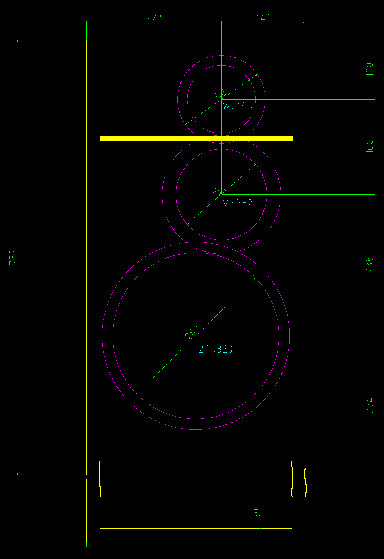

Is it impossible to make the cab higher? Just an inch more and put the tube port next to the midrange (8 o'clock). Or better than that, use two ports, second at 10 o'clock.
Or two ports below the woofer at 5 and 7 o'clock.
Changing the front baffle dimensions would change the diffraction pattern. This would imply building a new prototype, repeating the far field SPL measurements (on axis, off axis), and then redo the xover design. Sounds like a huge effort just to try another option for the BR port.
Also, the port next to the mid or tweeter is not great for diffraction reasons (see earlier posts).
Two round ports below the woofer might work, but I don't see how they could bend around the woofer without getting very/too long. That's why I asked if someone could make a drawing.
Extending the baffle's lower edge does nothing to diffraction, practically. And neither does a small increase in volume to tuning.
Port diameter and length go hand-in-hand. If we use 2 tubes, each must be twice as long as a single tube. Makes it easier to bend them up.
I vote for 2 bent tubes below the woofer and a bit taller cabinet. Still, there will be some resonances in the cab and in port tubes... ¤75mm drain pipe

IF hornresp MLTL model reflects to reality you could add panel between mid and tweeter and make the box ~12cm longer to get the woofer in the middle of the "pipe" and then there shouldn't be any 250hz resonance at the slot port. And you'd get some room for 100mm drain pipes and turn them up from the bottom. Just speculating here :D

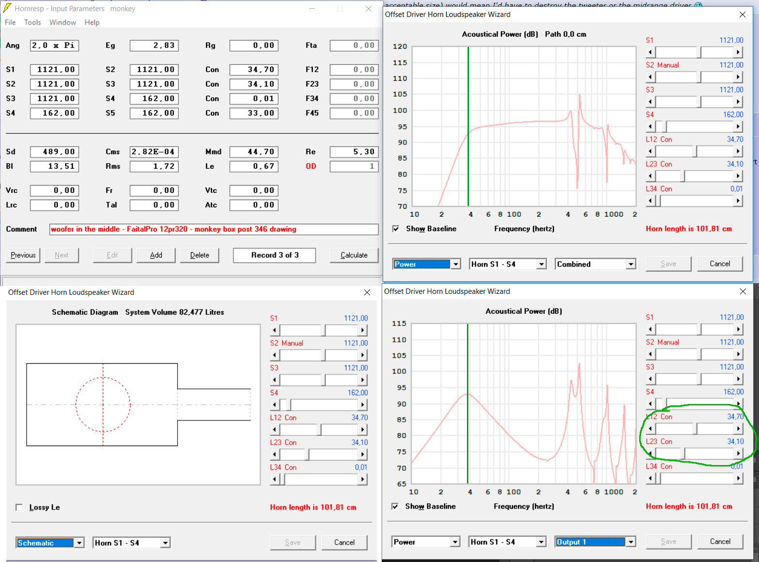

If anyone is interested I made some screenshots of the Hornresp model. Its made with Hornresp MLTL wizard from the monkey box drawing in post 346.
Check out the first attachment. Current woofer position where the woofer is ~212mm from the enclosure bottom there is the strong resonance at 250Hz visible in port output view (bottom right on the attachment) as well as in the combined output view (top right).
If one adjusts L12 so that the woofer is middle of the "pipe" the 250Hz resonance cancels out and is not showing at the port output anymore. 500Hz resonance is more pronounced here, but maybe easier to filter out by crossover and polyfill. See the other attachment.
Only thing changed between the attachments is the woofer location (L12, L23), huge difference.
If one simulates the same box from different perspective so that the port will stick from the box side or back panel (middle), the resonances are way higher up since box dimensions are shorter and the first resonance is cancelled since the woofer is in the middle of those dimensions. Didn't make any screenshots of these, one minute job to try yourself :)
I wish there was an option in hornresp to change the port location somehow :)
Anyway, a lesson here is don't put port at the end of an long enclosure and put woofer in the middle of the baffle to cancel out the lowest standing waves in the enclosure.
