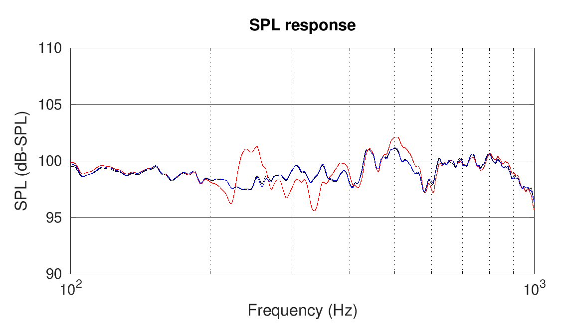

Just a quick update:
What do you guys think?
- I played a bit with the damping of the box. Doing what KaffiMann suggested a while back seems to work okay. Felt / "egg foam" on top of the divider of the bass reflex port, plus some foam on the sides of the woofer. I also added some foam on the top panel. I did not put any damping material in the way between the woofer and the bass reflex port. I have done some measurements (nearfield, acoustic) and a first quick look seems to show how the damping material reduces most of the internal resonances in the box (but I need to take a closer look at the data).
- The impedance curve and the nearfield measurements show a resonance at 250 Hz, which does not change much in response to the damping material in the box. The only way I found to reduce this resonance is to stuff the bass reflex port. 250 Hz corresponds to a wave length of 1.37m, which is pretty much 4x the length of the bass reflex port. Could this be some 1/4 wave resonance of some sort?
- Inspired by my earlier idea of trying a slightly shorter port I will try a BR100-HP bass reflex tube. I am not saying this will be "better" than the current port, but it will be easier to modify for testing purposes. Also, since it is shorter, it might provide some additional insight into the 1/4 wave resonance question above. A rough estimate shows that the BR100-HP should give a similar tuning as the current port. Then I can simply cut off little bits from the end of the tube to try different tuning options.
Question: where should I put the port? Rear or front (or even on the side or top panel)? I'd tend to put it on the back to reduce the effect of upper bass / lower midrange "leaking" out of the port. - I tried reducing the level of the tweeter a bit in the DSP filters (-1 dB). This improves the already good (perceived) sound balance even more; things just come together in a very good way. Implementing this change in the analog filter design will be easy.
I think the 250hz internal resonance is caused by the distance from driver to top, then reflection into port.
In grave danger of repeating myself infinitely, it is the sole reason I was not happy with the 12" drivers placement in the box, in relation to the port.
The only way to deal with it is to break it up, you cannot use that much dampening material in the box, it will NOT sound good.
The port is not the cause of this resonance, it is the drivers placement in relation to the internal walls that enable this resonance to occur, and at the same time allow it to enter the port almost directly. It is a problem that boosts itself. Break it up or live with it.
Hmm, I am not sure I get what you're saying, but I believe you're referring to a standing wave that develops between the bottom and the top of the enclosure. However, I am not sure that this really is the cause for the "250 Hz issue". The internal box height is 62cm, which would give a standing wave at about 280 Hz, not 250 Hz. Also, this standing wave would not be affected by stuffing the port (which it is!). I therefore don't think the "250 Hz issue" is due to a standing wave in the box.
You suggested a while ago to break the internal standing wave with an angled divider in the box. I have tried that in the past (in a different project), and it didn't work. I guess the standing wave just goes around the divider.
I may have missed it, or maybe I can't remember it, but what exactly did you not like about the placement of the woofer and the port in relation to each other? What would be a better arrangement?
I try to put woofers and ports at golden ratios of the internal dimensions, or at 1/3rds. I avoid 1/4 and 1/2 at all costs. That said, this is one area I need to do more research on. How is your placement?

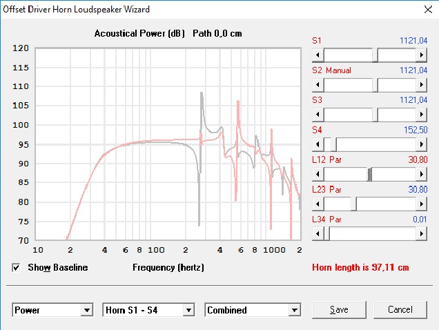

Here you go Matthias.
Actual driver placement in gray, ideal placement (red squiggly line) in this particular box, is smack in the middle.
Ideal placement pushes those nasty resonances to a frequency and amplitude they can be dealt with easily.
I do not understand how that model works. Since the box dimensions are the same for both curves, the resonances due to standing waves that develop between the walls of the box should be the same. This is clearly not what the model does. So what's the process/mechanism in this model that is responsible for the different results at different placements of the woofer in the box?
Assuming there is a way to make sense of the underlying processes that result in the different model outputs, the following would be interesting:
- Can you run that model with a "stuffed port" (i.e., no port at all)? It would be interesting what the model does with those resonances, and how it compares to what I am observing in the real world.
- In a next step, it would be interesting to see what the model does with the woofer placement as it is in the Monkey Coffin (since we cannot change that a lot), but with the port at different positions. Where is the best position for the port?
If you can place a tube port of equal length and size, front and center, in this particular box

KaffiMann, I believe I am missing some crucial piece of context. I can't make sense of your model curves, and I feel pretty stupid about this. I'd like to understand what's going on behind the scenes of your model runs, and how to interpret the model curves. I am trying to understand the processes that lead to the curves you have shown. So here I go again...
Well, yes, I understand that. But why does the driver placement make a difference in the model? What is the process behind this?
Uhm, what about the driver? If the air inside the box resonates, the driver cone will go with it.
Sure. But I am just trying to make sense of what the model does, and how it does it. That's why I asked for the "no port" model run.
Let's assume for a moment that I'd understand why+how driver placement would make a difference. The next question would then be: why would the optimal port placement where the optimal driver placement is? What is the logic behind this?

...I'd like to understand what's going on behind the scenes of your model runs, and how to interpret the model curves...
Well blank myself about acoustics inner of ported system and also running Hornresp, that said think if we did spend few minutes on below page should get us more or less going about using Hornresp and ported system understanding.
The Subwoofer DIY Page - Ported Systems
I see. Well, to be honest, I do not have the full understanding myself, you would have to ask David about this.KaffiMann, I believe I am missing some crucial piece of context. I can't make sense of your model curves, and I feel pretty stupid about this. I'd like to understand what's going on behind the scenes of your model runs, and how to interpret the model curves. I am trying to understand the processes that lead to the curves you have shown. So here I go again...
But after spending some years doing a few hours of simulations every single day, I've come to see patterns that say something about the distances inside the box. I am no good at maths, and horrible at theory, but I do have a fairly good spatial understanding, and can easily manipulate shapes, signals and reflections in my head.
It coincides with measured results, it is caused by certain frequencies bouncing around between the internal surfaces. Ask David about the math behind it.Well, yes, I understand that. But why does the driver placement make a difference in the model? What is the process behind this?
You are correct, but the increase in damping material will largely negate the effect. (and it does not show up in the simulation quite the same way, the effect may be overly reduced by the "closed box" simulation).Uhm, what about the driver? If the air inside the box resonates, the driver cone will go with it.
It does not come up the same way in closed box simulations, I aim for getting realistic simulations, not pretty simulations.Sure. But I am just trying to make sense of what the model does, and how it does it. That's why I asked for the "no port" model run.
This only counts for the tube port, because that is a point in the box where the 250hz does not resonate.Let's assume for a moment that I'd understand why+how driver placement would make a difference. The next question would then be: why would the optimal port placement where the optimal driver placement is? What is the logic behind this?
Because it is very unpractical to place a slot port in the middle of the enclosure. Better to use an existing boundary.Why would the optimum placement of a slot port be different than for a round tube?

Software tools can only simulate so much. I used to run a lot of akabak sims, but after a while I came to see that Hornresp was much easier to use, and eventually came incredibly close to the akabak results, so seeing as akabak is no longer in development, and requires an XP machine, I came to rely more on Hornresp.
David Mcbean is the creator of hornresp, he has a sticky thread in the subwoofer forum.
Do not trust Hornresp? Not a problem for me, but then by your definition that 250hz resonance should not exist.

Software tools can only simulate so much ... Do not trust Hornresp?
It's not that I don't trust Hornresp. It's just that I don't understand the processes that are included in the model, so I find it difficult to interpret the results. As long as I don't know what processes are in the model I cannot interpret the results such that I can use them to tweak a real-world loudspeaker system.
...but then by your definition that 250hz resonance should not exist.
My logic is the other way round. I know the 250 Hz resonance exists, because that's what the measurements tell me. I'd like to do something against this resonance, so I need to understand the process that causes it. A computer tool that works on a model with processes that are unknown to me will therefore not help me.
The only thing I understand so far is that the 250 Hz effect is not easy to explain with a standing wave within the enclosure because (a) the effect goes away if the port is stuffed (which has nothing to do with internal standing waves) and (b) the box dimensions don't match the 250 Hz frequency.

The postman delivered the round bass reflex ports (Monacor BR-100HP) I ordered for testing. I installed one in the Monkey Coffin (centered on the rear panel) and measured the nearfield SPL response of the woofer:
You can clearly see that funny things happen at 250 Hz with the front/slot port open (red curve). No such resonance happens with the rear/round port, which is quite a bit shorter than the front/slot port. This indicates that the 250 Hz issue happens within the long slot port, not in the enclosure.
I'll continue by taking a closer look at the bass reflex tuning with the new port, and also do some listening tests.
- Red curve: front/slot port open, rear/round port closed (filled with compressed foam)
- Blue curve: Rear/round port open, front/slot port closed (filled with compressed foam)
- Black curve: Both ports closed (filled with compressed foam)
