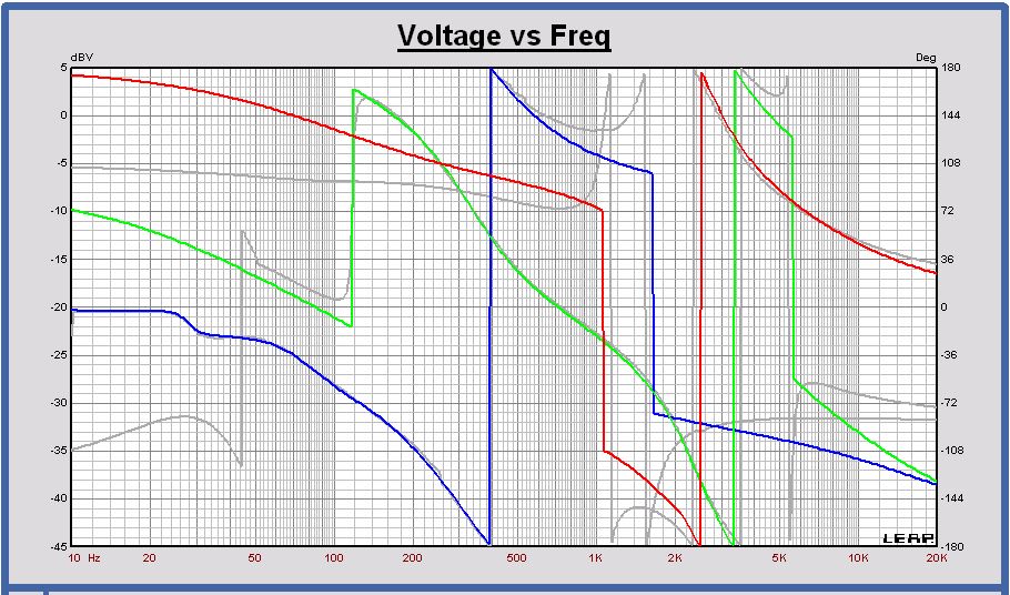

Just to check: can you show a comparison of the phase curves of the biquads and the Vituix simulation?
The phases of the xo transfers of biquads and Vituix targets are equal in the passband and loosing target far outband.
In the plots, the grey curves are the targets. Woofer = bleu, midrange = green and tweeter = red.

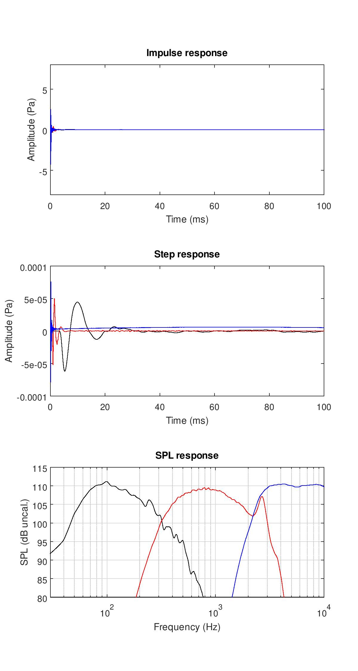

I have listened to the DSP implementations of the "Conventional 3B" and the "Elliptic 3.4mix" filters described in post 685. The overall sound of both filters is very similar, and at the beginning it was surprisingly hard to tell them apart. As always, these things take a while to figure out. The sound of the Elliptic 3.4 mix is a bit more transparent, which becomes apparent especially when complex music is playing (several instruments and vocals playing at the same time). Going from the Conventional 3B to the Elliptic 3.4 mix is a bit like going from a good amplifier to a better amplifier. Both filters work well, but the EL is a bit better. The only gripes I have at the moment is that the bass is a bit "anemic". The bass itself is very good, but the overall sound balance could benefit from a bit more bass.
Since it's hard to do meaningful farfield acoustic measurements below 300 Hz or so, I did some nearfield measurements (attached). I was a bit surprised to see that the nearfield SPL levels were essentially the same for the woofer and the mid/tweeter (note that the absolute SPL level is not calibrated with the miniDSP/active setup, but the relative SPL differences are correct). With the baffle step kicking in the farfield (where my ears are), it's no surprise the bass is "anemic". Did we make a mistake with the baffle step modeling / low-frequency splicing somewhere along the road?
Let me know what you think.
P.S.: please don't worry about the 2.5 kHz peak of the midrange nearfield measurement (see earlier discussions).

Remember that the baffle step is not included in the near field measurement. If you take this into account, the bass will be up to 6 dB lower.
The exact shape of the baffle step is not simple to determine, though. It might be possible to model or measure it in the free field (outdoors, on a "tower" to get away from the floor reflections). Not sure what's the most meaningful approach for in-room situations.

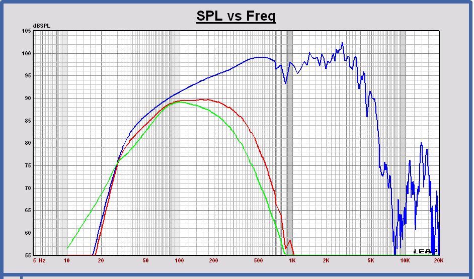

In attach some simulation results to compare your nearfield measurement with.
The farfield response of the woofer without xo at 1m in blue and with xo in red. The simulated nearfield response with xo in green (scaled). Quite consistent with your nearfield measurement. I used the voltage xo transfer of the EL34mix digital xo version.

I am not (yet) concerned about the shapes of the filter curves around the woofer/mid x-over point.
My concern is more fundamental. The max. SPL levels of the nearfield measurements of the woofer and the midrange (and the tweeter) show up at approximately the same level (see post 708). In the far field, you need to take into account the baffle step, which is centered around 300 Hz for the Monkey Coffin (using this simple formula). This means that the max. bass SPL (woofer) would be up to 6 dB lower than max. SPL of the midrange driver in the farfield.

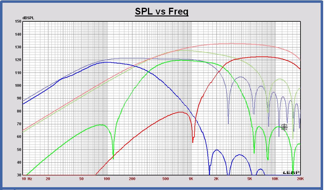

Remark that the nearfield SPL of a smaller driver is higher for the same SPL at 1 meter distance. Simply because the piston Sd of a little driver is smaller and the acceleration has to be higher for the same SPL at 1 meter.
In the plot the simulated nearfield responses of the three drivers without and with xo. The filtered curves in the more dark color. Almost conform your measurements, but the absolute nearfield level is difficult to measure very accurately.
Making the port shorter is an option, but it means a new low frequency design...

Argh, of course! Brain malfunction on my side!
Far field SPL is proportional to sqrt(Sd) x nearfield-SPL. With woofer Sd = 489 cm^2 and midrange Sd = 57 cm^2, the woofer would theoretically be be louder than the midrange by a factor of 2.9 (ignoring the waveguide of the mid). Taking into account the baffle step, things should get levelled out more of less.
