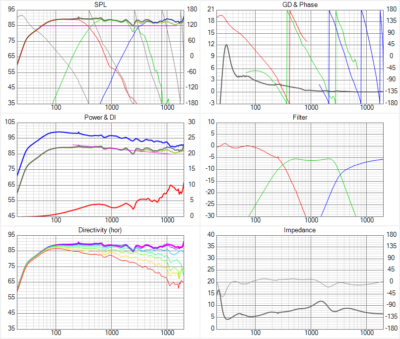

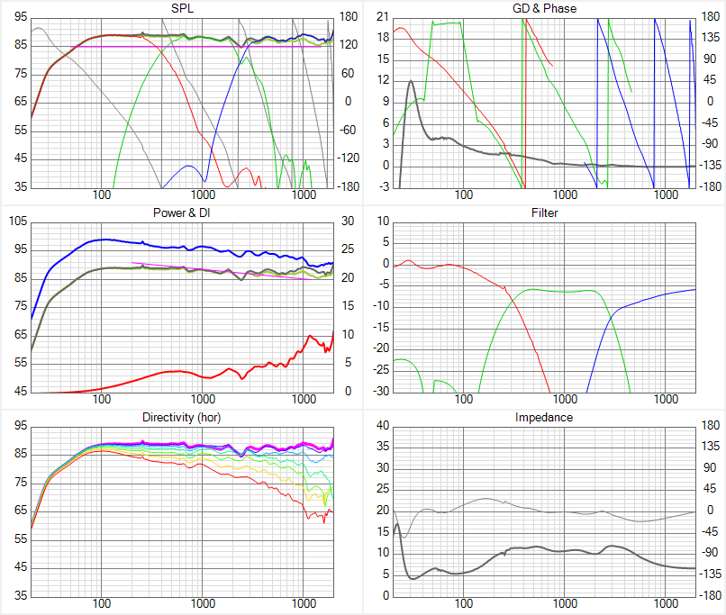

I can see how the group delay would be different for the individual driver responses, I don't see this for the complete system. In fact, the group delay curves (top right panel) look rather similar to me for all three simulations.
I feel stupid... Was looking at the wrong graph, impedance plot... *Duh*

Well, I'd say that the labelling of the Vituix graphs isn't exactly great. There are no axis labels, no units, and 1 kHz seems to be the same as 10 kHz. 😀

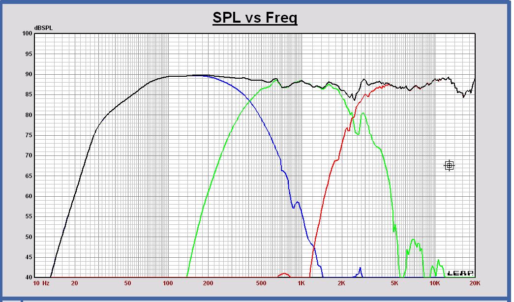

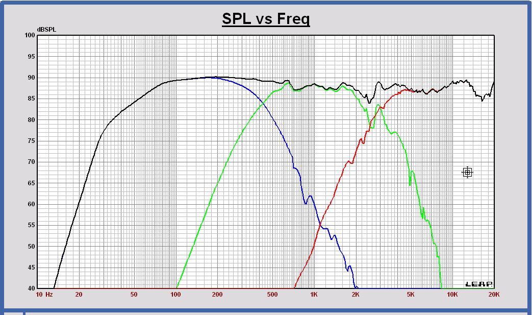

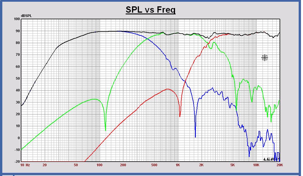

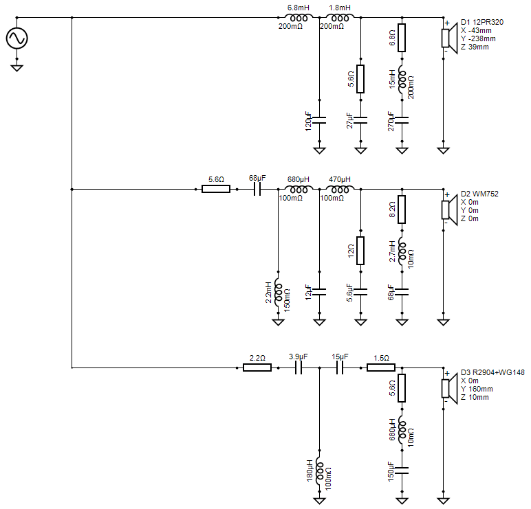

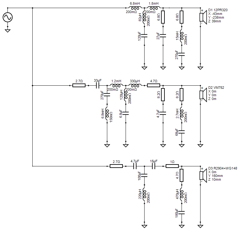

Here are some revisions of my filter simulations in post 664.
The rules that I "applied" during the tweaking were about the same as before (smooth+flat overall system SPL response, good off-axis and power response, no funny peaks/dips in the electronic filter curves). In addition I made sure the acoustic filter slopes were approximately symmetric around the x-over points, and I tried to make the filter curves a bit smoother than for instance the EL3 filter in post 664.
First, I improved the "conventional" filter (option (3) in post 664) to give an overall flatter response. While I was at it, I added a resistor before the filter(s). Splitting the attenuation resistances between before/after the filter(s) helps tweaking the filter transfer curves. This also helped to reduce the "directivity blip" at 2.5 kHz. Let's call this filter version the "Conventional 3B".
Then I went back to the elliptic filters (options (1) and (2) in post 664) to see if they can also be improved using the "split resistances". I played around with many options, and in the end I found a nice solution with the EL3. This involved making the second series capacitor in the midrange filter so large that it became ineffective, so I simply deleted it. The midrange filter circuit was now the same as in the EL4 filter (but with different part values). I tried adding the parallel capacitor in the woofer filter as in the EL4 filter, but couldn't tweak the system to a better response, so I removed that capacitor again (leaving the EL4/option-2 from post 664 in the dust). The resulting circuit is a mix between Pauls EL3 and EL4 proposals (but with different part values and different filter transfer curves). The voltage transfer curves are quite a bit smoother than before, and I really like the overall simulation results. Let's call this version the "Elliptic 3.4mix".
Simulation results and x-over schematics are attached. Comments, suggestions?

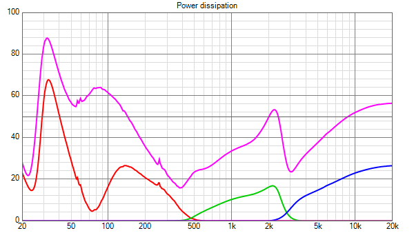

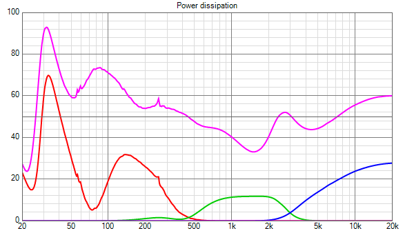

Nice work there 🙂 maybe no problem then ignore this post but WM752 opens up in lows now and don't know where its wattage comfort zone is, for example 20 volt input show 1 watt at 190Hz for option two post 685 where option one post 664 show 1 watt up higher at 450Hz.
First graph below is option one post 664 and second graph is option two post 685.
That's a good catch (although I am not sure which curve to look at, but I guess you're referring to the green curve). I am not worried about the power at all. 1 Watt is a piece of cake for this driver.
However, cone (dome) excursion could be more interesting. If the voice coil leaves the linear range of the motor due to low frequency "leakage", distortion will go up. Since I couldn't quickly find a way to calculate cone excursion, I simply measured it (peak-to-zero at 200 Hz): 0.36 mm with 6.1 Vrms at driver terminals and 0.62 mm with 9.9 Vrms at driver terminals. 1 Watt into 10 Ohm (impedance at 200 Hz) is about 3.3 Vrms, so cone excursion would be about 0.2 mm. Volt give Xmax = ±1 mm in their TSP specs. So even at 20 Vrms input to the filter (1 Watt or 3.3 Vrms into the driver), cone excursion would remain at 20% of the specified max. Should be fine.
--- Since I couldn't quickly find a way to calculate cone excursion, I simply measured it (peak-to-zero at 200 Hz): 0.36 mm with 6.1 Vrms at driver terminals and 0.62 mm with 9.9 Vrms at driver terminals. ---

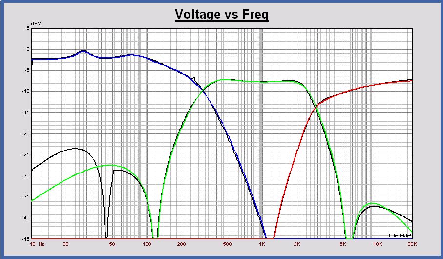

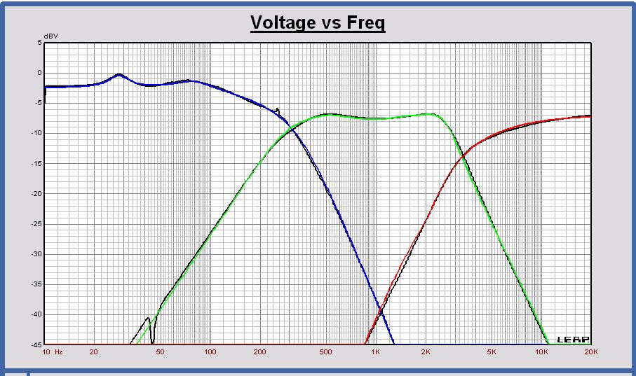

Since there are no more complaints about those filter designs, here are the filter transfer curves (voltage at driver terminals) for the "Conventional 3B" and the "EL34mixed" versions.
Paul, can you convert these to miniDSP biquad coefficients so that I can test them in the prototype?

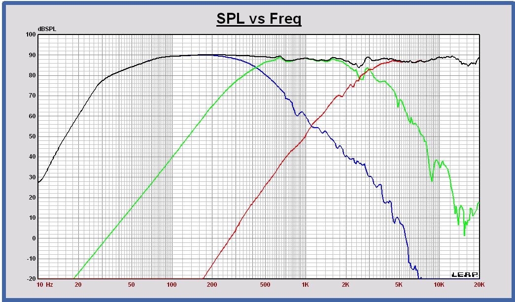

Here the biquad version for miniDSP of the 2 Matthias' designs. The transfer level decreased 1.5 dB to avoid digital overflow.
In attach also the voltage transfers of both xo (targets in grey) and the SPL of the digital filtered drivers as a check.
Thank you Paul! The biquads seem to be very close copies of the Vituix output!
