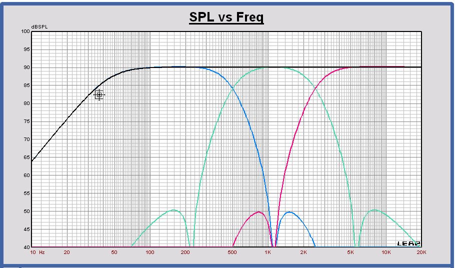

And what about an EL4? Targets in first plot for a xo at 500 and 2500Hz. Compared with EL3 and LR4 at same xo points in other plots.
You can see the EL3, I designed before, is more brickwall around the xo points. EL4 has a more LR4 behavior.
Anyway I will test the EL4 on my own speaker with miniDSP, how it sounds. First time I will design such one.
EL4 450 - 2500 Hz is also possible of course...

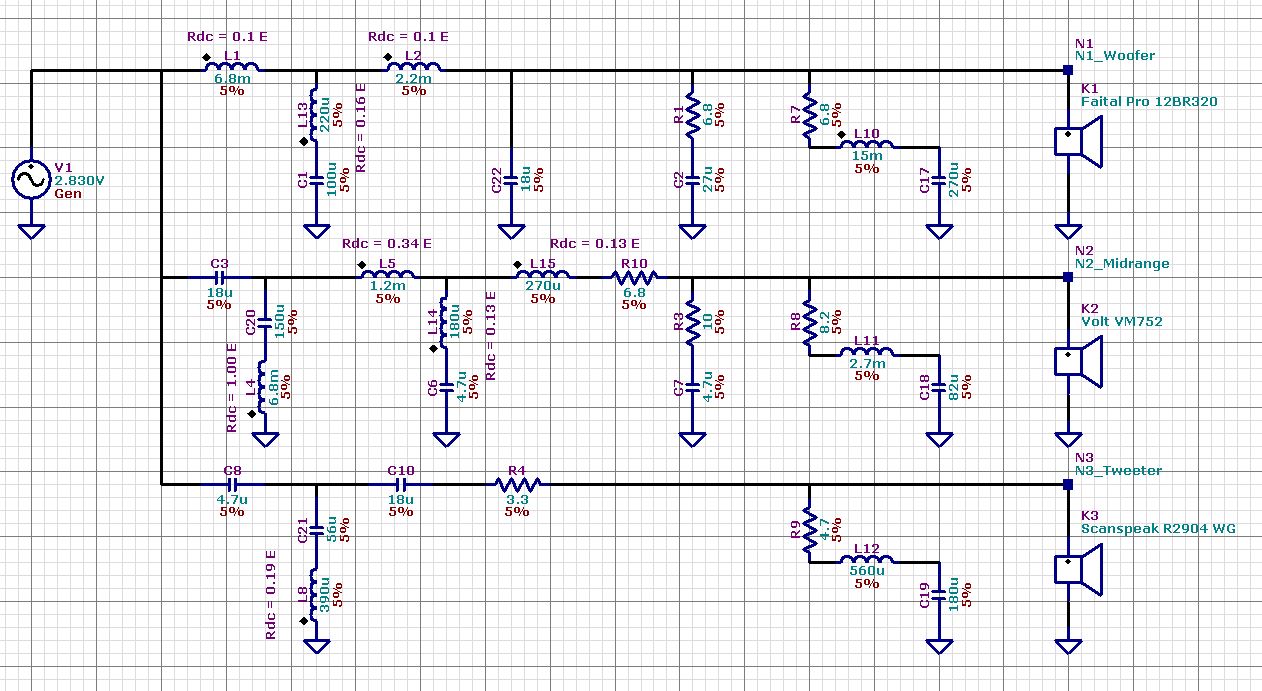

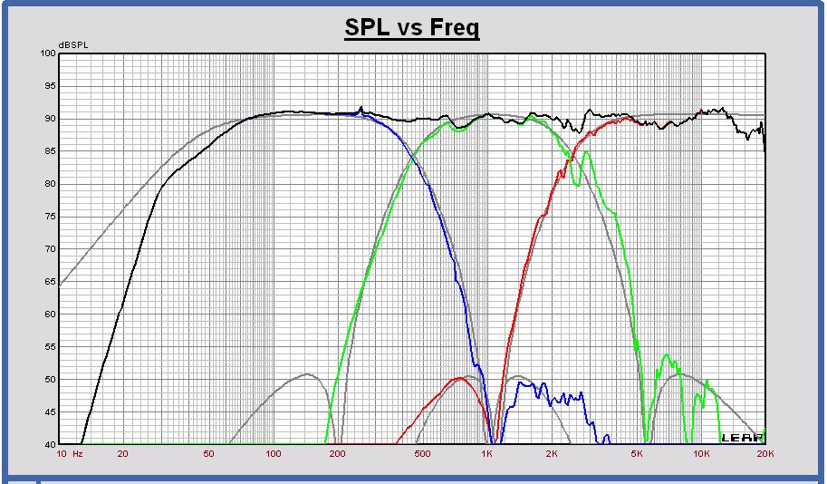

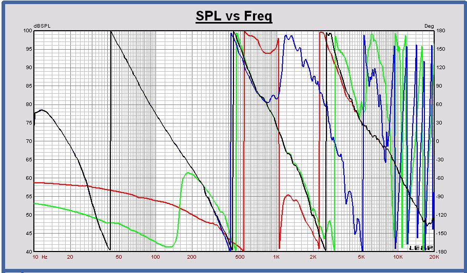

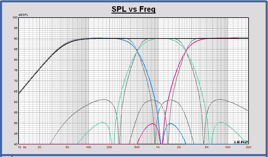

The 4th order elliptical filter EL4 isn't more complex than the EL3. Other component values, one capacitor extra in the woofer filter and one less in the midrange filter.
EL4 has a better outband reduction of 40 dB, the sum response of the targets is flat and the target phases are aligned perfectly.
XO schematic and plots of SPL, phase, impedance, xo transfers and groupdelay in attach.
Choosing for an elliptical concept, the EL4 is the best choice. All plans to improve EL3 will result in more complex filters, worse SPL flatness and deviations from target.
We can discuss about all later on.
This looks interesting! Thanks Paul! I will try to empirically tweak my earlier simulation of the EL3 to in order to see how much I can improve the outband attenuation of the woofer. I will also do a version with this EL4 filter. Finally, I will try to make a "conventional" non-elliptic version for comparison. I will do this in Vituix because that's what I have and it also makes it easy to look at the off-axis response.
EL4 should be pretty good at any rate, I am not very familiar with the passive implementation of filters. But if EL4 is about equal to EL3 in complexity, I consider it (the choice) a no-brainer.
Juhazi, That was what I was proposing, to approach more equal acoustic xo slopes between the drivers, it has been common practice for years, the measured response of drivers is available, trying different filters and measuring to quality check the results equals more work, but it takes less time than arguing.
But if EL4 has the same components count as EL3, we do not have to discuss this further.

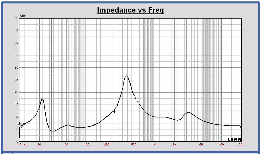

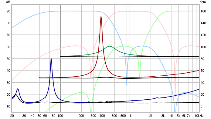

In attach the EL4 targets used for the passive filter design, that can be useful in Vituix also. While tweaking it is important to stay around the targets, also outband. Timing will be affected between the filtered drivers compared with the target behavior and such filters will tend to sound blury and colored. Therefore I am not a fan of tweaking and adding circuits to improve outband reduction of the EL3 for example, compared with EL3 targets, that are different.
Will mean most drivers change subjective character to the better using resonance plus inductance compensation networks to linearize drivers impedance and experience is that is also the case using a active XO system, so suggest for these trials with miniDSP to find the optimal XO topology that add those components so that sonic improvement is also present for the active trial setup and those components shall be used anyway down the road, also for the subjective worry about the port such a network can make a change.
Below is the visual linearization that Paul use for the 3 times resonance compenzation networks plus 2 times inductance networks:

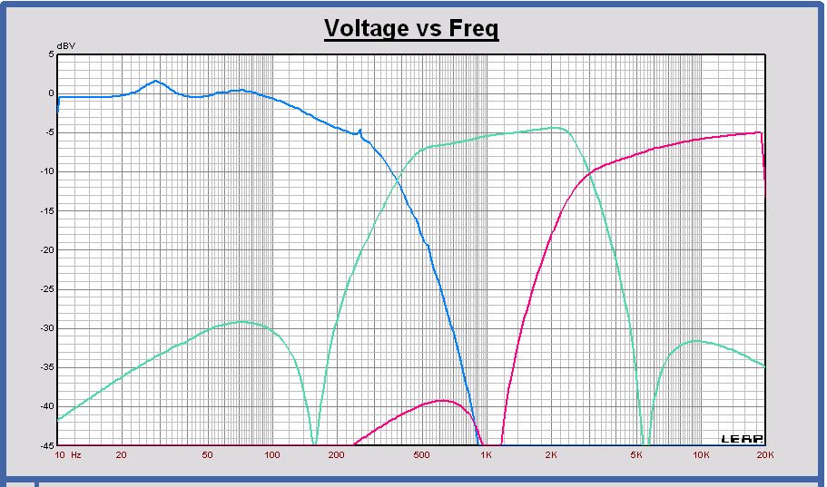

Byrtt,
For the EL3 biquad miniDSP version I made for Matthias, the voltage transfers of the passive xo are chosen as the filter targets. In that way it is inclusive the influence of the impedance compensation networks. It was the reason we did it that way to have an exact copy of the passive filter version in the miniDSP.
