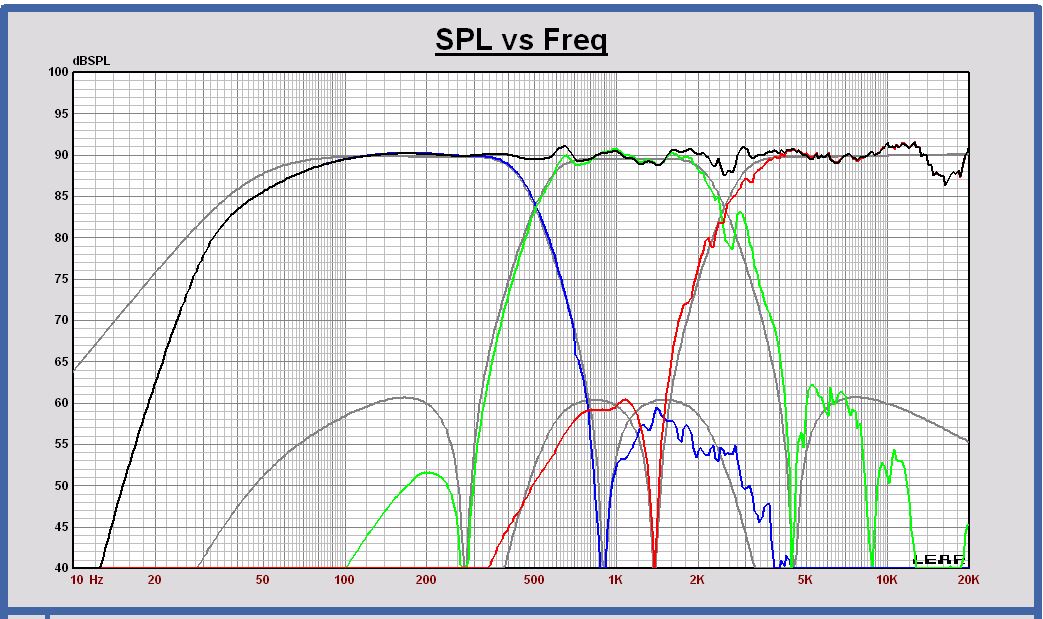

In attach the SPL and xo transfer plots of this design.

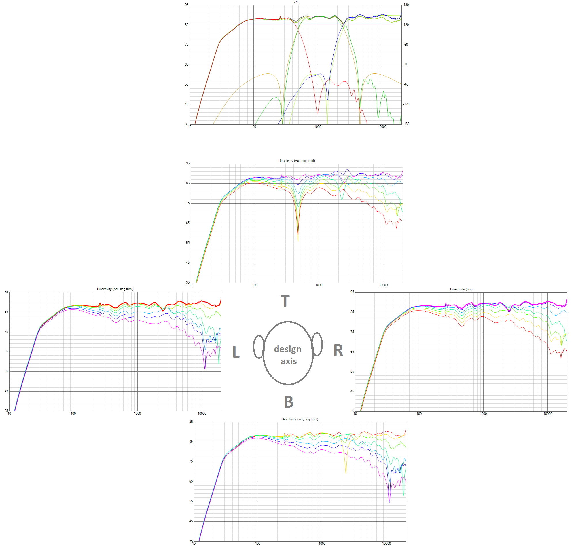

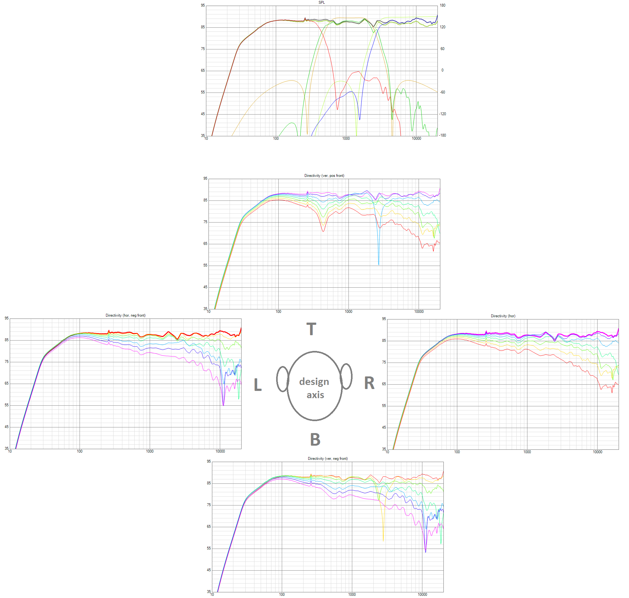

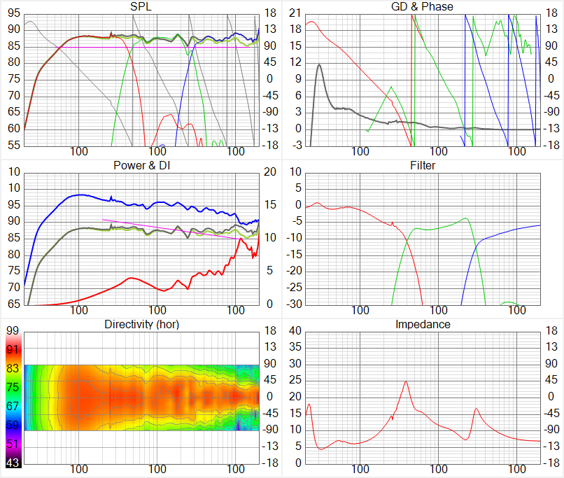

I took Byrtts Vituix project file from post 544 and replaced the measurment data with those from post 576. Then I started having fun with the values of the x-over components. The result is attached.
What do you think?

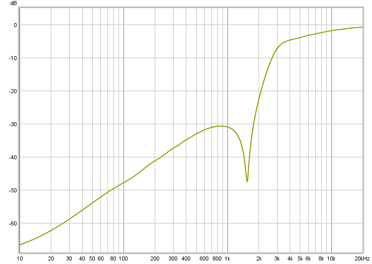

How can I get this into the miniDSP (filter curves attached)?
What do you think?
Hahah! That's a big "party hump" Matthias 🙂
Have you listened to it using just slope eq? Probably sounds very "fun", it's probably a really good match for the MonkeyBox.
What do you think?

Paul has package to get those filter curves into biquads.
What do you think?

I don't see any filter targets? While tweaking components, it is important to look also to the deviation from the targets. Driver filter targets are theoretical and have a relation to each other, because they use polynomials with a same behavior, also w.r.t. timing. Changing components without monitoring the deviation from target, will lead to worse matching between the filtered drivers. Not my preferred way of designing...

Can you still make a biquad version in Leap using the filter transfer curves in my previous post?

Its not called target but rightclick in SPL plot gives possibilty of up to two overlays at a time, alternative for using visual target curves is VituaixCAD can be open multiple of times so now open a new session and setup three directly wired drivers where each driver have Paul's three bandpass targetfiles linked and in full screen mode one can toggle between the two open VituixCAD sessions to see if your curves line up or not to target.
Below is using the up to two overlays in SPL plot, left one as is with post 576 handcrafted predictions of measurements and right one is with tweaked components. Sure horizontals plus power response and directivity index improve with tweaked components, quistion is if you happy about how true those edited measurements of post 576.

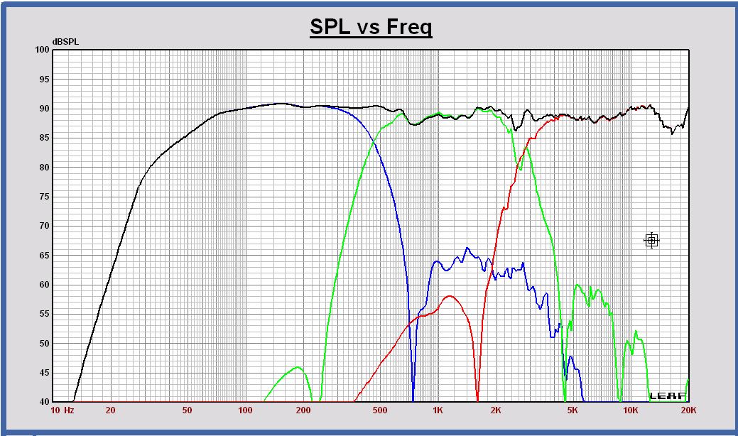

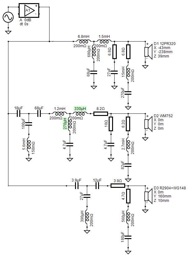

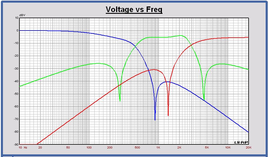

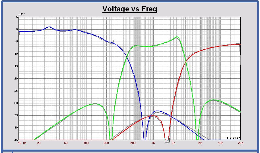

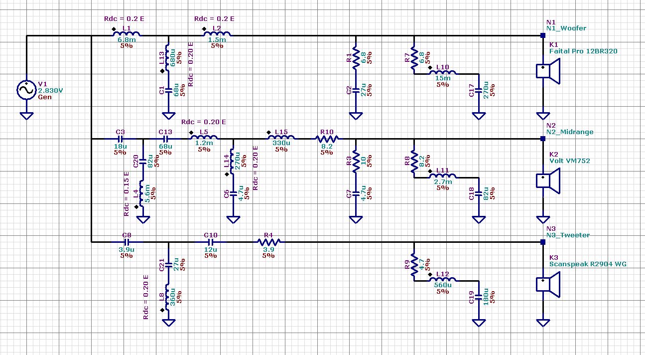

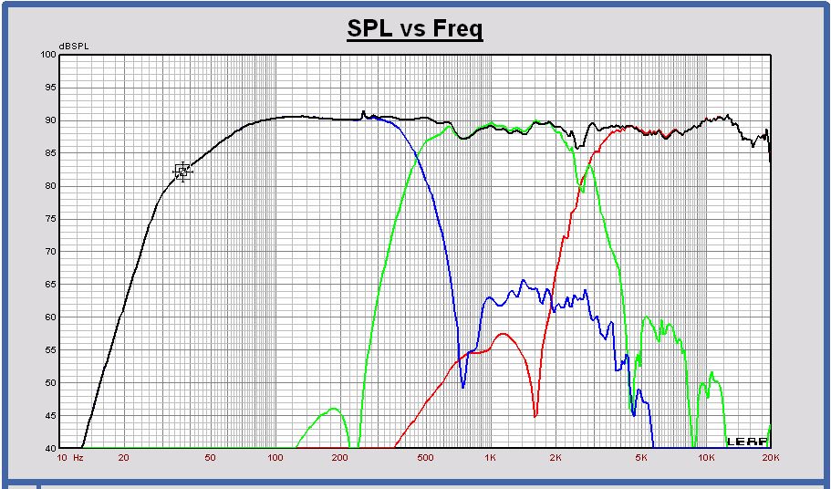

Here the digital design in Leap of the tweaked EL3 by Matthias
In the plots:
- schematic tweaked passive EL3 xo
- SPL tweaked passive xo
- SPL tweaked digital xo
- voltage tranfers digital xo (color) and the transfer targets of passive xo (grey)
I did my very best for a fit as good as possible 🙂.
Success with it Matthias!
Edit: I just checked the passive xo component values again, I used a wrong value for a coil in the tweeter xo, 360 uH instead of 390 uH.
This will give a minor change. I think it is ok for a test now.
