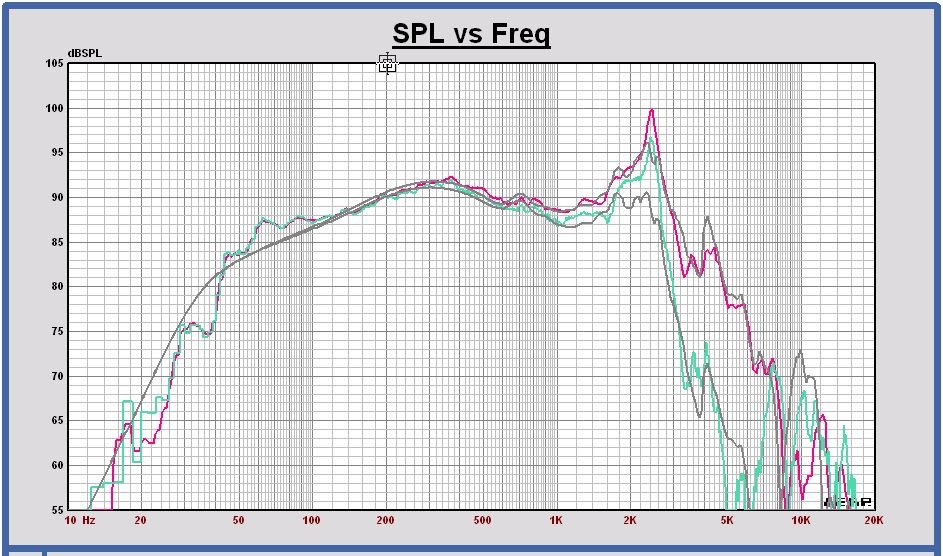

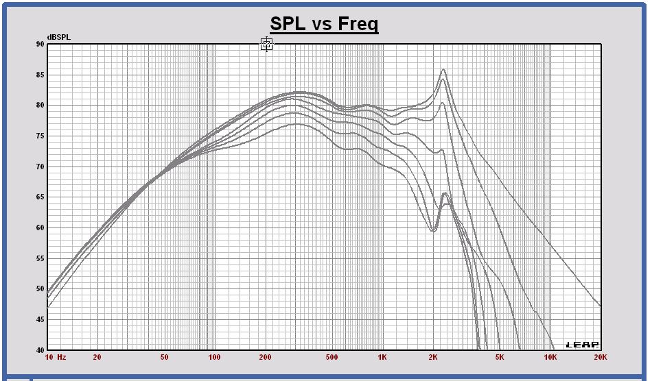

I have done an off axis simulation in Leap to compare with the indoor measurements of Matthias.
There is a large difference between the simulation and the measurements.
In the plot the SPL off axis of the Faital 12PR320 0 - 30 - 60 deg on - off axis. Measurements in color, simulations in black.
I dont't understand it. I have some older off axis measurements of an 11 inch in a cabinet, done in a professional anechoic room. I will have a look at those also.
Remark that ka = 1 at 439 Hz for the used 12 inch woofer.
As an information, this is the transition frequency between non-directional and directional radiation (on infinite baffle).
I will investigate this, we have to be sure which are correct off axis curves if an off axis study of the woofer is wanted...

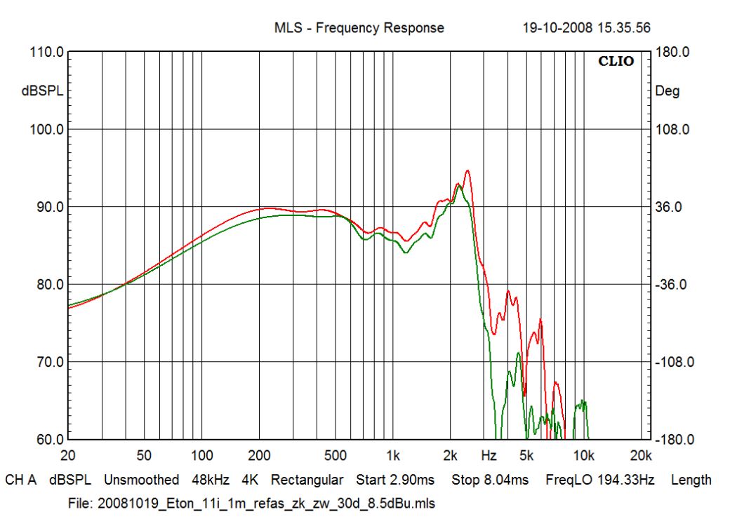

Look to a Clio outdoor measurement on axis and 30 degrees off axis, I did in the past of the same speaker I also measured in the anechoic room (post 563). The gate time is set to 5ms in that Clio measurement (settings below the graph). These measurements become close to the anechoic measurements above 500 Hz.
Seeing all these results, I don't understand the results of your off axis measurements. Are you sure of your measurement settings?
I dont't understand it. ...
This does look strange indeed. Is it possible the outer parts of the Faital cone tend to "shut off" at higher frequencies, resulting in a smaller effective cone diameter?
These curves are almost parallel up to about 3.3 kHz. Isn't that a bit unexpected given the ka argument you gave above (should get directional below 1 kHz). Also, if the anechoic part / gate time is 5 ms, the data would be anechoic down to 200 Hz. And there should be no data below 200 Hz, but the curves go down to 20 Hz. This looks a bit awkward to me.
It's always possible that I screwed up my indoor off-axis measurement somehow. However, I repeated some of these measurements a few days later, just to check (and they were consistent). Also, the on-axis measurements I made indoors and outdoors are nicely consistent > 300 Hz (where both are anechoic). The indoor on-axis measurement was just one of the many measurements I made during the series all dispersion measurements. I don't see any reason for a messed up measurement set up. In any case, I will check again some time during the next few days.

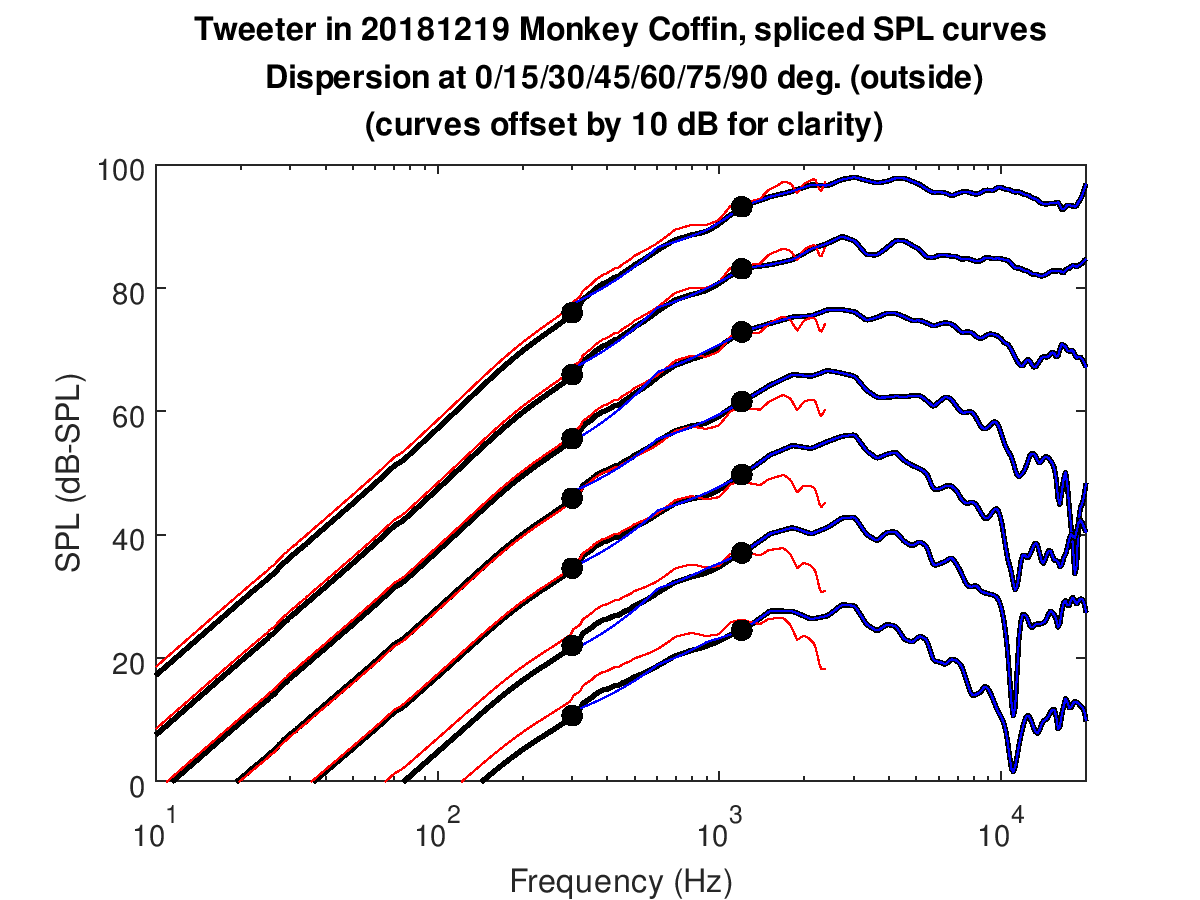

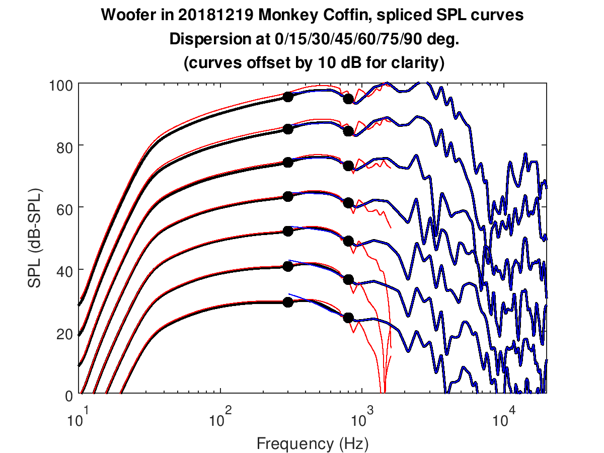

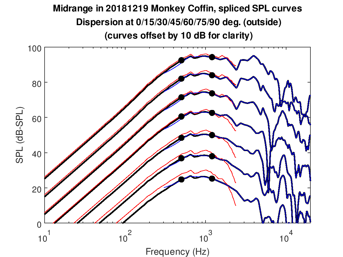

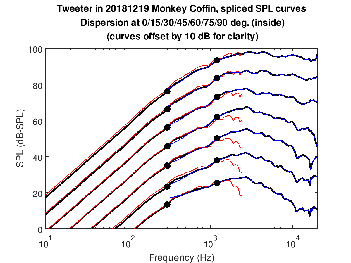

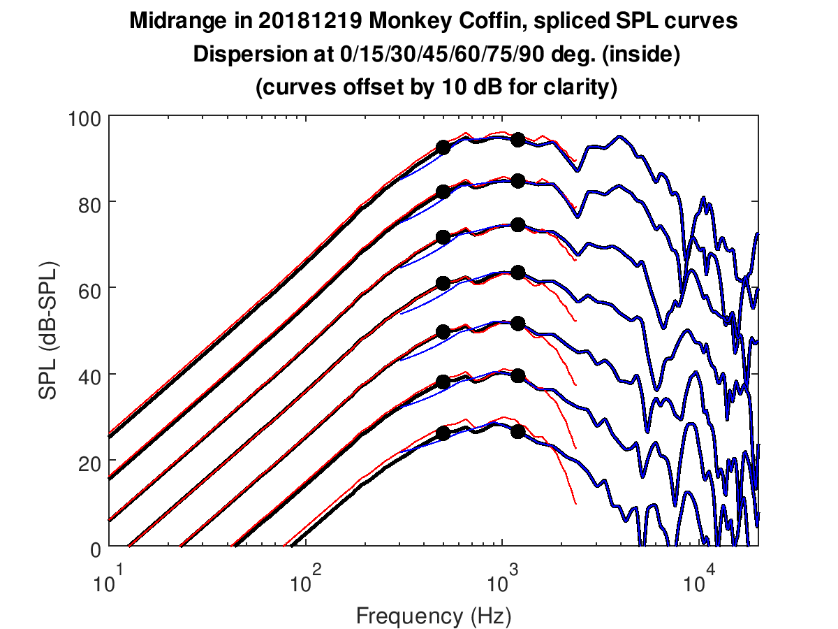

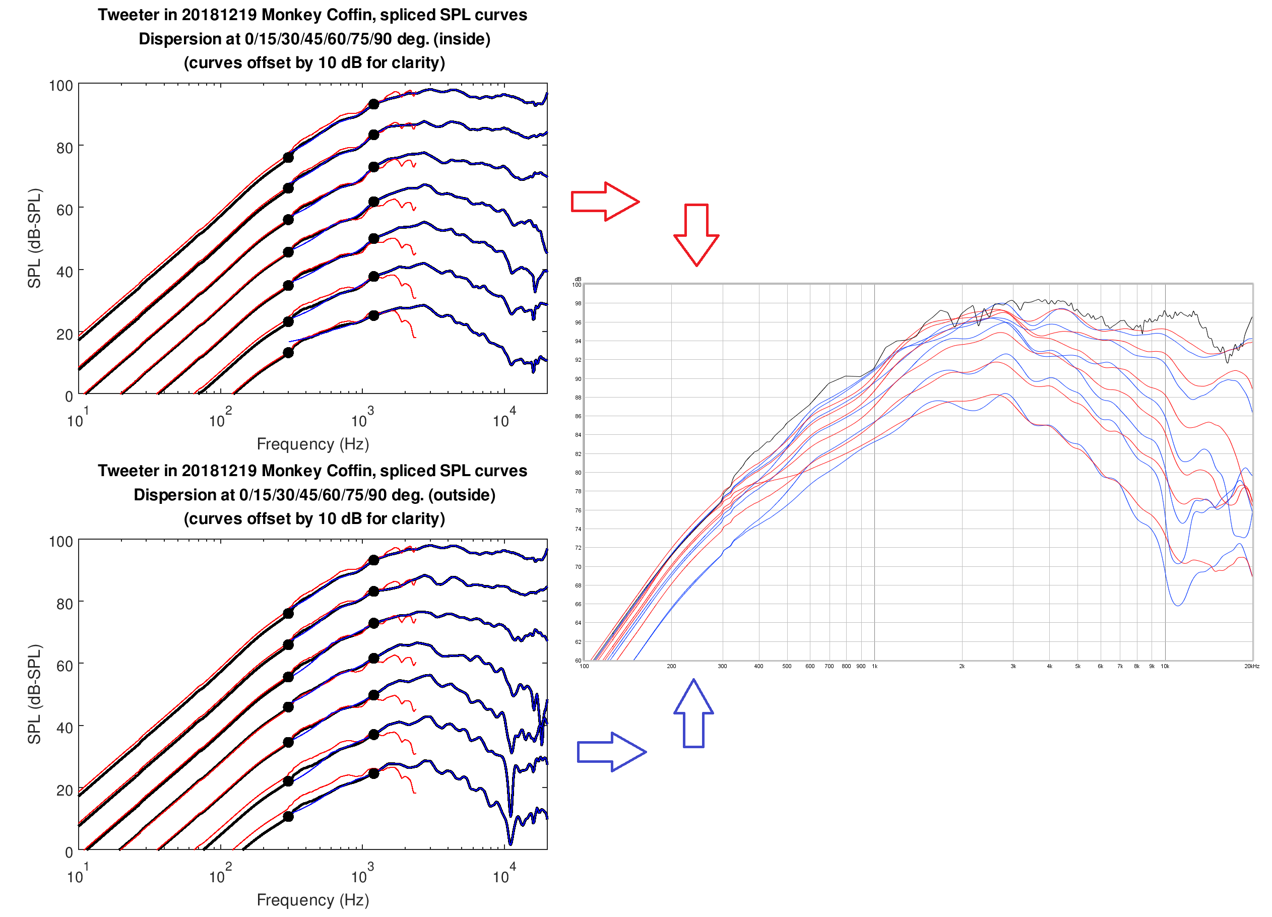

Following up on my thoughs in post 555, here's my attempt to produce a complee data set of SPL curves from 20 Hz to 20 kHz at horizontal angles from -90° to +90° at 15° steps. The goal is to obtain consistent data for use in modelling software.
Here's a step-by-step description of what I did:
(A) The indoor measurements at horizontal angles from -90° to +90° (15° steps) were used at frequencies from about 500 Hz or 1 kHz and up. These curves were measured indoors and therefore allow anechoic SPL curves down to about 300 Hz only. Also, the FFT resolution is rather low for modelling purposes below 1 kHz or so.
(B) The low-frequency parts of the SPL curves from post 511 were used to define the on-axis response below about 500 Hz to 1 kHz. The off-axis response in this low-frequency range was estimated from the on-axis curves using the directivity index curves determined from the Vituix diffraction calculator as described in post 555.
(C) The high-frequency parts from step (A) were spliced to the low-frequency parts from step (B) to obtain SPL curves spanning the entire frequency range and horizontal angles. The curves were spliced with MATAA using a "soft merge", as shown in the attached plots (red: low frequency part, blue: high frequency part, black: spliced curves, black dots indicate the "soft merge" range).
(D) Minimum phase was determined from the spliced SPL magnitude curves.
(E) Data was exported to FRD data files for use with modelling software.
Let me know what you think about this procedure. I can still implement (minor) changes, as the whole procedure is implemented in an "automated" Octave script, so it's easy to repeat. I think the resulting data are nicely consistent and allow much better comparison and modelling of the on-axis and off-axis behaviour.
The 30 degrees SPL for that speaker is correct, measured like that in the anechoic room and with my Clio outdoors. I just wanted to say that Leap simulates it conform these measurements and not with the Monkey Box.
The measured woofer is the Eton 11-581, it has a rather flat cone, not a deep one.
I think that Clio applies some interpolation on the measured data. The extension to 20 Hz, I don't understand.
Matthias, at very low frequencies like 20 Hz your speaker is omnidirectional, so no attenuation off axis.
So, the off axis responses of your last post cannot be correct.
Edit: in the plot a typical horizontal off axis response of a woofer in a cabinet

A first look comment is not about procedure but can see for whatever the reason is that resolution looks better than the off axis curves from your website project page zip folder, should look clear in below comparison where we see off axis looks smoothed or use FDW than Paul's on axis curves from post 511.
My plots are pretty much in line with the expected omnidirectional behaviour. Note that the curves are artificially offset by 10 dB from each other just to make the plots clearer (as noted on the diagrams).
This is simply because the data used for the curves in post 511 had a lot of smoothing. I used much less smoothing in post 568.
Oops, I was a little bit too fast with my comment, sorry.

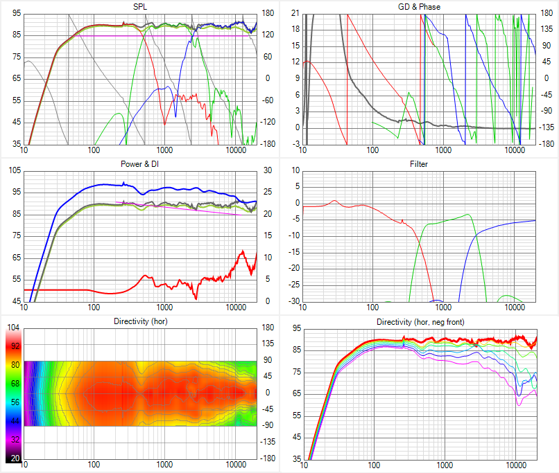

The procedure is ok. It is the same as we have done for the on axis curve, but using the Leap low frequency simulator in that case... if I have understood it well this time...

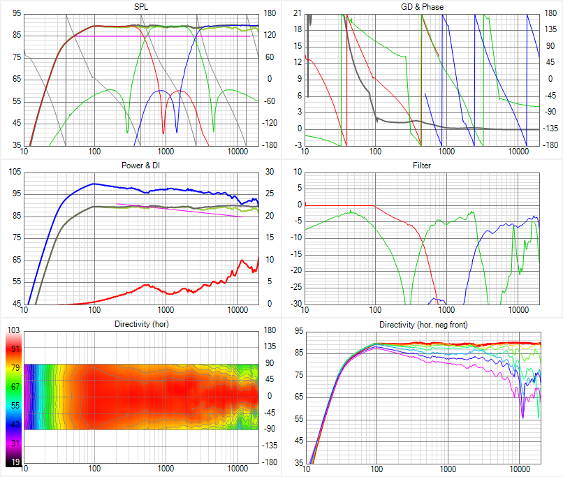

Matthias,

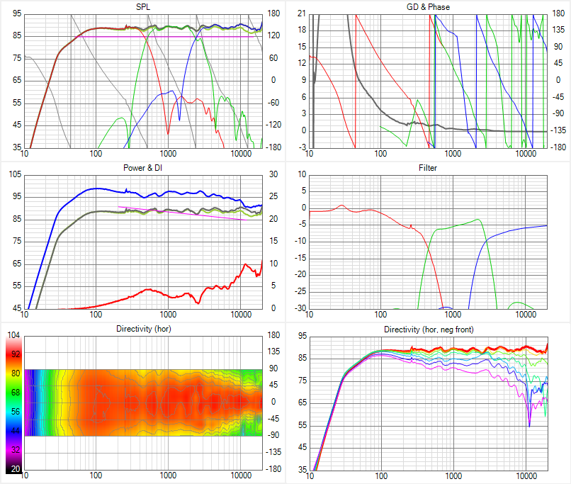

Traced your post 568 curves although your originals should be better than traced images but below is what i get.
First is before, second is the new ones where power response dip for 500Hz XO point improve alot and power response peak about 2800Hz plus its weaker directivity index is still there, third is same as second but using a transfer funchtion so as slopes get nearly a text book target this seems improve power response peak about 2800Hz plus its weaker directivity index there but will probably need powerfull DSP engine to get so smooth a response.

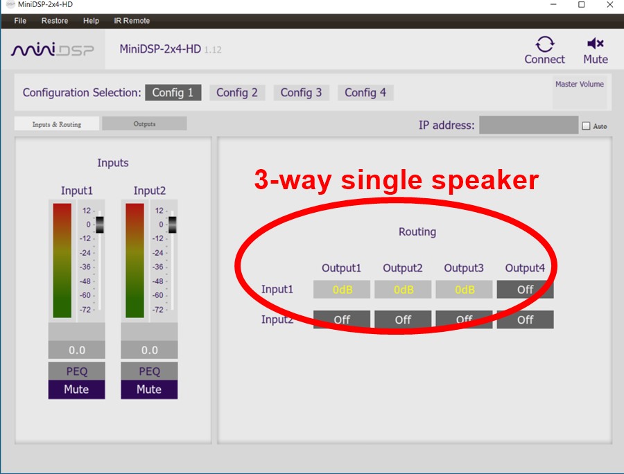

Yes, you must use the right application for the unit.
Looking at simulations, directivity below 800Hz in second and third version looks too high for this kind of speaker/drivers. Was speaker-mic distance constant when doing off-axis measurements of bass driver? If you just move mic sideways, distance grows and signal attenuates. Speaker/mic distance to wall variation can cause the error too.
Ok, found the software, got it working on virtual machine, convinced computer to route USB to virtual machine, convinced Windoze to swallow the miniDSP driver, and voila: connected to the miniDSP and set it to 1-input / 3-output as shown in your attachment. Now how do I tell it to use Pauls EL3 filter?
Yes. I just rotated the speaker around the center line of the baffle. Just to be sure: did you realize that my plots have additional 10 dB offsets between the curves? I did that in the plots to make it easier to see the individual curves, it's not really in the data!
