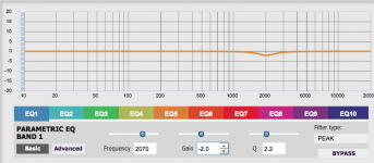

Ok, I played some music with the biquad filters from post 619 for a while. This is promising!
There is still a bit too much "energy" in the lower treble/midrange. I made some quick-n-dirty measurements (very messy overlays of many curves in the end, not very useful to show here) while I was trying to set an equalizer notch to reduce effect that my ears didn't like at the same time. In the end I could identify a small peak at about 2 to 2.1 kHz, which my ears didn't like. The corresponding notch settings are attached. I will have to make some proper measurements and then go back to the filter design, hoping I can change the transfer curve accordingly.
Apart from this, there is some internal resonances in the enclosure happening (as we figured out earlier by acoustic and impedance measurements). These resonances are audible, but surprisingly not as bad as one might expect from the massive peaks/dips around 400 Hz. I ordered some wool to stuff into the the enclosure, which I hope attenuates the resonances.
I also wondered how bad it would be to put the bass reflex port to the rear. The port outlet would be further away from the woofer, but the 400 Hz interferences would be attenuated quite a bit before they reach the ears.

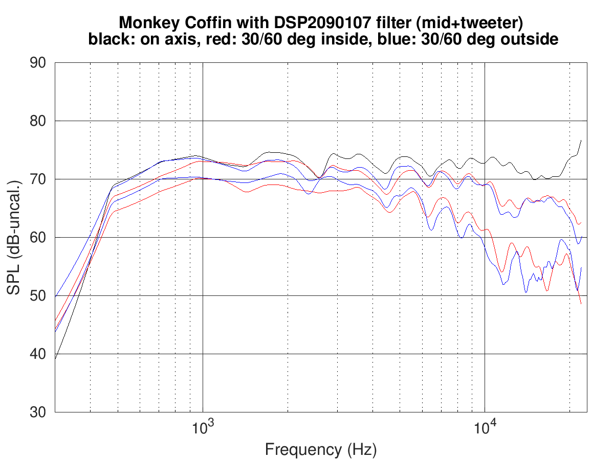

I made some more measurements (microphone 1m from baffle, height centered between mid and tweeter; SPL level not calibrated because this was measured without level calibration of the miniDSP + active amps). I believe it's better to forget about that peak/notch from post 625 for the moment. I think the mid/tweeter combination is doing really well.
The first attachment shows the on-axis SPL response of the full system. The black line was measured with woofer, midrange and tweeter connected at the same time. The red line was measured with the woofer disconnected. The woofer output obviously interferes with the midrange between 900 Hz and 2 kHz. This is not good, and we need to fix this somehow. Is this the leakage of the elliptic low pass filter of the woofer?
The second attachment shows the SPL measured at 0, ±30° and ±60° horizontal. I think the dispersion is nice and smooth, even at the x-over from the mid to the tweeter between 2 to 2.5 kHz. The two dips at 1.4 kHz and 2.5 kHz are attenuated in the off-axis curves, which confirms they are due to baffle-edge diffraction. I don't see anything to worry about in these curves.
I really think the woofer needs some work. It really shouldn't upset the midrange like it does. What are your thoughts about this?

I don't think this issue is related to summing at the x-over frequency (about 400 to 500 Hz), which is much lower then the trouble area of about 1-2 kHz. Ideally, the woofer should be "silent" from 1 kHz and up.
I'd expect the woofer to be out of phase above the x-over frequency. Remember that the elliptic filters have "leaky" stop bands and the (unfiltered) woofer gets really loud between 1 and 3 kHz (about 100 dB-SPL or so). I wouldn't be surprised if the stop-band "leak" causes the midrange trouble at 1-2 kHz -- but I am not sure.
Would it make sense to try another filter function without "stop-band leakage" (Butterworth, Bessel, etc.) just to see if the issue goes away?
EDIT: take a look at the modelled acoustic output of the woofer at 1-2 kHz in post 619. It's only 24 dB below the midrange. Hmm.
...I don't think this issue is related to summing at the x-over frequency (about 400 to 500 Hz), which is much lower then the trouble area of about 1-2 kHz. Ideally, the woofer should be "silent" from 1 kHz and up.

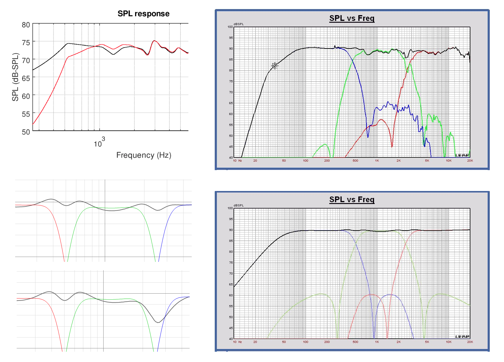

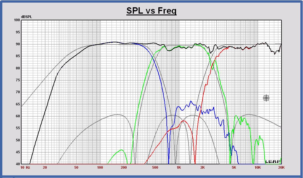

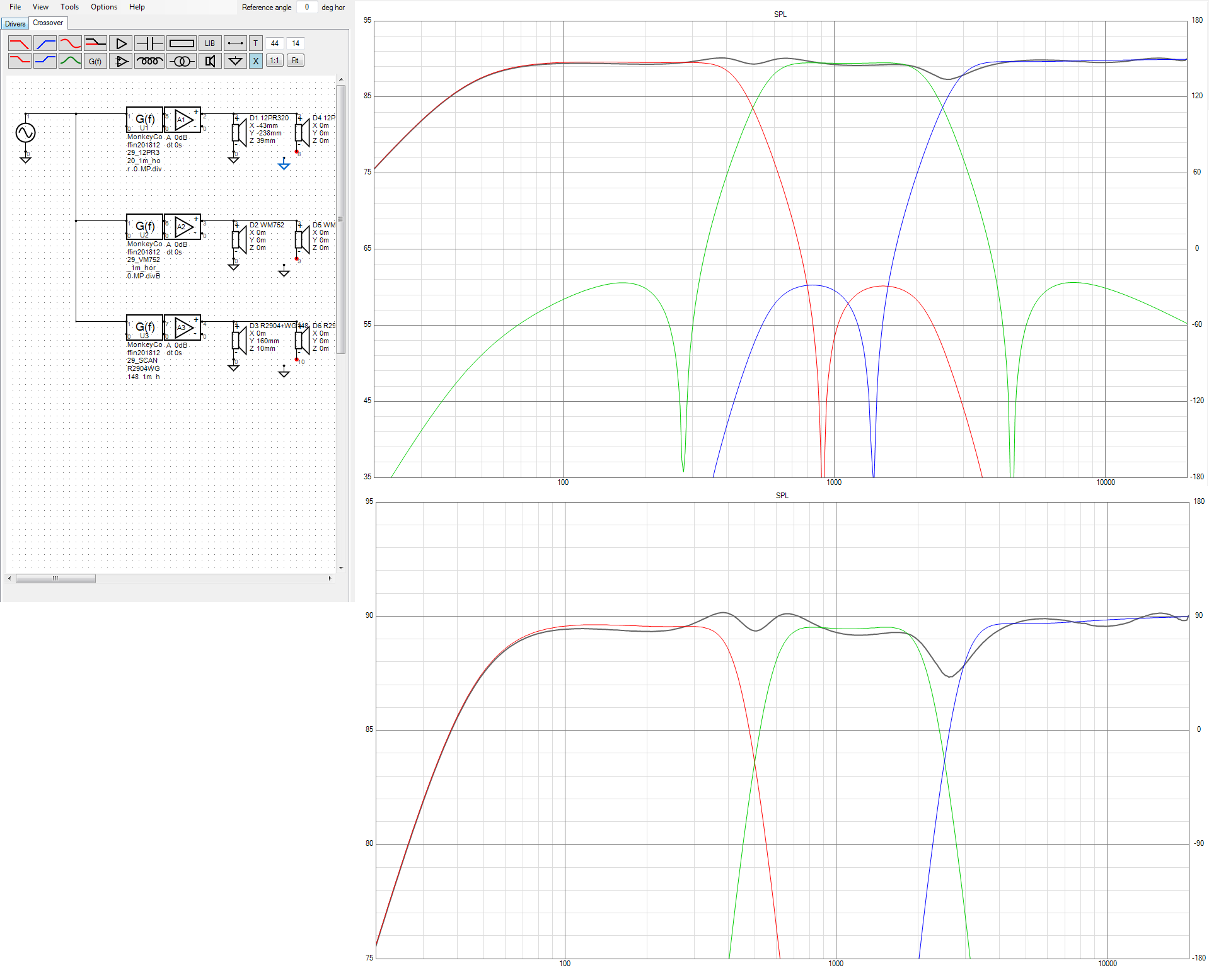

Below visuals show how the perfect text book slope would sum, the first one is using Monkey Box spacing of drivers and AC mismatch, the second one as a perfect coxial with same AC and no spacing. Guess mostly for other slopes symetrical or non symetrical than a pure symetrical LR we get some ripple interference here and there, if LR will work good for Monkey Box physicals and sum smooth as its theory is non known and has to be simulated.

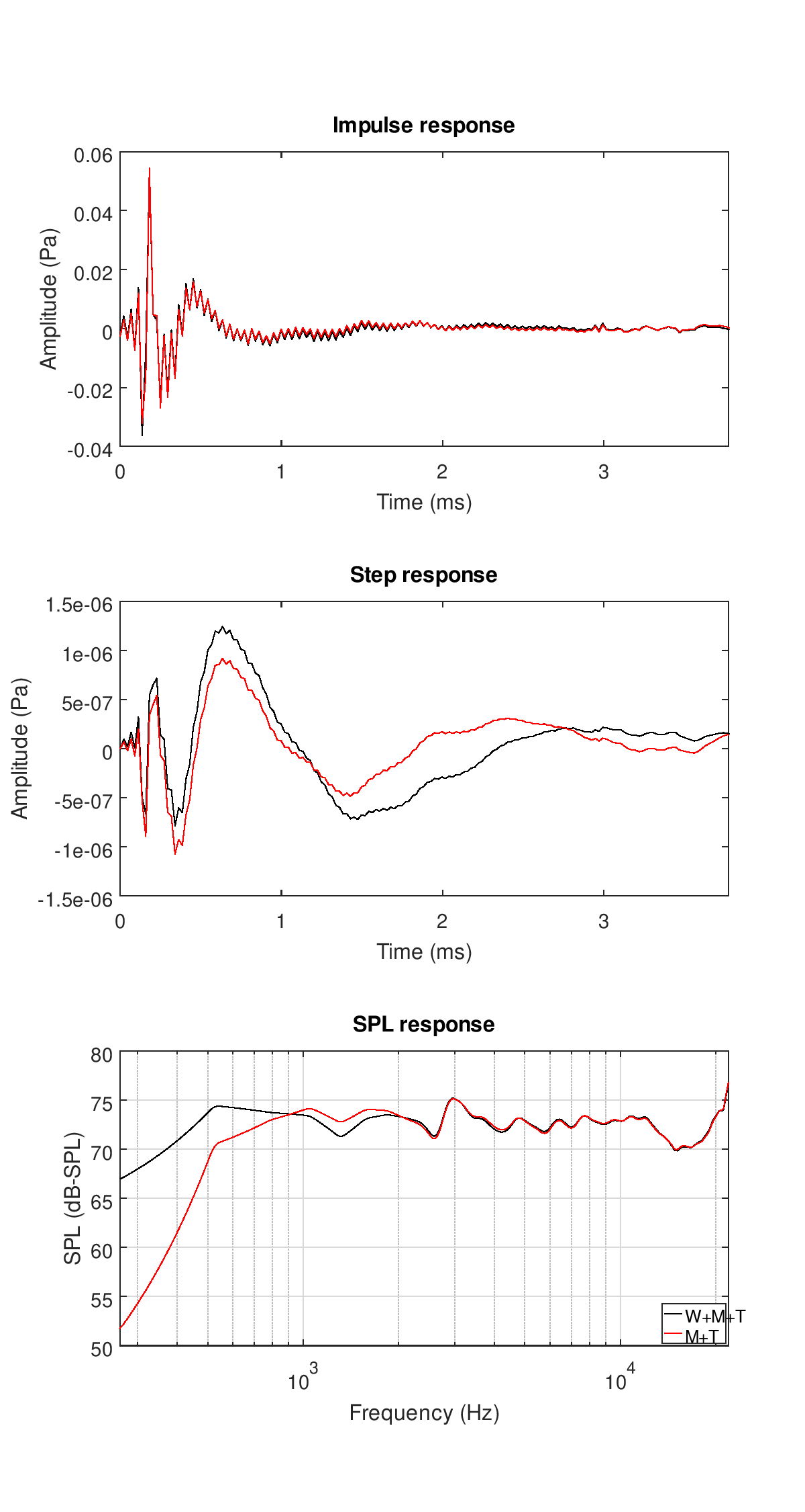

Guys, I am with you. But I believe I wasn't clear enough about what I was talking about. I was NOT talking about any issues at 500 Hz or below.
Take another look at the SPL curves in the first attachment of post 629. The black curve was measured WITH the woofer, the red curve was measured WITHOUT the woofer. You can see that WITH the woofer, the SPL is LOWER between 1-2 kHz. This must be some interference resulting from the woofer output in the 1-2 kHz range, which, according to the modelled curves in post 619 is only 24 dB below the midrange output in the 1-2 kHz range.

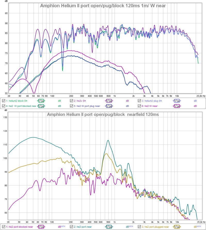

Kaffiman noticed perhaps the most obvious reason, reflex port resonances, have you measured the port mouth response? Backside port with 90¤ bend in the pipe might help. My Amphion Helium has backside port.
