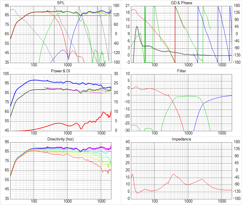

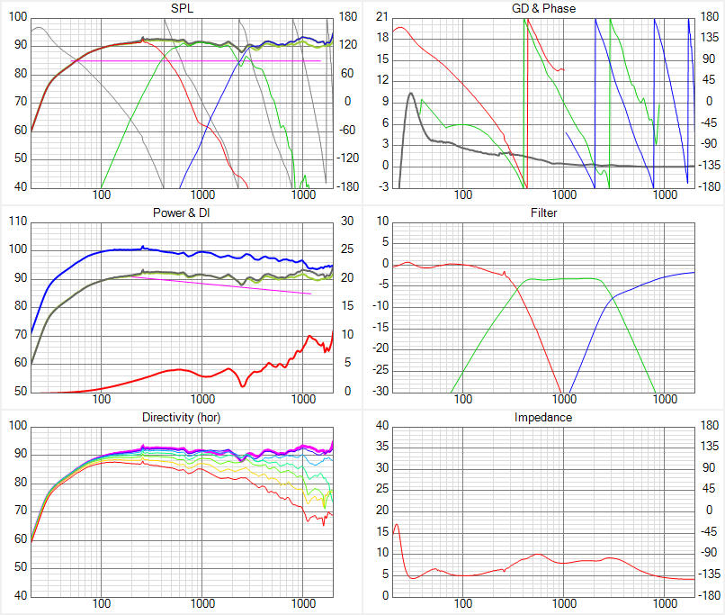

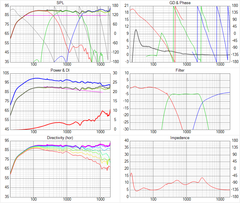

I had a look at three different filter versions using Vituix. The attachment shows the simulation results. At the beginning I tried hard to keep the driver response curves (acoustic) as close as possible to the theoretical target curves. However, I found that I can achieve better overall system response if I allowed some flexibility (cleaner summed response at the x-over frequencies, smoother off-axis response).
The three filter versions are as follows:
  • The first six-pack shows the "20190114-EL3" version, which is a revised version of what I showed in post 607. I tweaked the part values to reduce the stop-band leakage (a lot -- note the different y-axis scale). I also achieved much smoother power response (blue curve).
  • The second six-pack shows the "20190116-EL4" version, which was derived from post 654, but tweaked some part values a bit to achieve good off-axis response and a bit better summed response at the x-over frequencies.
  • The third six-pack shows the "20190116-Conventional3rd" version, which is a conventional x-over with 3rd order slopes (acoustical) that does not use the "notch elements" of the elliptic filters. I started from the Butterworth targets and tweaked it for good overall system response.
Before we go ahead with implementing these filters in the miniDSP, I'd like get some feedback on the simulation results. What do you like about those simulations, what is not to like? Is there anything obvious that needs to be improved?
I think the third option looks really sweet, the roll-off is nice and smooth, and the individual drivers seem to work well within their pass band.
The second option seems very nice too.
What is the difference in component count between #2 and #3, and will the cap values be higher for one filter than the other?
Thinking about cost and complexity here.

The number of parts in options (1) and (2) is the same as explained in post 654. The capacitors in the midrange filter are larger in the EL3 (33 uF and 82 uF) than in the EL4 (22 uF). Option (3) has 6 inductors, 5 capacitors, and 2 resistors (not including the impedance compensation parts, which are about the same for all designs). The series capacitor for the midrange is 33 uF.
I agree that we need to keep an eye on parts count and complexity, but let's say that the current EL3/EL4 complexity is just ok (but let's not get more complex).
I'd be interested in your thoughts about the electro-acoustics of the three filter designs. Is there anything to tweak or improve?

About Matthias' 3 options:
- I don't like the 3rd option with a SPL not flat down to 100 Hz, a fall off starting below 200 Hz. Such speakers are missing some fundament and deep bass in the sound. I have no good experience with such concepts for home applications.
- In the three options the voltage transfer of the midrange xo is flat, I think designed that way. It means that the SPL of the filtered midrange has a downward trend in its passband in the three designs. It will give a typical sound, more lazy I expect. Not my preferred one.
- I recently compared some filter concepts in a new speaker: EL3, EL4, LR4 and B3. Flat SPL designs +/- 1dB, very accurate on target, SPL and phase, miniDSP designs. I am surprised that the timbres are so close to each other. My ranking at this moment is EL3, LR4, B3, EL4.
EL3 the most musical with the most life experience, LR4 also but more modest. B3, very musical, sometimes overdone. EL4, almost the same as LR4, but less fascinating, LR4 sounds more refined. EL4 has the same curve shape as the LR4 around the xo frequency, but a more steep fall off outband. So there is less power in a EL4 than a LR4. It sounds like that. The EL3 (the version used in this project) has more power, because of the smaller more brickwall overlap zones.
- Personal preference for this project is EL3, but with a little more flat SPL from low to high.

I just want to say that the 3 options have different limits on the scales, and it is a little bit difficult to compare properly, other than the obvious difference in GD ofcourse. How can you possibly say the B3 alignment is less efficient when it has higher SPL than the others?
I do agree that with the data given, the EL3 looks about equal to the B3 overall.
It would be nice to see the B3 and EL3 graphs overlayed.
I agree that EL3 sounds better than EL4 "less is more". But the components are probably a little cheaper for the filter that requires the lowest cap values, might be significant.
I have no opinion on the relaxed EQ curve, but feel it is a matter of personal taste, and I think it should be an option to choose freely for the builders.
...Before we go ahead with implementing these filters in the miniDSP, I'd like get some feedback on the simulation results. What do you like about those simulations, what is not to like? Is there anything obvious that needs to be improved?
Prefer your latest tweak for EL3 (first one), all curves there looks to be a good avarage and have the smoothest directivity index without that 2,5-2,8kHz such out as the other two have and that bit smoother index should tell the polars from left to right side is most coherent and help in tonality of reflections to be most the same.
This is a good point. Seems I didn't look at this well enough. That's exactly why I put this up for review before asking for biquad coefficients! I'll try to revise this simulation accordingly.
I didn't design the midrange voltage transfer curve to be flat. My goal was to achieve flat and smooth acoustic / SPL response (on-axis, off-axis, power response). I only looked at the voltage transfer curves to make sure there are no funny peaks or dips that would point to something very wrong with the filter design. The voltage transfer curves just came out flat from this. I don't understand why this would give a "lazy" sound. What we hear is the sum of the drivers, and that looks ok to me (except maybe the issue with option (3) mentioned above).
- I recently compared some filter concepts in a new speaker: EL3, EL4, LR4 and B3. Flat SPL designs +/- 1dB, very accurate on target, SPL and phase, miniDSP designs. I am surprised that the timbres are so close to each other. My ranking at this moment is...
That's pretty much what I am after at the moment. Test different concepts/designs for the Monkey Box and then decide on the way forward based on these tests.
Are you referring to the on-axis SPL response? Yes, it could be made flatter, but at the expense of the off-axis / power response.
They all have a 60 dB span on the SPL axes. But you are right, option (3) has the SPL levels offset by 5 dB. Vituix just does that, because option (3) is a little bit "louder" than the others due to the rising SPL response below 200 Hz (see issue pointed out by Paul above). I don't see how the axis limits can be hard-set in Vituix.
I am actually a bit confused about this. The parts count is the same for the EL3 and EL4 circuits, and the EL4 actually has one single 22 uF cap in series with the midrange where the EL3 has two series caps (33 uF and 82 uF).
I'd suggest to aim for "flatish" response, as this is what most people would think is right.
I have noticed this too while I was working on these designs, and I am glad you pointed this out. I guess this little blip is due to baffle edge diffraction, as it goes away in the off-axis SPL curves.
I simply wanted to get some comments from you guys first before giving my own opinion in order to avoid polluting the discussion with my own thoughts :)
  • The overall acoustic response looks rather similar for all three options, with the exception of the SPL rise below 200 Hz with option (3)
  • I decided to use E12 part values only in order to stick to parts that can easily be obtained. This imposes some limits of the filter curves than can be achieved. For instance, I could achieve some improvement for the direcitvity blip at 2.6 kHz with option (1), but not so mucht with options (2) and (3).
  • The bass peak of the group delay curve is slightly higher for option (2). However, the bass simulation is based mostly on synthetic model data spliced to the measured SPL curves at some higher frequencies. I wouldn't believe the absolute values of the bass group delay, but it is interesting to see that option (2) does not come out as good as the others.
  • Overall, I think that option (1) provides the flattest / smoothest SPL output, but it may be a bit more effort to build due to the midrange series cap(s): 33 uF + 82 uF series caps vs. single 22 uF for option (2) and 33 uF for option (3).
I will try to improve option (3) to be more flat around 100-200 Hz and then come back. Please don't hold back if you have other comments so that we can include these before doing the biquads for the miniDSP.
