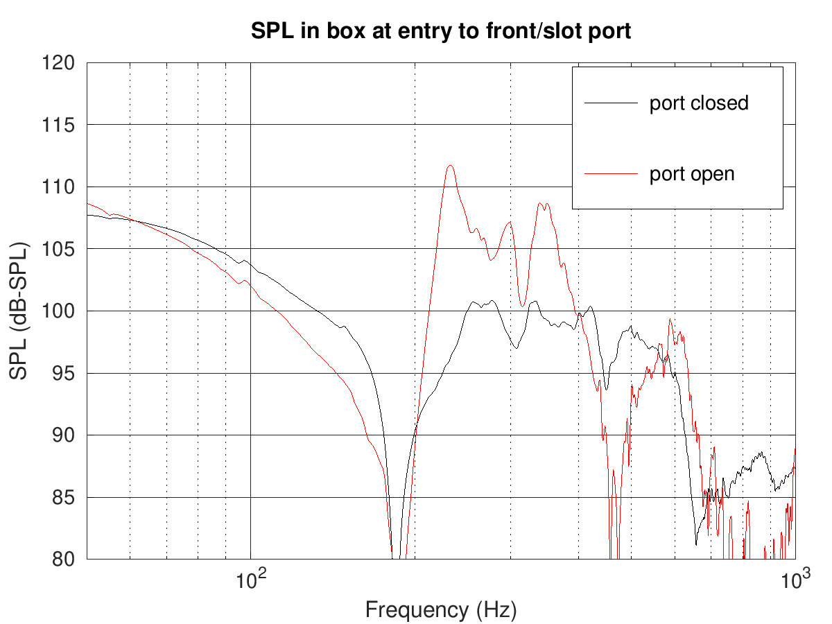

You can clearly see that funny things happen at 250 Hz with the front/slot port open (red curve). No such resonance happens with the rear/round port, which is quite a bit shorter than the front/slot port. This indicates that the 250 Hz issue happens within the long slot port, not in the enclosure.
No, it does not.
What it indicates is: That the slot port throat is placed somewhere a 250hz resonance triggers! And I have warned about this since way back.
I will concede to almost any points in regards of filters, tweeters and midrange drivers. But not on the point of BR/equivalent type boxes and internal modes.
It is not the port itself, it is the port in relation to internal surfaces, and driver placement.
A mode does not trigger uniformly in a room, or enclosure.
You are right, my previous measurements cannot exclude this. I therefore placed the microphone inside the box at the entry to the front/slot port (with the rear/round port closed). Then I first measured the SPL with the front/slot port closed, and then again with the port open (see attachment). If the resonance arises within the main enclosure volume, the SPL around 250 Hz should be about the same in both measurements. That's not what I see in the measurements. The SPL is much higher with the port open. This looks to me like something is happening in the port. What do you guys think?
I do not dispute that it does not happen, or that the port does not have some influence the resonance. But it is because the port is placed where it is. It is not caused by the port itself.

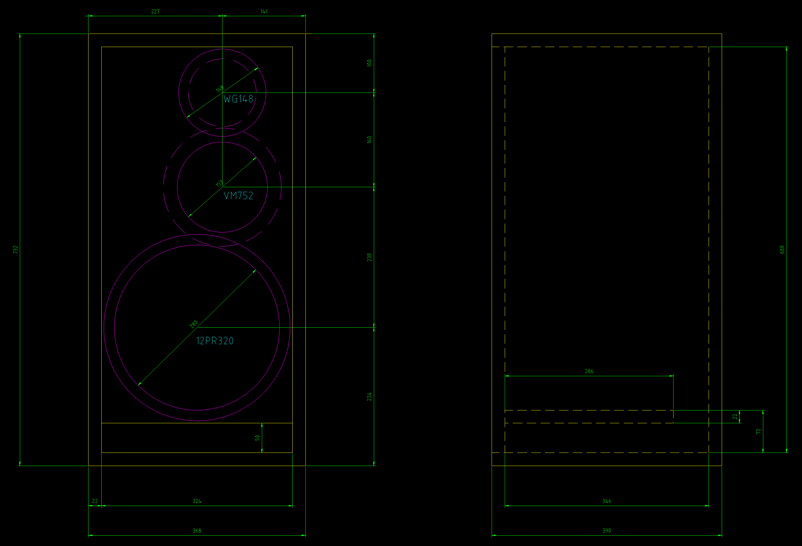

The only constraints I have at the moment is that I don't want to place the port right next to the mid or tweeter for diffraction reasons. Also, the space available on the front panel for a port with a largish cross section is quite limited (see drawing in post 346).

Remember we are not aiming for a full blown study of how to design a bass reflex system in general. We are looking for the best option for the Monkey Coffin.
So far, the long slot/front/bottom port created a problem which the shorter round/rear/center port did not have. A front port next to the mid/tweeter is out for reasons of space and diffraction.
