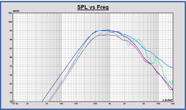

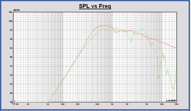

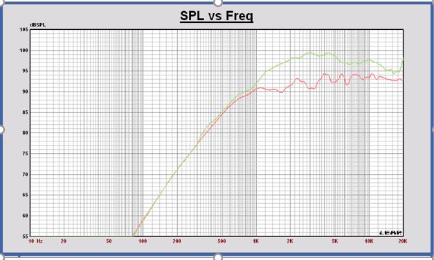

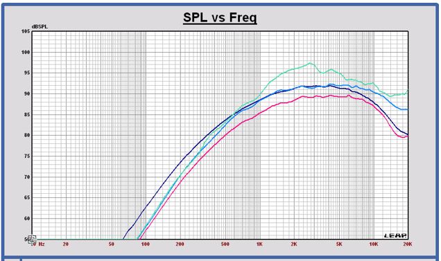

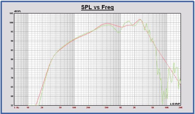

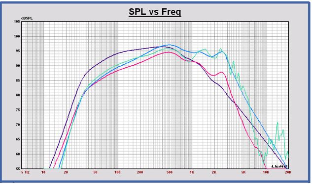

Some curves to think about. We can discuss about later on.
SPL on axis curves for each driver:
- SPL on axis of measurement (green) and Leap simulation (red)
Power curves for each driver:
- Measured power in the single horizontal half plane conform Tylka (green)
- Leap single horizontal half plane power (blue) and full sphere power (red) conform Tylka
- Leap radiated power per driver (dark blue)

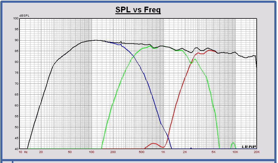

Power curve with last EL34 X-over, using measured driver powers
Remarks:
- No tweeter waveguide in Leap, simple driver models without any SPL correction
- Measured SPL curves, +1.5 dB added to match with Leap
- Power conform Tylka is expressed as the SPL of a point source in full space with the same power.
- Power in Leap radiated by the driver is expressed as the SPL of a point source on infinite baffle with the same power.

Some comments on the power curves.
- As expected, measuring only off axis SPL in a single half plane, the resulting power response is representative for the full sphere power only in the frequency region where the speaker is omnidirectional. For frequencies above the bafflestep, where the speaker becomes unidirectional, the single half plane power becomes higher than the full sphere power.
- The single half plane power calculated with the measurements maps on the Leap single half plane power simulation for the woofer, for the midrange expect around the bafflestep frequency, but not for the tweeter because of the waveguide.
- As not expected (by me 🙂 ), the single half plane power of the tweeter with waveguide is higher than the tweeter without waveguide. In full sphere it is not measured yet, but it is to be expected that the behavior is the same, that the power becomes also higher in full sphere using a waveguide.
- Interpreting the power sum with X-over, this is a single half plane power curve. The full sphere power will be lower for frequencies above the bafflestep frequency.
- Maybe interesting also to compare the results with VCAD?
Measured power ... conform Tylka
I am not quite sure how to interpret this since I have no clue about the features available in LEAP. Did you implement the Tylka equation in LEAP? Or did use the existing tools in LEAP to calculate power response that should be consistent with the Tylka approach (integration over a sphere around the speaker)?
That's based on the concept of calculating the power output from the driver (using the TSP etc.), correct?
I can see why one would expect this. However, my quick-n-dirty experiments using synthetic data in VCAD showed that the shape/slope of the power response was hardly affected by neglecting the rear hemisphere. The major difference between the full-sphere and half-sphere calculation was the the absolute level of the power response changed a bit. I'll look into this a bit more.
Is this because the waveguide improves the coupling of the tweeter to the air, allowing the tweeter to transfer more power to the air?
Yes, I will play with this a bit in the next few days. I have also implemented the Tylka equation to calculate the power response from ASCII data files in GNU Octave. It's here, and it gives slightly different results than VCAD (see here). I don't know yet why this is.
Overall, I still wonder how important it is to get full-sphere measurements in order to make progress with the Monkey Coffin. Yes, a proper assessment of the power response would require the full-sphere measurements. However, I don't want to become excessively obsessed with the power response assessment for the Monkey Coffin. Do we absolutely need better power response than what we have? We already know the power response is quite linear with a slight slope, with no nasty bumps, dips, or other undesired features. In case we do need a better assessment of the power response, do we need it now, or can we do it later?
I am asking these things because my workshop is currently cramped with other things that have higher priority than the Monkey Coffin (yes... but we need a new door for our house!), and there is currently simply space to do proper acoustic measurements. In addition, I wanted to build a second box to see how a stereo pair would sound in my listening rooms.
What does everyone think? Build a stereo pair first? Work out the power response properly first? Try the augerpro waveguides first? Something else?
Leap has a curve averaging tool inclusive weighting etc. to calculate the power conform the Tylka formula.
Driver power output is calculated with TSP, radiation impedance , etc…yes.
A waveguide does change the radiation impedance seen by the tweeter and thus also its radiated power. I have to look how to simulate waveguide behavior for the future, in Leap it isn’t possible.

So I'm pretty convinced this is the speaker for me once you work out these final issues, and I can't wait because I know you will. While the bookshelf idea was a nice idea, I think the sound quality will be so good that they will mostly be used with the front baffle at least a meter from the wall. There are too many compromises required to make a "bookshelf speaker" that actually works on a shelf and also works a bit away from a wall.
I found the FaitalPRO 12PR320 in the USA at $238 from Usspeaker. Parts Express sells the Faitalpro line but not that speaker driver. I'm pretty confident that they would special order if people wanted them, and their commercial account prices are usually a great deal!

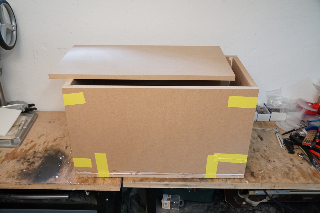

Here's how far I got with the second prototype for now. Building another quick'n'dirty monkey coffin, and some beautiful augerpro waveguides that fit the Scan R2904 like a glove!
I will be away for a few weeks, so don't hold your breath for more progress with this.
